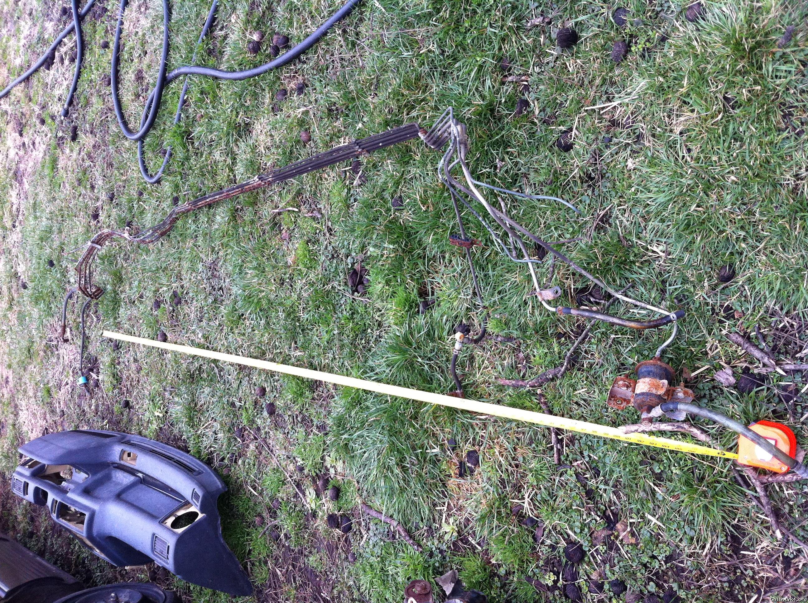

Does anyone know approximately how many feet of line we need to replace the stock hardline?

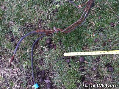

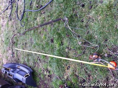

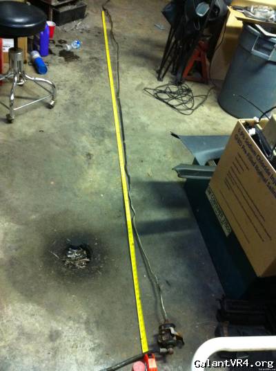

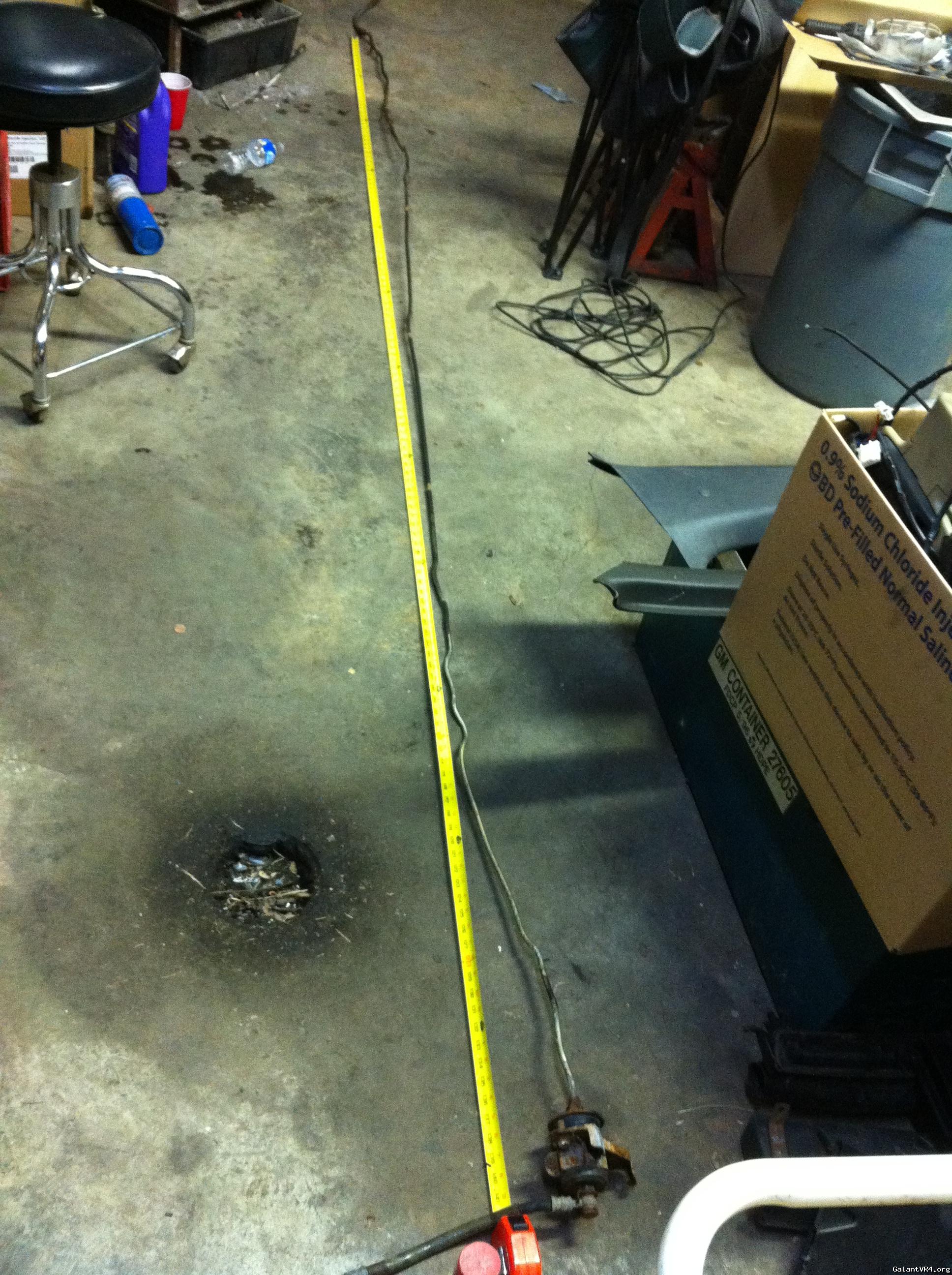

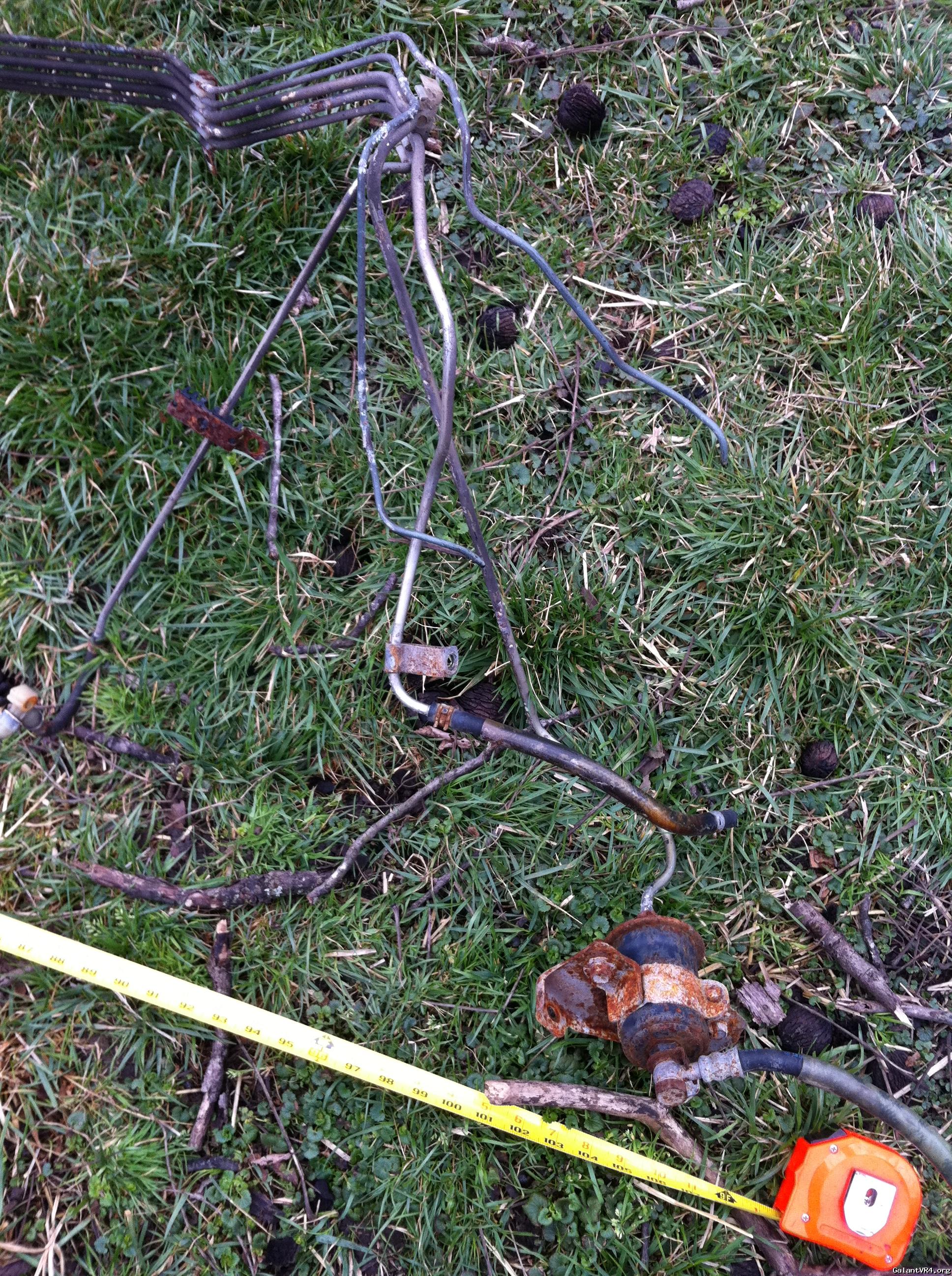

I think that the general consensus is that the return line does not necessarily need to be upgraded the same time as the supply.

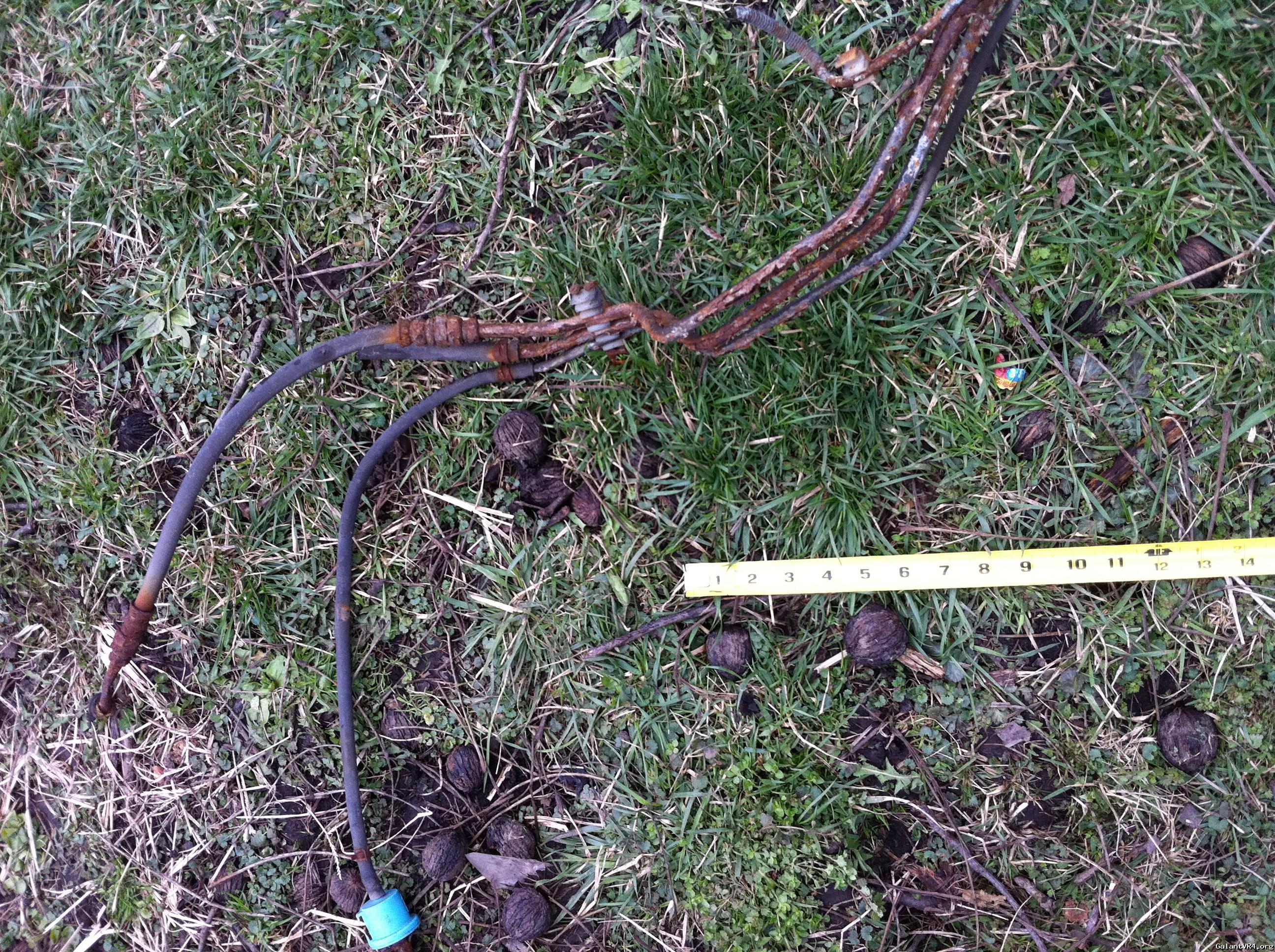

If that's your fuel line you've taken photos of, is it possible for you to measure the whole thing? I mean, especially if you're going to junk it, you can straighten and measure it, and it would be GREAT if we knew precisely how long it was.

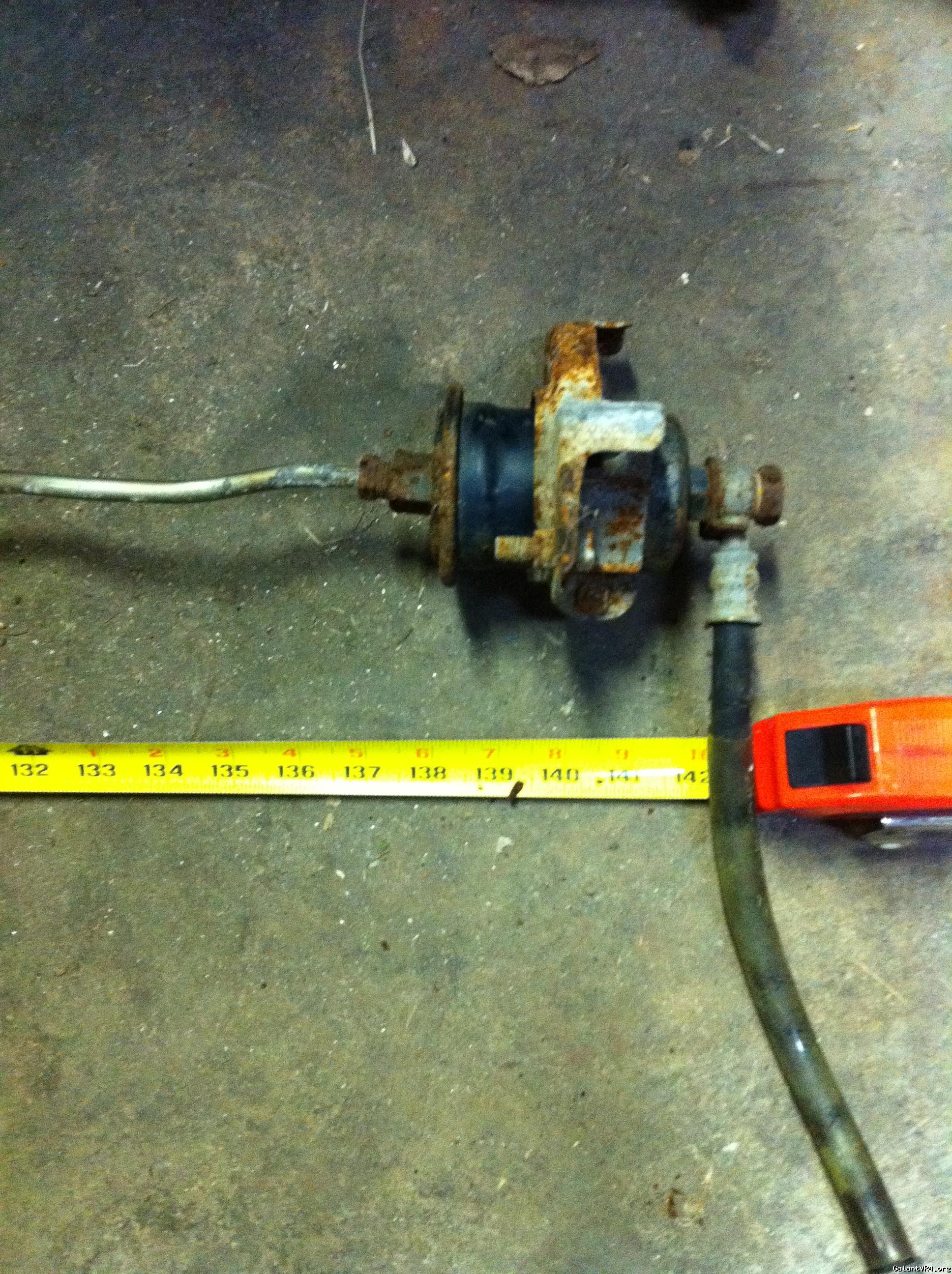

Looks like the flexible line at the end is about another foot, right?
That would make it a total of 13 feet of -6 AN that i need to get, if i follow the OEM route. In order to make sure there's a margin for error, i suppose i'd just go ahead and order 15 ft. Fortunately i already have adapters and hose ends. /ubbthreads/images/graemlins/smile.gif /ubbthreads/images/graemlins/grin.gif /ubbthreads/images/graemlins/wink.gif /ubbthreads/images/graemlins/tongue.gif
