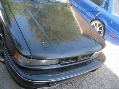

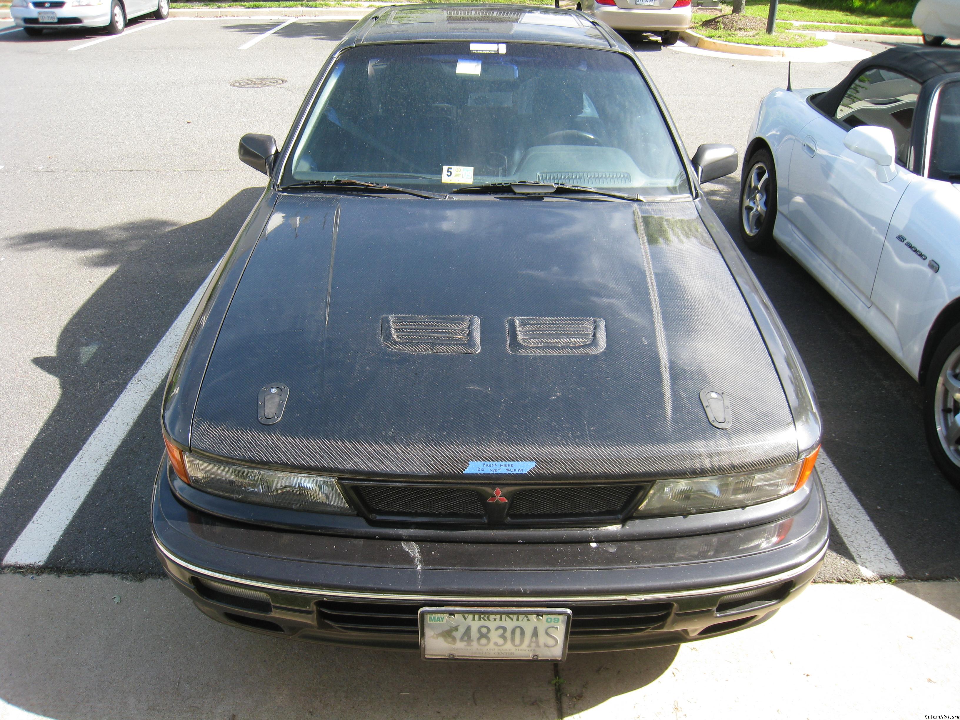

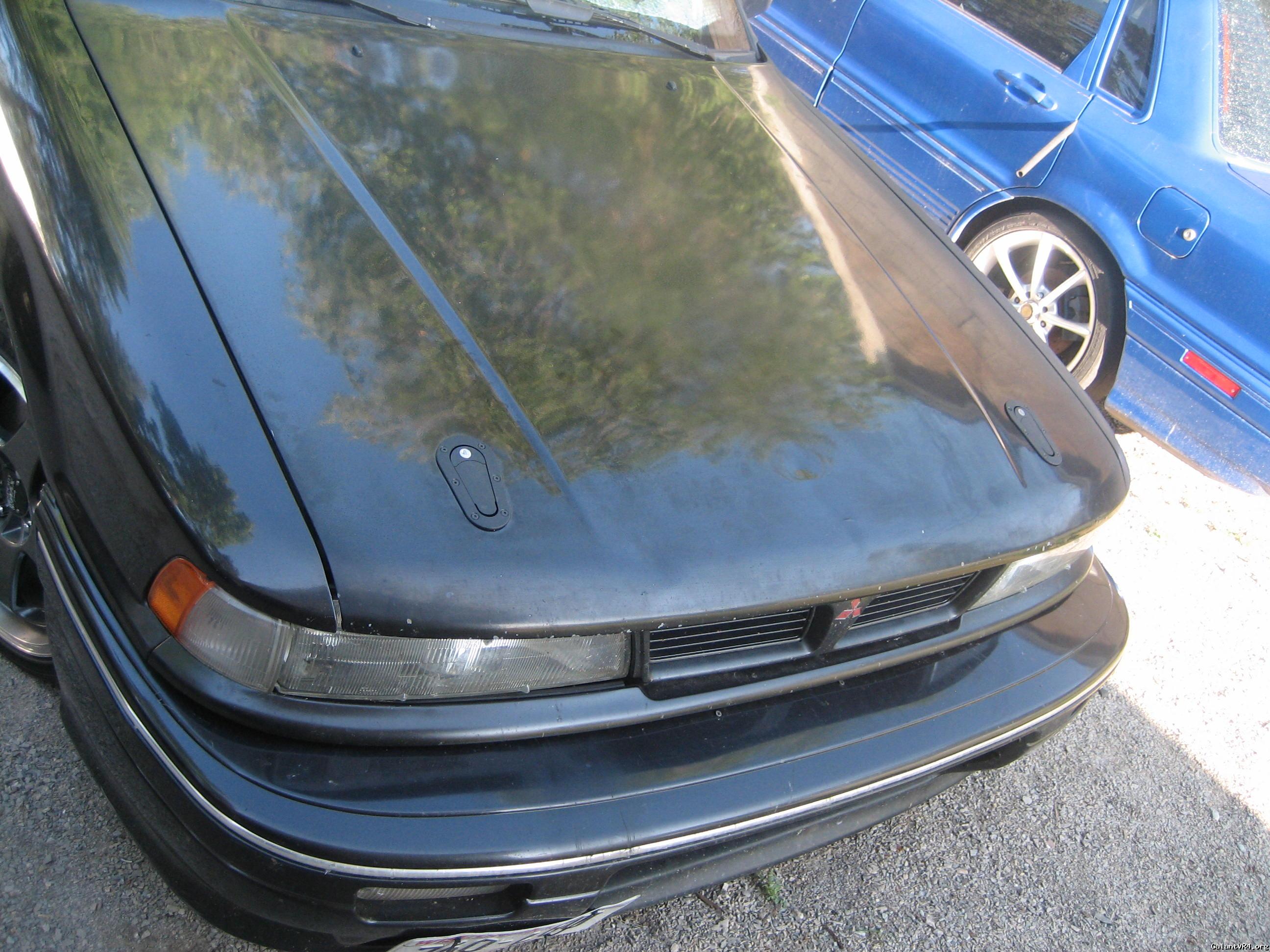

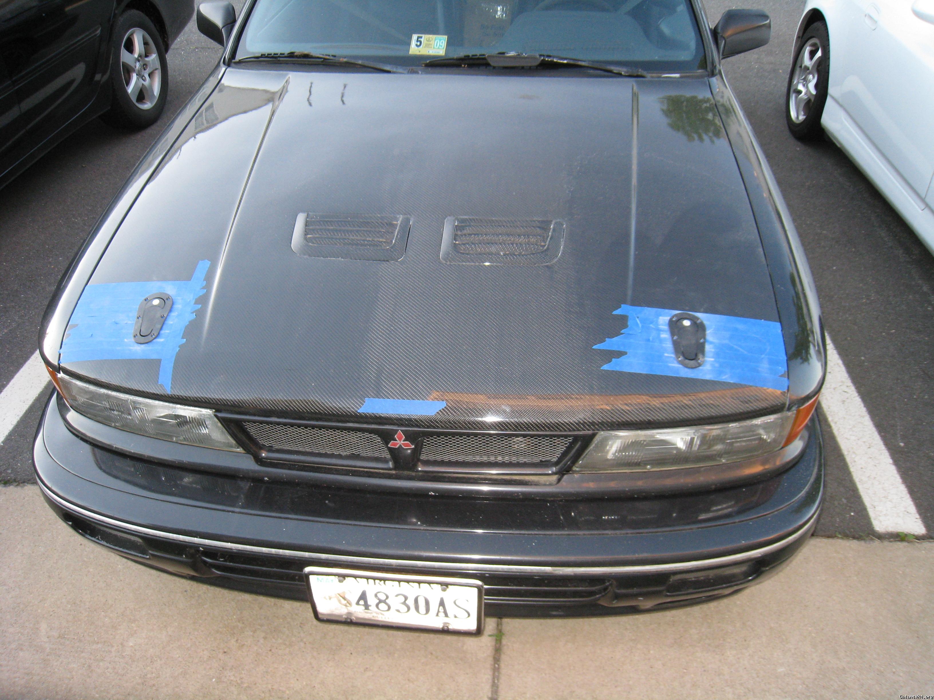

pictures arent uploading.. i have a set on my car.... I wasnt able to put them on the correct way because i had sparco pins before.. but they came out nice.. ill get the pics up in a few for you

Quoting spooling92vr4:
Fixed.

the hood's a dented mess but that's why they went in there first. if i screwed them up, i just mess up a junk hood. anyway, i love them.

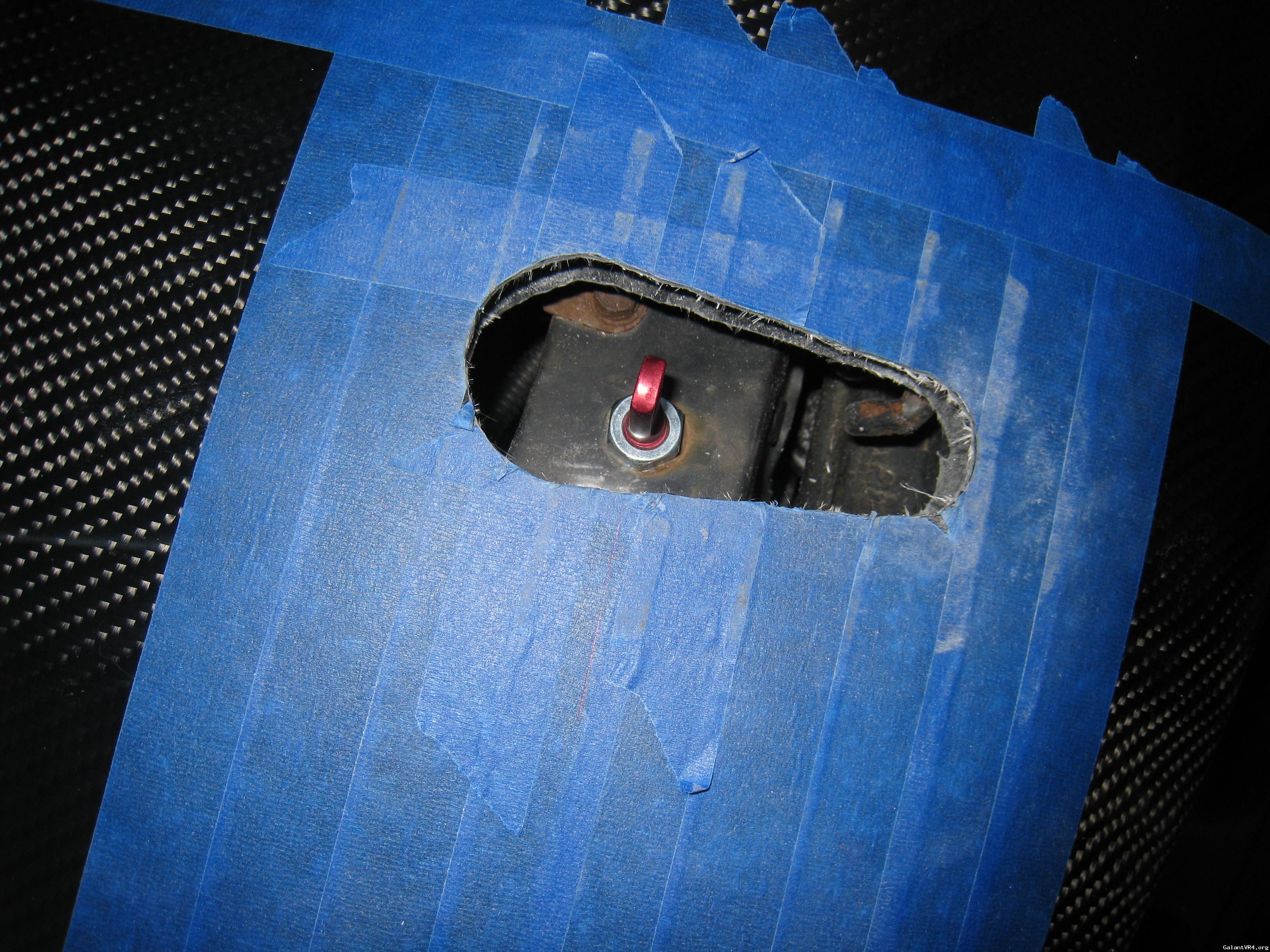

Thanks for the pics! Although, I must admit, I was hoping to get a pic of under the hood to see where the pin is being mounted by everyone. If someone doesn't mind posting...? /ubbthreads/images/graemlins/smile.gif

Great write-up, thanks. That'll help a lot when I get to this. I'm just looking to see where people mounted the pins underhood. Thanks!
-shamus
Mostly for a vr4 I've seen people drill the pins about 1.5 to 1.75 inches in from the rubber stopper.
Search around in members rides and you may find some pics.

you really have to hack up the underside of the hood to make them fit. will take some pics of the underside of my hood tomorrow.

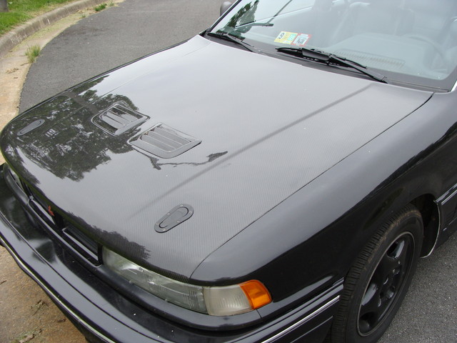

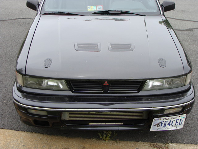

Sorry, this is the best hood pin pic I have. It's before the Aerocatch pins, but the actual pins are in the same location.

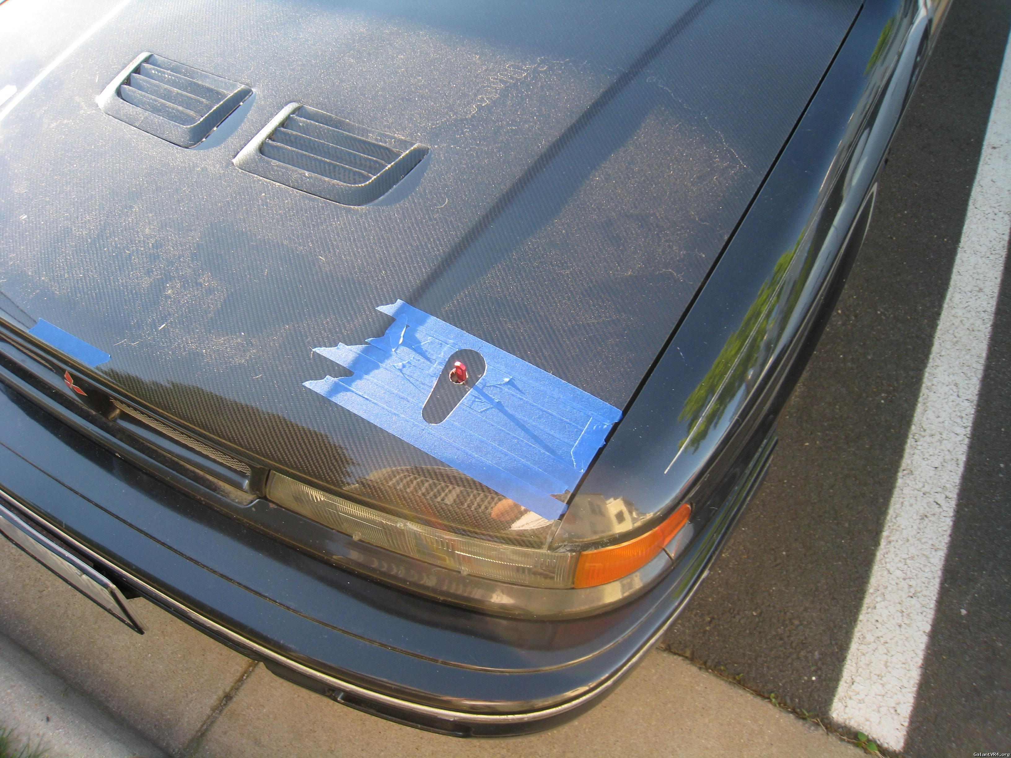

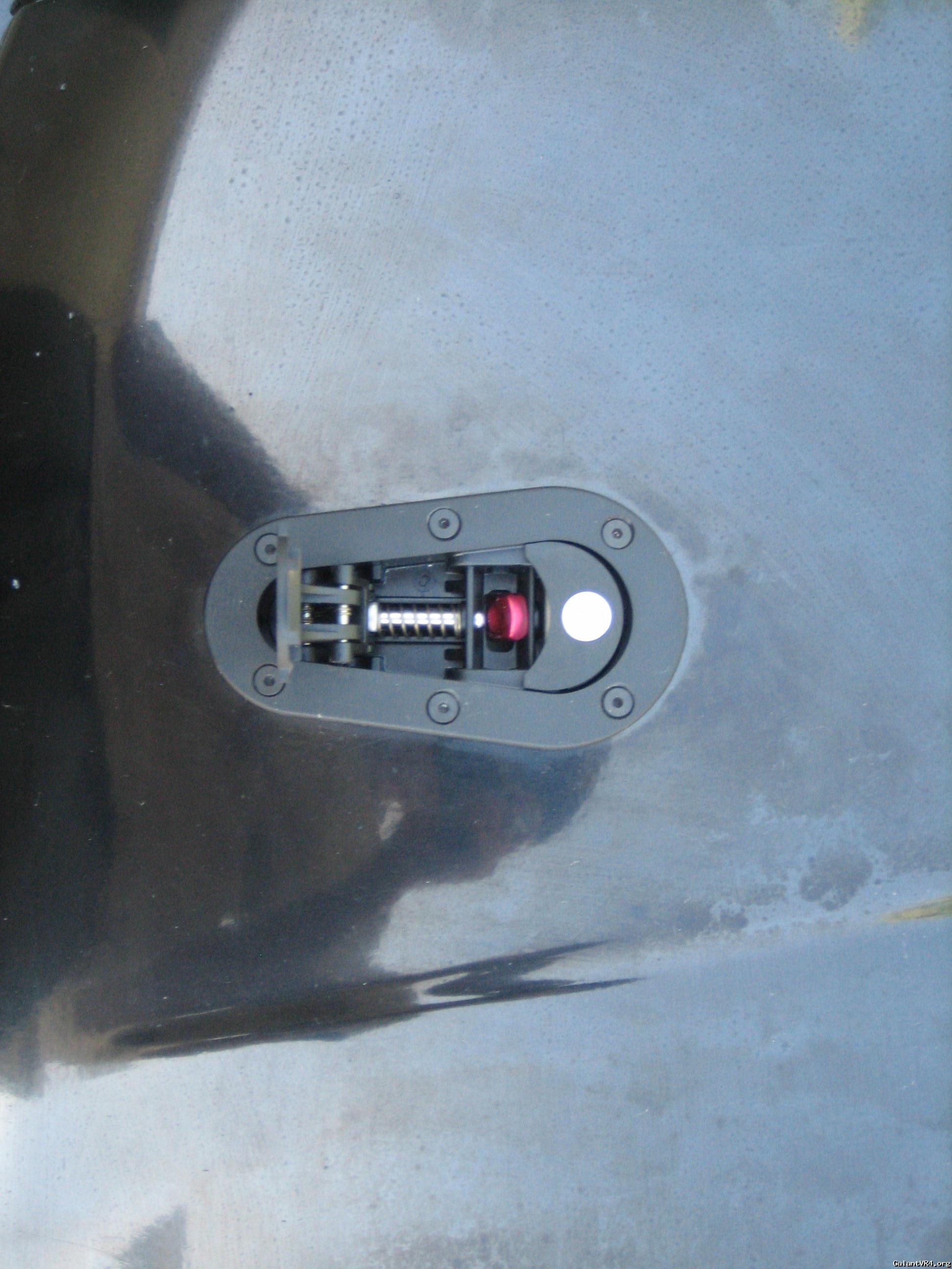

That write up is very good, I would only add that I remember seeing another one somewhere on the DSM forums which was also very good.
I mention it mainly because the author of that write up gave the sizes of two hole saw attachments for a power drill (the type used to drill circular holes for installing gauges etc). When cutting the opening in the hood he cut two holes which followed the radius of the edges at each end, then he cut a straight line on each side to remove the material left between the two holes.
At the end of the day both methods work and once the catches are installed any rough pieces should be hidden. I just thought the second method sounded much easier.
