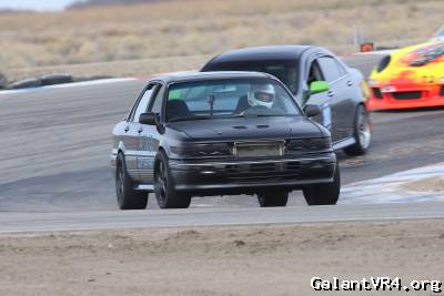

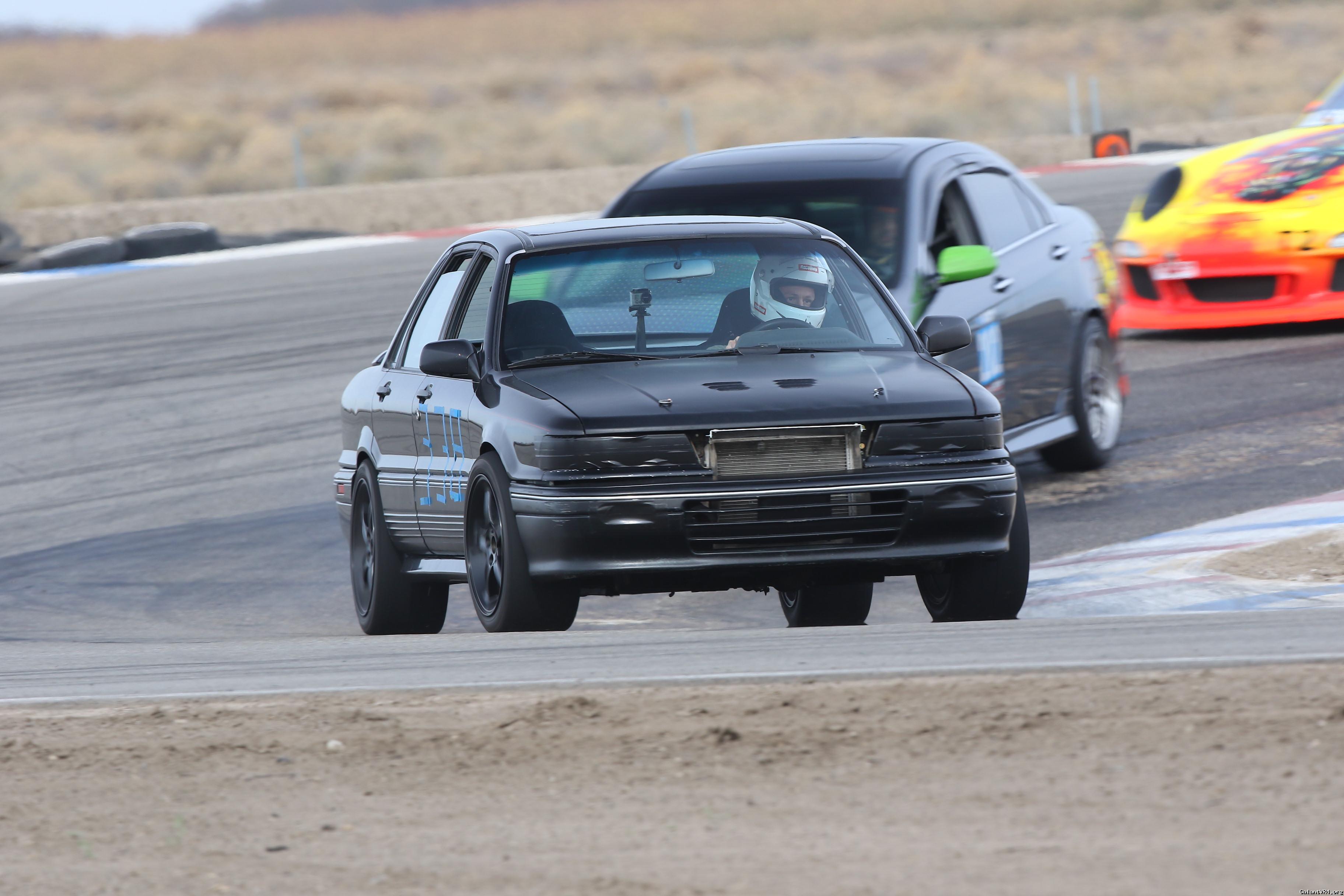

i want some holes in my hood also. my car seems ok at anything below 80* ambient temp now. and it doesnt have AC, so really i probably wont be putting many miles on it when its hot out.
i was thinking of something like this:
either a CF hood or i cut a vent in. but that one looks too far back, dont want rain pissing onto my valvecover or turbo manifold.

I live in the middle of the desert in AZ so I feel I have a fair understanding to the situation seeing as how I daily my galant in 120F as well as track it. I can tell you the fans are key. I have full working AC and it was 105F out today and I happily boosted along and sat in stop and go traffic at 185F with the AC full blast. I'm running a 1g mishimoto X line (3 core) which helps tremendously, a 180F t-stat, and I'm using a stock galant pusher fan and a stock 1g puller. It's a very tight fit and required a bit of clearancing, but the engine without AC on will hit 204-205 and drop back to 190F as soon as the fans kick on. If I have the AC on full (green light), fans on high speed all the time I can idle for hours on the t-stat. The fans are what really keep my temps. I installed Evo 3 factory hood vents during the winter and my car already runs on the t-stat with the fans on so I can't comment on hot temperature effectiveness from installing vents, but just from the initial drive comparison it takes 3-4 minutes of cruising before I reach operating temp with the vents as opposed to without.
