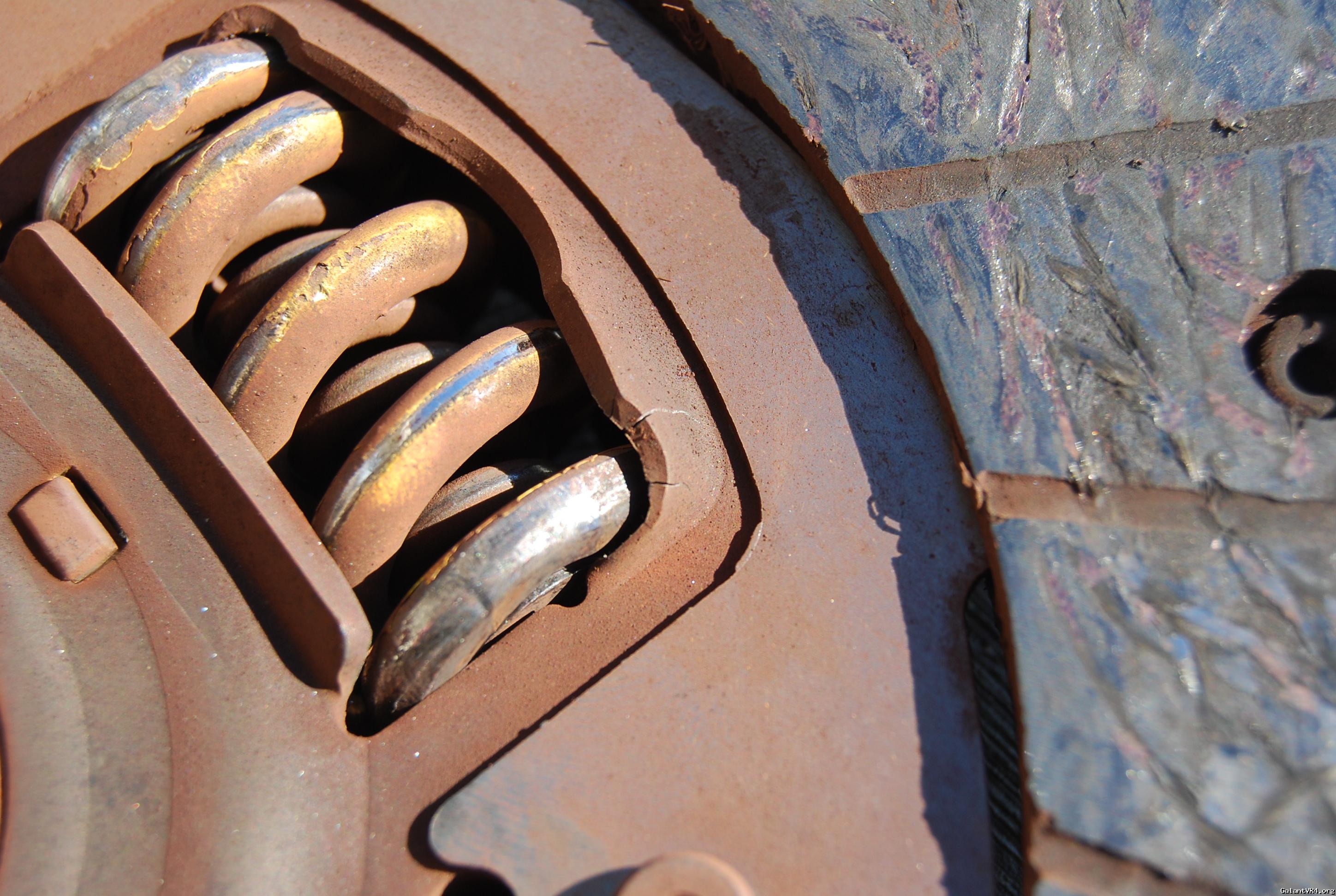

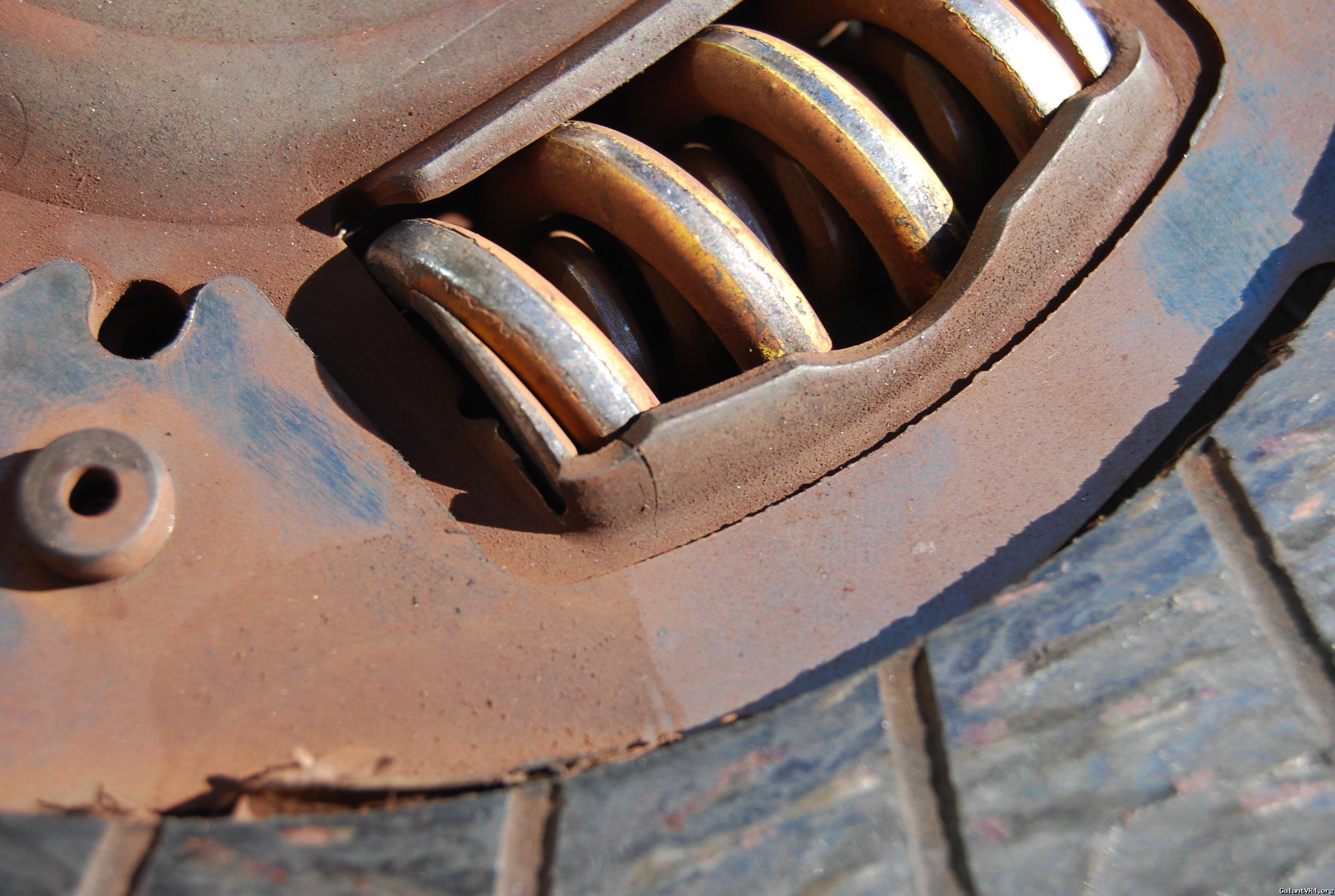

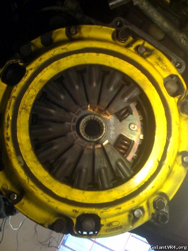

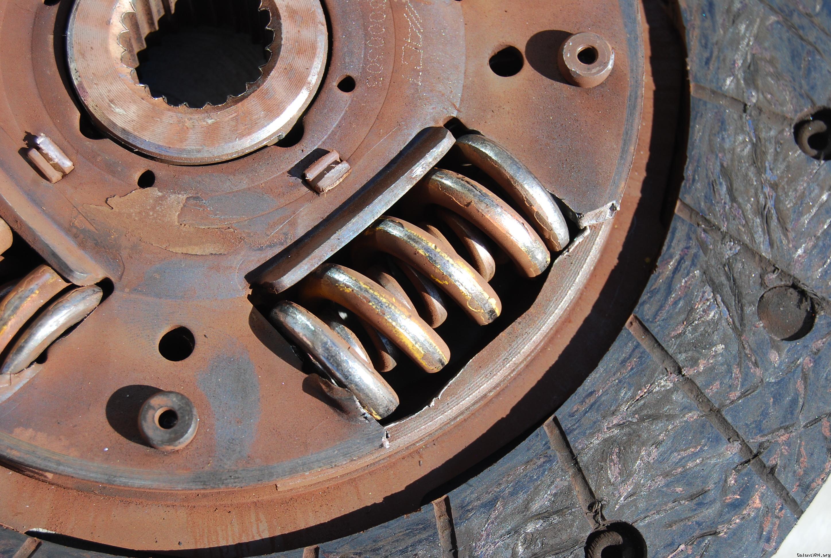

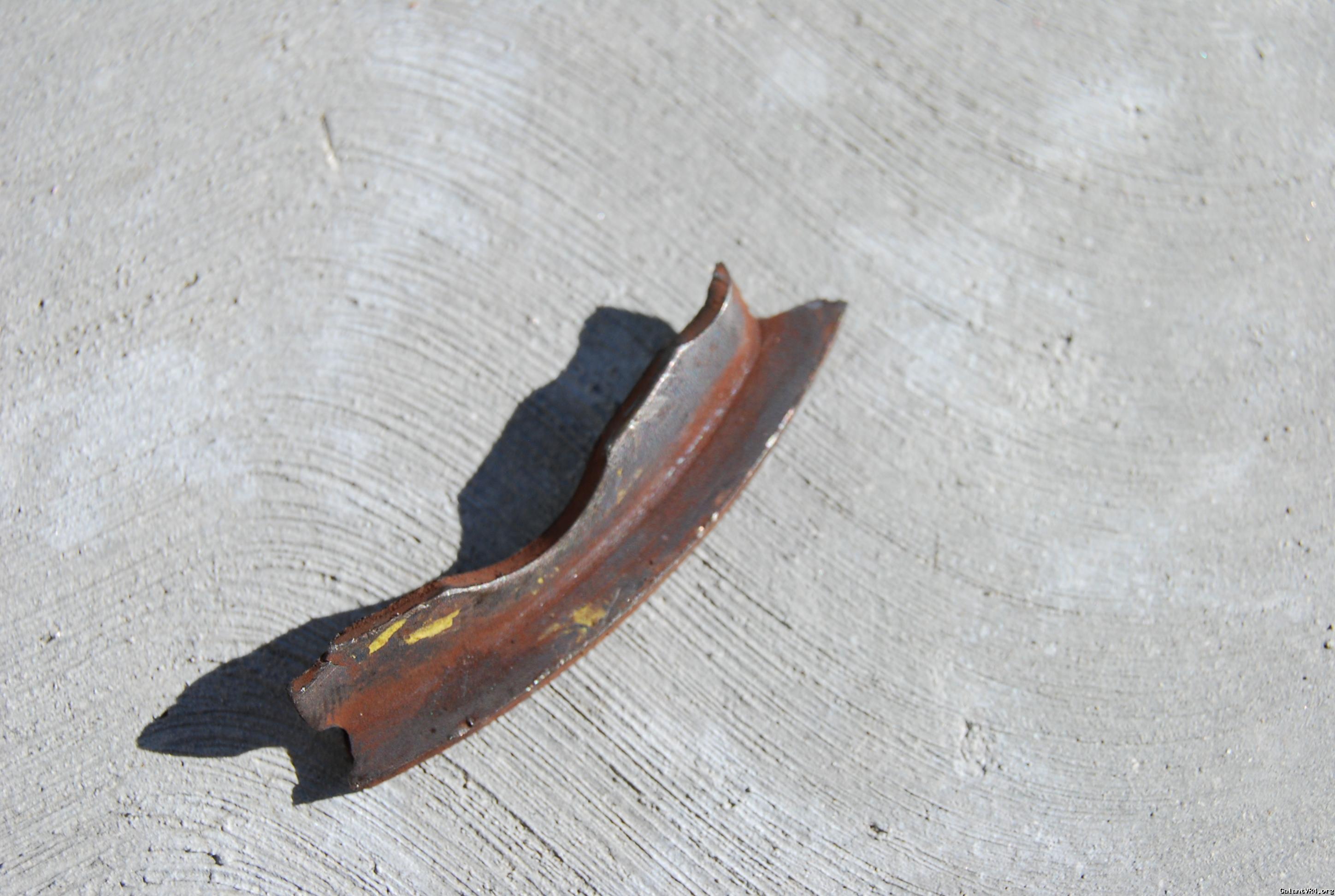

So my brother inlaw had an ACT clutch fail on him about a year ago(due to spring failure). Well we contacted ACT and they offered to replace the clutch for
free. Well Not long ago he was driving back from North Carolina and about 1000 miles into the trip he started to have trouble getting into gear. The trans
in this car is a custom Shep trans so we knew the trans was not the culprit. Like 3 days ago my dad went to move the car and it jumped as if it the clutch
was stuck. So Jon(jonvr4) and my Dad started pulling the trans yesterday to see what the deal was we suspected the clutch to be the problem once again.
Finally after an hour of tinkering with it the trans was off and they removed the clutch to find this. Last time the spring tried to leave the hub.
This time the Hub decided it hates life and hit the "self distrust" button.

Oh i forgot to add that by every spring the hub had hair line cracks. /ubbthreads/images/graemlins/banghead.gif
Sorry Daryl, no more ACT for us. We went back to an OEM disk on this car due to it only having a 2.5" exhaust. How ever we did keep the ACT streetl

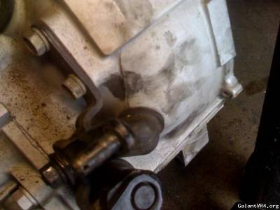

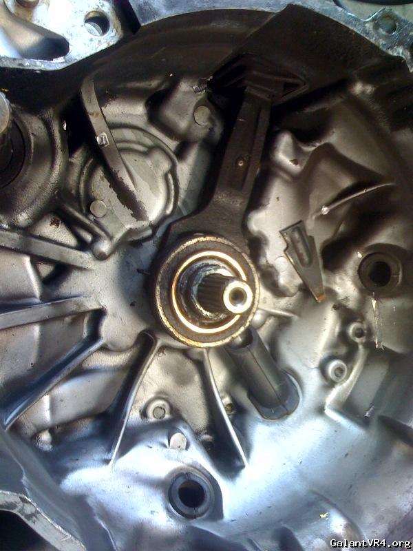

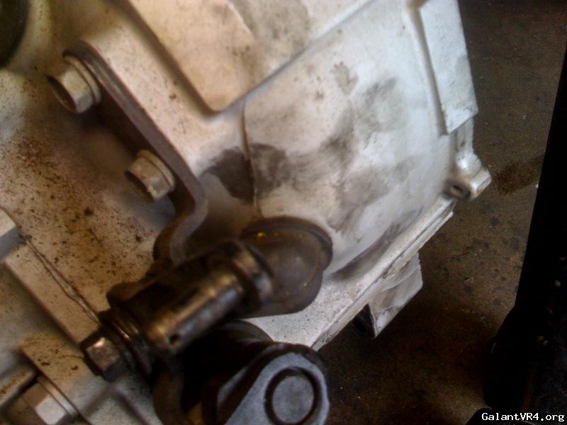

I had a good experience with ACT about 6 years ago lasted me a while so i decided to go with an ACT again along with a new ACT street disc 2600pp and ACT flywheel and TOB a new pivot ball, fork, master, slave and rebuilt clutch pedal ran fine for about 3200 miles and then failure came see pics totally ruined my Shep stage 4 case to /ubbthreads/images/graemlins/banghead.gif /ubbthreads/images/graemlins/bawling.gif /ubbthreads/images/graemlins/bawling.gif /ubbthreads/images/graemlins/bawling.gif /ubbthreads/images/graemlins/bawling.gif
by the way its been about 3 months, and to this day ACT has not done anything about it
