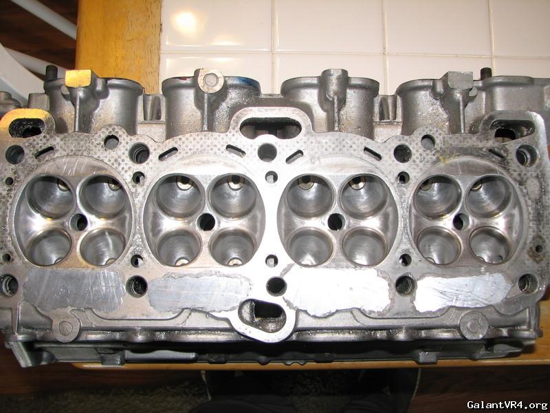

Added security when running 32+ psi. I dont want the head to be lifting on me, especially since its my daily driver. We even held off on timing down low to help keep the head down.
Brianawd
Apr 18, 2005
2,117
Portland OR,
Why do you need L-19's???
Because the regular 8740 head studs suck ass. I know I know, People have made 700+ with them but that is short lived. Why not just put them in with a good head gasket and forget about it.
On my 95/90 motor I was lifting the head with the 8740 studs. So I replaced the head gasket with a fel-pro mls had the head surfaced and then check and hand lapped the block. I again used 8740 studs. Motor was good for a few more months then started lifting the head again. It was after that I choose to never use the 8740 studs. Why spend $85 for a set of throw away studs when you can spend a little more and get something that you can use over and over and don't have to think about. Thats just me.
To tell you the truth, I have been running the standard stud forever and have never had a problem(35psi) but it may be the way we o-ring the block. Mike Reichen still runs the standard head studs with 45+psi. We were having an issue but we ended up milling the head out and welding it up solid under the exhaust port were it was blowing out and we haven't had any issues since. I've also done an evo 8 head like that also.
Brianawd
Apr 18, 2005
2,117
Portland OR,
No o-rings here. I thought about doing on this build but for some reason did not. Maybe next time.
We press the o-rings into the block and then mill the tops off so they stick up about .005. It seems to work the best and then copper coat everything real good.
