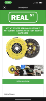

GVR4 guys,
ACT MB1-XTSS clutch kit…
Anyone had any issues with install on stock flywheel??
