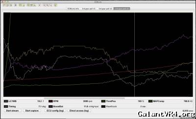

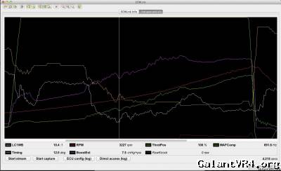

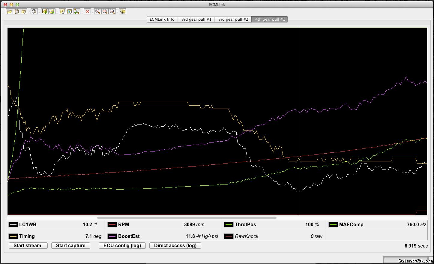

I'm driving on a dyno tune right now and I've noticed a few things. One is a rich condition at a certain MAF value, the other is a small (but noticeable due to timing getting pulled) amount of knock.
I'm seeing knock under boost 100% of the time when my boost hits 20psi. Sometimes while I'm in third gear, I don't see enough to throw a CEL. Other times I do. 100% of the time I see a CEL in 4th gear. I see knock at partial throttle under moderate boost at a lower RPM. Just one or two counts, so again, not enough to light the CEL. Different cells in the timing table as well (from WOT).

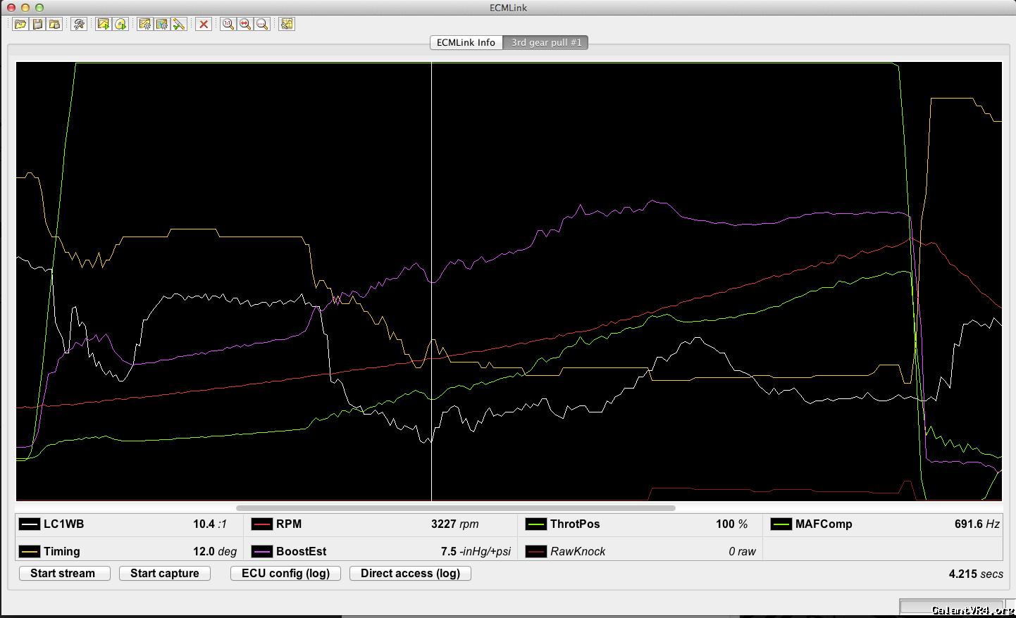

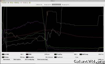

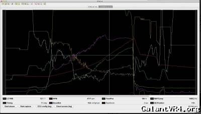

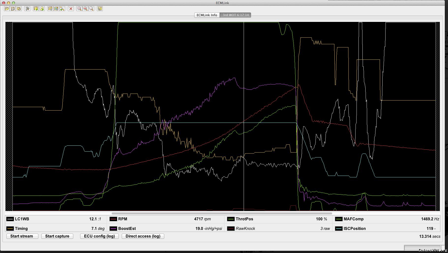

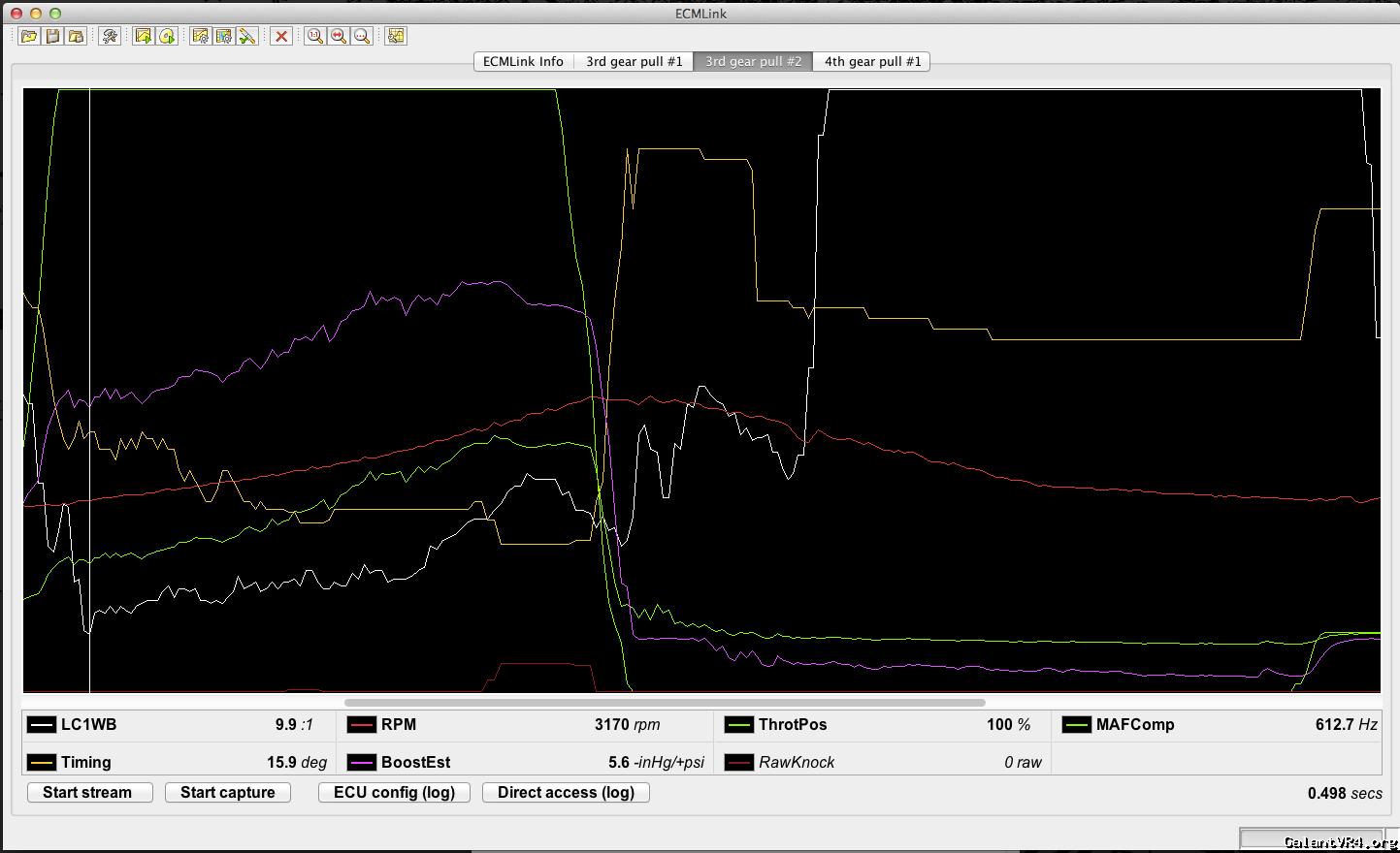

So I did 3 WOT pulls, and a partial throttle 2nd gear pull. Here's my cursory observations.
1. The boost est. seems accurate, even though my gauge is progressively resting clockwise of 0 (need a new gauge).
2. I seem to be running a bit lean between 300-500Hz on the MAF
3. I seem to be running SUPER rich at 670-730Hz on the MAF
4. I'm seeing knock at WOT when my max octane timing table hits 2.2/2.4 load @ 4500 rpms. This is the same for all 3 WOT pulls.

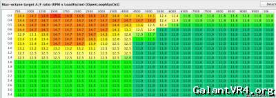

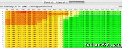

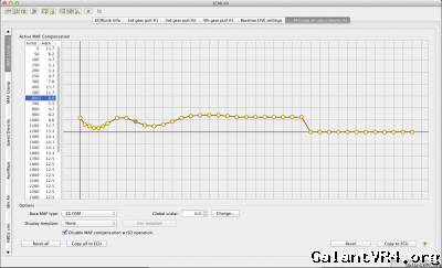

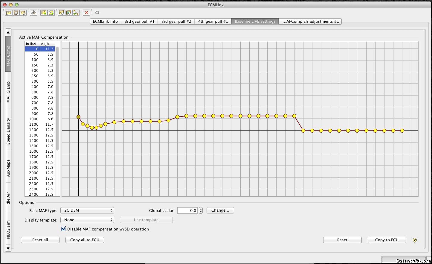

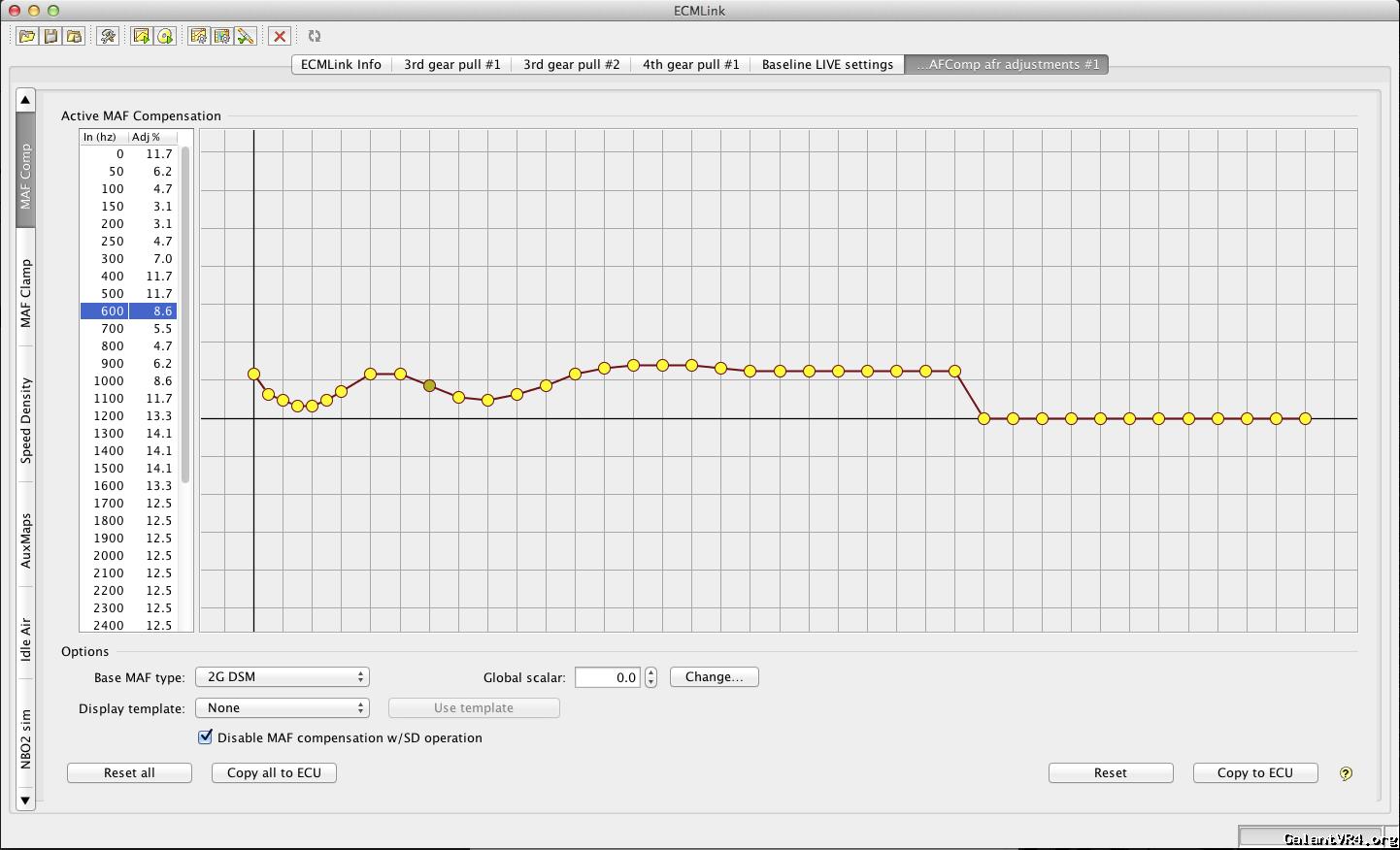

First, let's look at the problem I'm trying to solve. I've noticed that i'm running rich while building boost between 3000-3500 rpm's. I'm building up to about 10psi in this range.
I've noticed the MAFComp is between 600hz-800hz in each case, so I'm going to adjust my sliders from this:

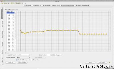

To this:
My goal here is to richen up the mixture a bit around 350hz - 500hz so that my AFR smooths out a bit, then lean it out a bit between 600hz-800hz.
I'll go cruise and make sure everything logs happy, then do some more pulls. Next is tweaking the direct access settings. Then onto the knock after that!

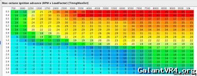

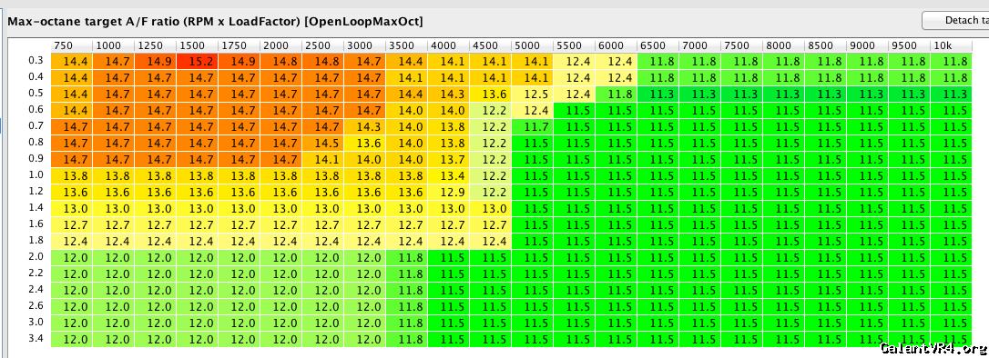

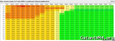

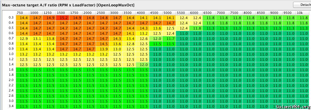

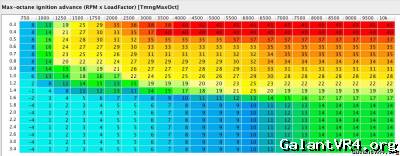

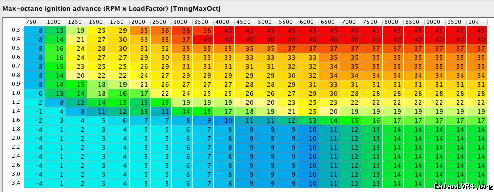

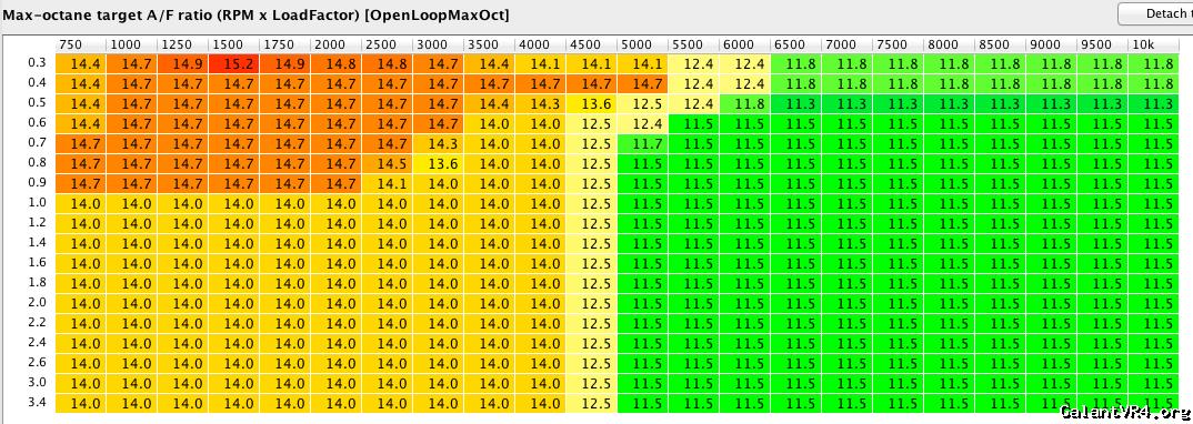

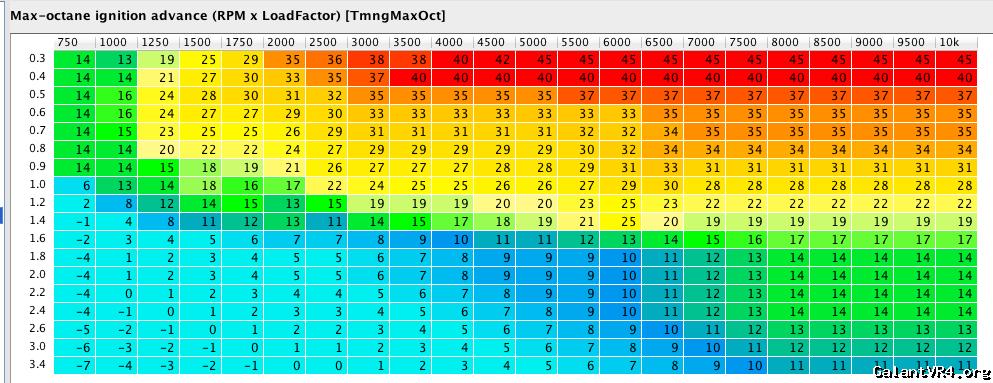

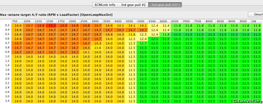

However, I do have an update of substance. I have an updated LIVE and DA file from the tuner w/ the proper fuel maps for my car and I did a pull today. Some noticeable differences. First, the DA Fuel and Timing tables are 100% different.
Old DA AFR table:
New DA AFR table:
Old DA Timing table:
New DA Timing table:
I backed the turbo off a bit and did a 3rd WOT pull and things felt MUCH better at the bottom-end. I'm spiking to about 23psi now, and settling around 20psi (before it was 26 and 23), and I'm still seeing a touch of knock along the RPM range, but things are much happier. Just a bit more tweaking and I think I'll be ready to rock.
