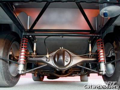

yea the APC EVO II is the way to go. the yellow car from Rob Barac.
utilizes a supra MA70 rear diff with a different ratio and custom axles.
thats what i am going to be using for my current project.
mrnvit
Oct 11, 2003
111
nz
robs yellow car *did* have a supra diff in it, im sure he said somewhere that it added weight to the car tho, but its now a full tube chassis rwd evo /ubbthreads/images/graemlins/jawdrop.gif

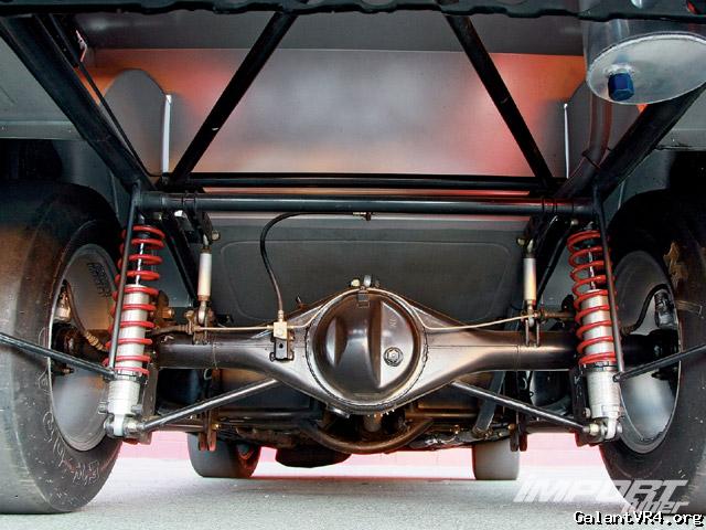

here you go buddy from the worlds fastest evo he uses toyota rear end but you can read the rest this may be a bit overkill but if its what you want go for it my friend
and here is a picture of it on the car and yes its still awd
and this is what it can do
