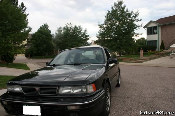

Yes, I will post some pictures of the car as well. I get to drive it on a dirt road for part of my way to work (it's a perfect rally place if I didn't have to worry about deer- haha).
I wish I would have saved all the stuff I had collected over the years from my old DSM friends and from my turbo mustang days. I know just how valuable these sights can be for information and learning...so I will spend much of my time reading and learning before I start doing much on my own.
Pics to come

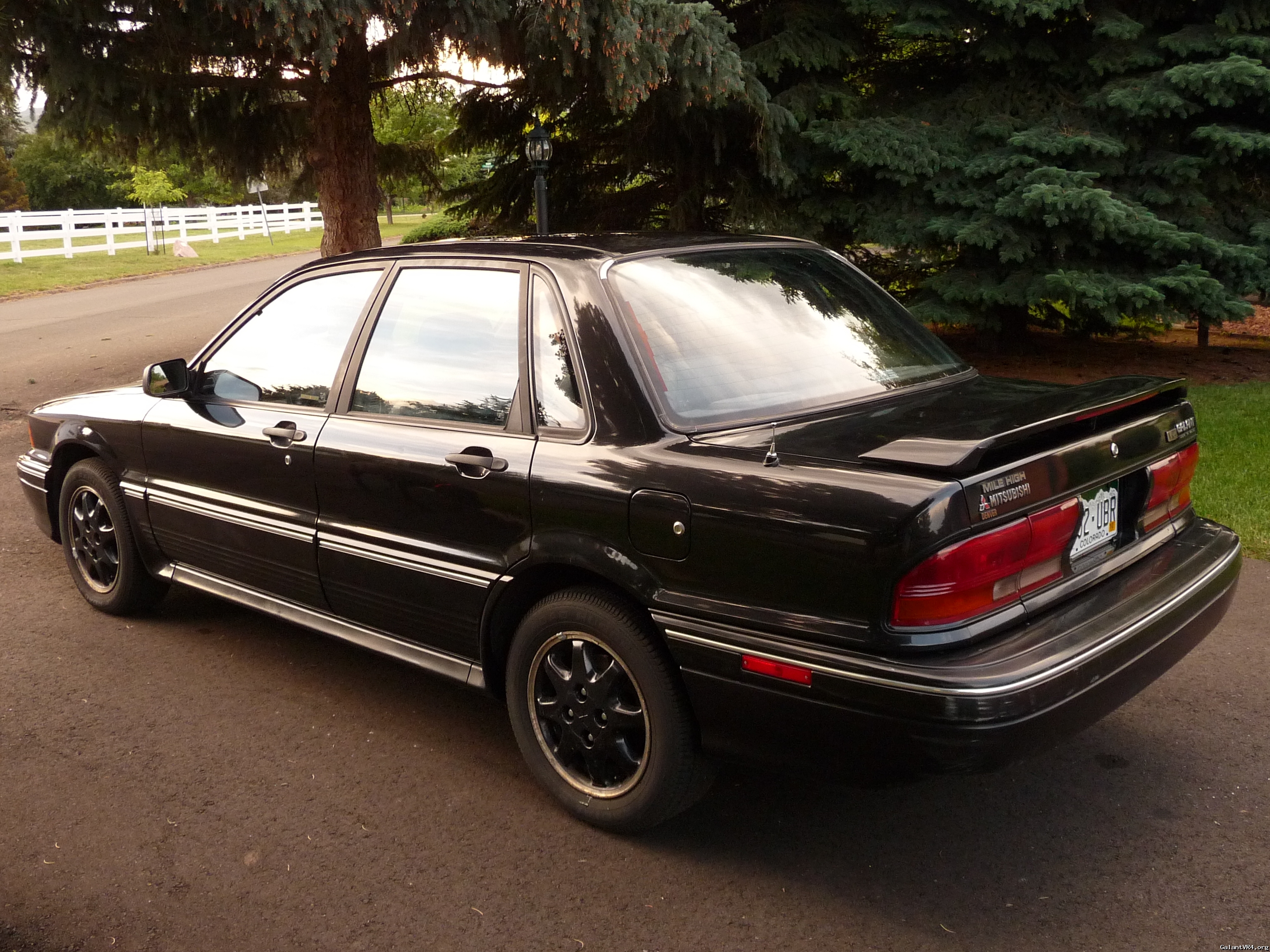

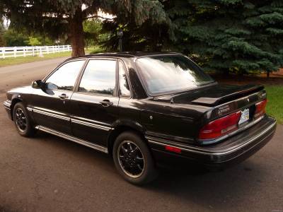

nice /ubbthreads/images/graemlins/laugh.gifi also am at 202k also and am in the springs thats a trip i only know of a few gvr4s here and i saw a new one i never saw that was a kingston grey and i wasnt drivin mine... mine also is a daily driver and does have similar problems... but i did go with a big 16g i recently installed and new ecu with a stage 1 i also have a 2.5 exhaust and i love it and want more but do want to take a good route with it.... maybe ill see you around
here is 583/1000 now black orig. color was green previons owner got a crappy paint job done on it
