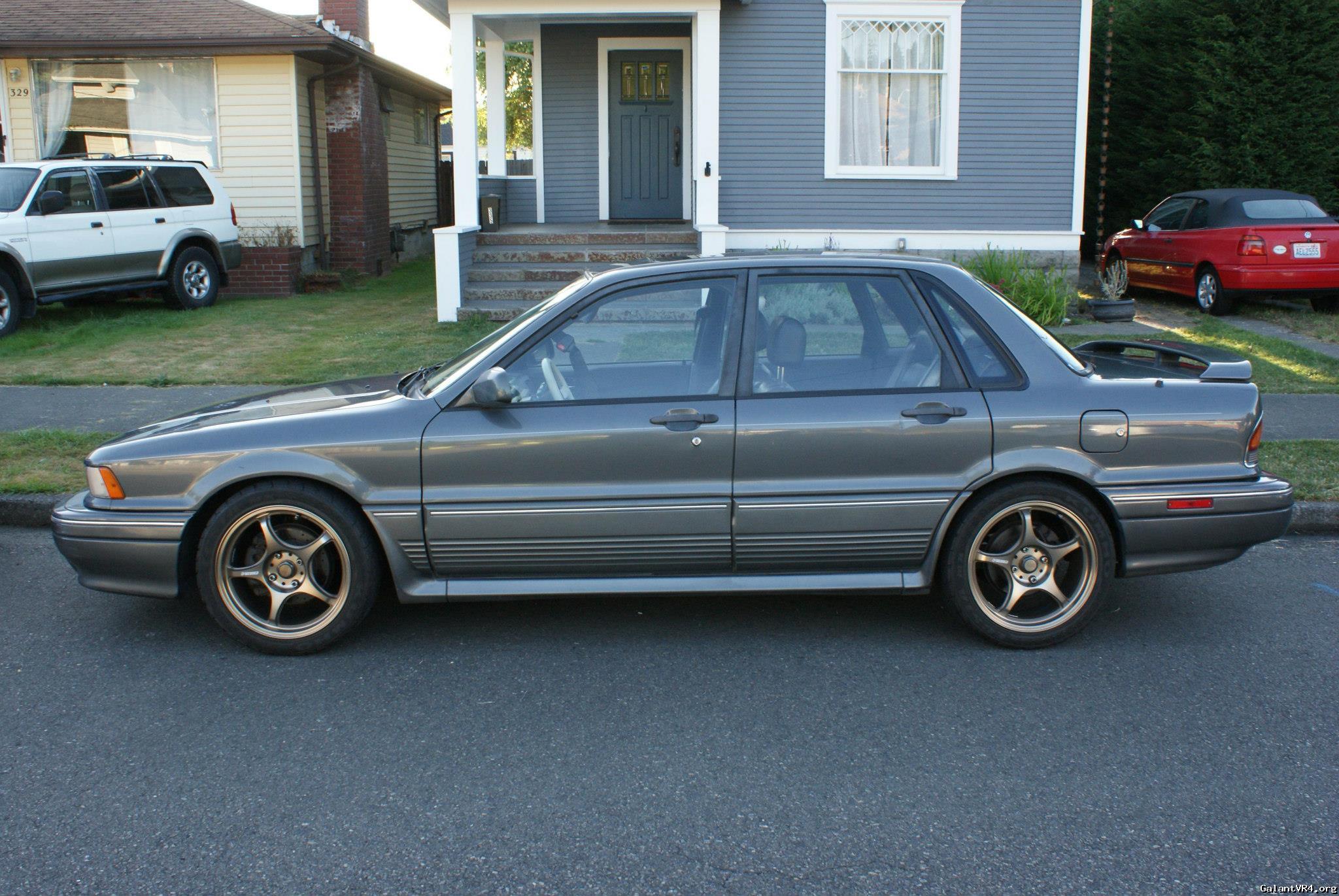

I actually drove the car to work today. /ubbthreads/images/graemlins/jawdrop.gif
Still need a few things. Fresh paint, minor body work, windshield, 91 tails, JDM hood and bumpers, BC coilovers, and need to get the cobra rotors now so i can put the 3k brakes on the front (i have the brackets and calipers already).

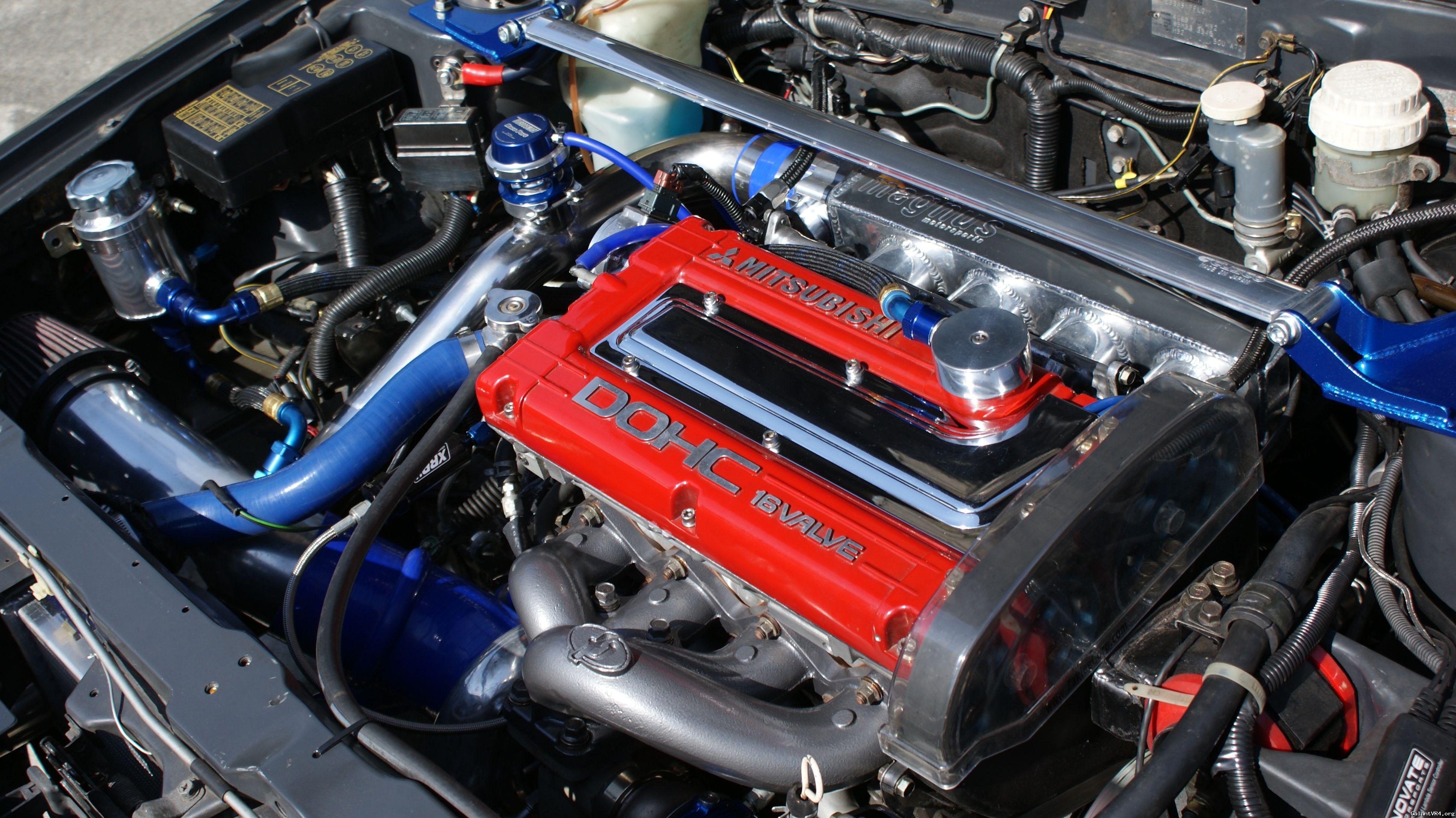

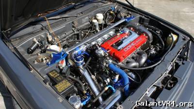

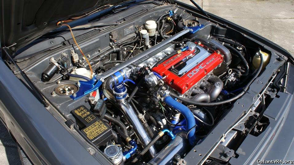

Winter upgrades are nearly complete. Just waiting on a few things. I hope to roll out to some sausage fest car meet on the 29th, but don't know if i'll make it. Here are a few of the goodies that should be buttoned up in the next week.
Magnus SMIM
New stainless cold side FMIC pipe with IAT bung and 50mm BOV flange
Turbosmart RacePort BOV
70mm throttle body
FIAV blockoff
external FIAV module
BC RM inverted ram Coilovers
Cusco front STB
Whiteline 22mm front swaybar
Whiteline 26mm rear swaybar
Moog end links front and rear
Rebuilt front LCAs with Energy bushings
TechnaFit stainless brake lines all around
Had the FP exh. manifold ceramic coated (original coating was sh*t)
New mani-turbine bolts/washers
New XRP 20 micron inline turbo oil filter and AN adaptor/fittings from head (no more banjo junk)
relocated the oil separator and replaced it because it had a leak
MAP CAS cover
I'll take some photos once it's all put back together. Until i get a new BMRS hose i can't mount the oil separator. I'm also waiting for bolts, washers, a gasket, rear swaybar end links and a JMF coil pack bracket before i can get it done. They should all be here from summit and extremepsi pretty soon.
