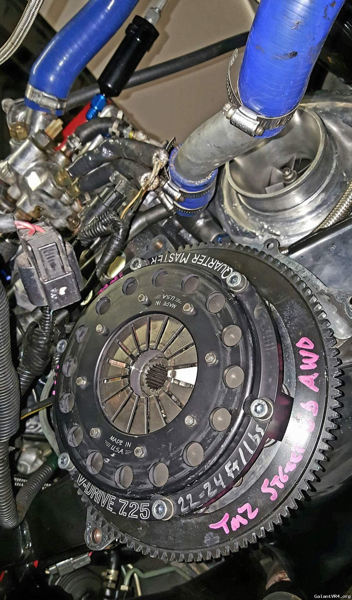

At least i was getting more consistent. I'm getting new tires this season which will help a lot.
Installing this seemed to help a bit as well.

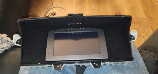

Just about finished installing the BTI 7" Touchscreen with Link G4 integration. I just need to sort out a couple of the LEDs not working properly. The CEL LED turns on when the key goes off, and keeps the ECU on. The low fuel indicator LED turns on with the key. Not sure why.
I plan on using the low fuel LED for a surge tank level drop indicator in the future. Whether i go with a fuel cell with integrated surge tank, or an external one. Since the wire is already there, it should make for easier connection.
The hi beam can be displayed in the touchscreen, but it was easier for me to tap into the gauge cluster and run my own LED since that circuit pulls to ground. The screen is looking for DC+ to indicate hi-beam. Brake warning indicator is run to the display, as are the turn signals.
Left to right LEDs are: 4ws (low fluid), low fuel, hi beam, CEL, door ajar.
