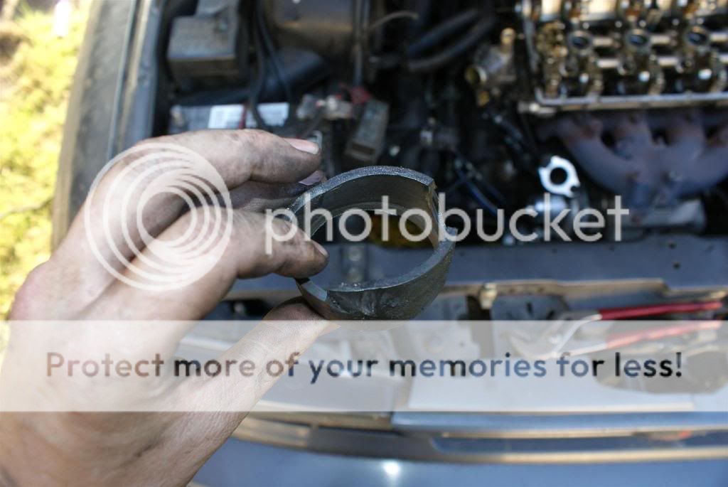

Look what i found whilst tearing the engine down today.
It's a good thing it wasn't running right from other causes, because some fucktard idiot did a piss poor turbo install.
I think we all know how this COULD have ended up....

Yeah, if you're running a 14b. E316g fits the stock intake pipe w/o this spacer.
It would have really sucked to pull this apart and find the evo3 to be shot because some assmonkey screwed up the install.

Man inspect the wheel and clean out the compressor housing and the IC pipes as well as the hot side of the IC. Those little pieces of rubber moving around can grenade a compressor wheel. I used a piece of those sh*t spectra hoses from Auto zone once as a spacer on a Garrett and it dried out and cooked and a piece got sucked in to the turbo and went boom.
