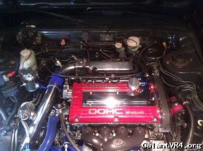

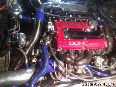

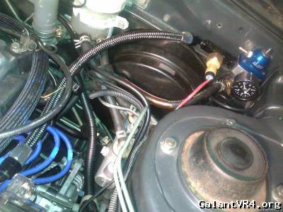

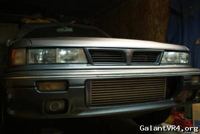

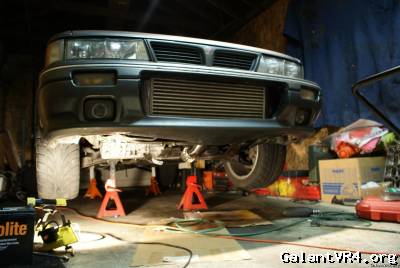

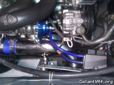

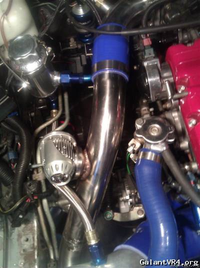

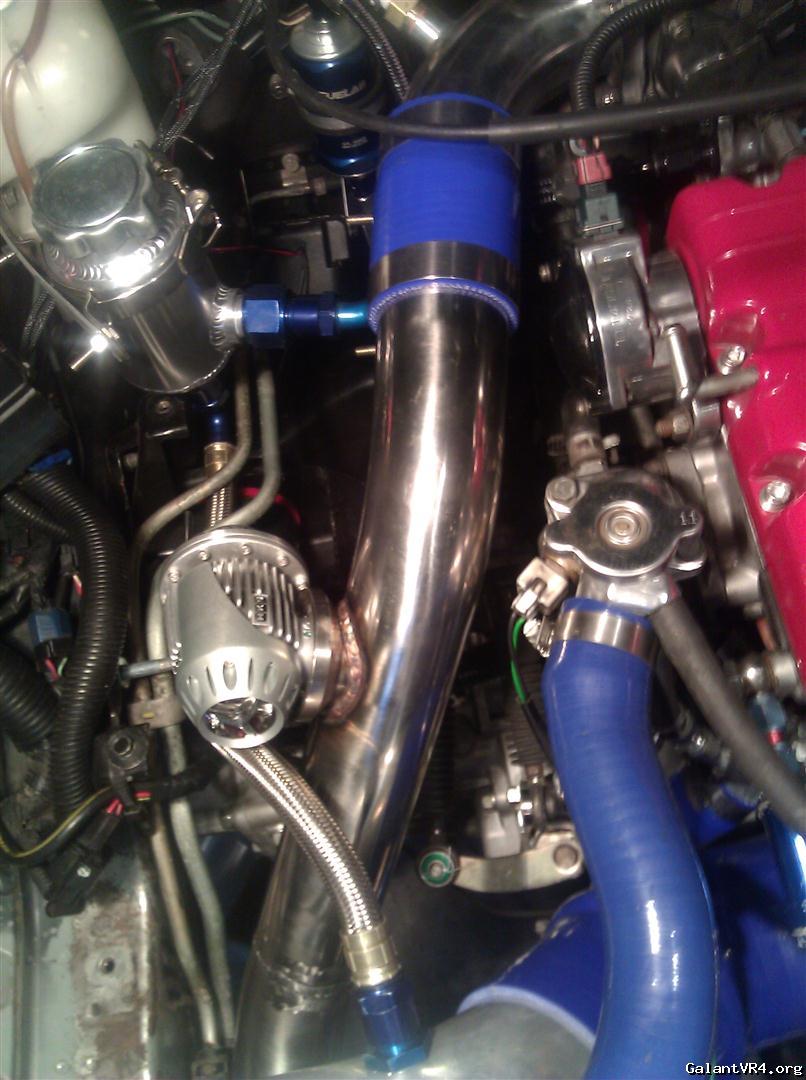

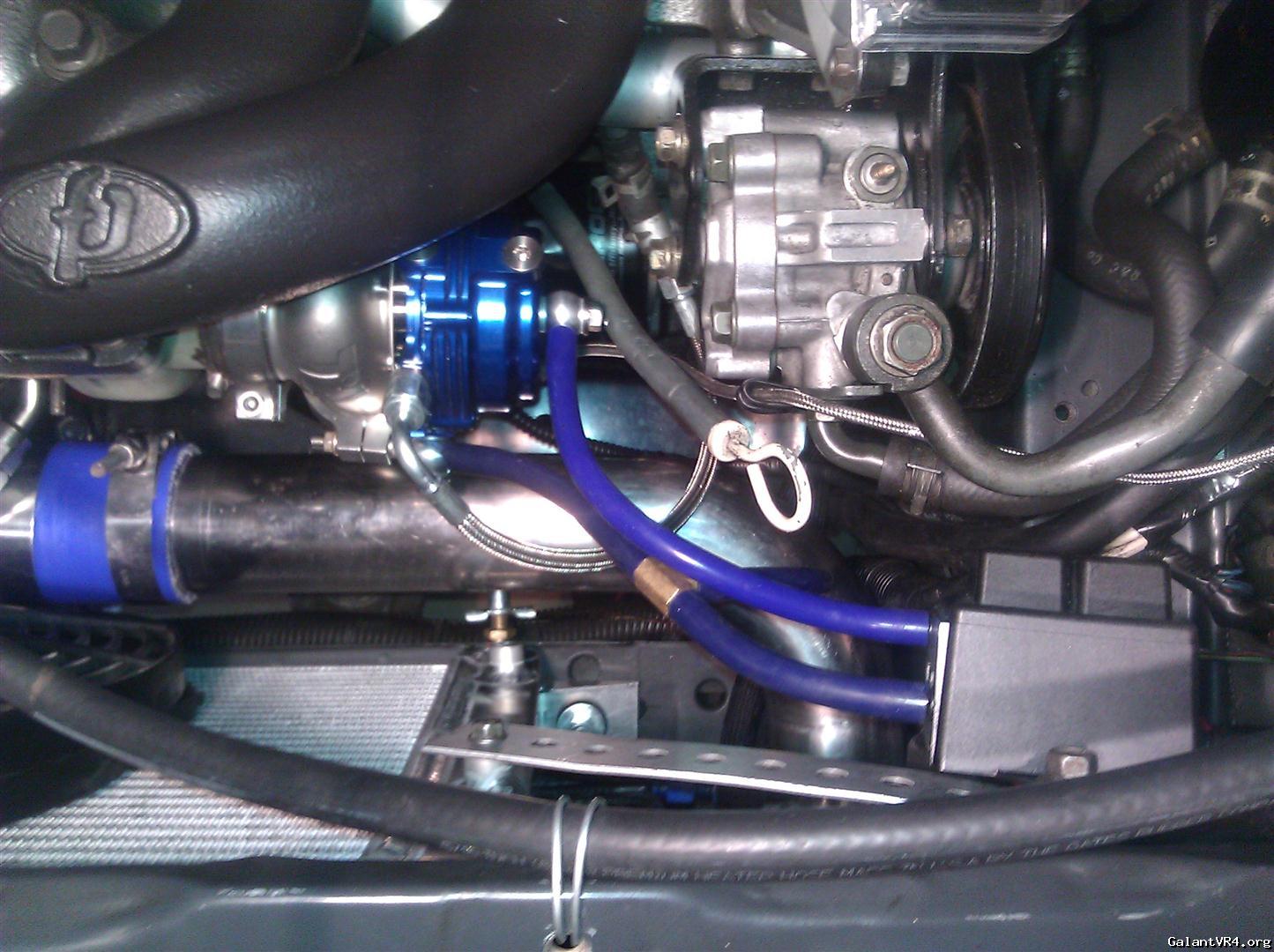

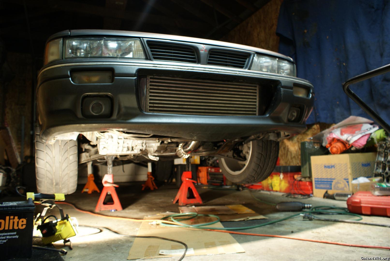

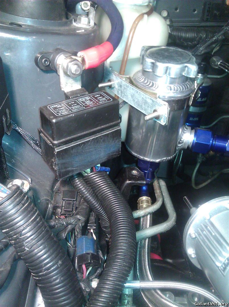

Finally clamped down the intercooler plumbing, the rad hoses, heater hoses. Just have some vacuum lines and wiring to do, now. Oh, and i'm rebuilding the exhaust. Once i get wheels and suspension, i should be rolling it out!

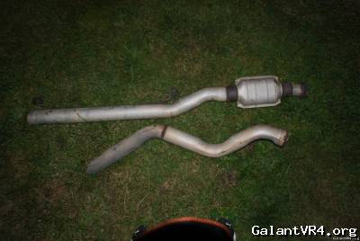

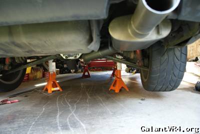

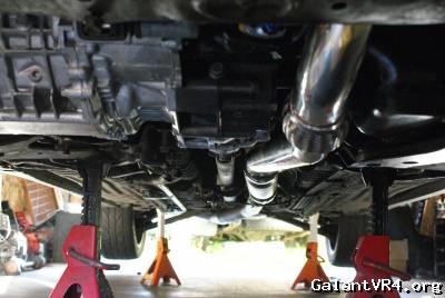

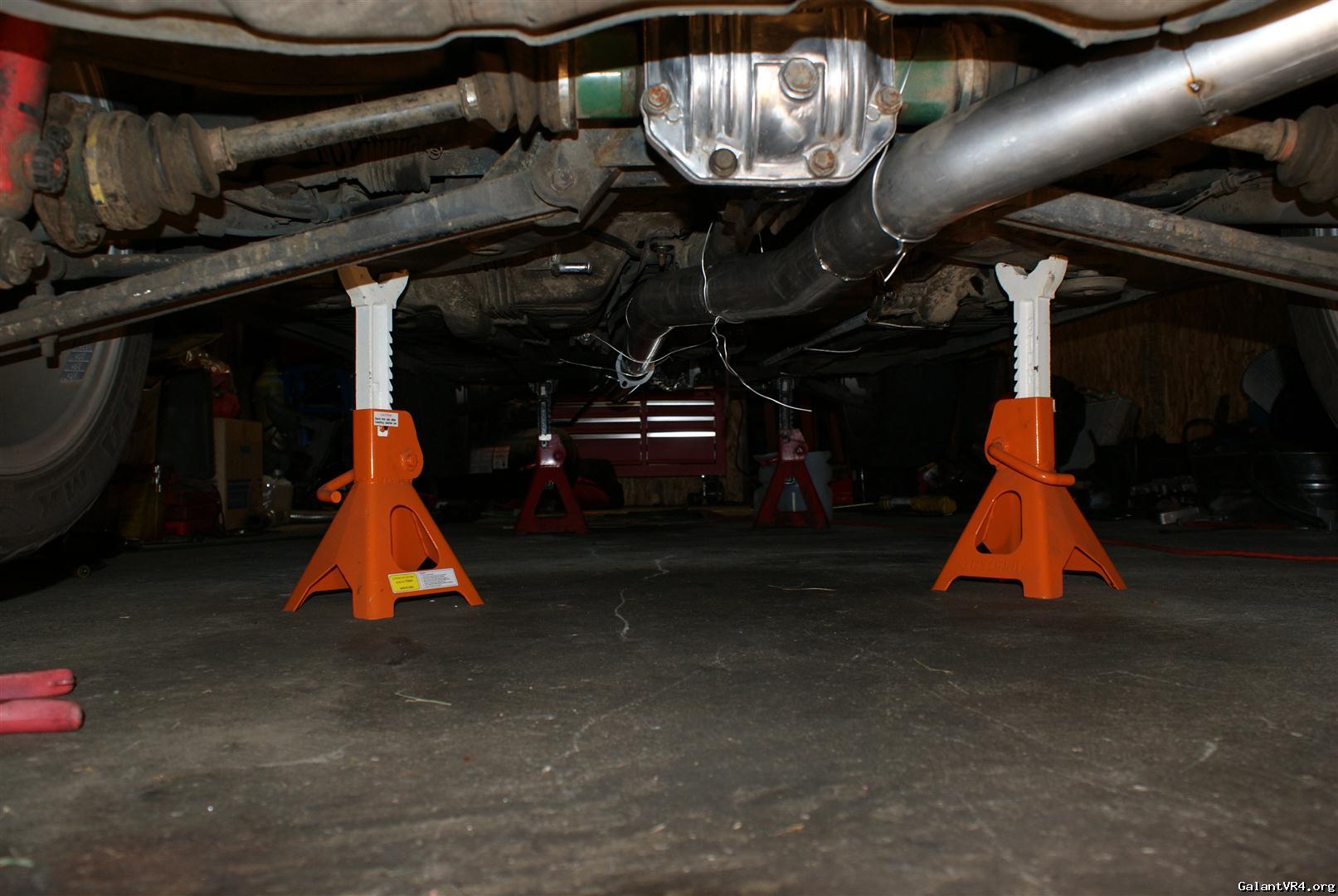

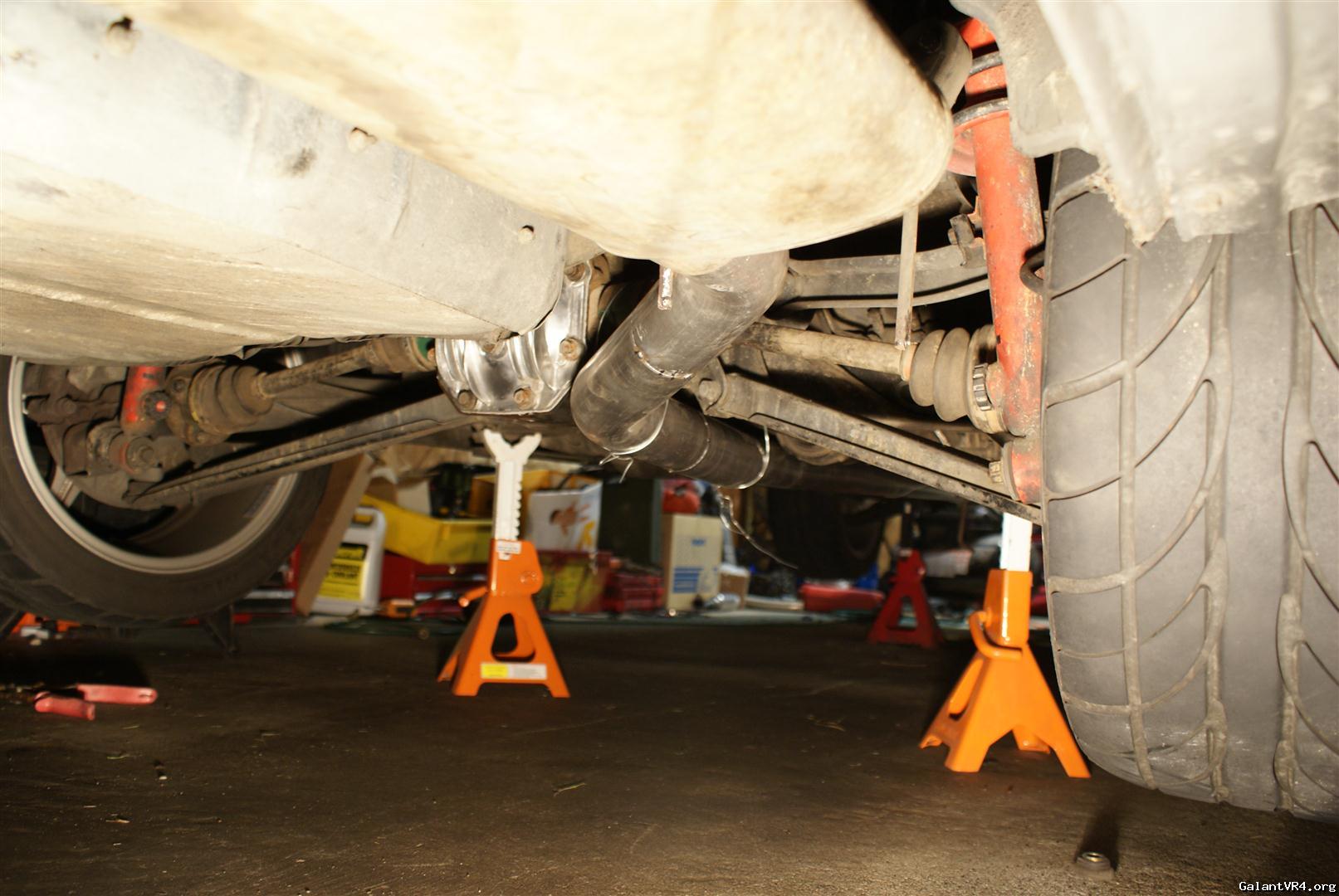

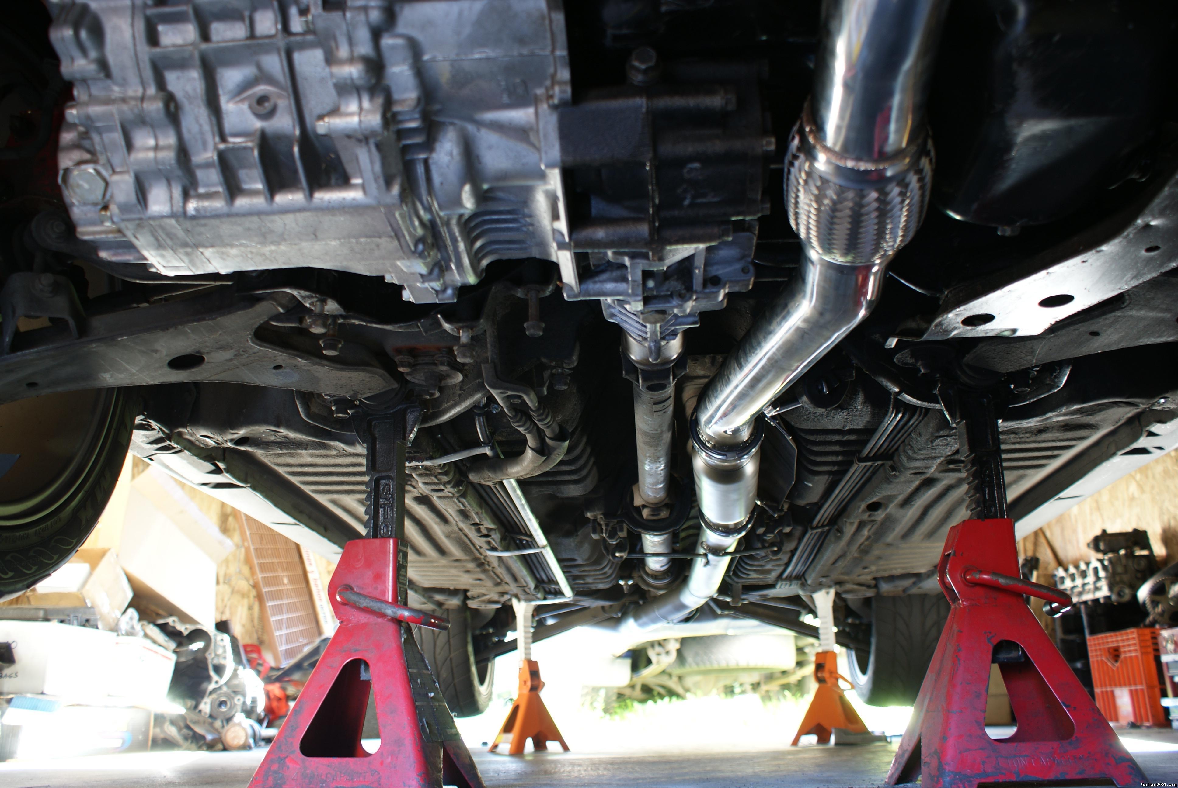

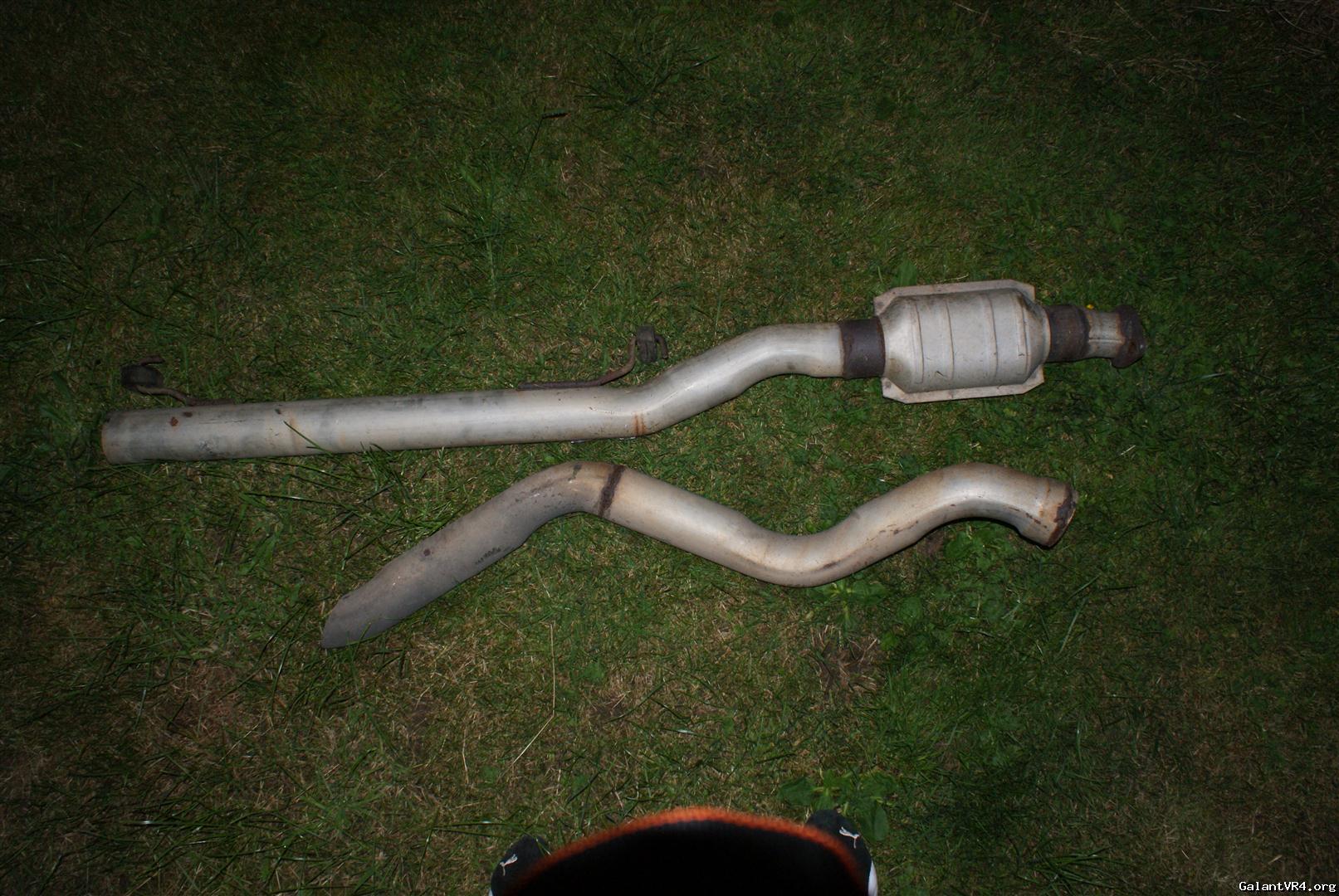

I didn't like the press bent 3" exhaust the car had when i got it. So, i built another one with 3" aluminized mandrel bends from Columbia River Mandrel Bending. (mandrel-bends.com)
Awesome place to order from. I spent about $25 more than i needed to because i wanted to make sure i had enough supplies in one order. They had my order at my doorstep the next day when i got home from work! $99 for four 45's, 4ft of straight, and 2 18 degree bends. I wound up using two 18's to go under the driveshaft, and 2 45's to go from the diff to muffler. Now i just have to get it hung properly, and weld it all together properly.

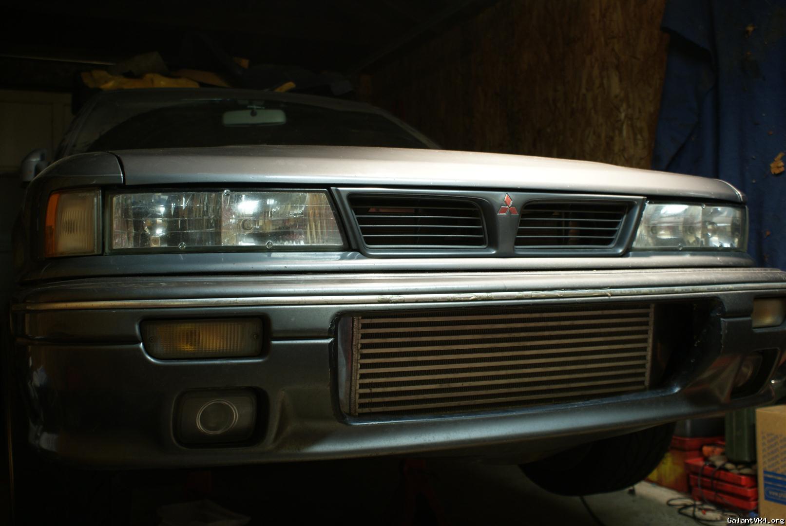

I also got the front bumper put back on. It doesn't look the greatest, but i hope to someday replace it with a JDM one anyhow.

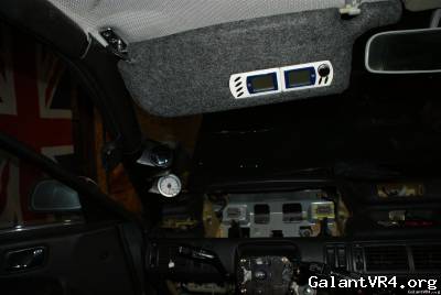

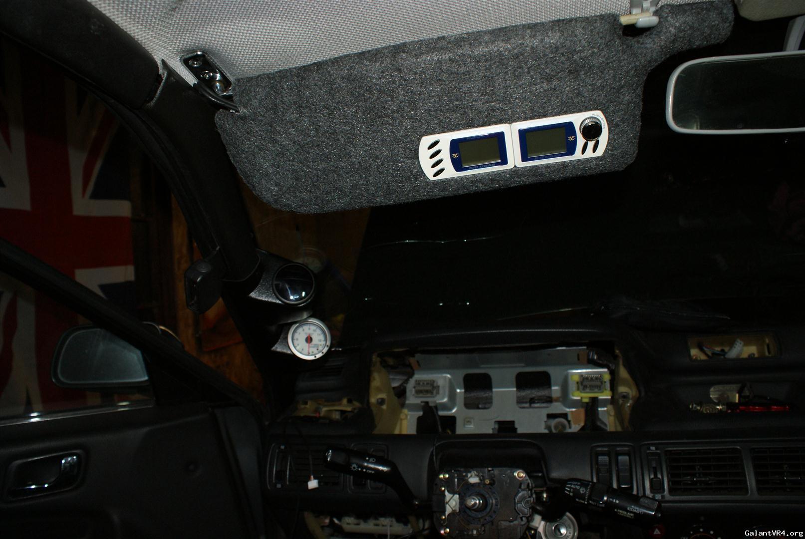

First time i've been in here...nice work man. I love the visor mounted electronics. Very stealth.

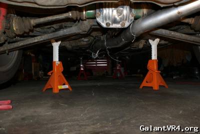

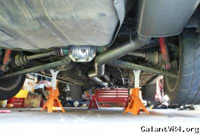

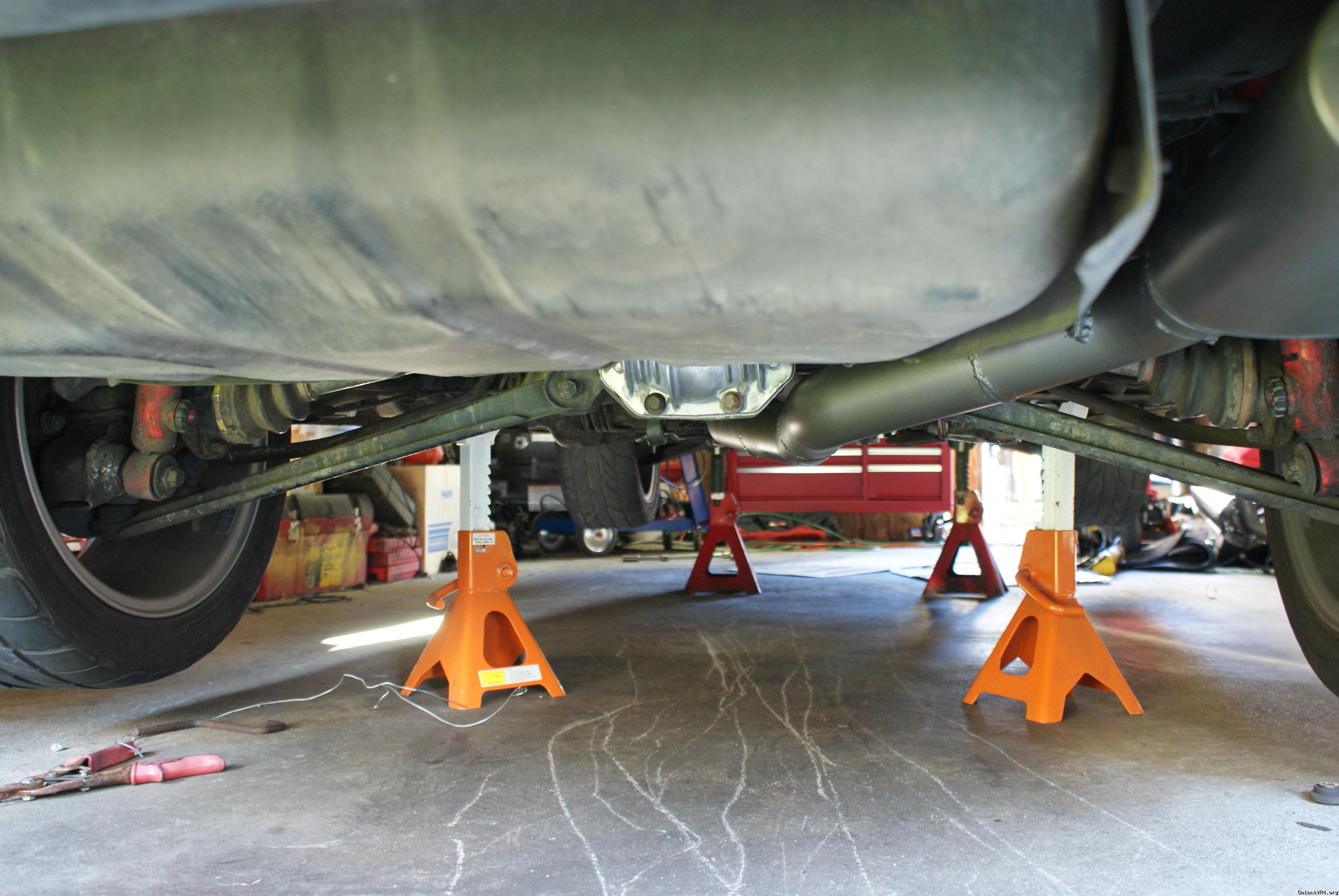

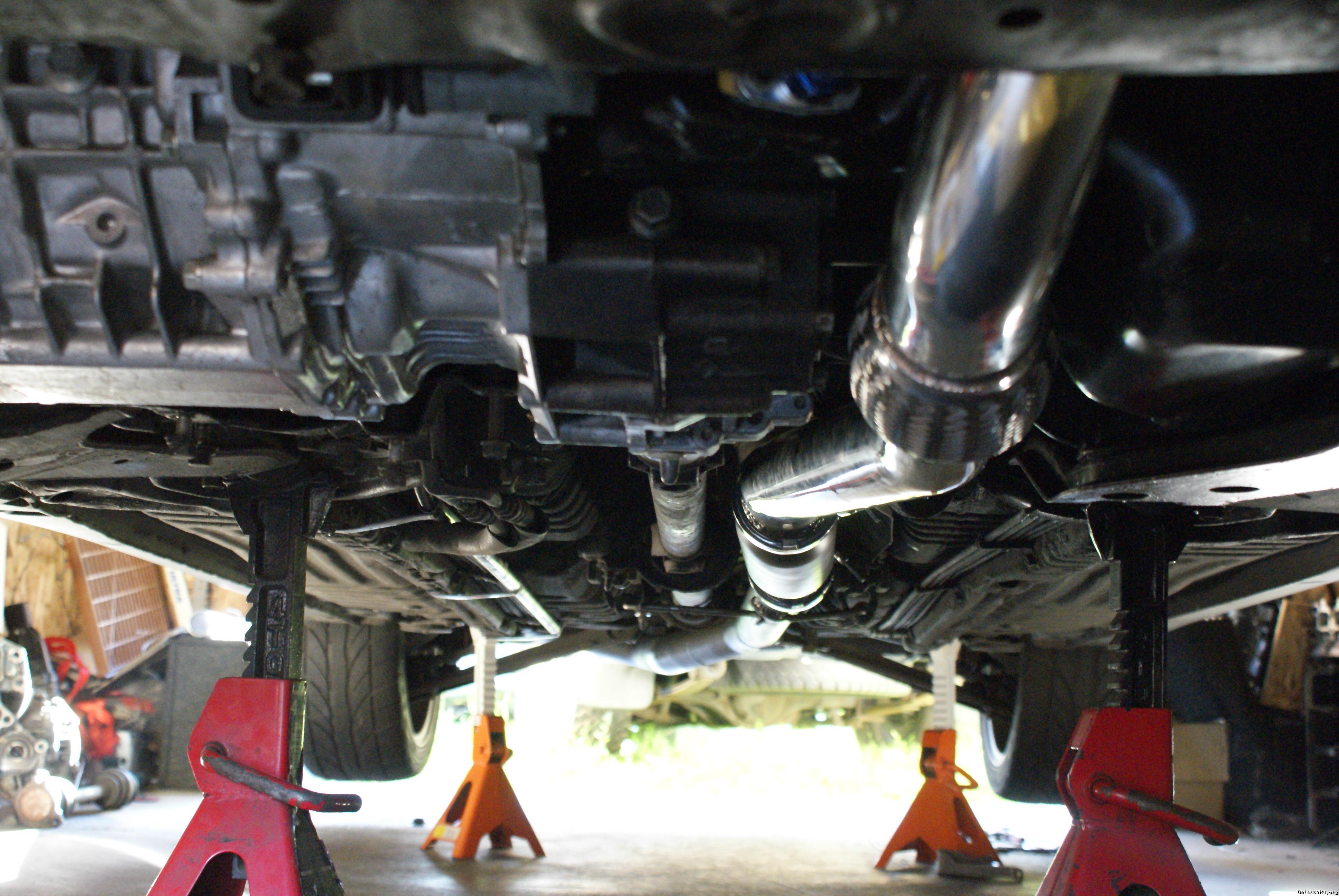

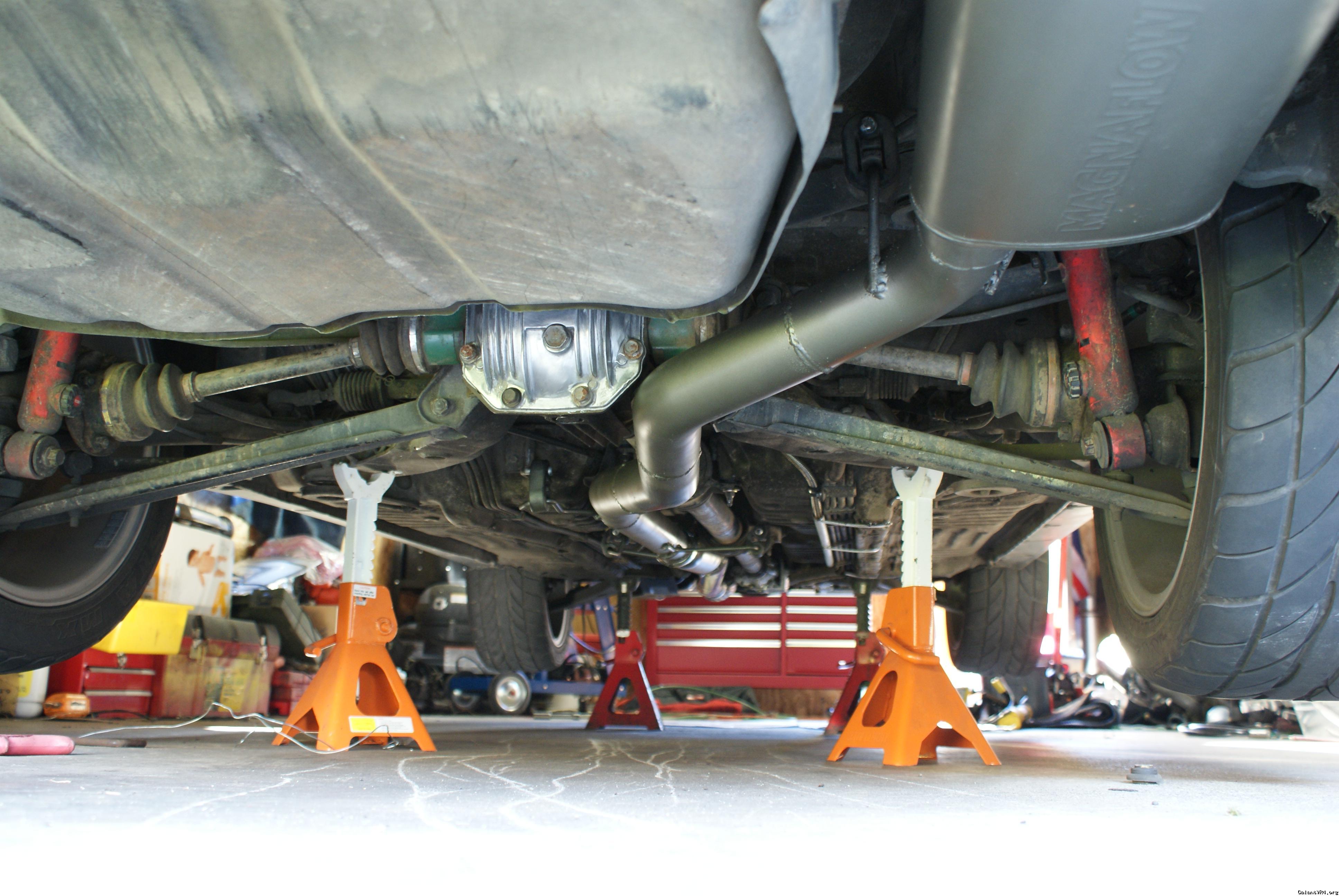

I Finally finished building a new exhaust.

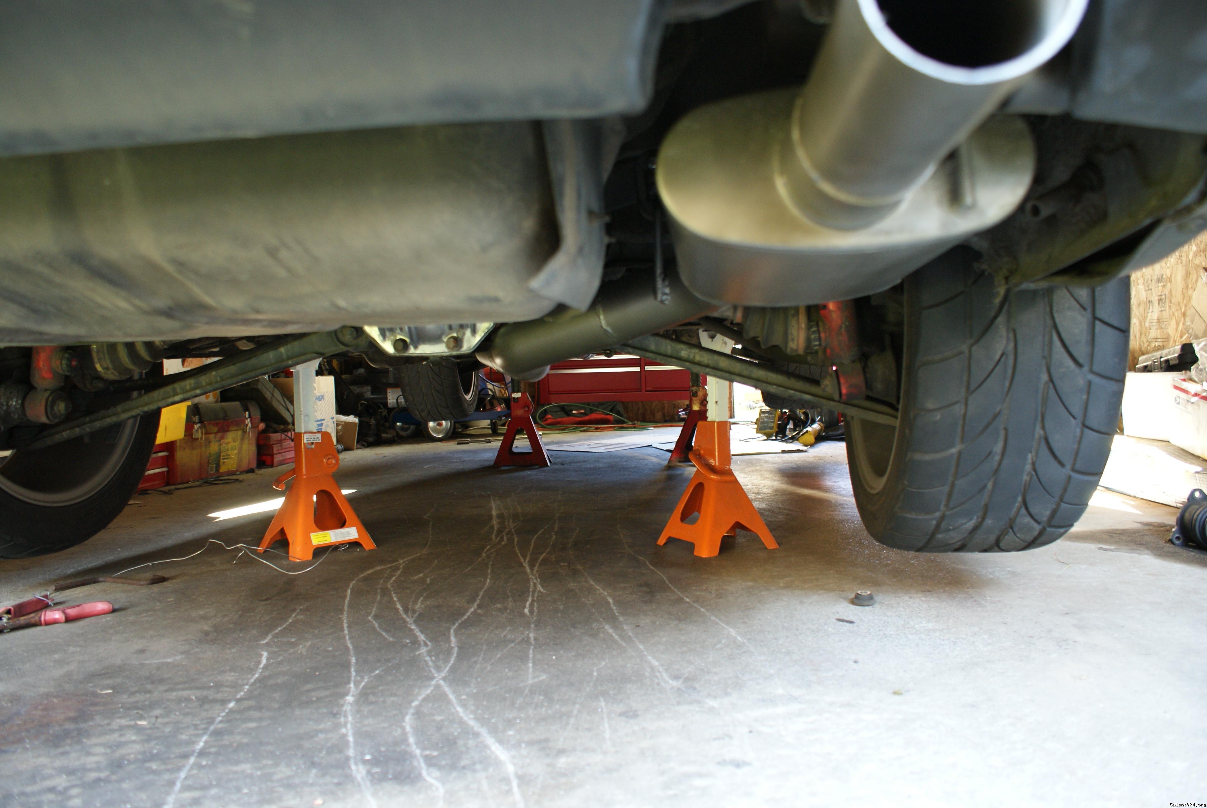

How's it look, guys? I think i managed to tuck it up under there pretty far, and it won't bang around on anything or rub the shaft. <img src="/ubbthreads/images/graemlins/hsugh.gif" alt="" />
I'm not awesome at welding, but this thing isn't going to leak or fall apart. I welded in stainless V-bands where i can put a cat if i need to. I've a cat lying off to the side, with the flanges already welded on, and I've test fit it. IDK if that resonator, or "bullet muffler" will quiet it down any, but at least it makes for a good 'test pipe'.
The exhaust is 3" mandrel bent, all the way back. Typically i see 2 45° angles used to go under the driveshaft, and 2 more 45's to connect to the muffler. I managed to do it with 2 18° bends under the driveshaft, and 2 45° bends to get to the muffler. I figured less bend = less restriction. <img src="/ubbthreads/images/graemlins/dunno.gif" alt="" />

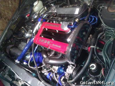

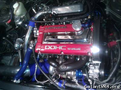

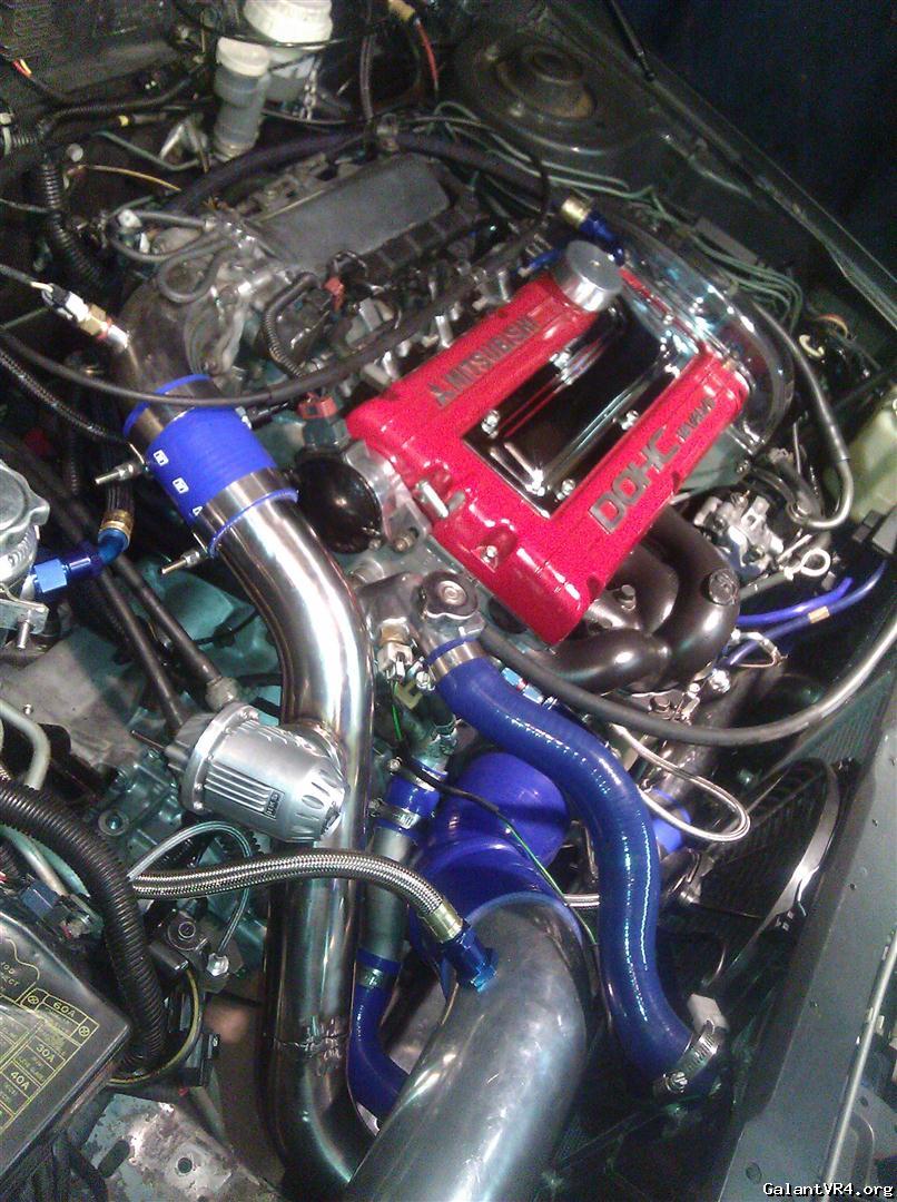

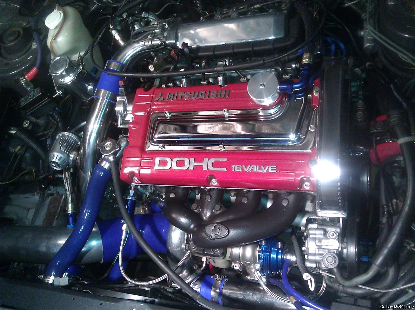

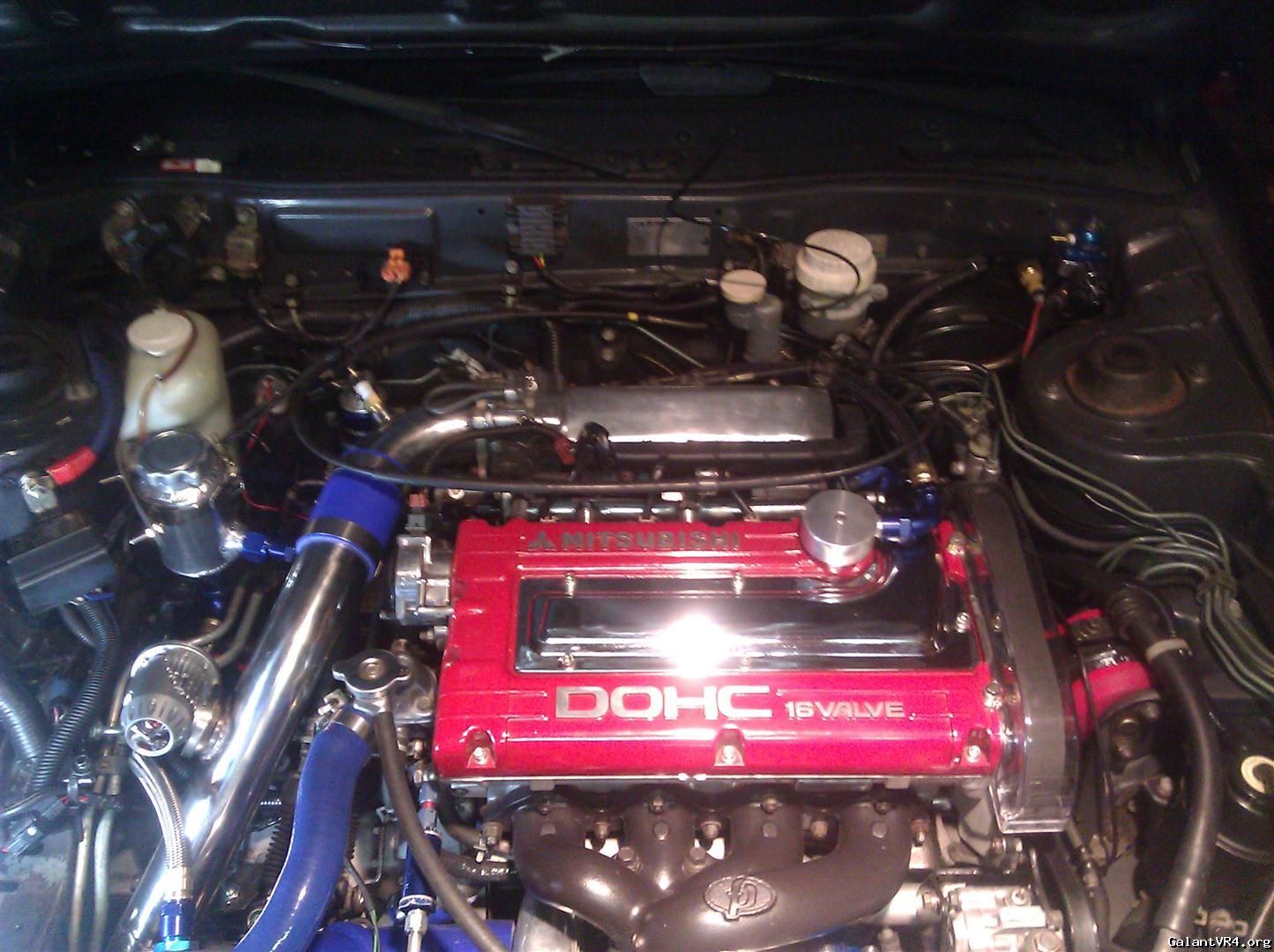

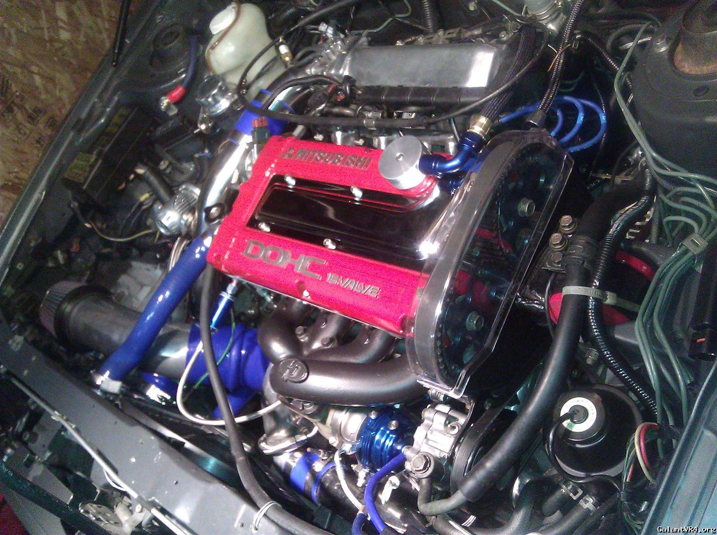

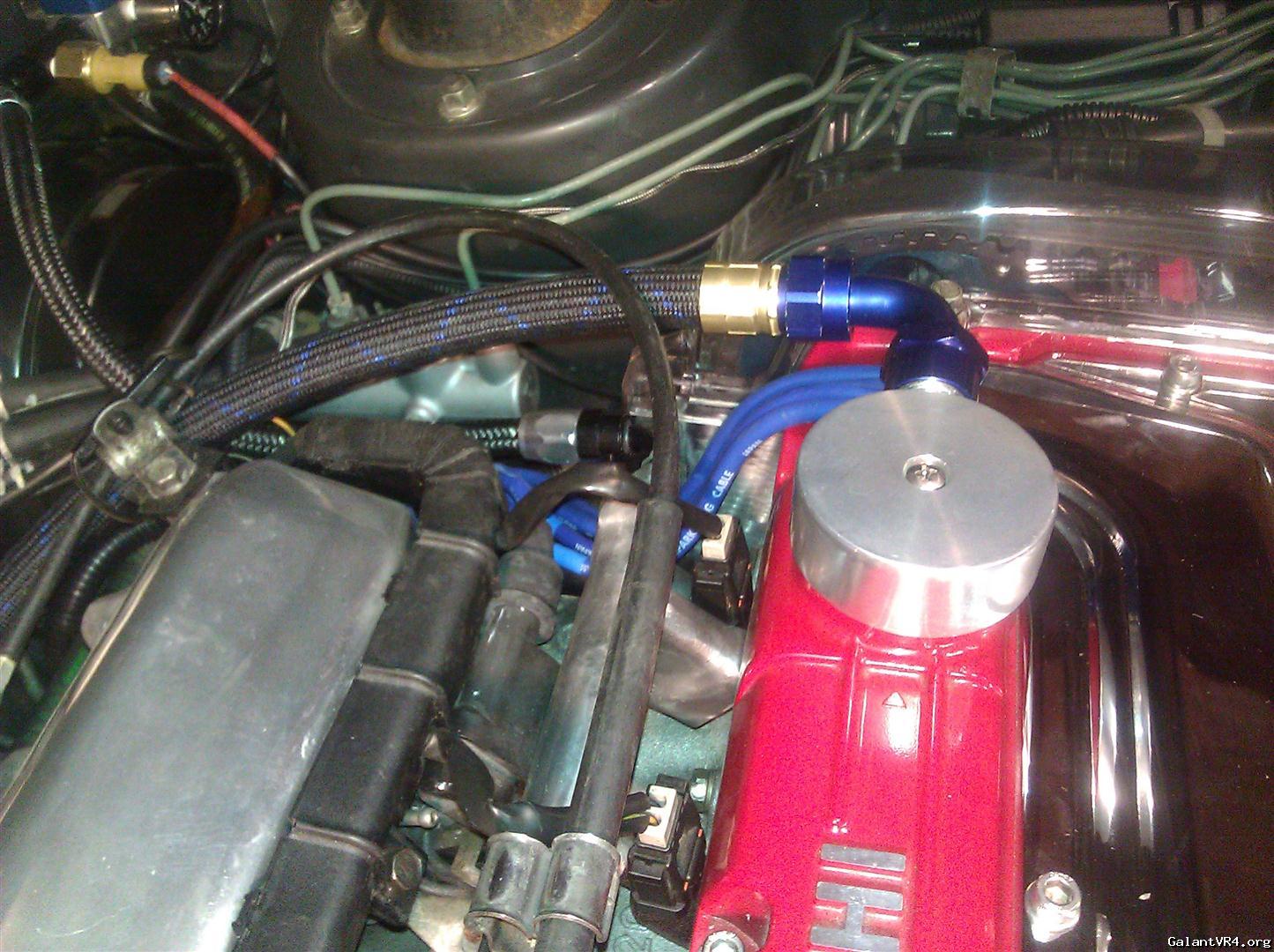

Wednesday night i actually started the car and ran it for a minute or two. I haven't put any coolant/water in it yet, but it doesn't appear to be leaking any oil. That's a good start!
It started right up, but then wanted to die. I didn't bother checking Link, because i thought it was all set up on the old car for 1000cc injectors and GM MAF. Well, funny thing is... I dont remember changing anything, but when i checked, it was apparently set for 450's and a stock MAF. Timing and Fuel maps were the same as before, though. So, once i figured out it was flooded as hell, and after a backfire that scared the living sh*t out of my neighbors, i pulled the plugs and cranked it over a bit with the resistor pack and coilpack unplugged (so no fuel or spark). Then i dove into Link, and found my version of V3 was so old, there was no SD option present. I had to update firmware, and my software. Apparently i bought V3 when it FIRST came out and it didnt have the options i needed to be utilizing built-in yet. Once i got the fuel and airflow monitoring set up, it started right away and idled!
I revved it a little bit, but nothing too crazy. I got it somewhat warm, but not up to operating temp. I still want to rewire a couple things in the cabin. Need to clean up the back seat and put it in, clean up the interior (doors and rear deck), and set up some vac lines. When i started it, the BOV wasn't hooked up yet. Once everything else is done, i'll fill it with coolant, and go over pretty much every nut and bolt ONE MORE TIME... then maybe take it for a drive and break the engine in the way it should be!
