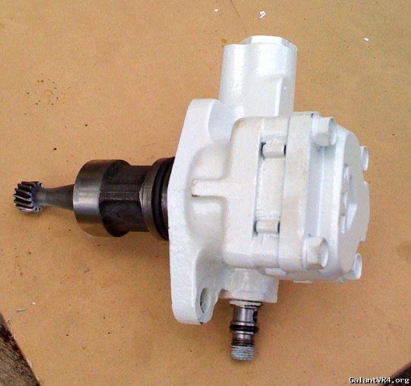

what about the pump on the rear end? when i pulled the 4ws off 713, noticed there's an auxillary pump that runs off the rear end. it's bolted to the pumkin on the rear end. if there's no fluid being run thru it, will the pump burn up? i just went and swaped pumkins but so can post pics of the pump if people don't know what i'm talking about.

If anything the 4ws pump is hydraulically driven, there is no electrical power to it, just valves, so with no fluid it wouldn't function at all.

I'm either reading this wrong, or you are incorrect. The rear pump has a gear that goes into the rearend, so it is still "functioning" no matter whether the fluid is there or not.
I'm not sure what affect it will have, as it may just be a return pump, or booster, but I'd think if there is still fluid in the lines, and the front pump is not active, the rear will just be fighting against the pressure in the lines. Without fluid, maybe it gets a little warmer, and may sieze, but I don't imagine it would be a "lock up the rear" type of catastrophe. Correct me if I'm wrong.

I may be incorrect, as the threads I've read before, it was said the pump was just pivoted on the top of the pumpkin, didn't know there was any sort of sprocket on the bottom of the pump. Do think you are correct that it wouldn't cause any sort of "Lock up the rear end", I just swapped out my rear diff a few months ago for a LSD rear diff, and had been driving with the 4ws pump still intact for over a year with no fluid. the 4WS rear pump and powersteering front rack were the only remains of any 4WS system.

No, I don't think it would. IIRC, the other gear is plastic, so it would just sheer if the pump locked up. I'm not in any way saying it would cause danger,, lots of guys have done it and you never hear of issues. /ubbthreads/images/graemlins/wink.gif

Even if the drive and driven gear are metal they have small teeth and I would see either the gears stripping out or the shaft would break. It's not as beefy as the differential. Only real issue is that it could send pieces into the diff and that could screw it up. Like mentioned before though, no one has had any issues yet.
