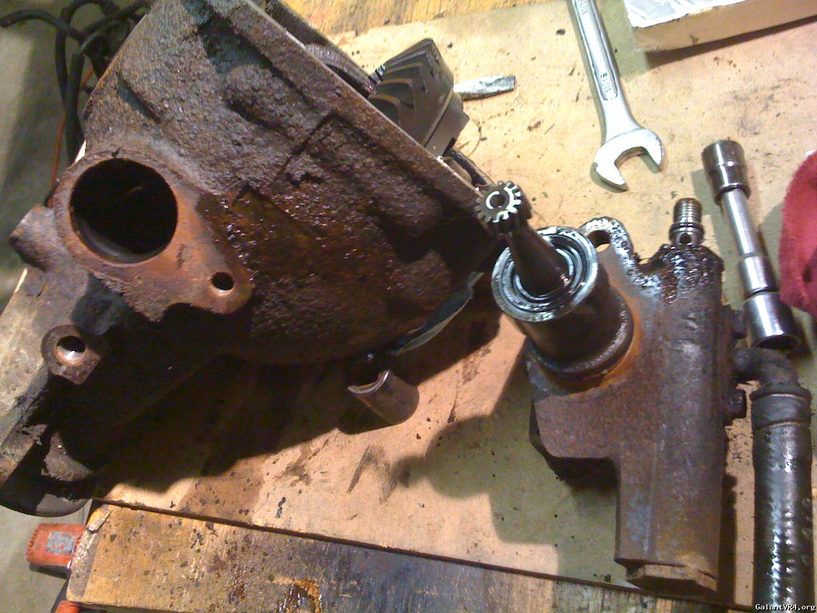

Here is a pic of where the plug would go he's talking about.
He's saying just pull that pump, and put the plug in the hole. As long as you can find one to fit, there should be no issue to that. Cleaner too.
