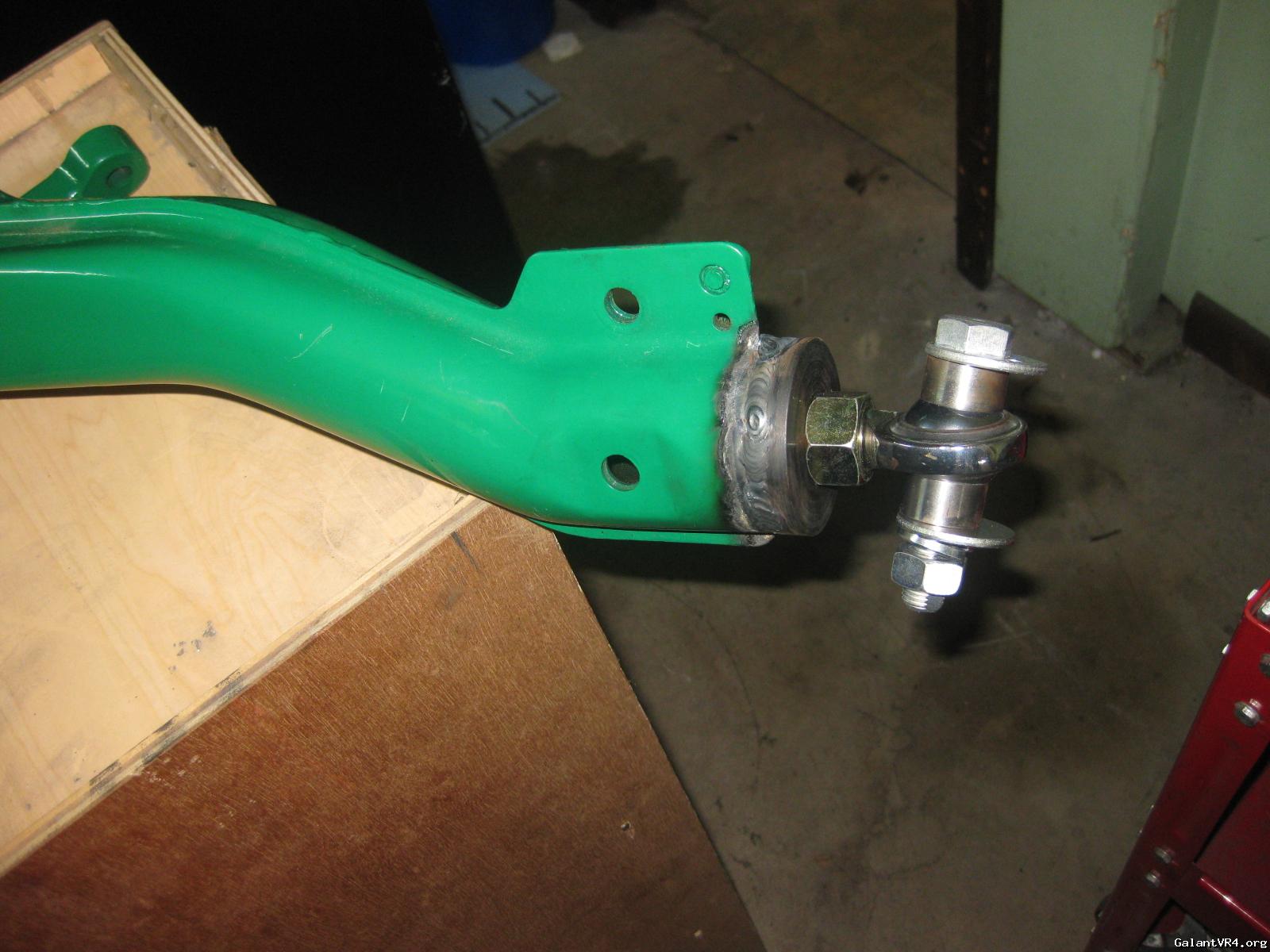

when removing the rear steering rack what if anything do i put in its place. on 3s cars they have an adjustable arm to replace it. click here does it make sense to have these on the gvr4?

oh ok i have a dsm rear and i have the weld in adjustable bushings. so there is no need or use for the arms.
asked and answered

Whats to be gained by adding that delete kit?
11,982
Most people just pull the rear rack and call it good. Then it's identical to the DSM rear setup. Mine has been like this for years.
I've never seen those little arms for the 3s. Those are pretty sweet. I always wanted to weld the rear solid but it seemed a pain in the ass. I might have to try these out instead.

I wonder if this would tighten up the rear end much.
Im on a mission to make this car handle as well as possible with only being mildly offense to passengers.
Im not on a mission to send my passengers head into the ceiling... like some... Brian...
11,982
Those shouldn't do anything other than eliminate the passive rear toe while steering. I don't think passengers will feel it. /ubbthreads/images/graemlins/rofl.gif
