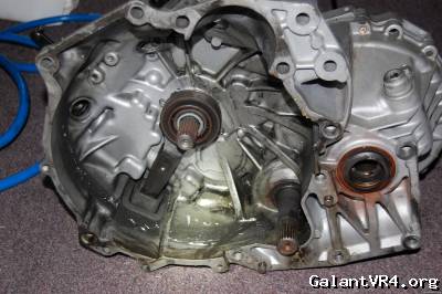

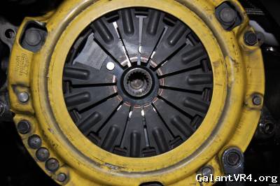

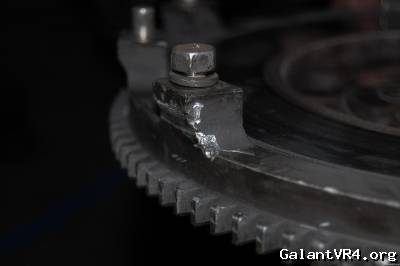

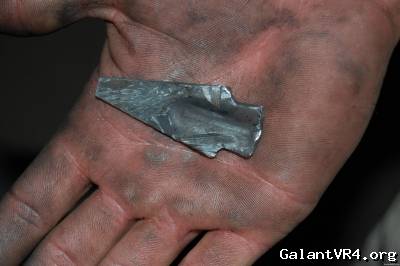

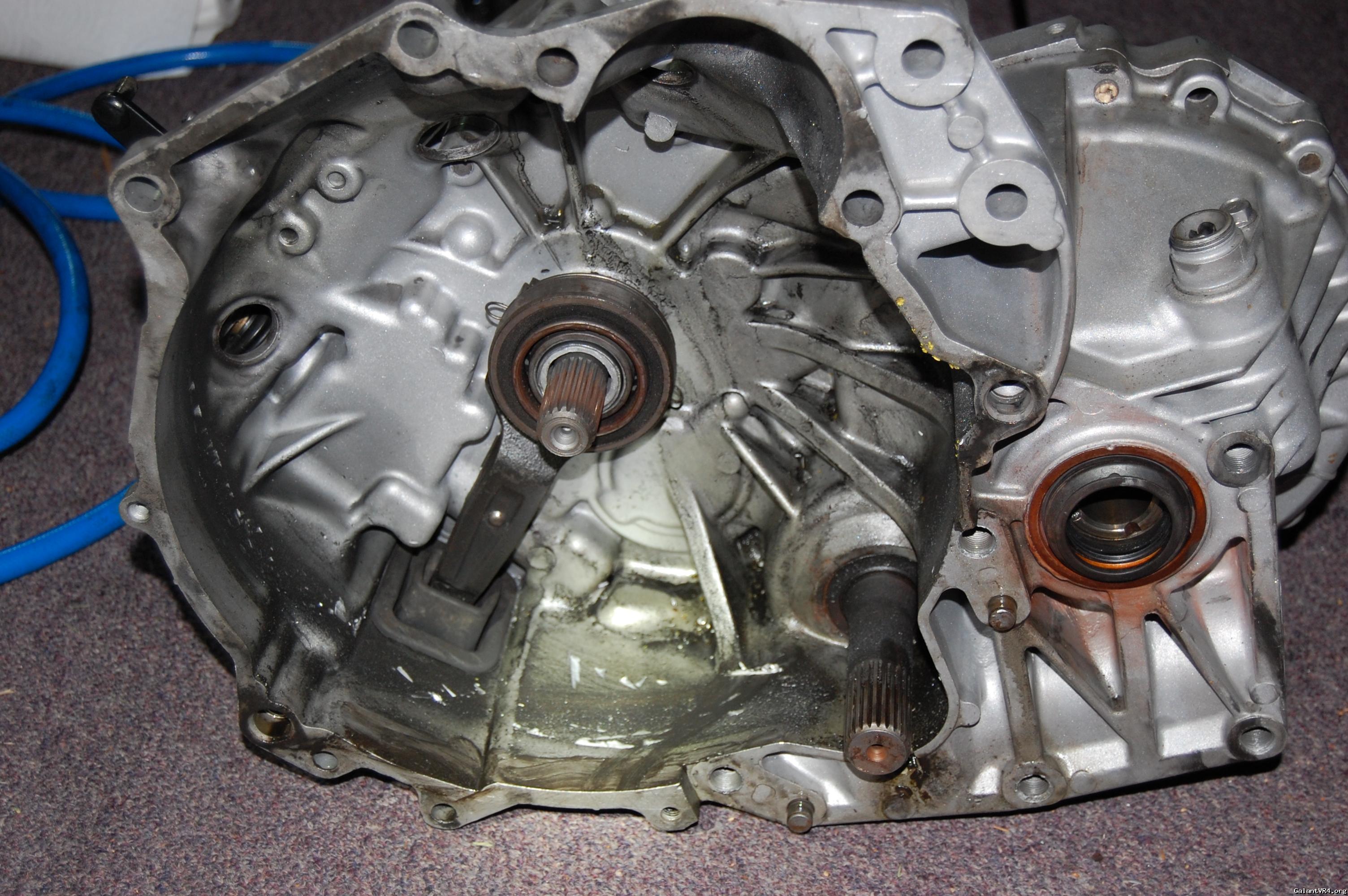

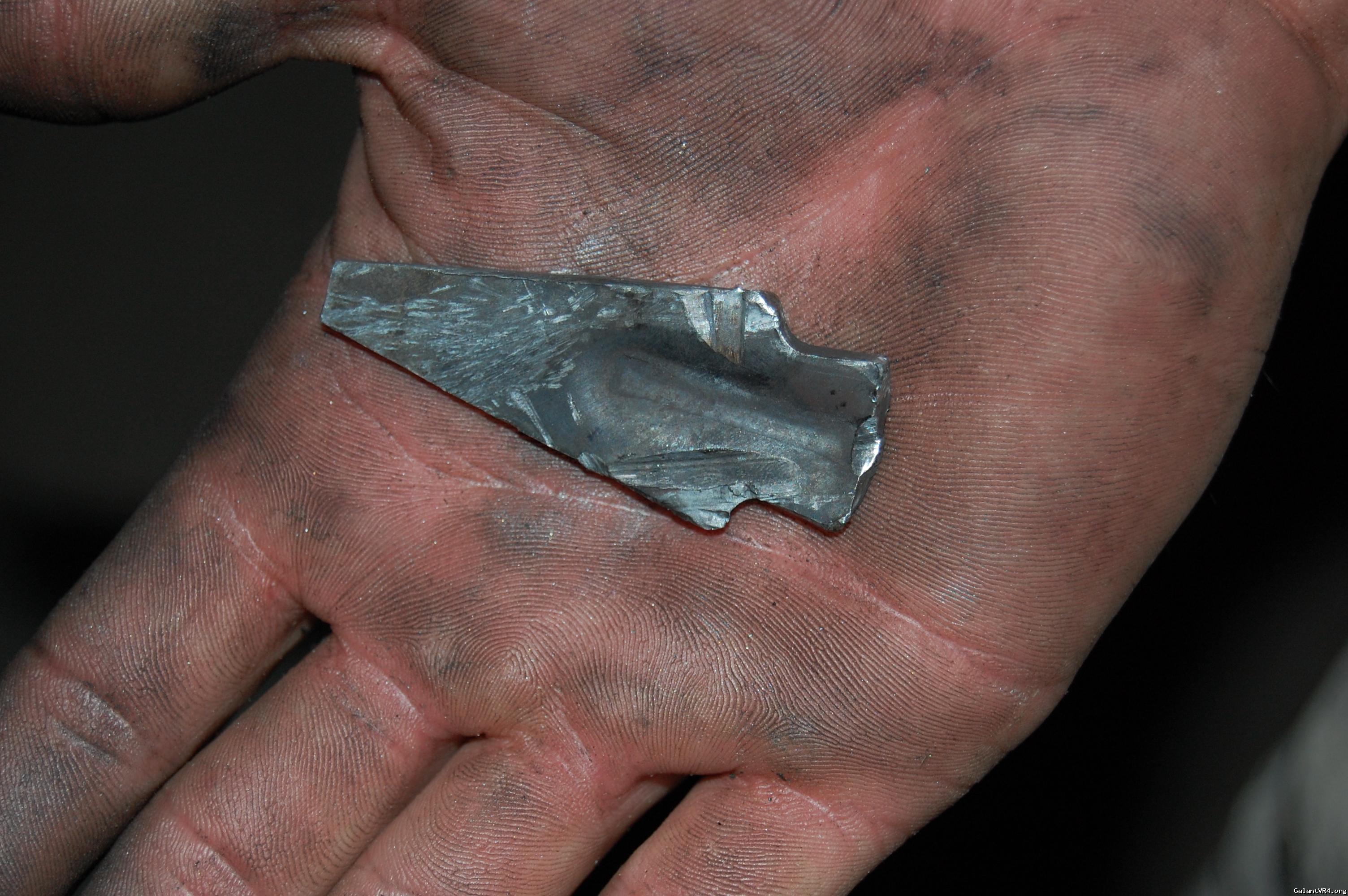

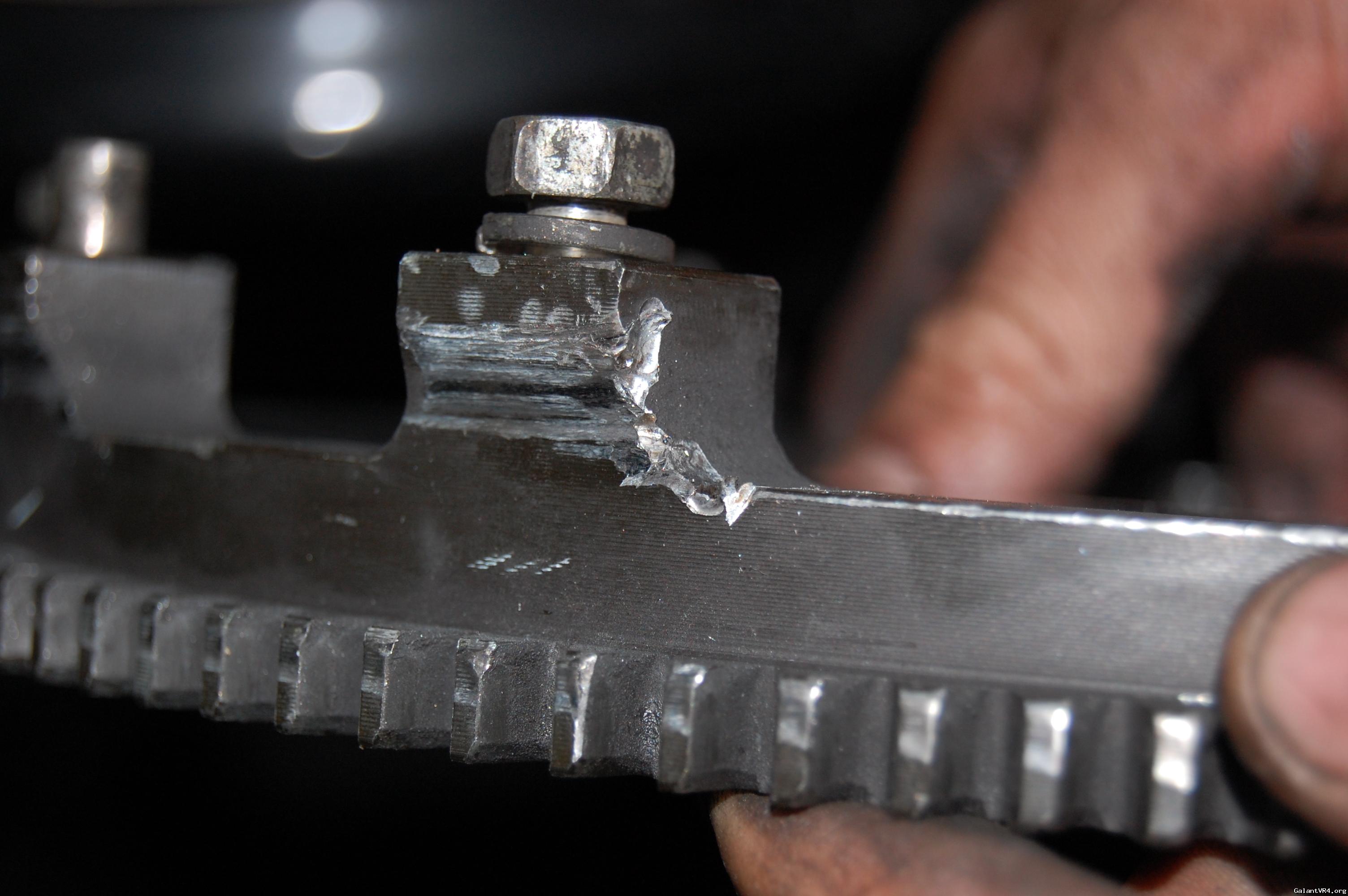

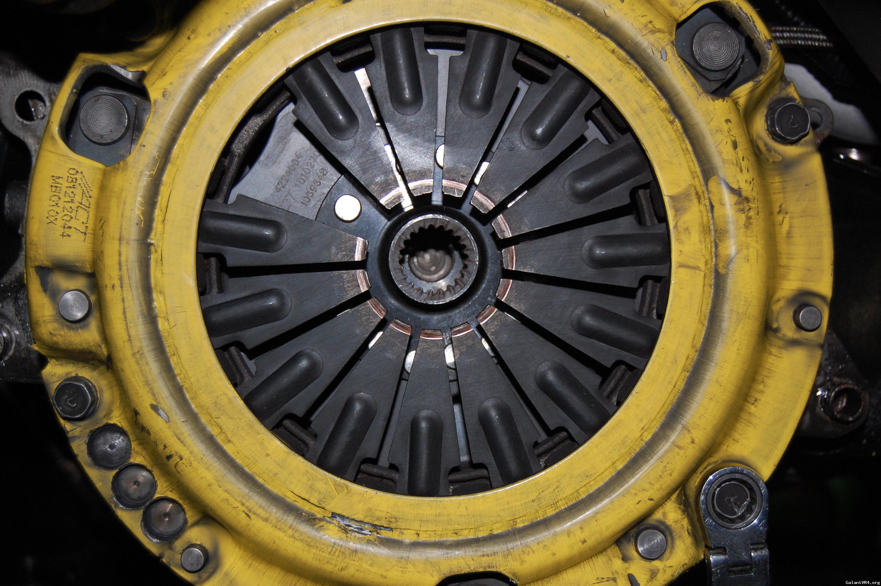

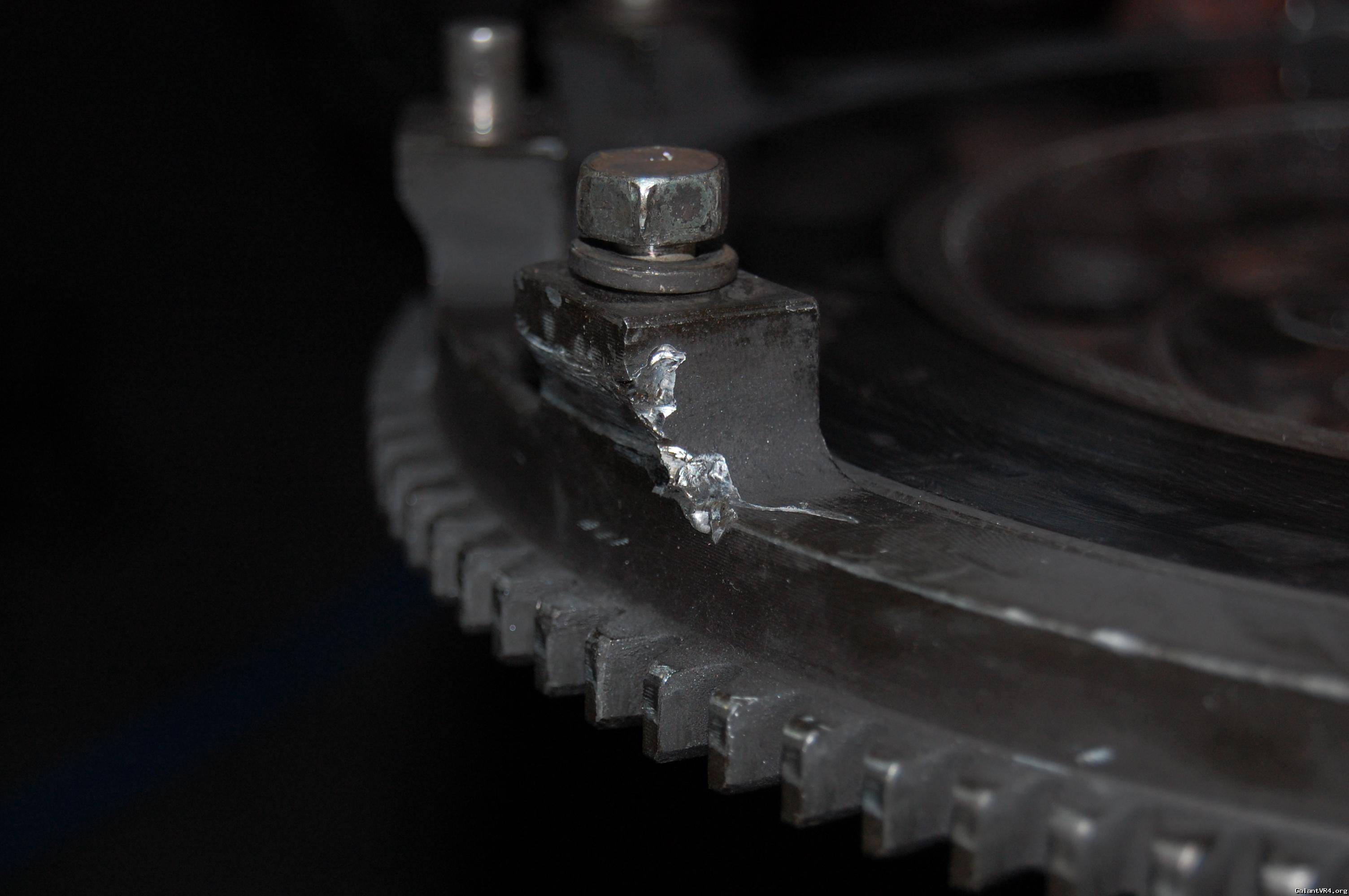

So I drove the 65 miles or so to go help out Diego in Greeley. The car drove real nice the whole way up there, never even made me think something would be wrong. I chit-chatted Diego for a few minutes and then we went to get into my car so I could show off a bit and we could get food also. The car didn't want to go into gear, so we took his roommate's RX-7 instead. After coming back and working on his car, the time came for me to try and get this thing home. I started it in gear, and the clutch was dragging enough that the car backed itself out even though my foot was buried to the floor on the clutch. I shoved it out of gear and the car died. I re-started it, and tried to put it in first. It went right in, then into second, third, fourth, fifth and reverse with absolutely no grind or "block out", and it wasnt making any noise. I tried driving away, made it about 400 feet, and then I heard the worst sound I think I've ever heard from any of my Mitsubishi's. It was like 6000 school teachers dragging their fingernails across a chalkboard all at once. So I called for rescue in the form of a Powerstroke and a trailer.
After disassembly, here's what I found.

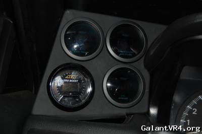

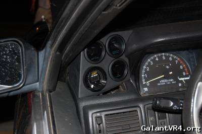

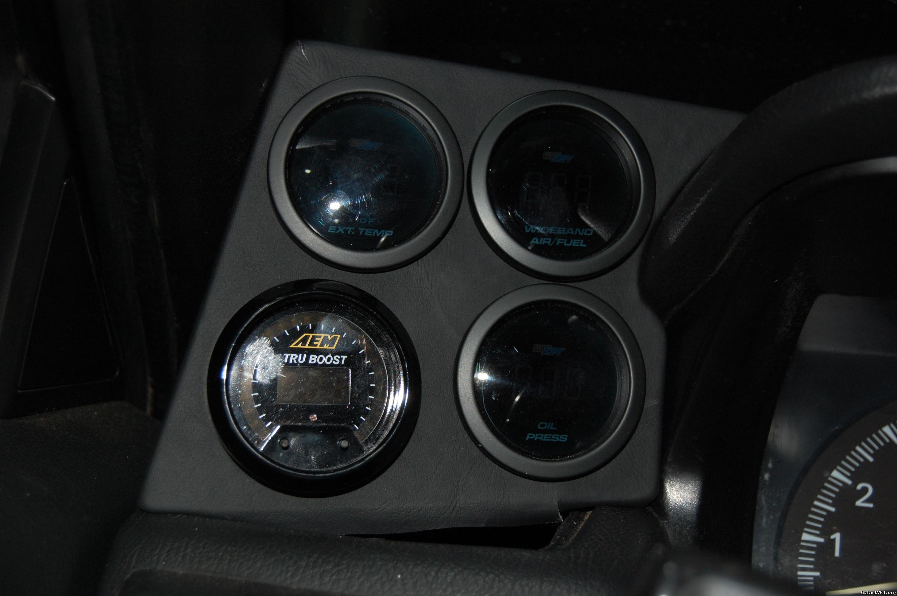

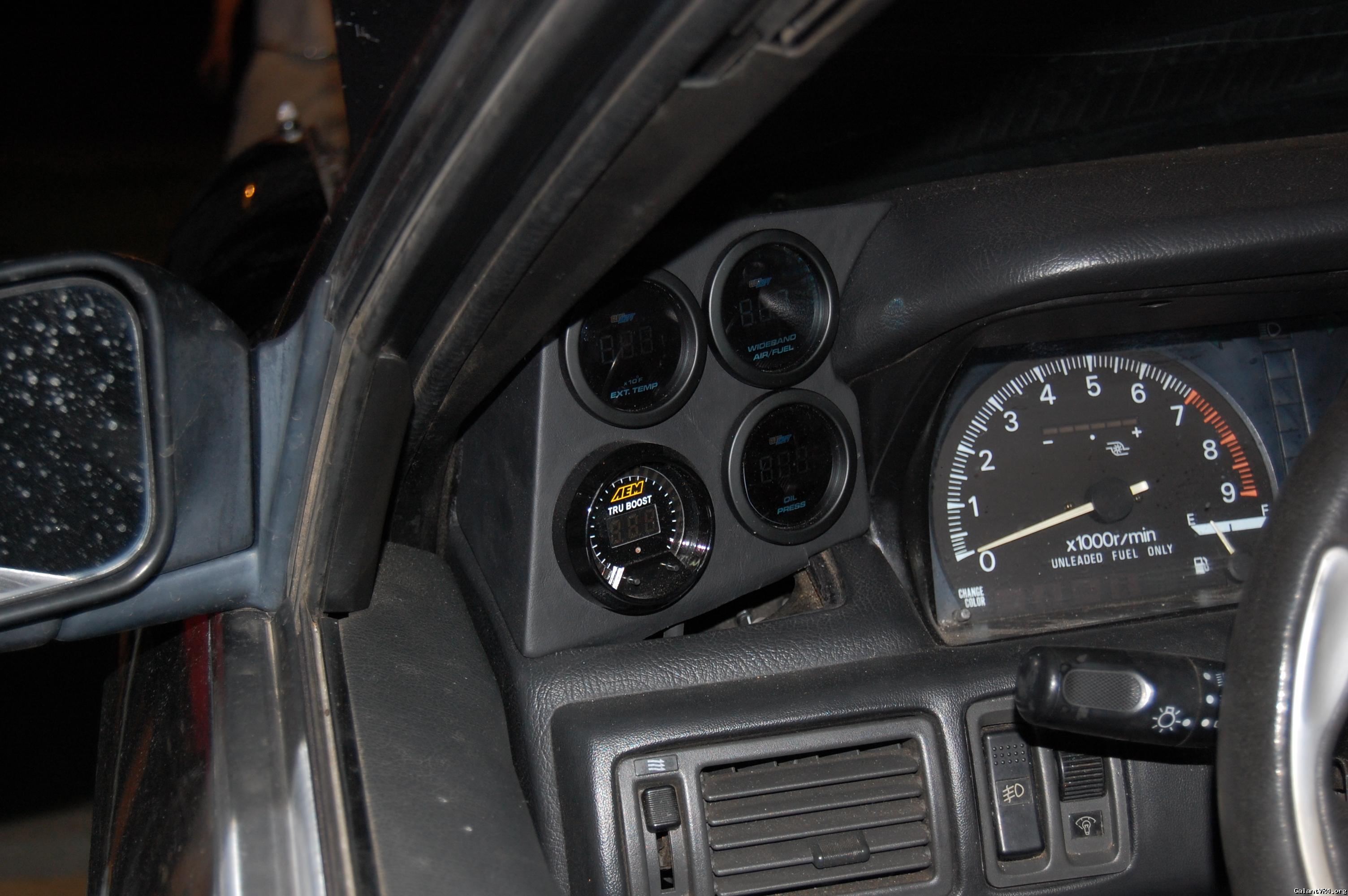

On a positive, I snapped a couple of pics of my custom gauge pod for your veiwing pleasure. The bottom panel is still in the works, the guy that built it just ran out of the glue he uses for attaching the vinyl the the MDF board.

Why am I not surprised your ACT took a crap. Never heard though of the PP going bad...just their discs which happened to me.
Whats your next clutch setup in mind?

My act 3200 pp did the same thing about 6 months ago. That is what caused me to tear the car apart. Drove to work great, then pushed in the clutch to start it and you could feel something in the pedal and no gears. I switched the master and slave, and when I got down to do the slave, those damn teeth were in the bottom of the bellhousing. I thought it was a common problem for the act clutches?
Terry: yes this is an ACT 2600, Diego remembered correctly.
Dlesser: unfortunately I can't blame myself for this one. The bolts were all tight, all there, so I don't really know the "how and why" on this one.

ACT at its best.
Where is the person that is on this board that used to work for ACT and always said there were great clutches. Care to chime in on this one?

I'm not putting a Centerforce in it. I have seen bone stock 4g63t powered cars kill Centerforce clutches in only a few months.

Sucks to see that... ive been running an ACT 2600 in my AWD 1g since 2002 with zero problems. Ive heard stories about there disc hub cracking but never seen any PP failures. Guess its how people drive them /ubbthreads/images/graemlins/dunno.gif
