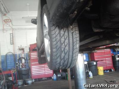

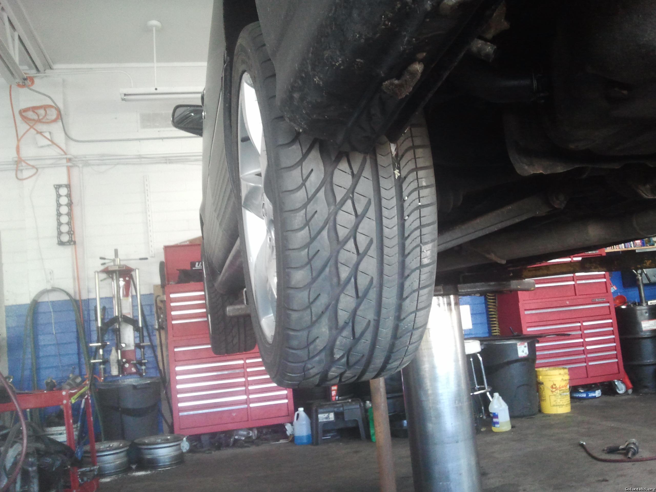

Turns out that I just had some crappy tires. I was forced to upgrade right before Christmas, and mounted up a set of Goodyear Eagle GT 235/45/17 97V all seasons. These new tires are grippy, which is nice, and also disappointing. It felt a lot cooler to be able to get the tires spinning on an AWD car. I feel much safer now, however, because the tires are actually capable of keeping up with the car.
Other than that, there isn't much to update. Rolled out to the local junkyard with another member today, as they were having a 50% off sale. Got a couple good things, but we missed out on what he really needed.
I need the weather to smooth out some so I don't freeze my arse in the garage and there will be some more updates.

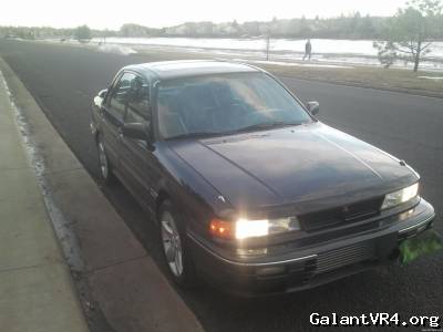

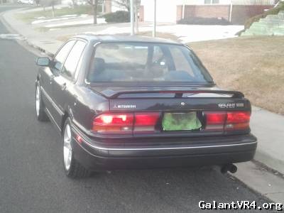

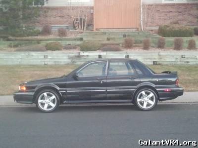

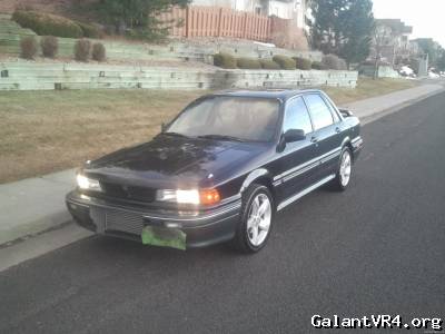

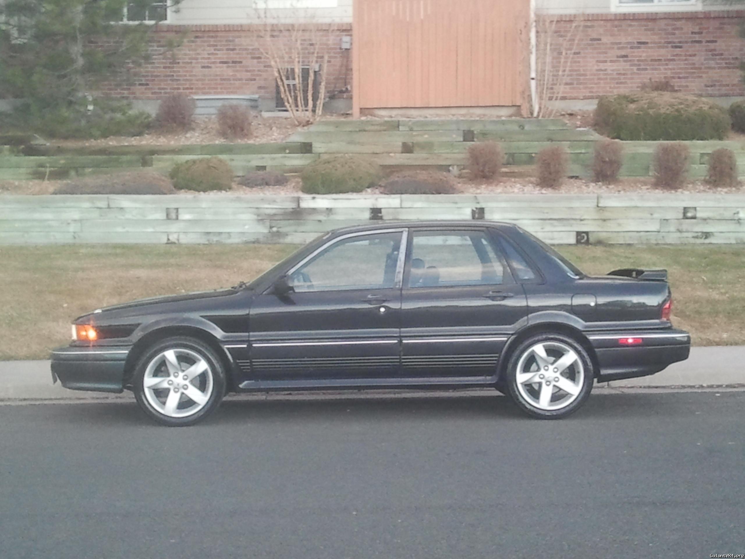

Here are some more pics:
Here is a pic of the new rubber.

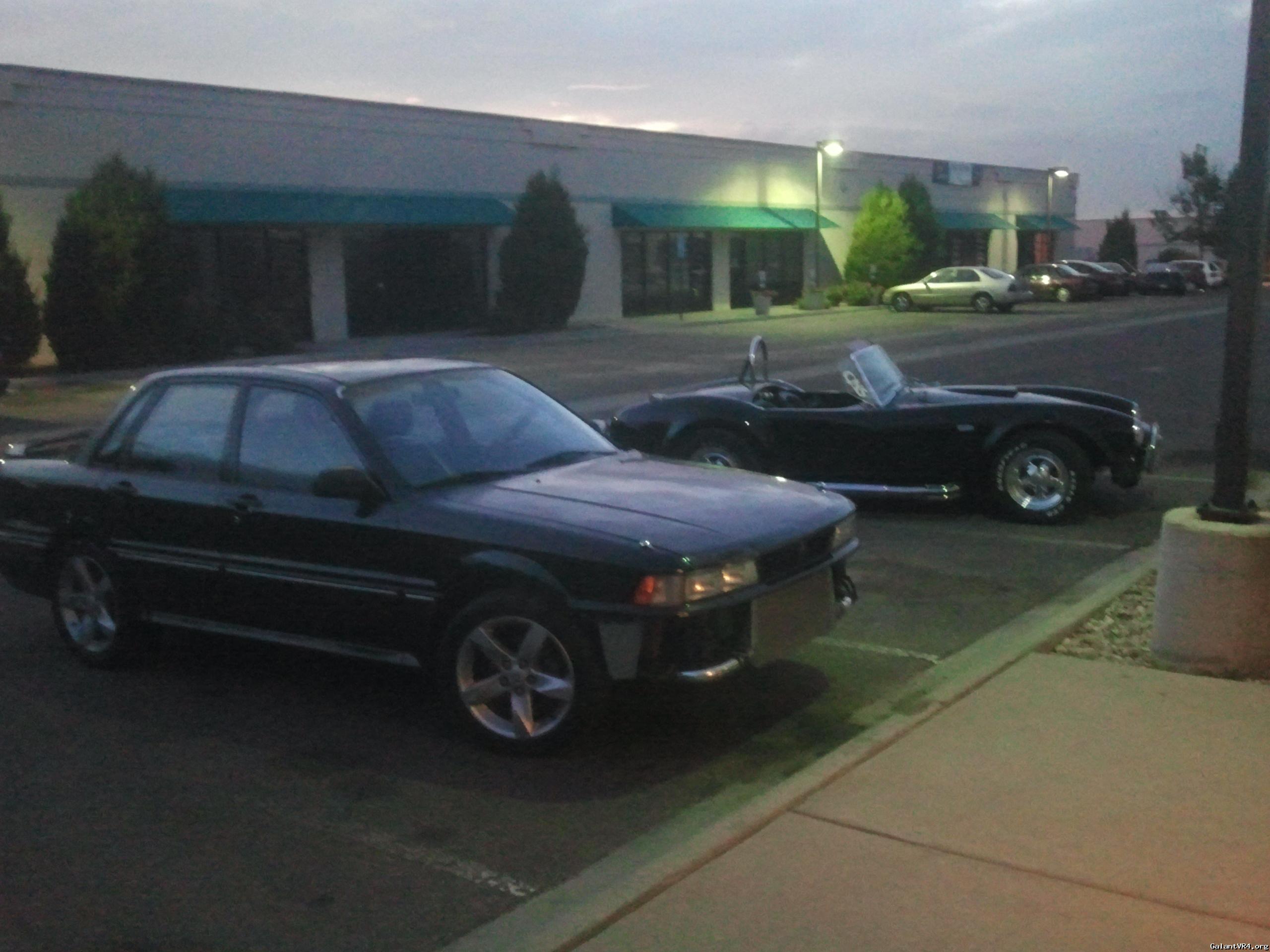

A pic of my car next to a friend's 351W powered replica. My car is way faster, as his only weighs 1960 lbs.

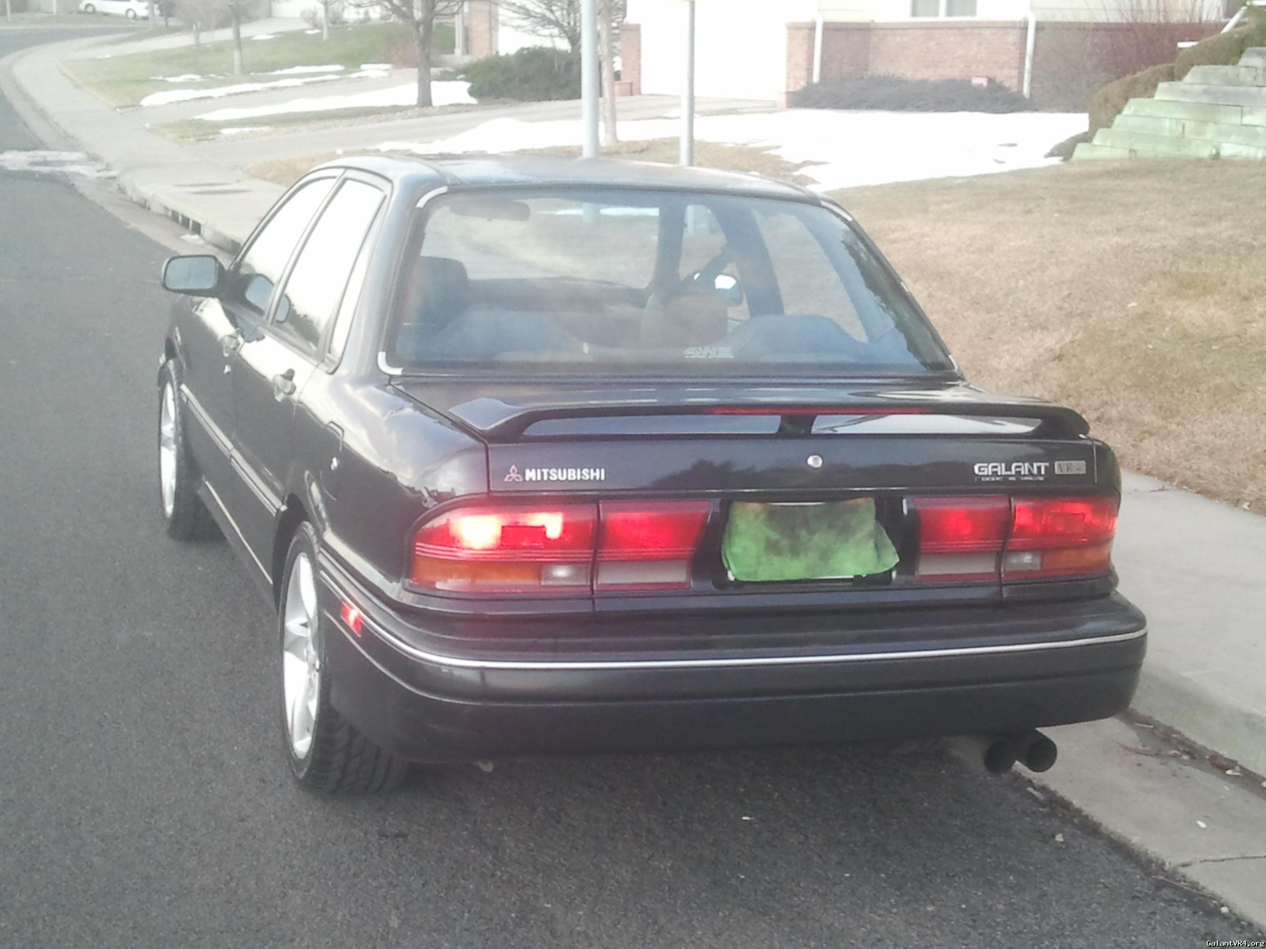

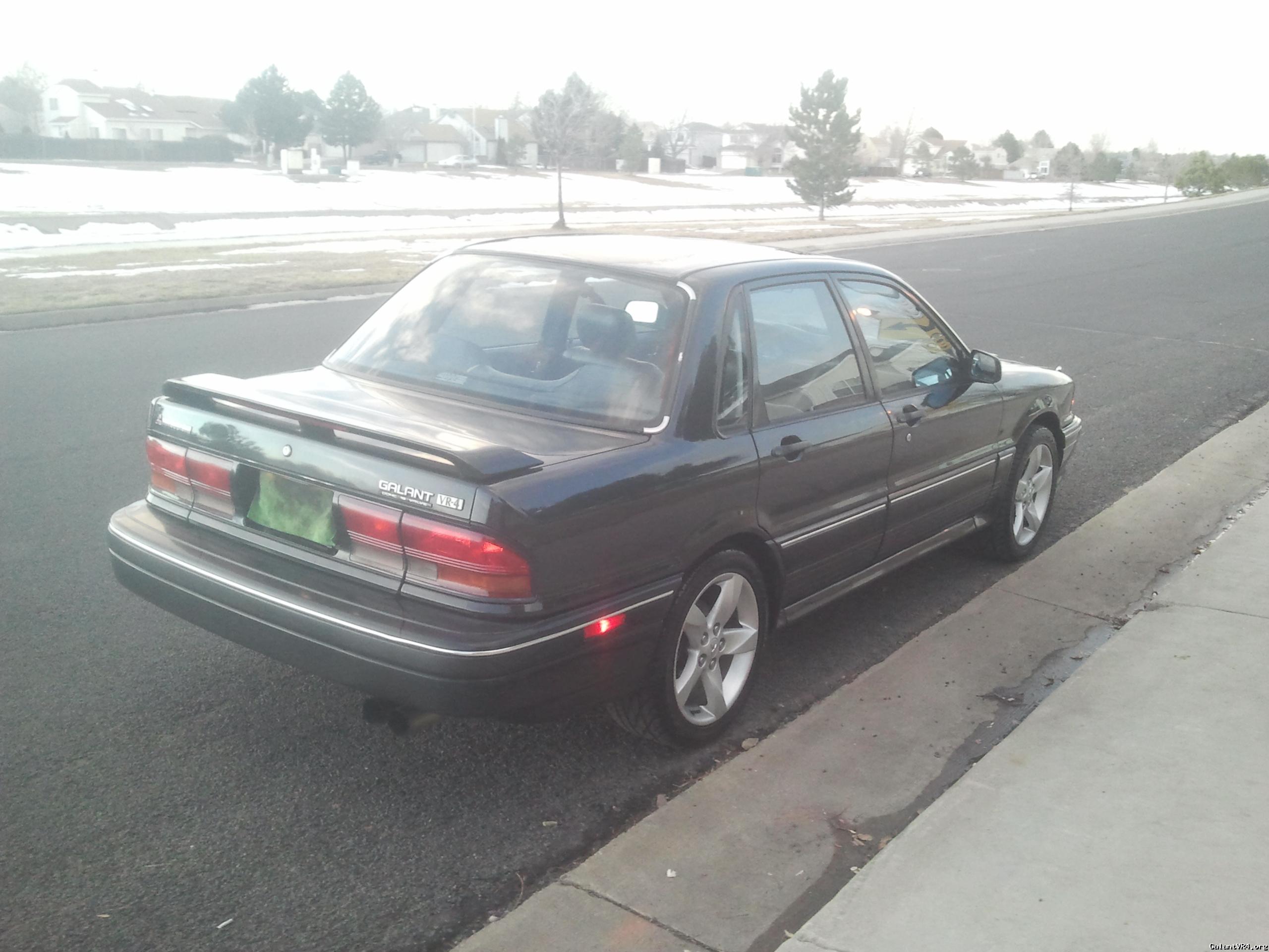

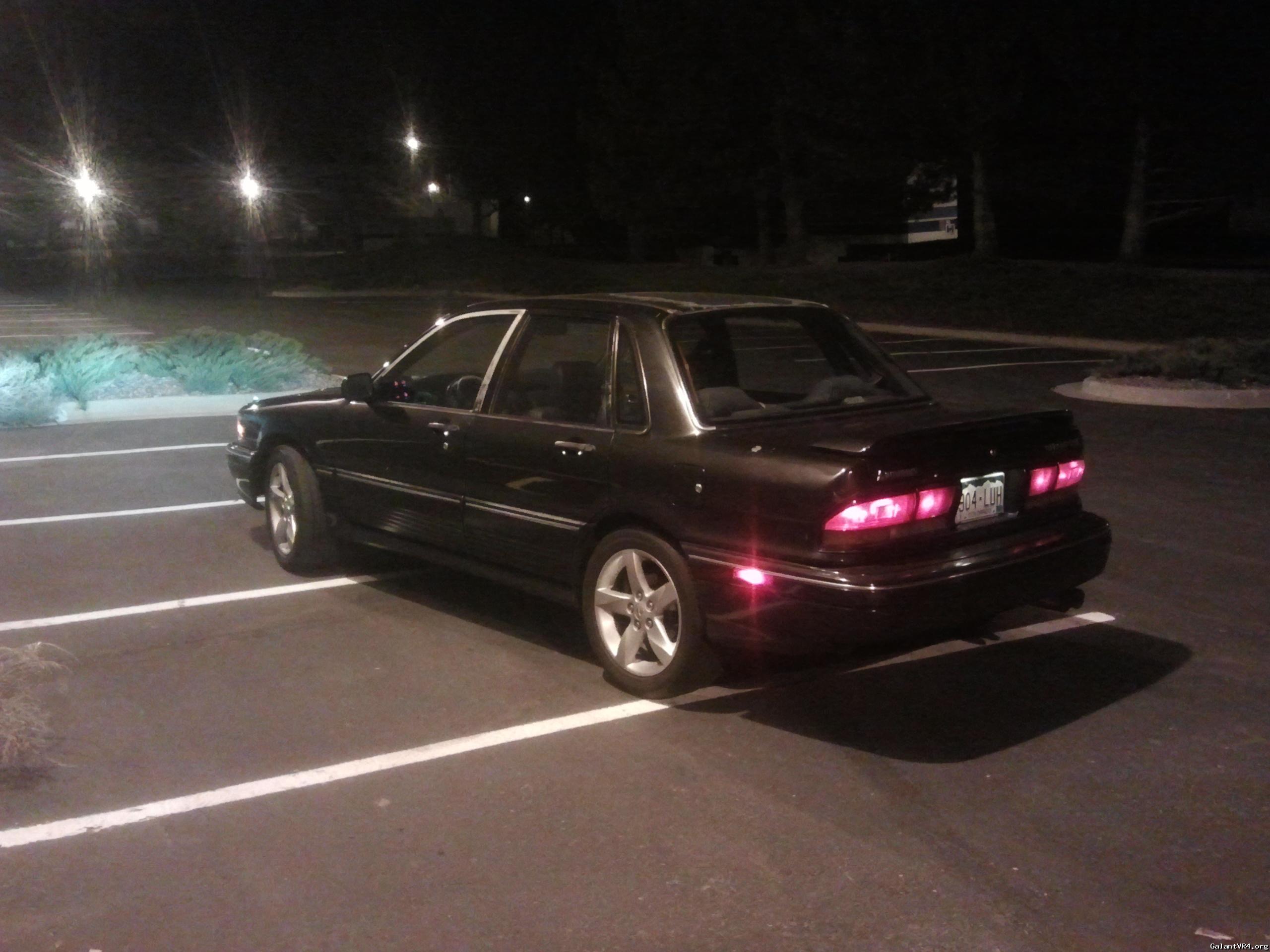

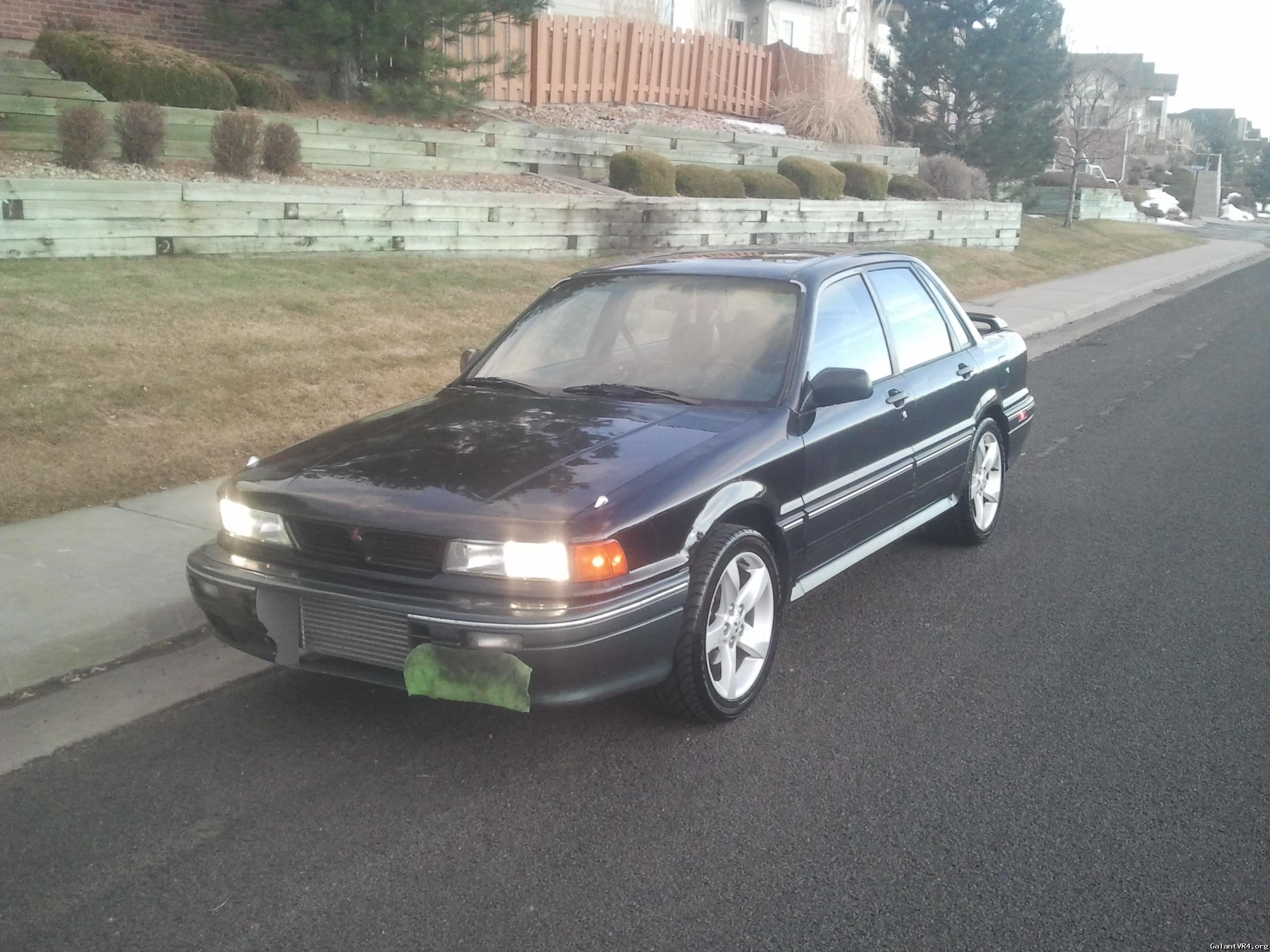

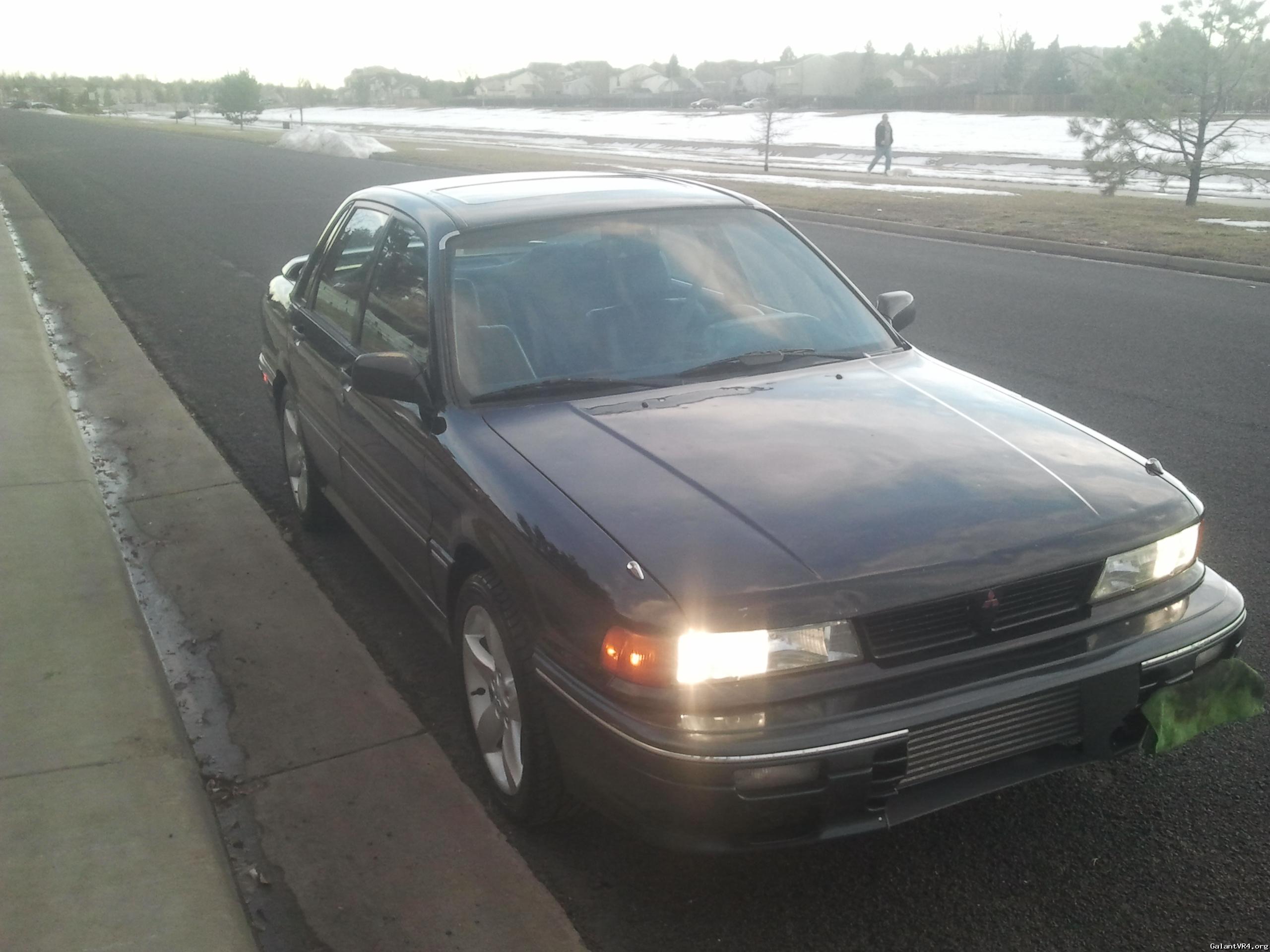

And these are some newer pics of the outside of the car(complete with a totally custom license plate cover /ubbthreads/images/graemlins/rock.gif):

Quoting turbowop:
/ubbthreads/images/graemlins/bowrofl.gif @ the rag over the license plate.
Thanks Wop, I took those pics to post onto FB, and didn't want some random people figuring out where I lived. Most of the active CO peeps have already seen the car and/or been to my house, so I am not too worried this group of guys.
11,992
I just thought it was funny because most people just photoshop out the plate. /ubbthreads/images/graemlins/smile.gif
Most have far more home technology than I as well. I don't even own a computer, although I am working on that. The funny thing is that hanging a rag over the plate is much easier and accomplishes the same thing. It takes two seconds to hang a rag, and then you take all the pics you want. I have never photoshopped anything, but I'll bet it takes longer than two seconds, and you have to do it to each pic.
