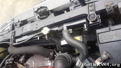

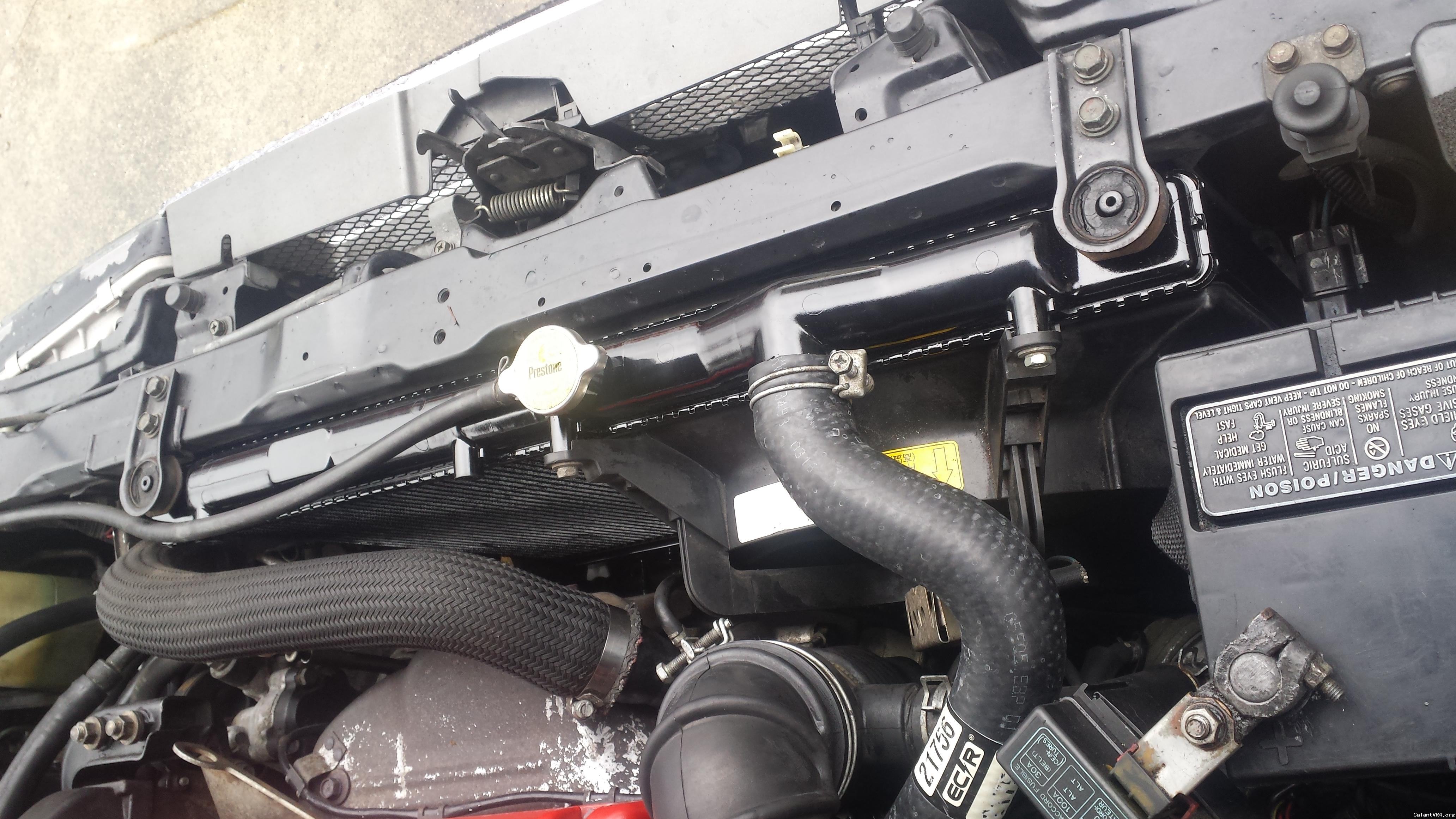

Koyo radiator installed, new hoses, thermostat, OEM CTS. Coolant flushed. G would be proud.

Quoting coyotes:
Shiny
Looks nice, how did the radiator fit? How's your heat and coolant temp?

100% perfect OEM fit. You can see my radiator mounts are a little worn out, but I can deal with that another time. I may do the window seal "mod" to fix em back up again.
Heat still roasts the cabin, no overheating issues before or after. I don't have a water temp gauge to tell you what the actual number is, but the car runs and drives as before. All new coolant, after install I had a shop pump everything out and fill with new. Has new thermostat and OEM CTS. I noticed the wires are a bit brittle down there so I will replace them at some point.
