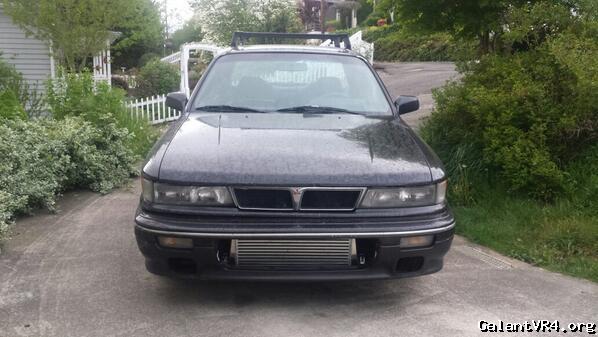

Here's a decent pic somewhat of my intercooler now. Fits way better, even though it's like half an inch to the passenger side. /ubbthreads/images/graemlins/smirk.gif I'm ODC and notice this sh*t.

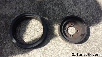

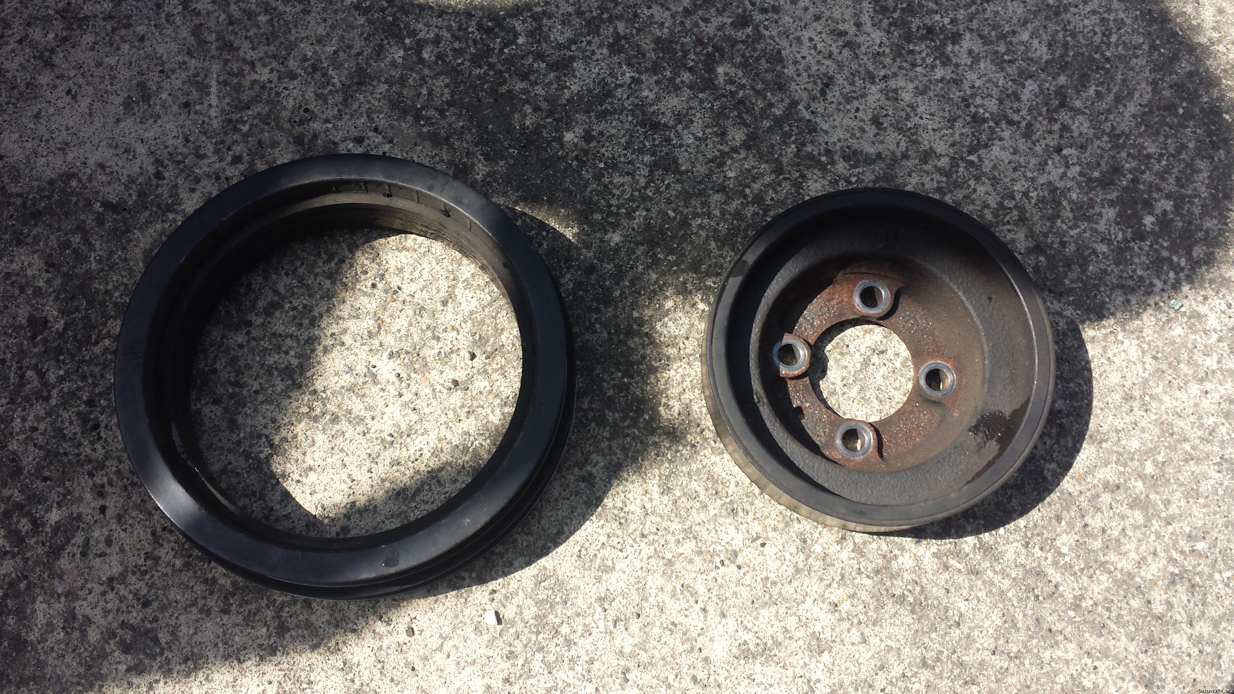

So I'm pretty sure the crank pulley isn't supposed to do this... /ubbthreads/images/graemlins/grin.gif
Gonna order a new one. Didn't see any rubbing on the timing cover inside or out, so I guess we're good. That little seal around the engine mount was out of place but not rubbing. Also it seems my water pump has a slow leak. Bummer, I just did the timing belt, service records indicated water pump had been done in last 20k. That's what I get!

11,016
Quoting coyotes:
No, that's normal. They all do that eventually. /ubbthreads/images/graemlins/wink.gif
