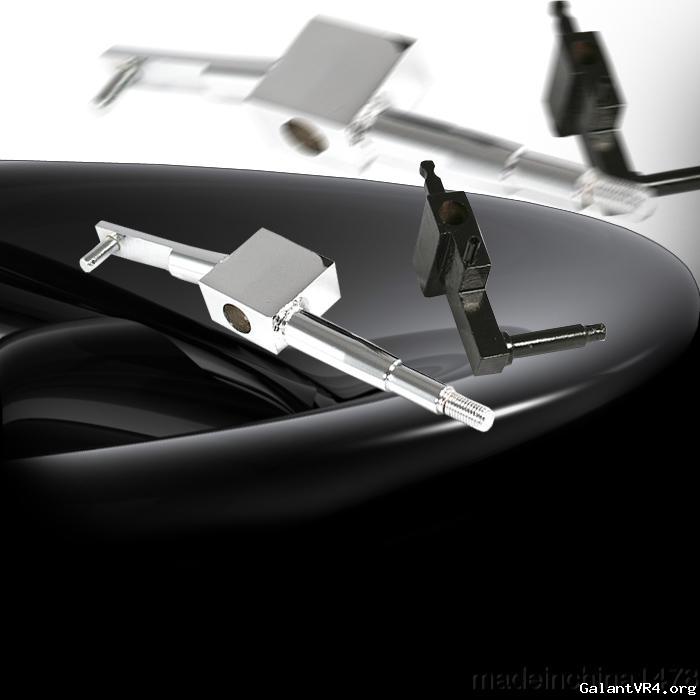

The eBay special. Woe for some, glory for others. Right here , on sale is a "89-94 MITSUBISHI ECLIPSE / EAGLE TALON SHORT SHIFTER" for the low, low price of $3.99 (plus $15 in shipping). I actually paid nearly thrteen dollars for mine, so ACT NOW and you can ride the cheap train to AMATEUR TOWN. (Notice that the application is listed for various Hondas later in the link.. /ubbthreads/images/graemlins/uhh.gif).

As a forewarning, I don't have my camera, so visual documentation of the impending butchery will have to wait. Come to think of it, 150 lines of semi-cogerent text aren't much help to anyone, so I'll just wait to do the write-up until I get photos. Suffice it to say, the job can be done with a satisfactory result. All you need is a welder, a drill press, various rotary cutters/grinders, a hacksaw, standard hand tools and an acetylene torch! Hidden in the last statement is a warning; don't try it unless you have 60% of the means to make this part from scratch! That's exactly what I had, and soon you can see how I did it! /ubbthreads/images/graemlins/bawling.gif

Those shifters are junk and don't have shift stops.
Exactly right! The shift stop is one of the myriad parts you can cut off of your stock shifter and weld to your new one. Why buy new, when slightly used will do?

Finally got some pictures taken.
Beginning with the upper shift arm:
The hole had to be bored out to accept the stock bushings and arm from the lower section. I started with a smaller bit, and worked up to a 5/8" diameter, IIRC. In its unmodified form, the hole was barely big enough to fit the arm alone.
Edit- Well this is fantastic, the pics won't upload. I'll keep working on it, but until then you just get text. Its kind of a PITA mod anyway.
The very bottom of the lower arm does not clear the shiter base when installed. First, I started by grinding as much as possible from the bottom of the arm itself. The unmodified arm bottme is squared off; mine now has a rounded end. I ground so much off that the pin, which was press-fit in, came loose. I took the opportunity to rotate it so the cotter pin would runfront-to-back instead of top-to-bottom. The pin would have contacted the shifter base otherwise. I welded it back on, and re-ground the weld for clearance.
After this, it still would not clear, so the shifter base itself had to be modified. I used an acetylene torch and a bur bit to make a long hole along the length of the arm action. I also removed some material from the lower arm support to allow the slightly longer-than-stock lower arm to clear it.
The unmodified pin has the cotter pin hole further from the arm than the stock arm. I used a rubber plumbing piece as a small spacer.
The upper arm does not have shift stops, but the stock arm does. I have yet to perform this step, but the stock stop can be removed with a hacksaw and welded to the uppper arm in the same position.
Still with me? No? I'm going to keep going anyway. /ubbthreads/images/graemlins/smile.gif
Onto the lower arm:
The hole for the long bolt which the arm rides on is again too small. IIRC, a 5/8" again allows the hole to accept the stock bushings,spacer and bolt. It also allows the use of the stock helper spring, which centers the shifter in the neutral position. However, the unmodified eGay shifter has no finger. Fortunately, the stock one does. I cut it off with a hacksaw, ground it to fit and welded it on. Nice!
The bottom finger of the unmodified lower arm is too small to accept the stock bushing which allow the side-to-side action of the shifter. Again, cut it off and weld on the stock piece. /ubbthreads/images/graemlins/grin.gif - Eeeyyy!!!!
