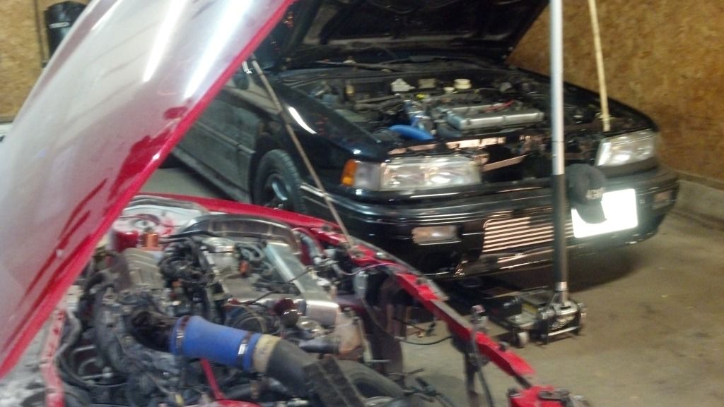

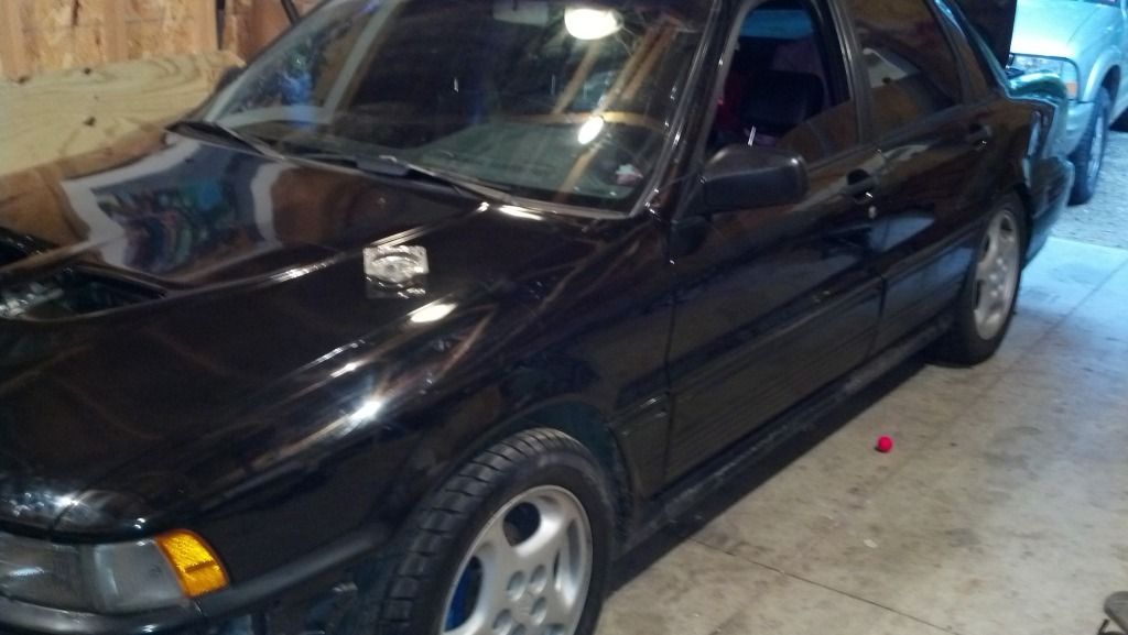

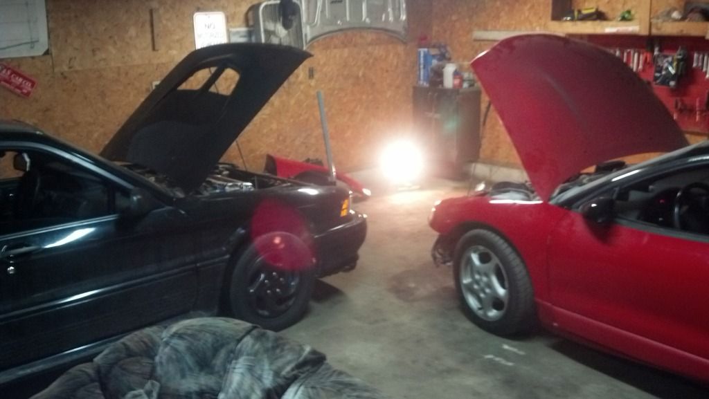

Just posting.some pics /ubbthreads/images/graemlins/smile.gif

So what's the plan for the VR4? Is that a DSM parts car hanging out beside it? Those 300zx rims look pretty good.

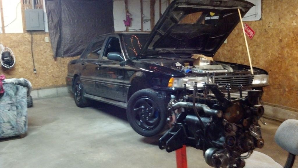

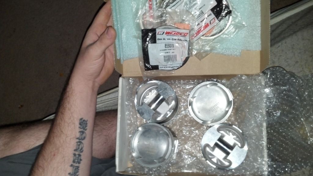

I am building a motor right now for it
.20 over block
.20 over wiesco hd pistons
Eagle rods
Arp head studs
Arp rod bolts
272/272 bc cams
Balance shaft removed
3in maf translator
3in megan racing downpipe
Thats pretty much all i got figured out as of now im looking into replacing some supports like the front crossmember with chromoly tubing and rear mustache.
The 2g is the tsi awd i traded running and driving for the galant. I swapped the 300z wheels off the vr4 to the talon my buddy wanted to keep them

.20 over weisco pistons
How the hell can you misspell WISECO? Especially when you can plainly see it in the photo!!

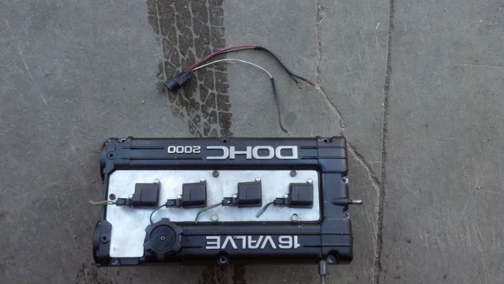

When I bought the car the o2 wirring off of the engine harness was cut so I'm going torewire it back to stock. Also changing out plugs and running my 3 1/2 maf with translator. I need some intercooler piping still for the fmic the piping i have is all rigged

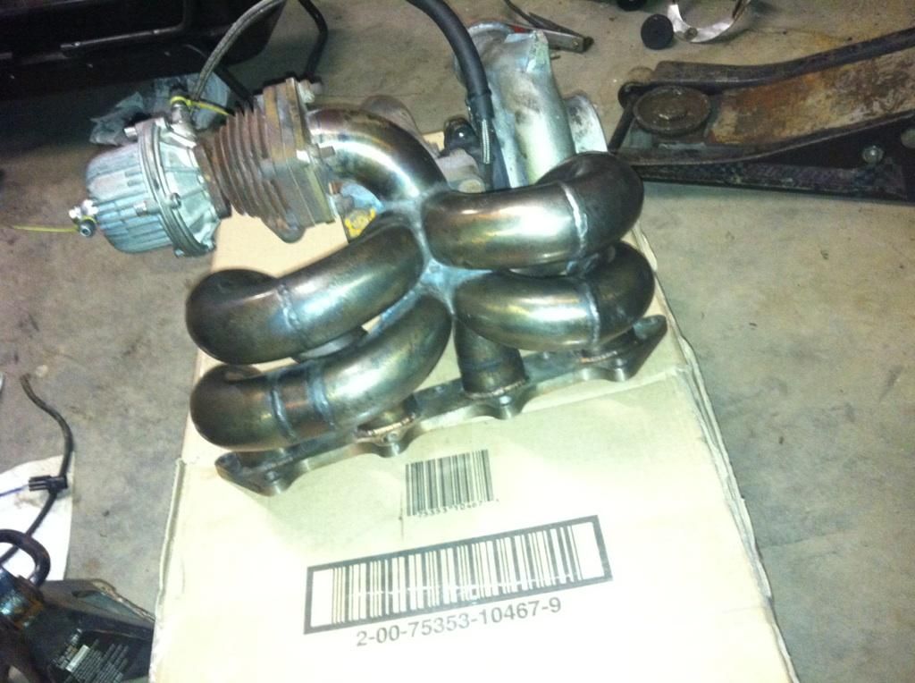

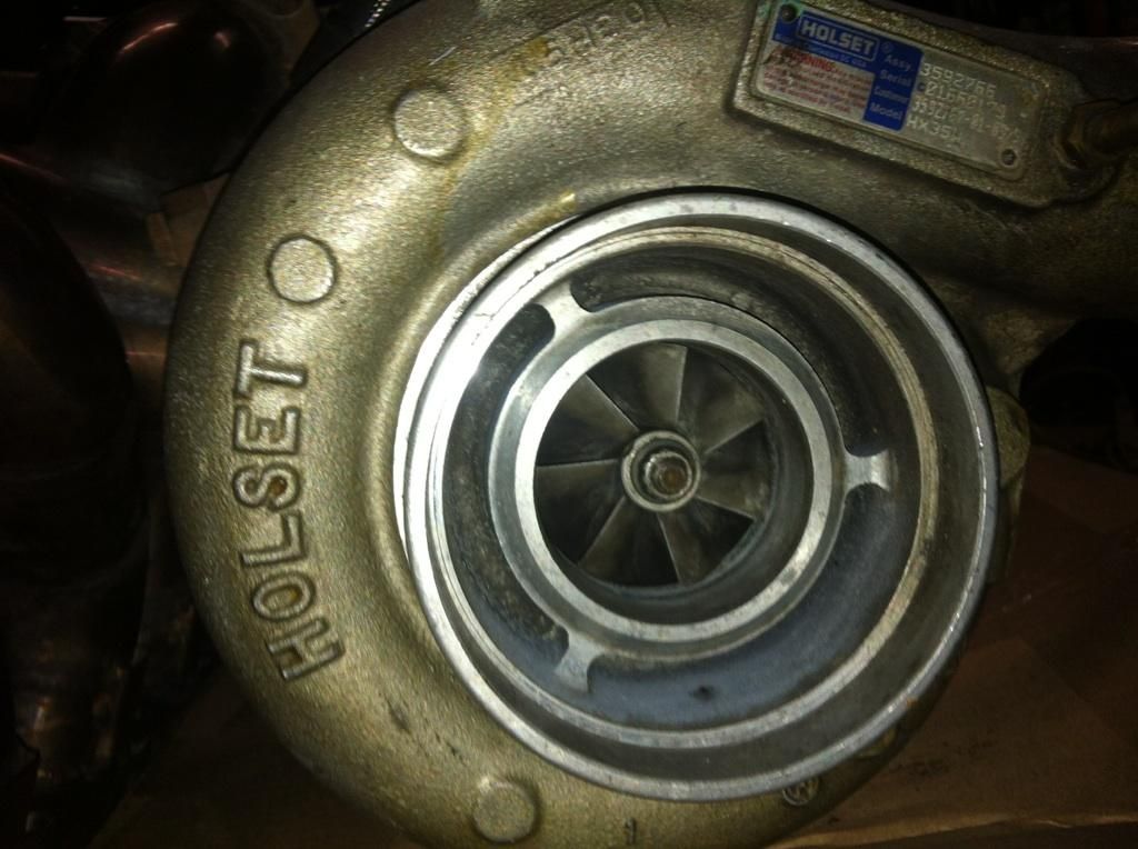

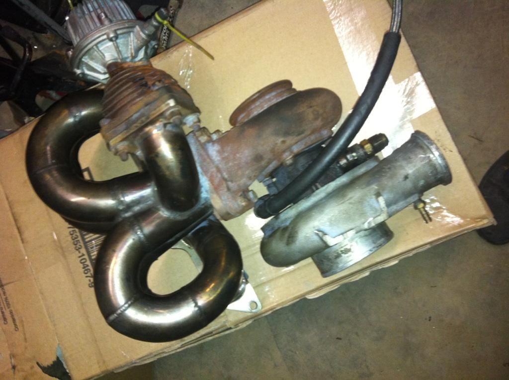

Rebuilt hx35 hks wastegate sch 10 ramhorn manifold

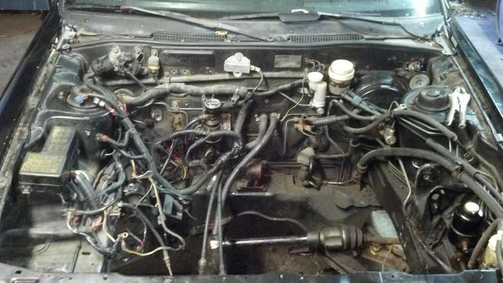

Time to clean up the engine bay

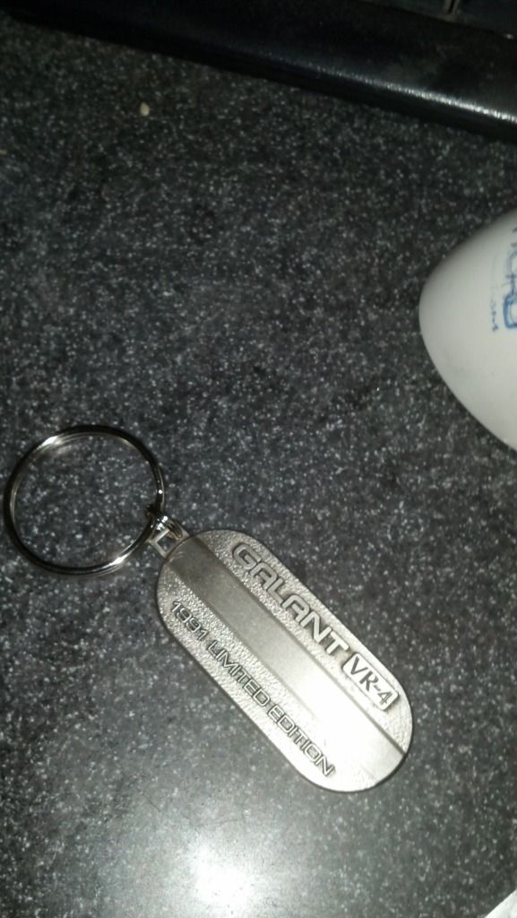

Got my replica key fob in the mail
