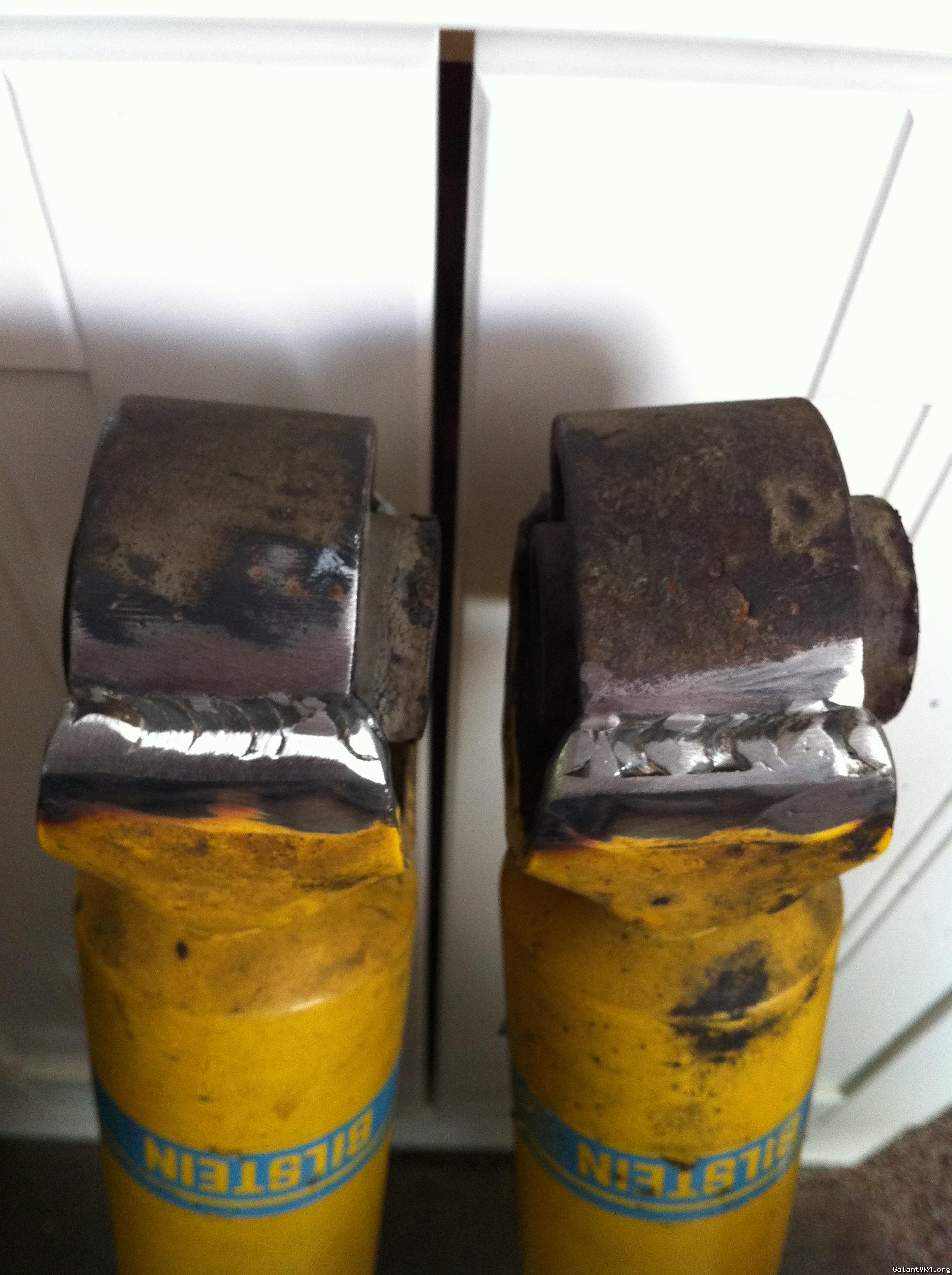

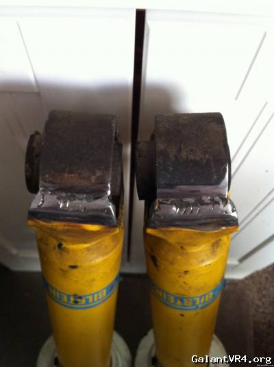

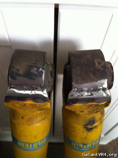

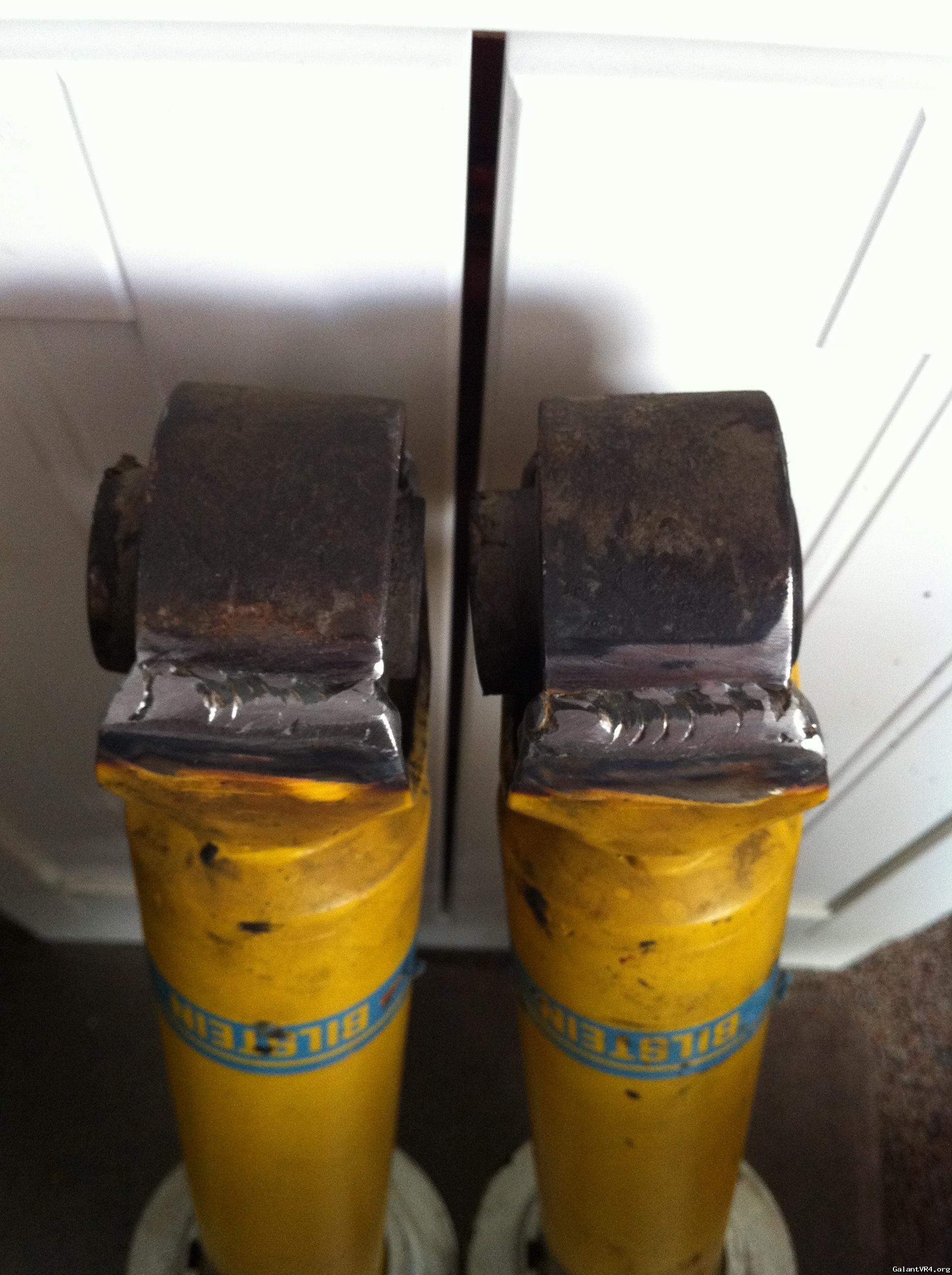

I got my Bilsteins back from the shop...Maybe it's just me, but compared to the ones Garfield does, and the other photos, these look a little underwhelming to me /ubbthreads/images/graemlins/dunno.gif
What say the collective?

The tabs should have been wrapped around and not cut off. What scares me more is that the paint wasn't stripped before welding. This contaminates the weld. They used a scotch brite pad on a 90 degree die grinder to clean off the sh*t welds after they buggered them up. The bushings should have had the paint blasted off with sand or glass beads. as well as the tabs then tacked in the top near the tube then on the sides then the tabs hammered down then welded allowed to cool etc and the finished off by welding the holes up. another good idea was to weld them on straight. They look kind of skewed a bit.
I'd say ship them down here and I could doctor them up but shipping is going to be pricey I'm sure. Just get some 1 inch wide 1/8 inch flat bar and wrap the end and weld to the tabs as well as the bushing but first strip off all the old paint dirt trash crap etc and also try and have them tacked in the top on both sides of the bushing

It may not be pretty, but it is not going to break. All the forces applied are pushing the bushing into the shock body. Only when you take it off sweet jumps are they going to try to briefly pull away from each other.

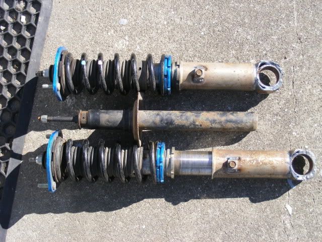

I'm not convinced you could weld them properly without destroying the rubber bushes.
When we did mine we removed the bushes (ended up throwing them away and finding some nolathane ones to fit instead)

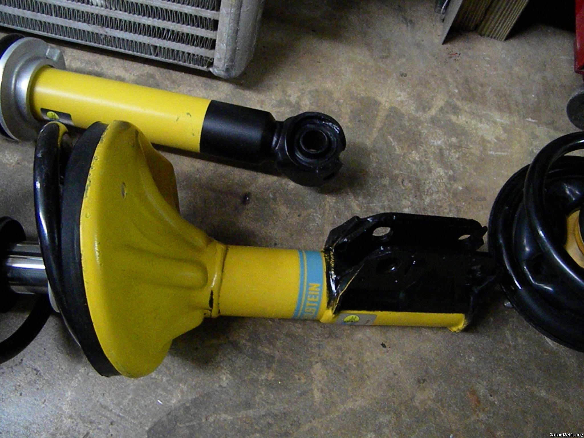

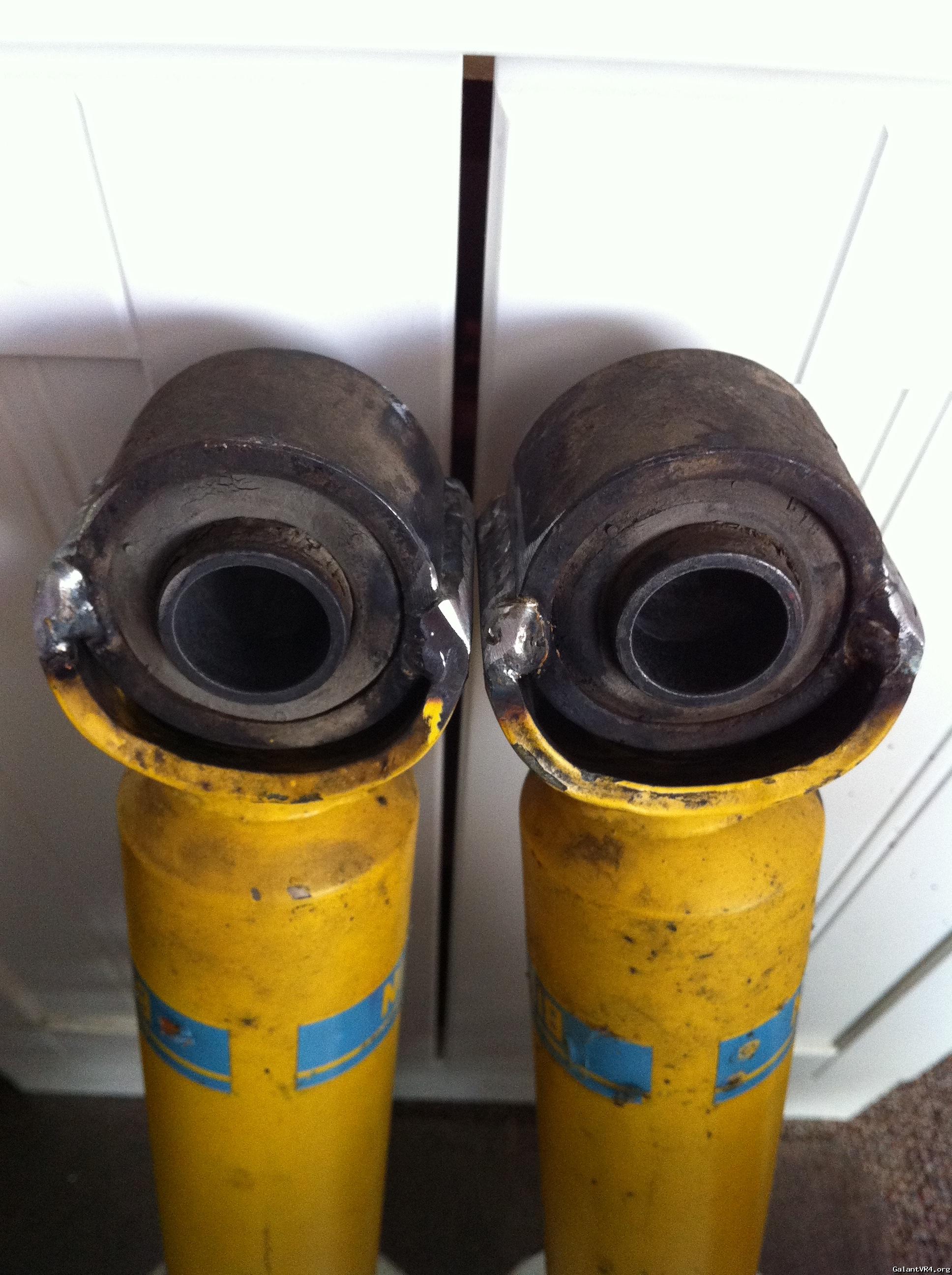

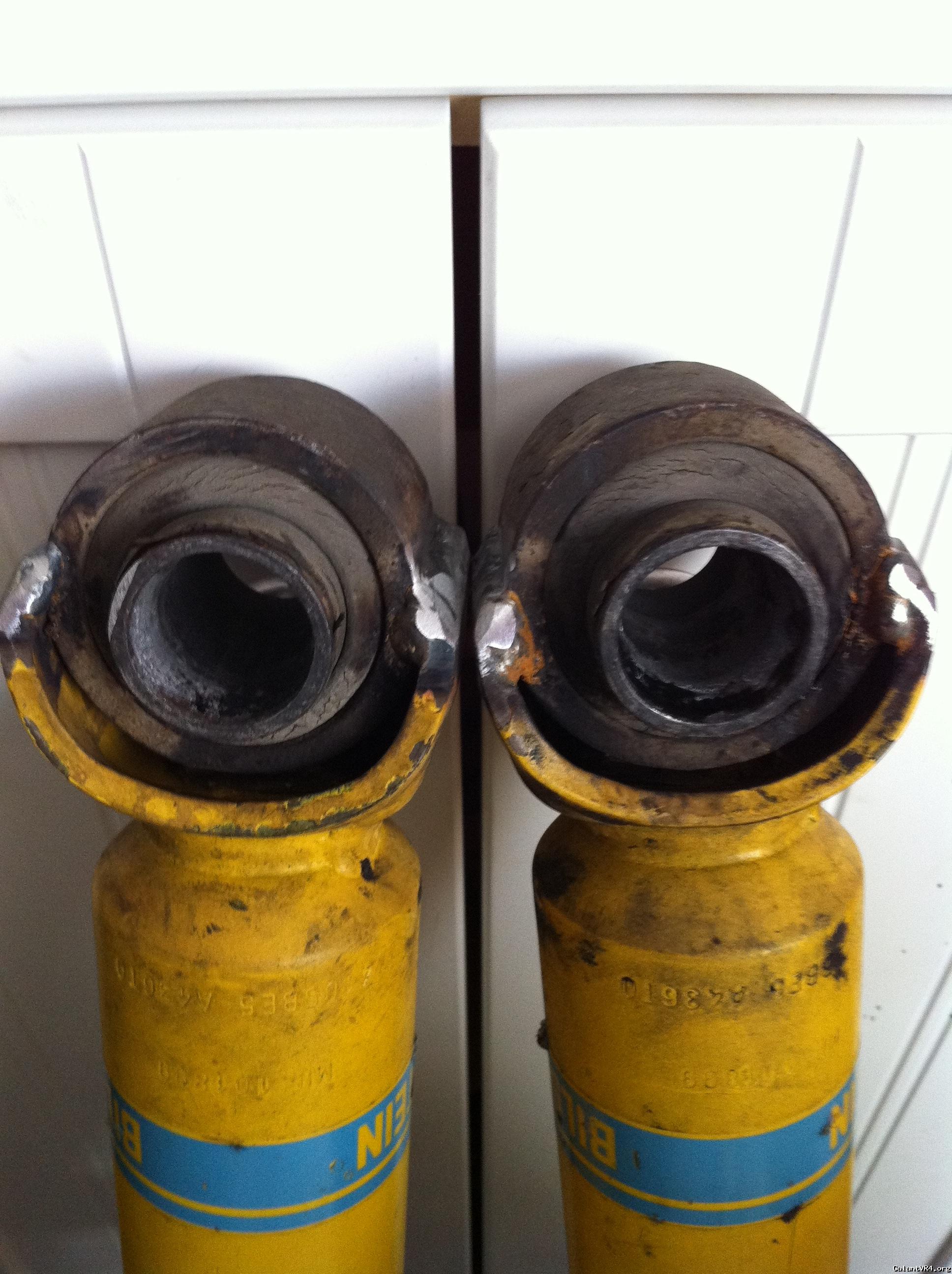

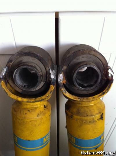

Here's a pic minus the bushes.
This is obviously the lower mount from a coilover with the shock itself removed - wouldn't be keen to try welding near a pressurised shock.

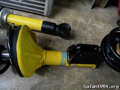

Here's a comparison with the stock shock (fully compressed and missing it's lower bush).
These are Evo 5 coilovers with about 3" removed from the lower mount.

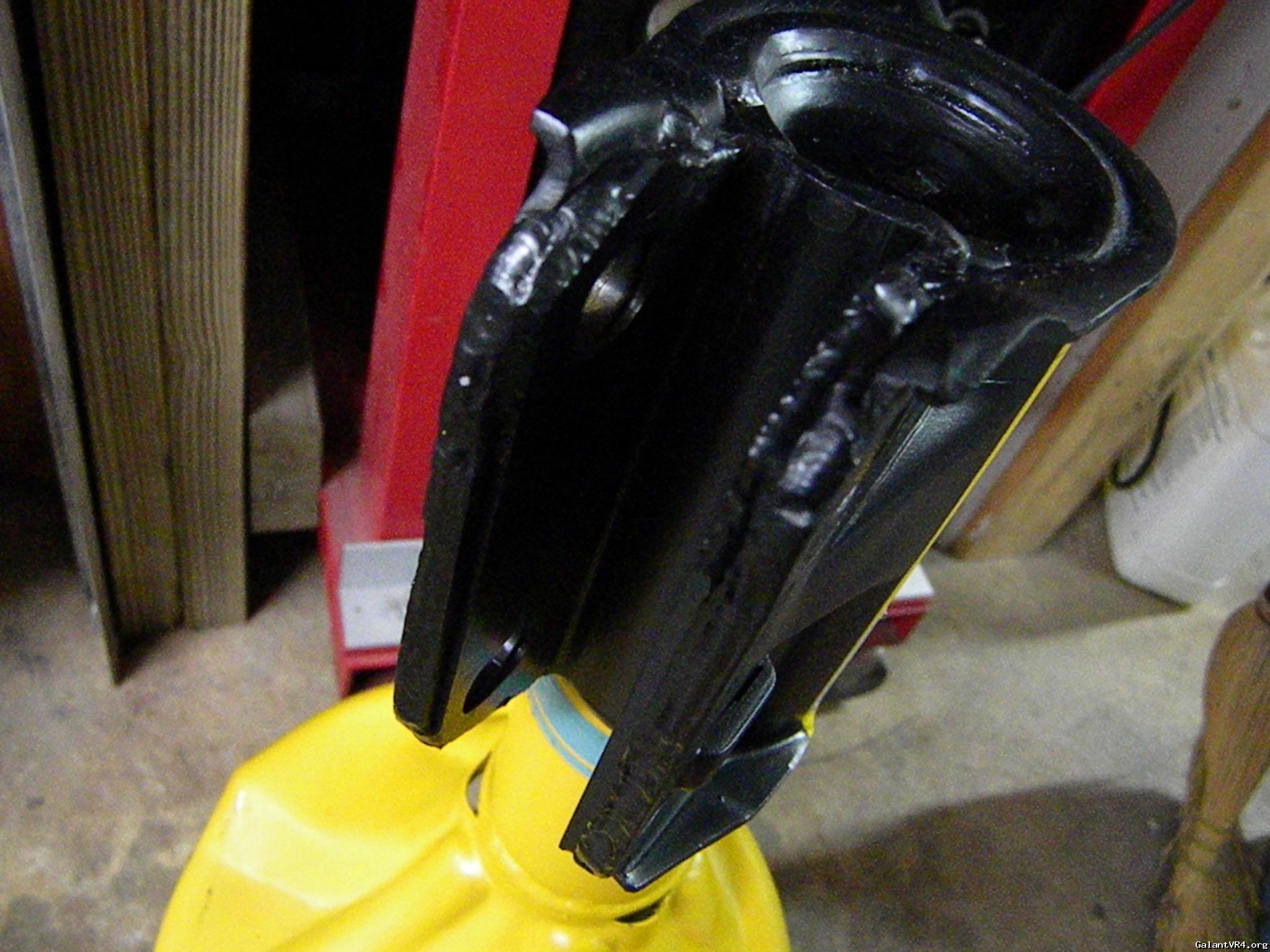

I've never replaced the bushings and done probably 10 or 15 sets. But I'm using a tig and going super slow letting them cool
Here's the last set I did. Already started on Paul's in the shop and probably going to finish those next week. But I'm doing his stealth mode so the Nazi's in Hong Kong think there stock.

They don't look pretty but I don't think you will have any issues. It looks like there is still decent penetration.

I am not sure there is decent penetration on the bushing. It looks fine on the shock, but not the bushing, you can see the small contamination bubbles in the tops of the welds which kill and hope of penetration to the non cleaned metal. I would definatly get them redone.

I'm in this camp. They are easy to inspect. I wouldn't worry too much about it.

They will probably be fine, but it seems rather obvious to bend the metal over and get the most welding possible. Not sure why you did it like that.

I'm no expert, but I"m betting on the welds outlasting the shocks. You don't have a whole lot of side/side, front/back motion, just up and down. The pressure will be going against the shock, not the welds, unless as mentioned, you take it off some sweet jumps. /ubbthreads/images/graemlins/dunno.gif

It is done with a mig welder, I would guess the machine was setup ok, most of the heat went into the new shock body, I would guess to save the bushing. I see where the paint was removed around the weld area, and there is no contamination or porocity in the weld.
I will put money on the weld holds out longer then the shock, as long as you re paint were the paint is removed.

I run a fabrication shop and I weld a lot of equipment used in the zip line industry....My welds have to count because if they fail someone dies! Although these welds are not pretty, they look like they would hold just fine. I would agree they will outlast the shock and the rubber bushing that has now been hot and will more than likely fail.

I don't consider myself an expert on this (or any other topic) but I do have a bit of experience breaking sh*t, (especially sh*t that I made/modified.)
The cyclical nature of the loading of this joint and the very nature of what a failure would cause would have me approaching this task differently.
I would strive to encapsulate the bushing, and at first glance, that would not be so hard to do /ubbthreads/images/graemlins/dunno.gif
Take a piece of tubing in the approximately correct i.d., slice it in half to give yourself a "u" shaped piece.
Work that over a socket to get the correct arc to match the bushing
Drill some holes thru this piece and the shock body stick outs (for rossette's)
Bevel the edge of this piece and the shock body stickouts
Insert the bushing, and clamp the whole shitaree together using a long metal furniture clamp.
Heli arc (that's tig to you young'uns) the joint a little at a time, using an appropriate filler rod and a lot of patience.
You would get "some" penetration into the bushing shell, but the main idea is to surround the shell with the u shaped piece to cradle it.
Then, I would make an exterior strap in the correct arc to wrap the whole diameter of the workpiece, drill some holes to match what I drilled in the other pieces, and then I would rossette weld thru the holes to positively retain the bushing.
Done deal, with minimal heat put into the bushing, and maximium fatigue resistance.
... last the life of the car and then some!
With a little more work, one could also weld the u on without the bushing in place, then clean the weld penetration/irregualrity from the inside with a carbide.
broach the thing round again ( an impact socket a couple of thou undersize makes a good broach)
Hone to the final size, give the thing a couple of thou (not much, 2 or 3 thou) pressfit, and press the silly thing in.
then strap it, rossette weld thru the strap all the way thru the workpiece and down to the bushing shell to positively retain the thing ... and it's fawkin done
... can;t help but think there is an off the shelf urethane bushing that could be used in this application ...

Brandon,
The fact that the stickouts don;t wrap around the shell at all does give me just a scosche of concern. Probably be okay, but I hate having even the tiniest worry when I'm flying down a dirt road at speed.
If you;re concerned about the set-up you have, just make a strap to wrap what's there, and rossette weld thru it in a few spots and attach it well to the stickouts.
It'll work just fine. /ubbthreads/images/graemlins/smile.gif
Be sure to tighten the lower bolt with the car resting on it's wheels!
That joint will wind up some as the suspension moves, and if you tighten it at full droop, it will pre-stress the bushing, leading to a shorter service life.
