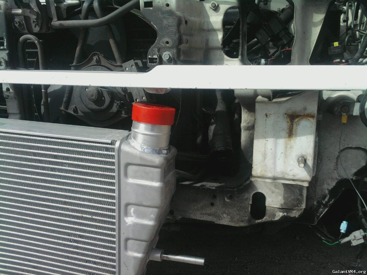

I was wondering if anybody has tried this? It looks like the core will be more of a bolt on than the 8/9 if you flip the core so the end tanks are on opposite sides.

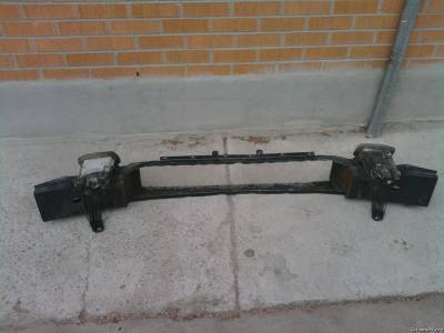

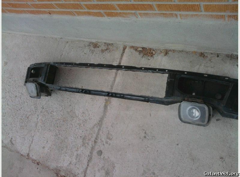

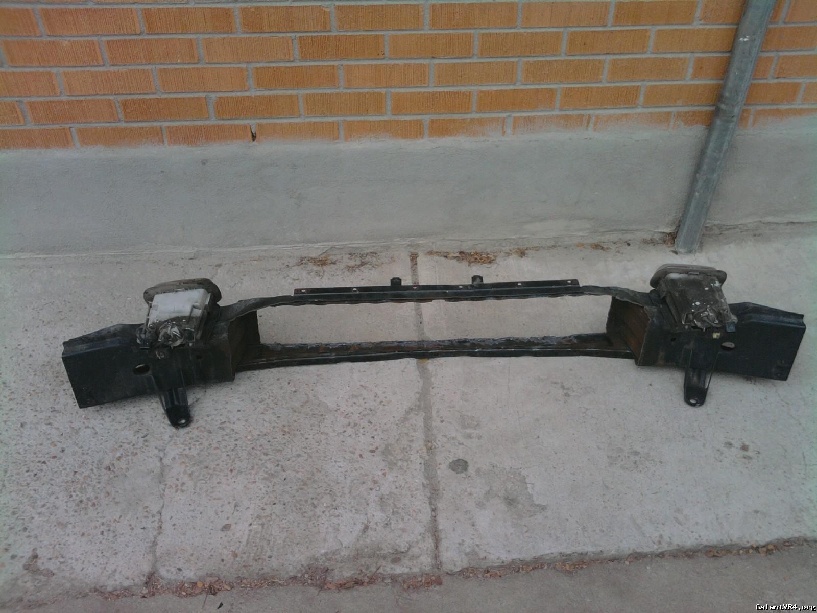

I have a JDM front bumper on mine so no need to worry on cutting my bumper support. I have the usdm bumper and already cut the support to fit a FMIC. I cut it that way so my bumper wouldnt sag and the foglights could be used while having a decent size core on there. It currently has the evo 8 fmic with the flipped elbow and the usdm front bumper

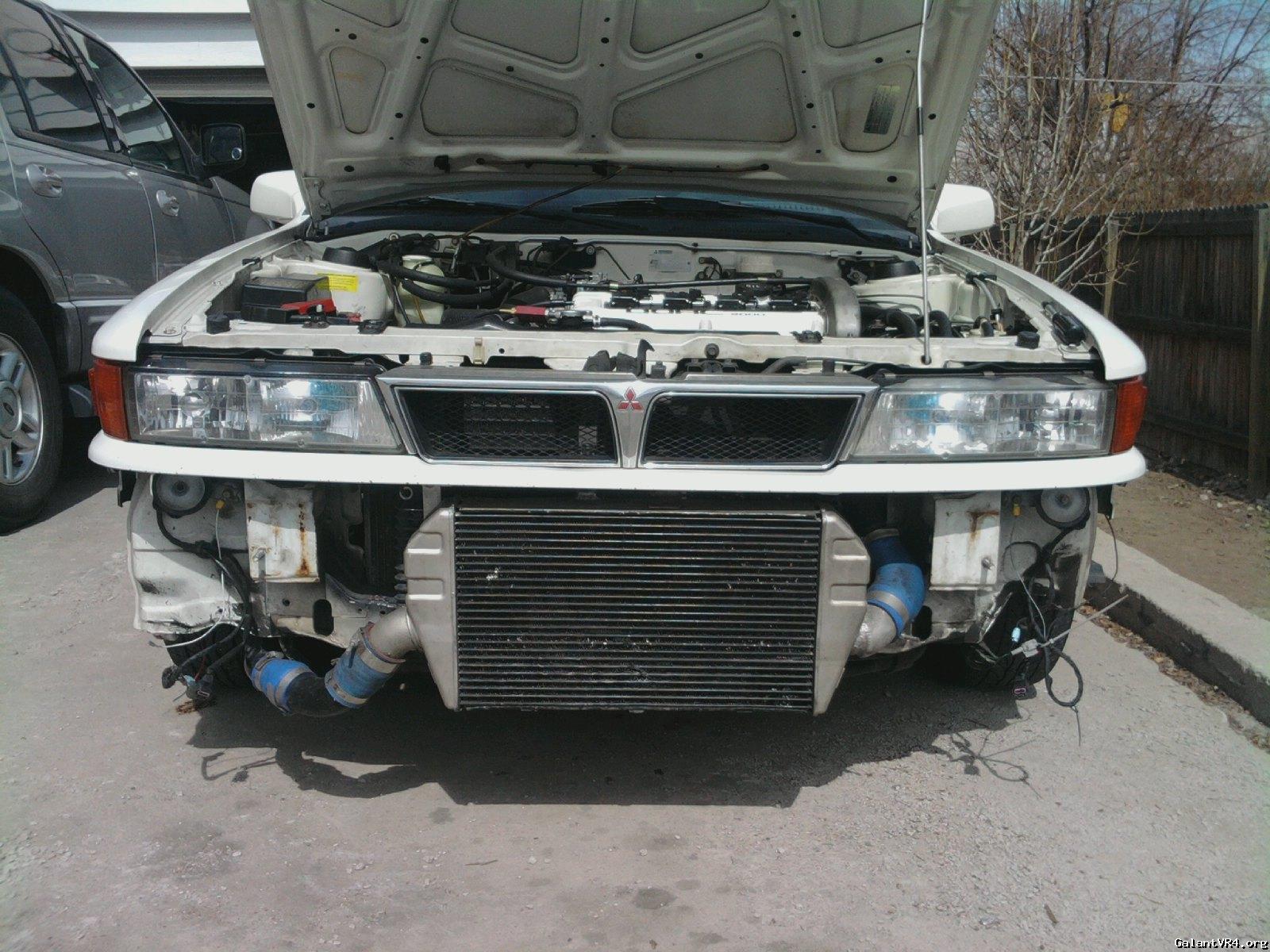

4.5x24x17 behind an almost uncut Evo factory front bumper support.
Most kits require removal of the bumper support for anything 4" thick. Mine is half an inch thicker and kept it.
I see what you are talking about with the core tank inlet/outlet positions though. It is sort of the reverse of what I did with the one on my Galant. I welded a 90 on the driver side of my stock Evo 8 IC to meet the factory hose. The passenger side runs through the factory pipe as well.
If I can find a picture I'll get it up here.

Didn't mean to start a sidebar so, on topic, I do think the Exo X IC is better suited for the GVR4 than the 8-9 core, judging from the inlet/outlet layout. That being said, 379 is getting a custom job like her younger brother.
/brox
By looking at it, doing the flip around with it, the end tanks look to be in the perfect location for a gvr4. I'm interested to see how this turns out. Post pics when you decide to tackle it.

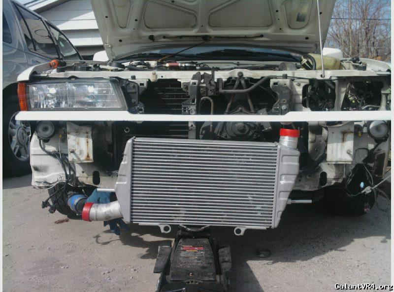

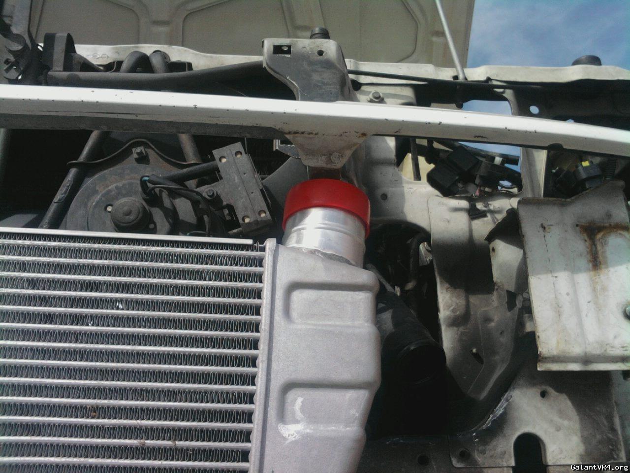

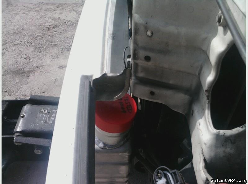

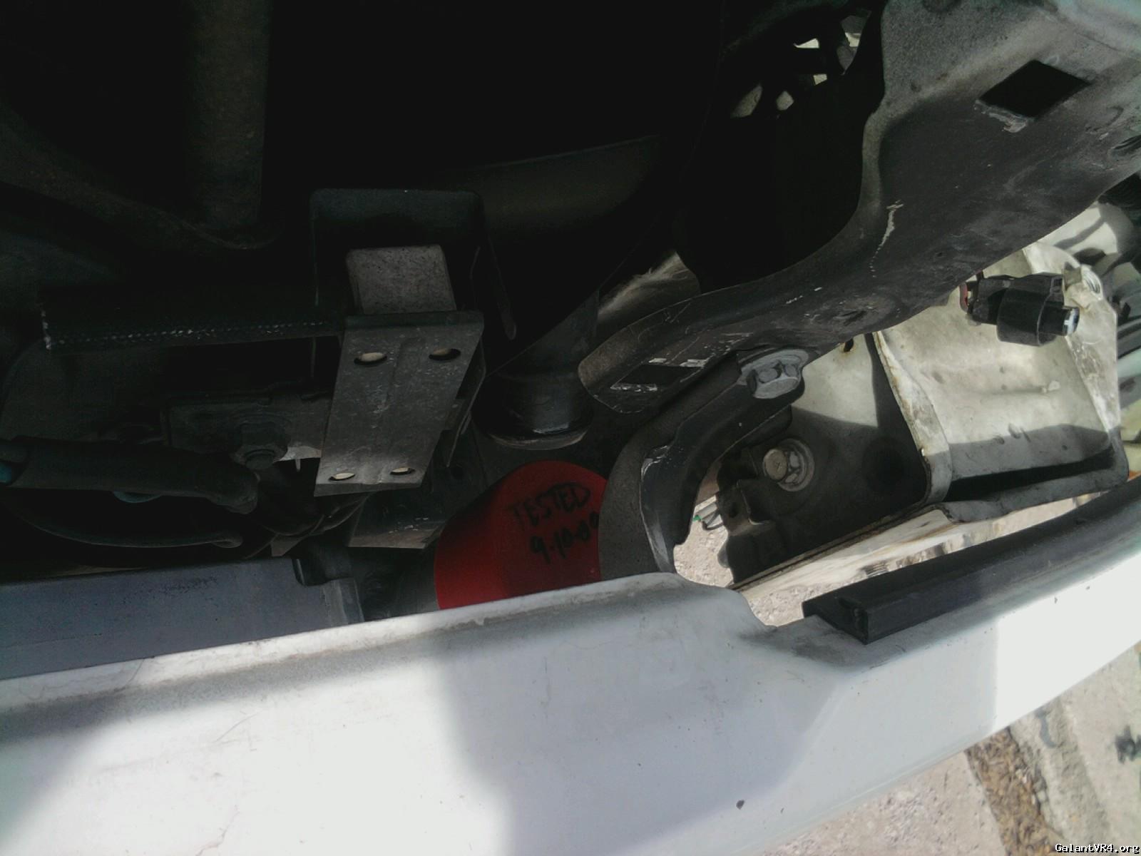

Here is my current set up with the evo 8-9 IC
If the evo X intercooler is centered thats what it would look like and would not fit. It it moves to the drivers side a bit it still wont fit because the endtank will hit the head light. I would rather keep the 8-9 IC and not have to worry about doing alot of modifications to get the X IC to fit. Please feel free to comment if you have a idea of how it might work with little modifications before I decide to sell it.
