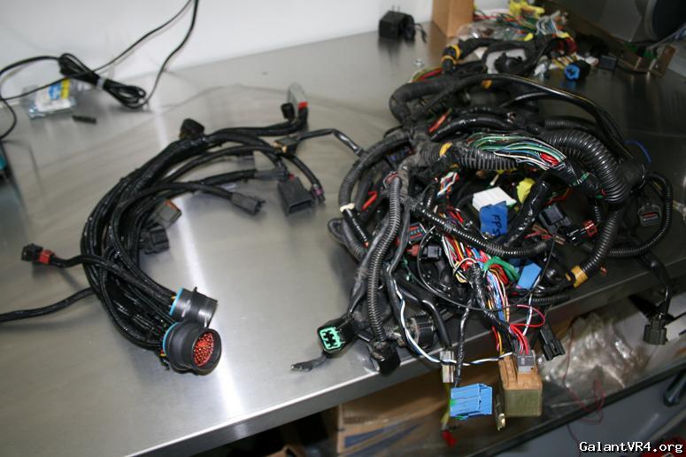

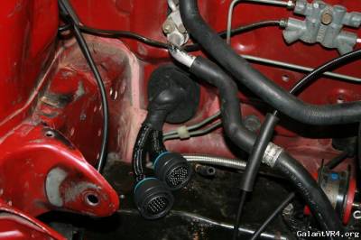

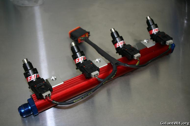

I was just on dsmtalk.com and I saw a thread with a guy that redid his wiring harness and used these connectors.
I have already ordered and I will soon start on my harness. Here are some more pics of his work.
