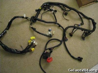

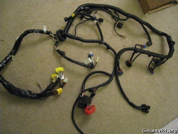

Heres the reason I want to use the 1g harness....Brand new.... /ubbthreads/images/graemlins/smile.gif
It would be easiest for me to use this harness rather than try to source a vr4 harness. So I need some help here.
