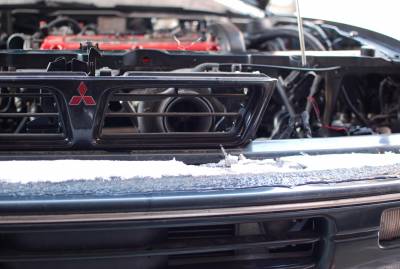

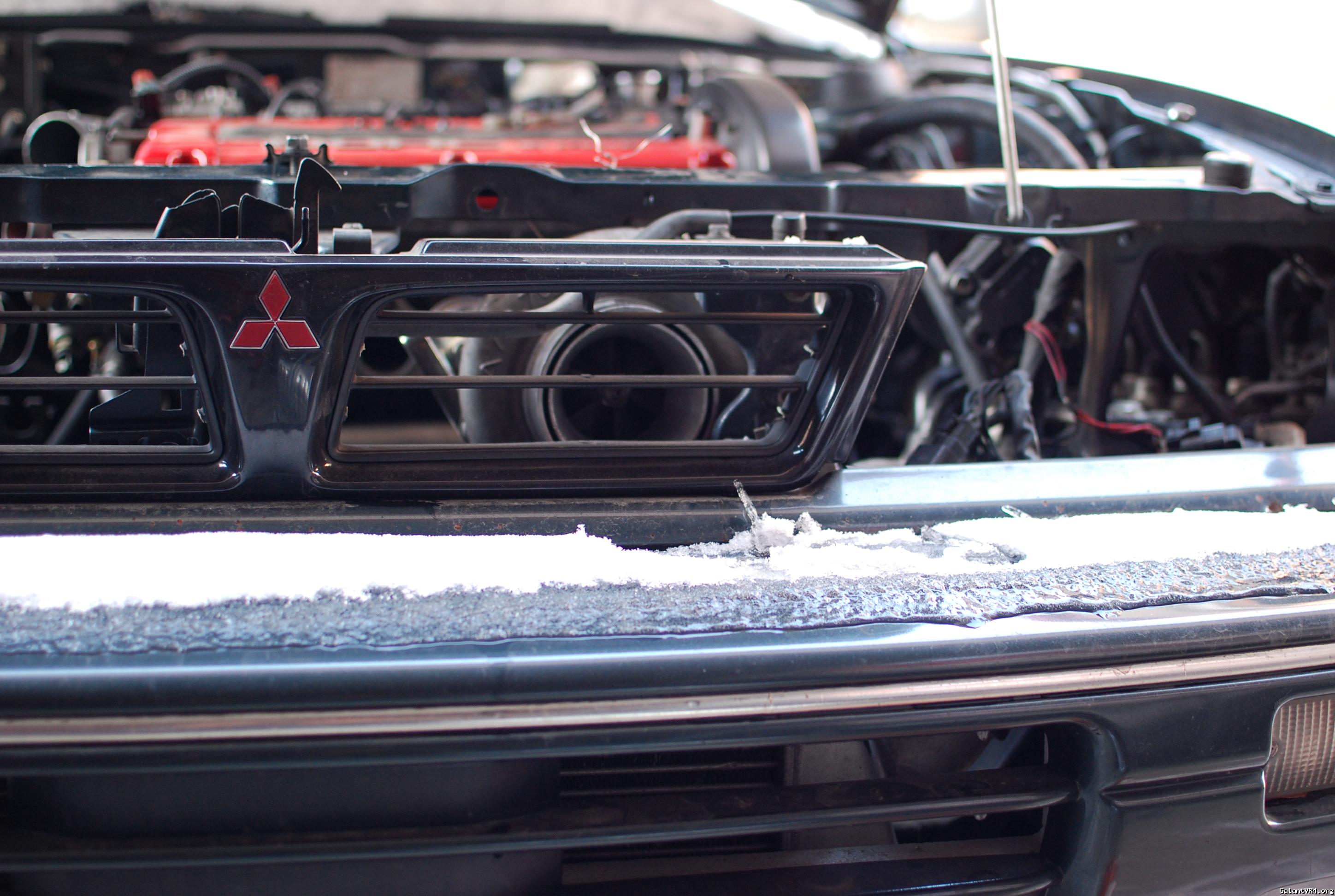

something cool to come from me and jon in the next few months.
The approximate new home for the snail. /ubbthreads/images/graemlins/smirk.gif No its not necessary but i like to have custom items no one else has.

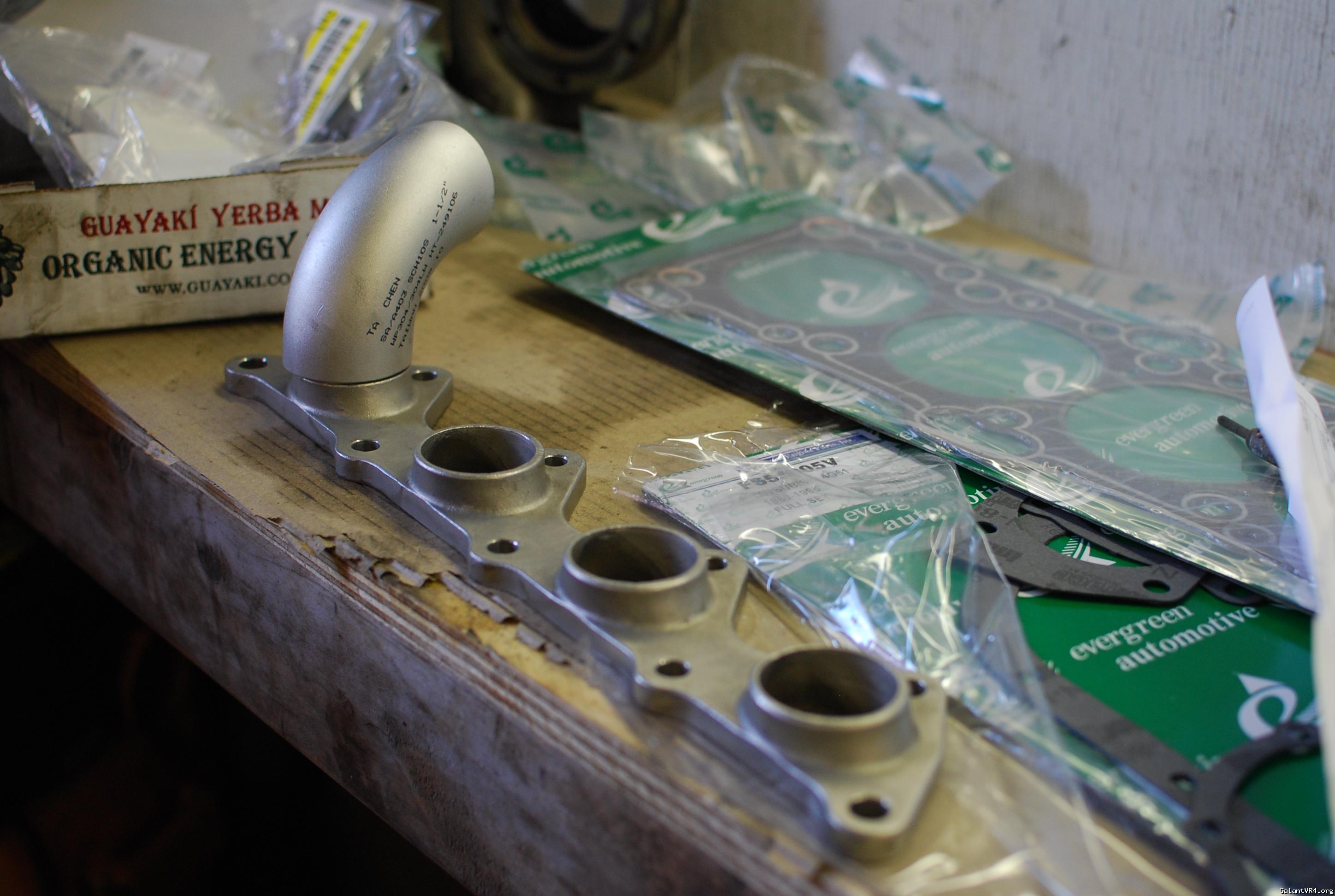

I wouldn't use the head gasket in that pic. I bought the same gasket set (eBay junk), and it blew within the first three miles. Definitely worth the extra money for a MLS gasket.

He isnt using those gaskets. Someone gave them to Jon so he could install on a car he was working on but I believe Jon got gaskets that were not ebay junk. Those are just sitting there on his work bench and will most likely be thrown in the trash.

As far as head gaskets go Im going to be sticking with an HKS MLS gasket. TRBODSM is right, we acquired them from a customer and as you can see its pretty much complete except an oil filter housing gasket, these will definitely find themselves in a land fill soon enough.
The exhaust flange is from AMS good quality piece.
