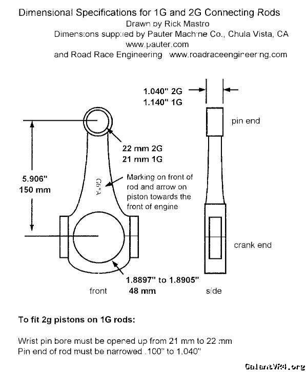

The wrist pin bore needs to be opened one millimeter, and the smaller end of the rod needs to be narrowed .100" for the 2g pistons to fit. That was taken from dsm talk.
Hill
Here is a picture
Quoting BoostedAWD91:
there is more work needed to fit the 2g pistons on 1g rods, thats why its more expensive.
I already know what's required to fit 2G pistons to 1G rods, that's why I don't understand why it would be so expensive. My rods got more work and only cost $150.
