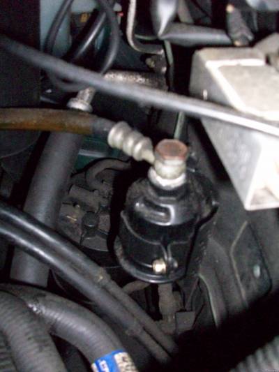

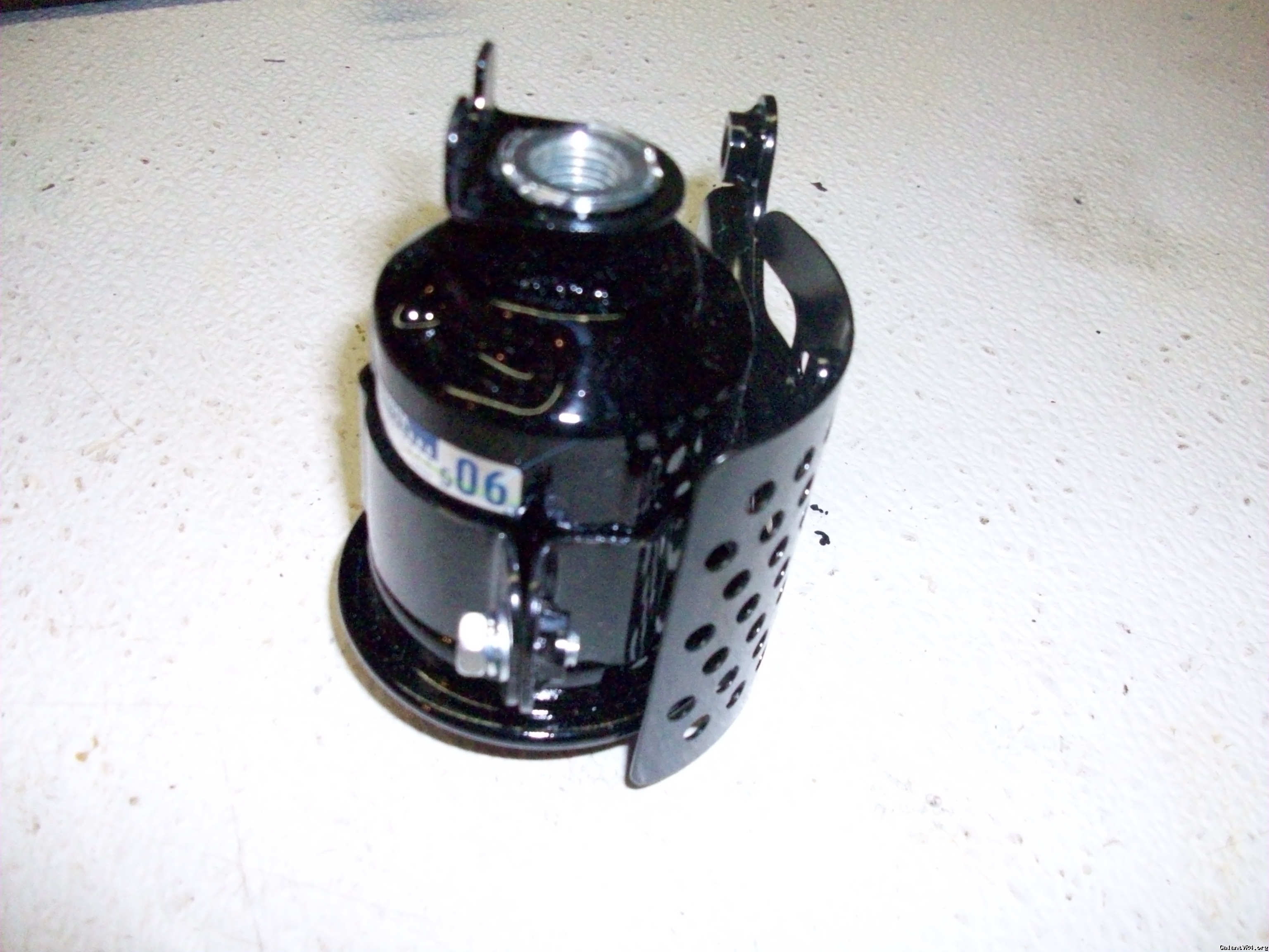

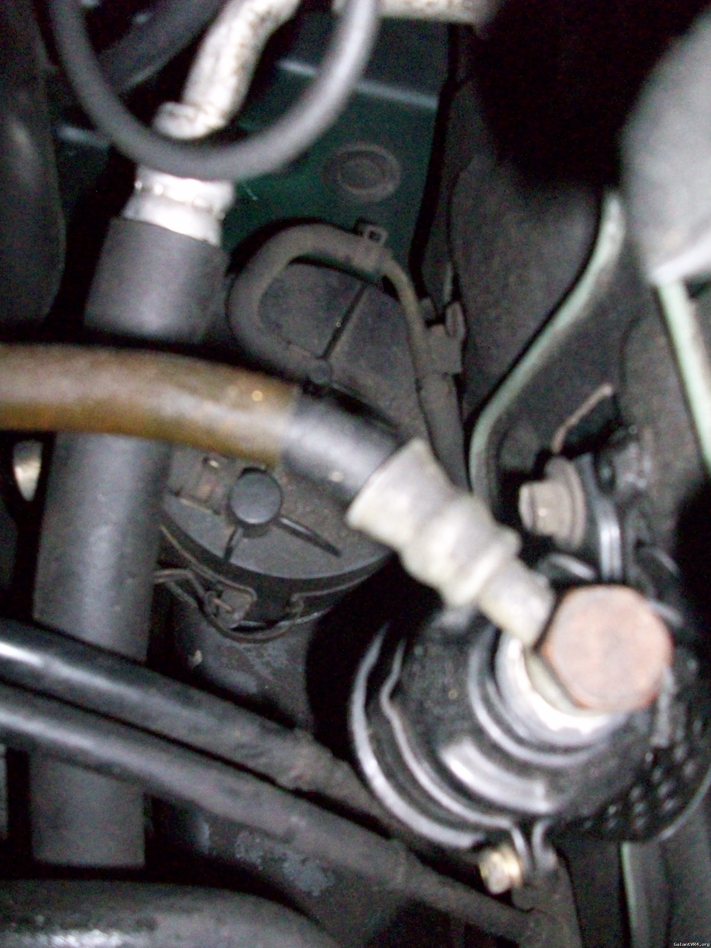

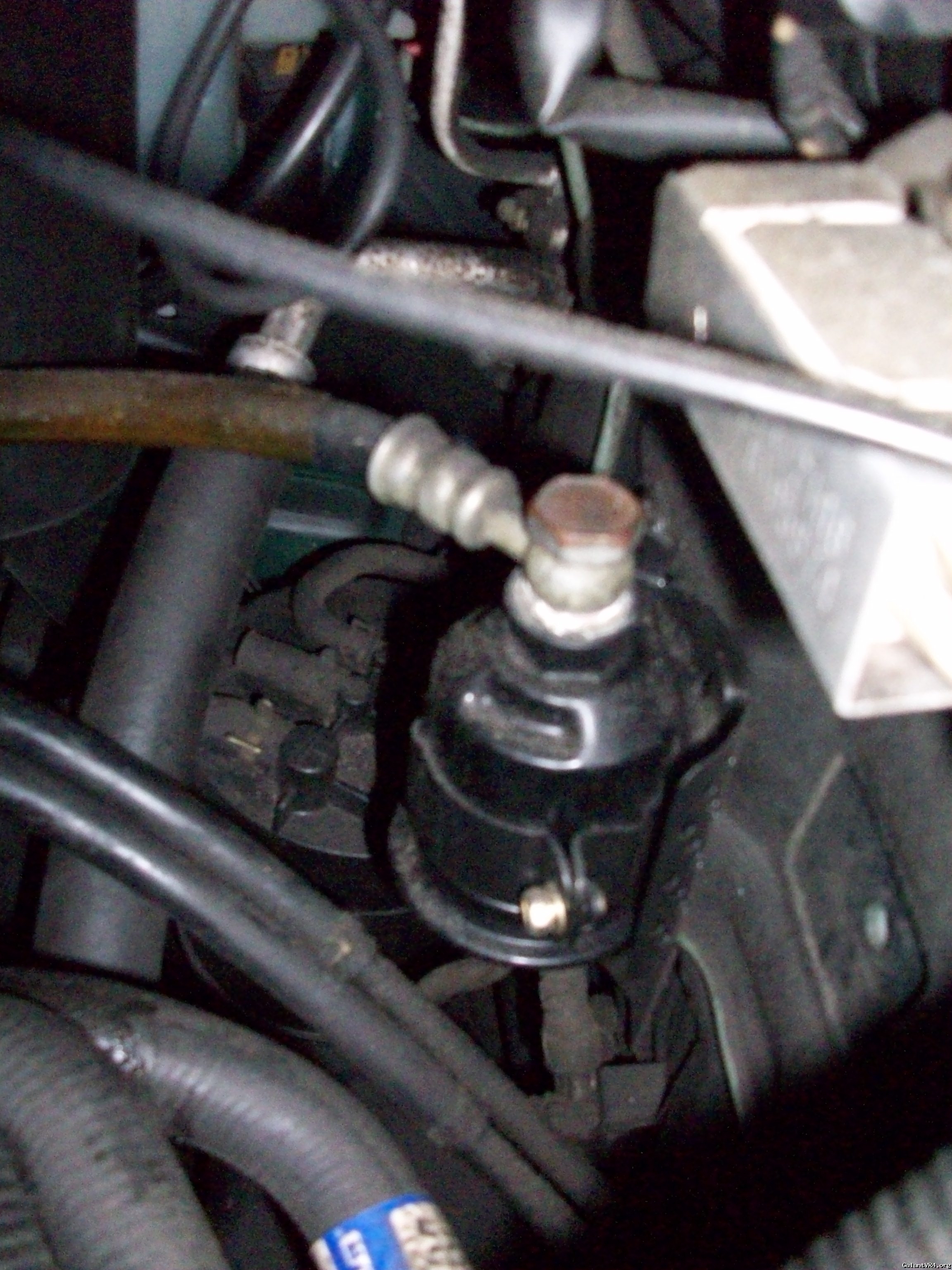

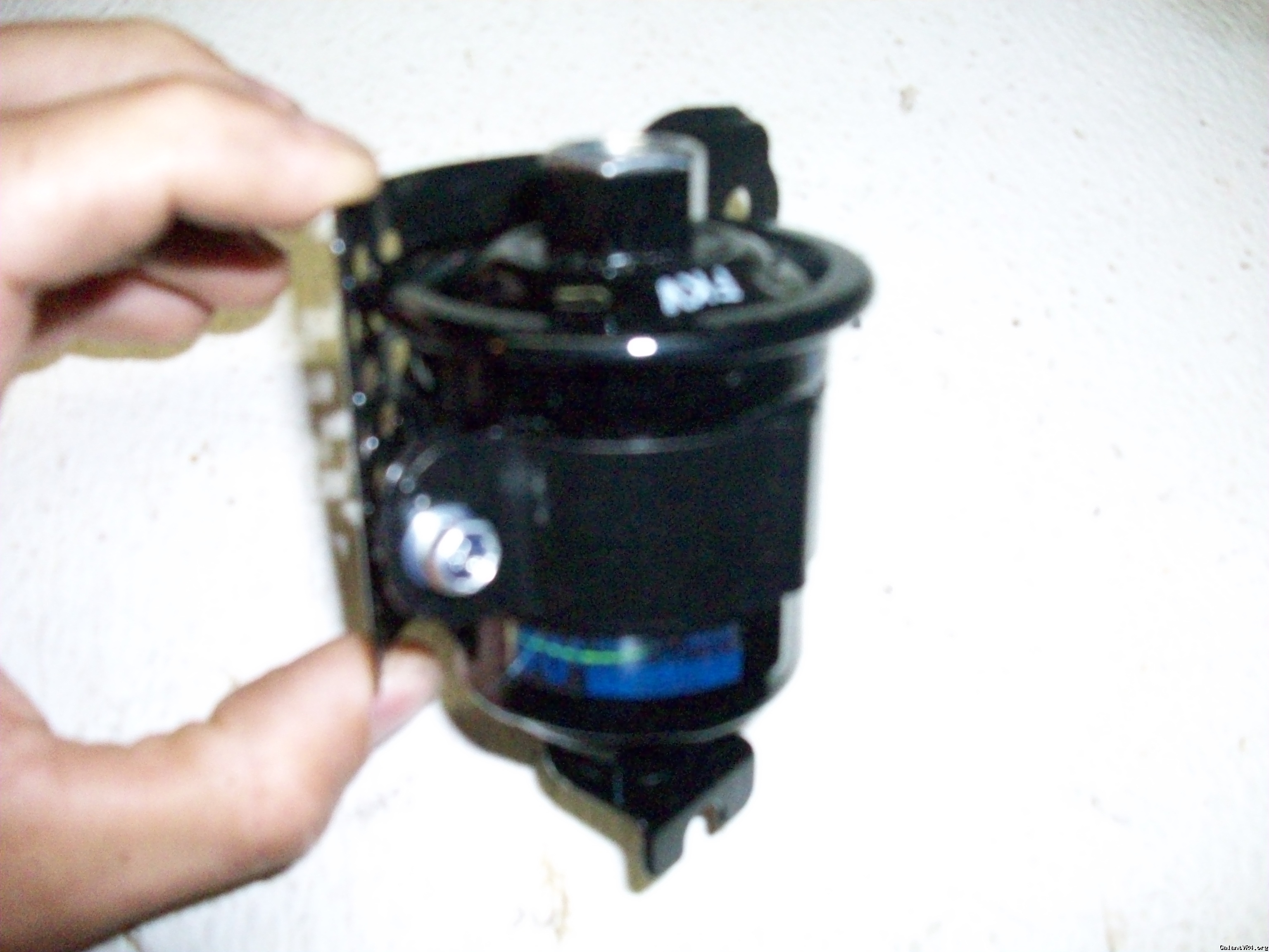

I am running one. Minjin told me about them years ago. The fuel lines bolt right up. It mounts to the firewall different.
GVR4_1057
Sep 3, 2008
678
Brucetown VA

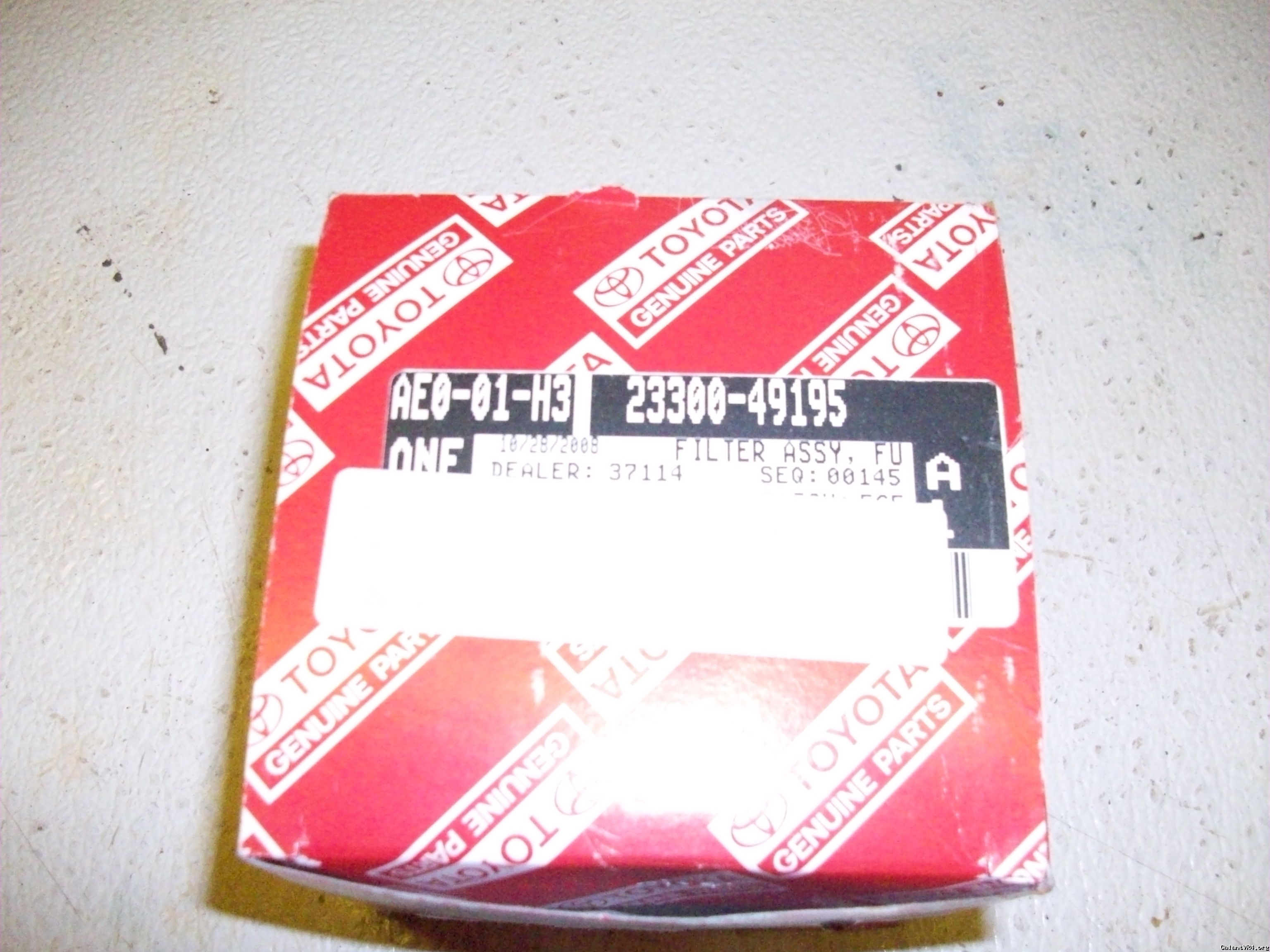

It has less restriction than the stock filter. I got those dates from Wikipedia. I am not too fluent in supra /ubbthreads/images/graemlins/dunno.gifIt is the Mark IV TT supra filter that you want. They are only like 15 bucks or so from JNZ.
