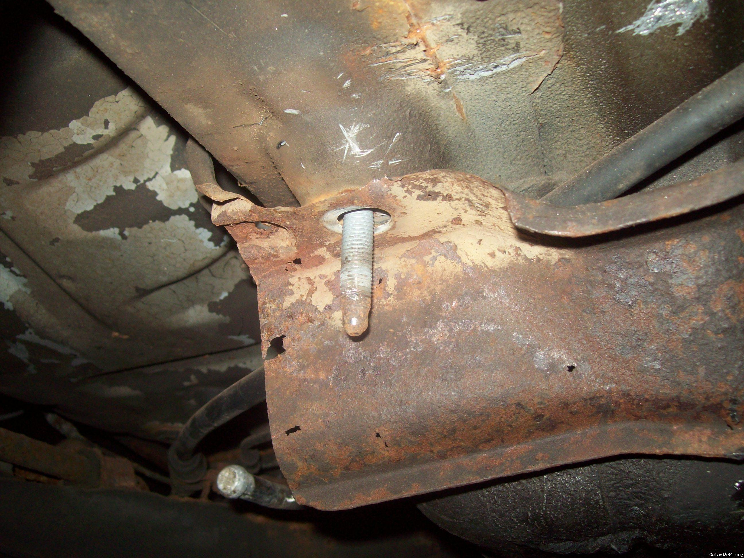

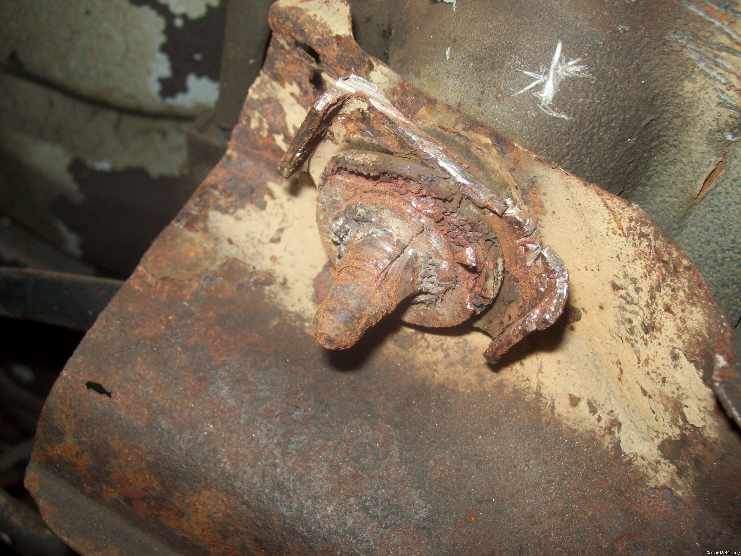

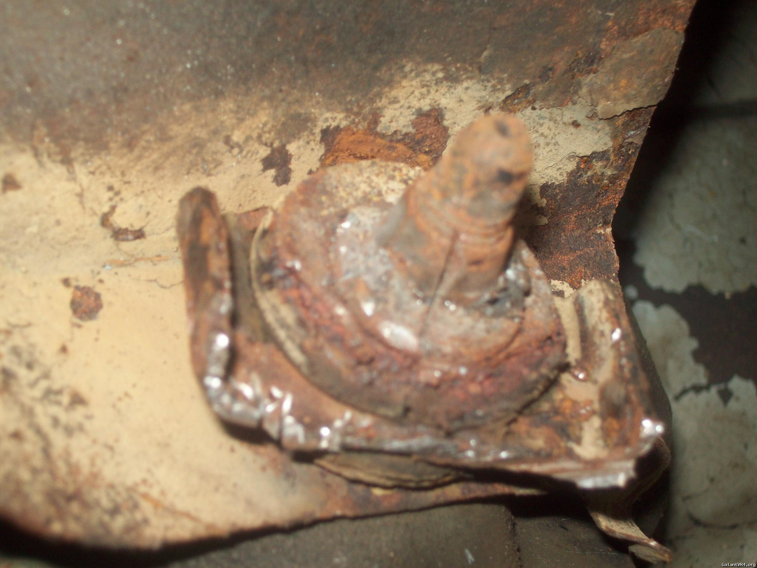

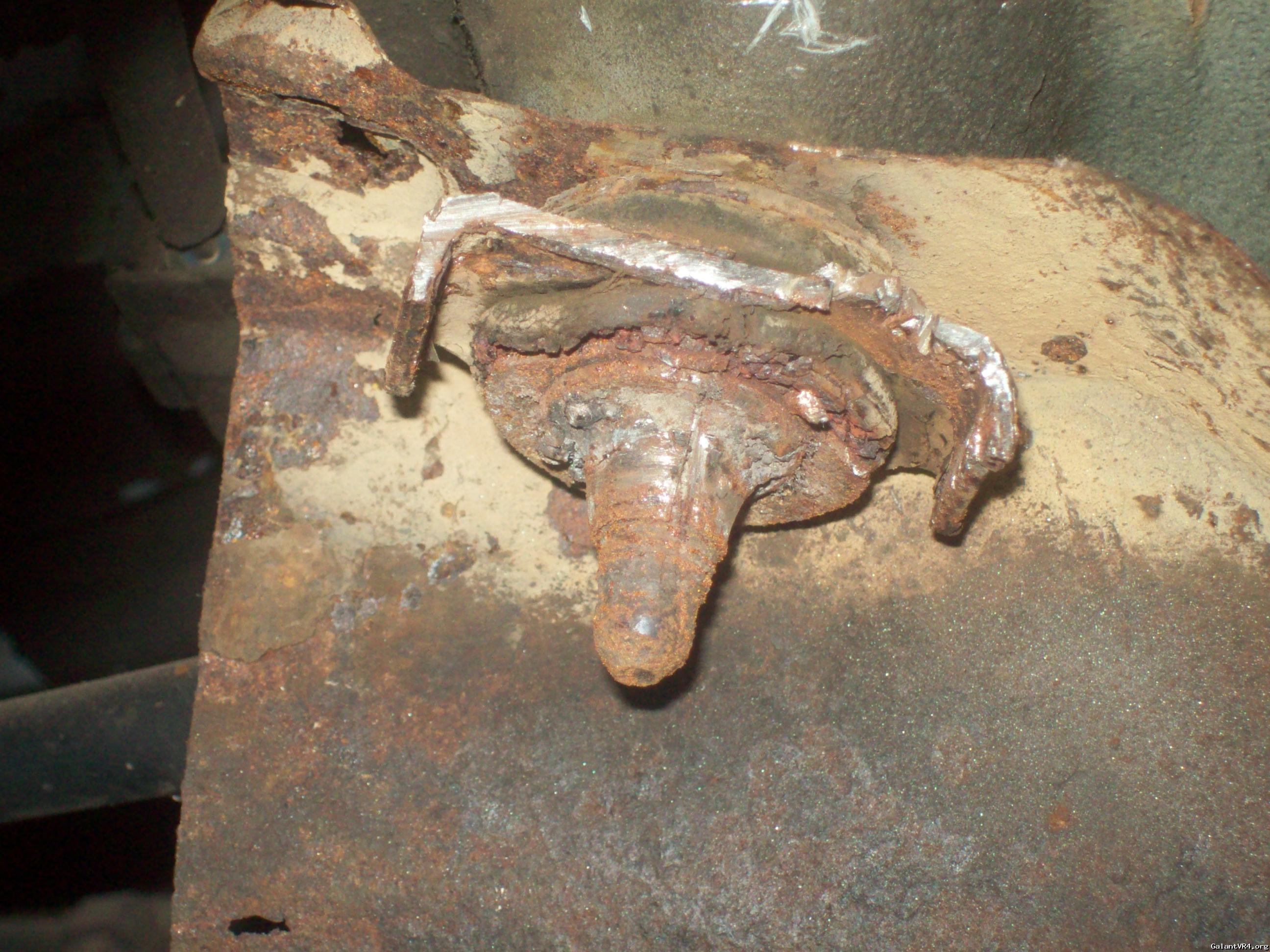

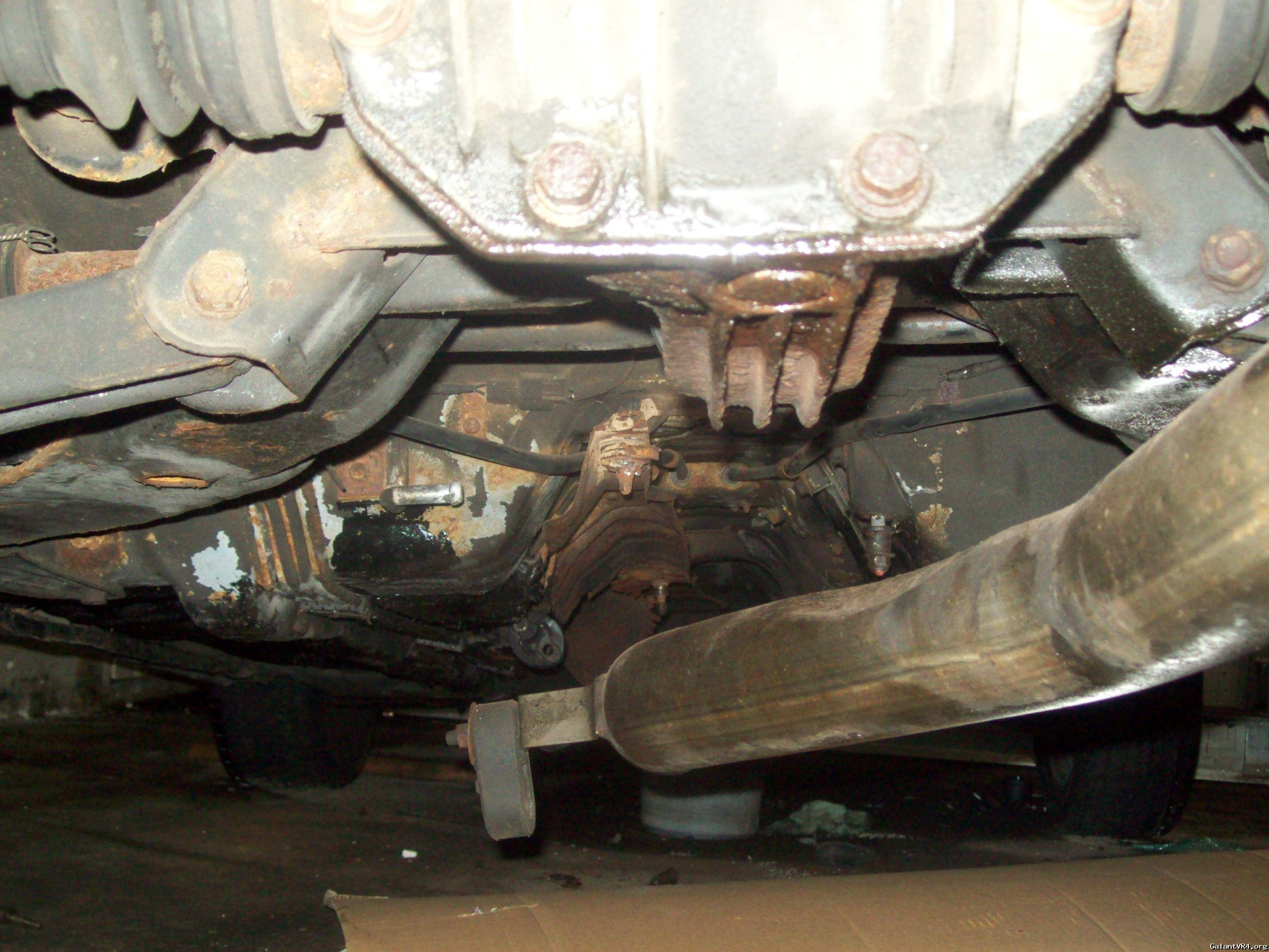

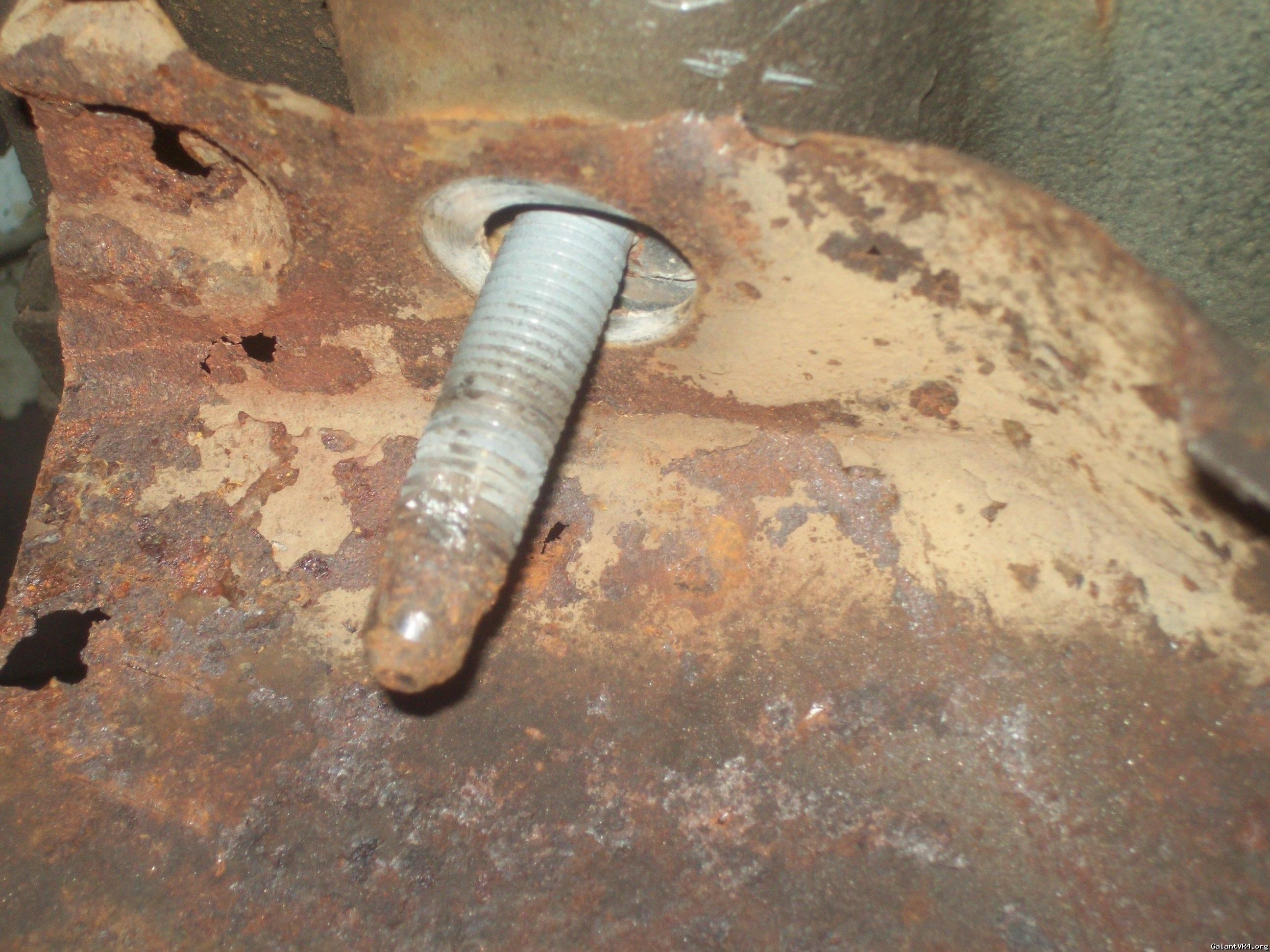

here are some pics of the damage, as you can see in the pictures that i started cutting but not sure if this is the right way. /ubbthreads/images/graemlins/dunno.gif

Since you've slotted the nut a bunch already you may be able to get a chisel in there and gently pry the nut apart to get it off now. If it does come off I'd still lube and chase those threads with a die and use lot of anti-seize when reassembling. You may not need to replace the stud at all if you can clean up those threads. It's hard to tell from the picture how bad they really are. But it looks like you won't need to replace the stud if it cleans up alright.

So far so good but SPRAY the F*er!!!! It should have been soaked w/ at least PBlaster. I would still spray and let it sit before trying to pry. G/L.
EDIT* Someone please post thread size. Run to Sears once its off and clean up the threads the best you can before putting it back together. /ubbthreads/images/graemlins/wink.gif

Got it, it actually came off pretty easy with an air chisel. Now i just gotta rethread the stud, and order the washers and spacers from extremepsi.

/ubbthreads/images/graemlins/applause.gif Yea that thread looks fine underneath. Run the die over that thing and you'll be good to go!
