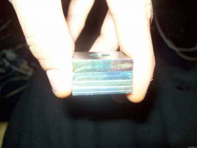

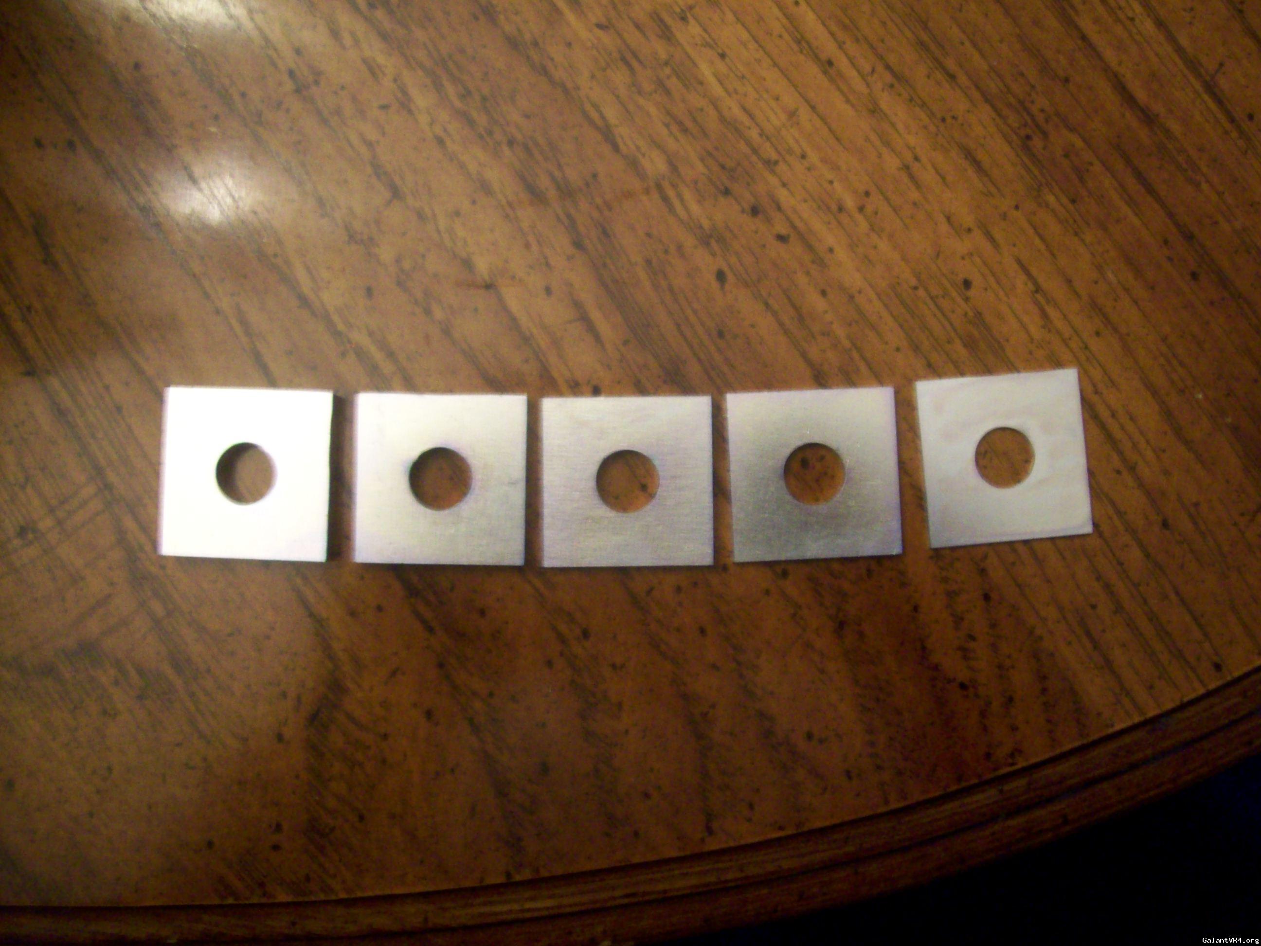

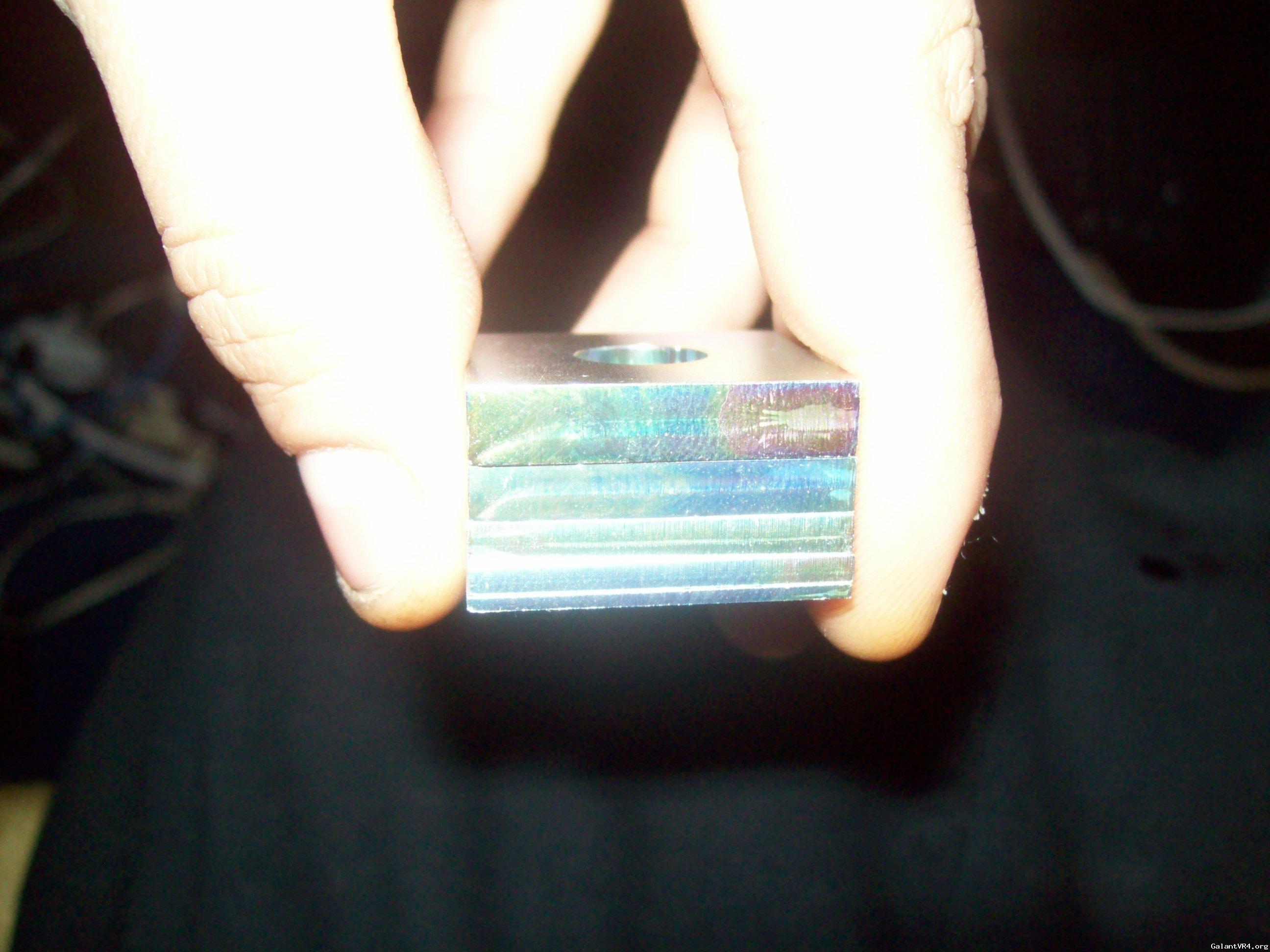

Has anybody installed these spacers that extremepsi sell for the driveshaft support bearing. they look nothing like OEM, each spacer is thicker then the other one, theres 5 for each side of the carrier bearing. /ubbthreads/images/graemlins/banghead.gif i need help i dont wanna install these wrong. heres some pics.

They look exactly like the OEM ones, except they look to be made from aluminum. You're not supposed to use ALL of them, it's basically a grab bag of different sizes that you put in the high spots to make them lower. It's likely that you will have to double up on a few or buy a few of the kits to get it balanced right.

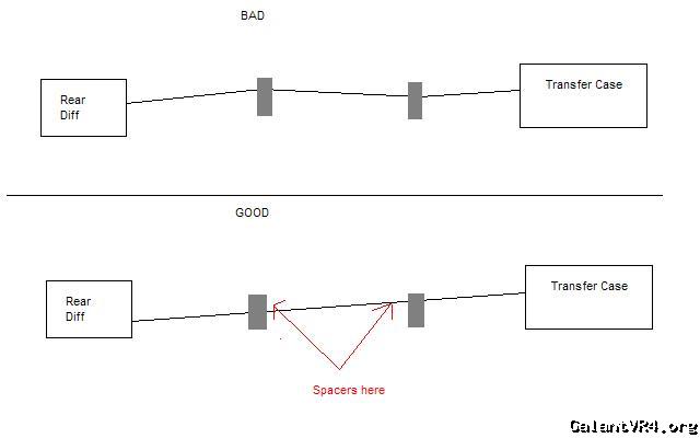

You're just trying to shoot for keeping the 3 sections of the driveshaft all on the same plane, so that under normal circumstances each joint isn't actually at any angle.
Like This:
Someone correct me if I'm wrong!

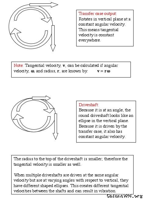

You're exactly right. Its all about angular velocity.
