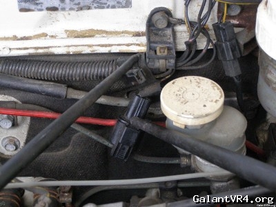

Just for future reference, here's a pic from the vfaq:
This is a pic from a GVR4, showing where this plug will be taped to a wiring loom near the center of the car at the firewall.
The above is from this vfaq page: http://www.vfaq.com/mods/BISS-1G.html
