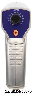

i have a timing light with a manual dial to adjust / advance timing.
i dont have a manual on how to use it. i got it for free.
(flame suit on) to use this timing light to set base timing, i ground pin by firewall, hook up leads to ground , positive, and plug number one.
my question is, do i set the manual dial to five or to zero?
thanks in advance.
thanks for the replies. but i think i explained my self wrong.
i am talking about the dial on the actual timing light. like the one in the picture. do i set the dial to 5 when i set base timing or i set it to zero?

After everything is connected as you already stated, engine at full temp, and a steady 800 revs, if you leave the dail at 0, then turn CAS so the mark is at 5 on the timing cover. If you want to turn the dial to 5, then adjust the CAS so the mark is at TDC, or 0 on the timing cover.
The dial takes all the guess work out of it. Questions like advanced timing, or retarded timing based on looking at the scale on the timing cover.
