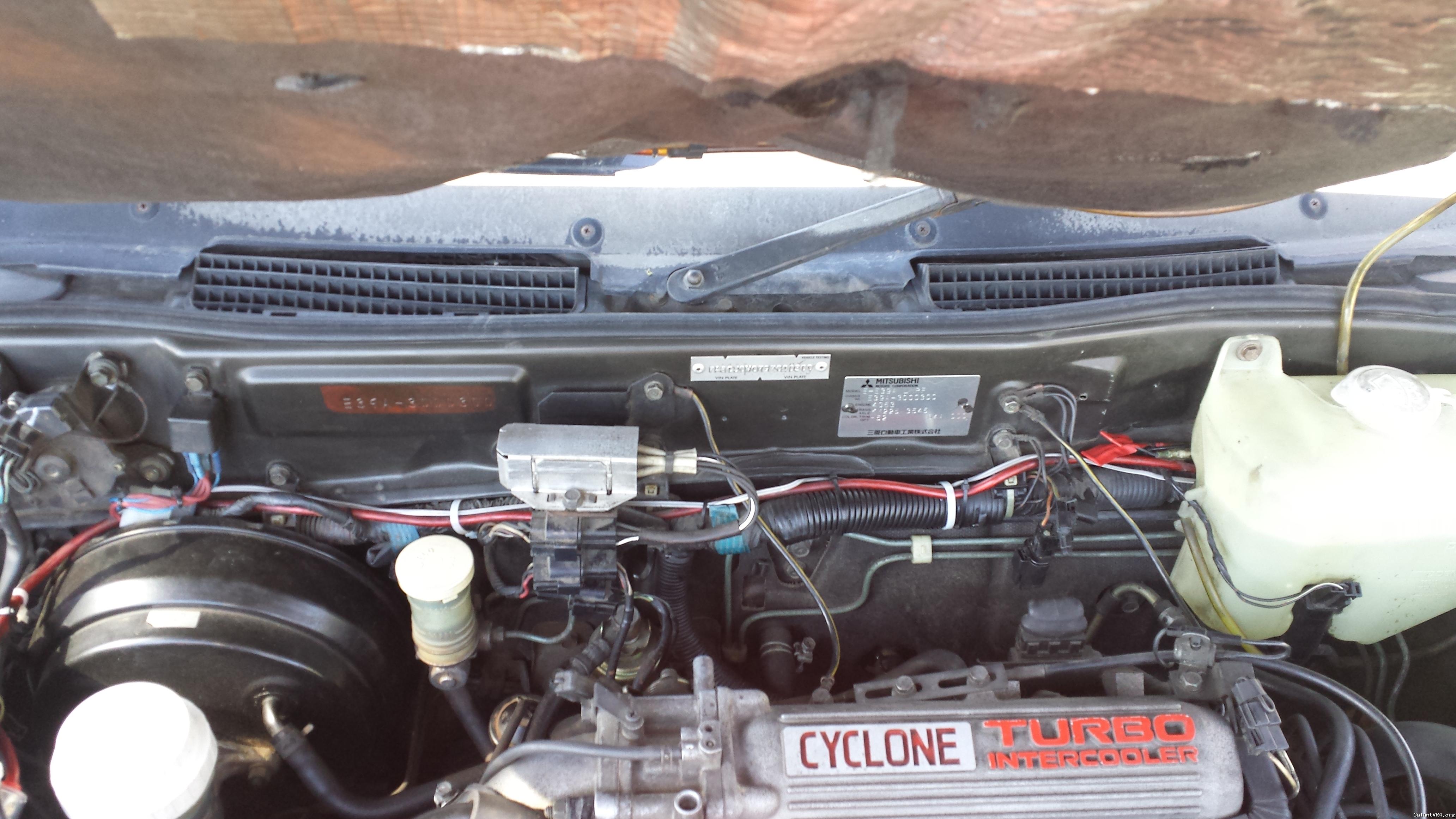

So will that mean taking the brake booster out to get to it? Cant see it just looking. Ive had another person telling me its beside the water washer bottle

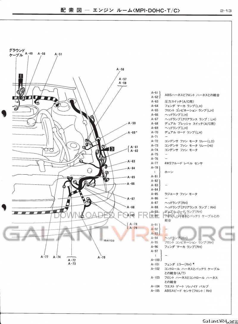

it is A-50 in this diagram:

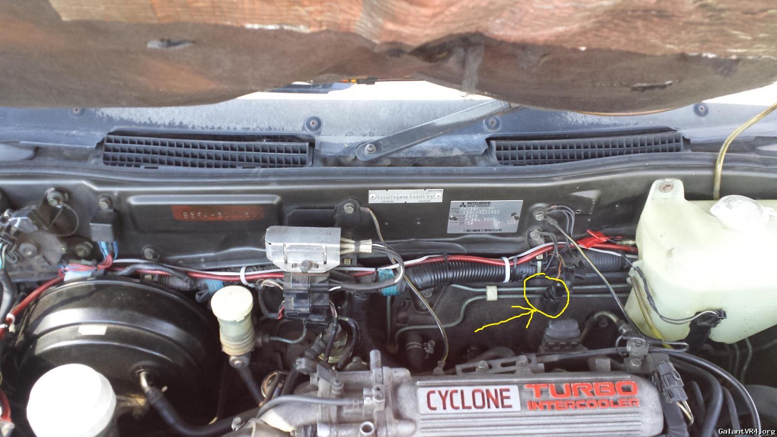

just to the left of the washer bottle, just below where the two 10mm ground bolts are attached to...
it isn't a brown plug.
it is the bigger of the two black plugs...with the Yellow-Red wire
here you go!
