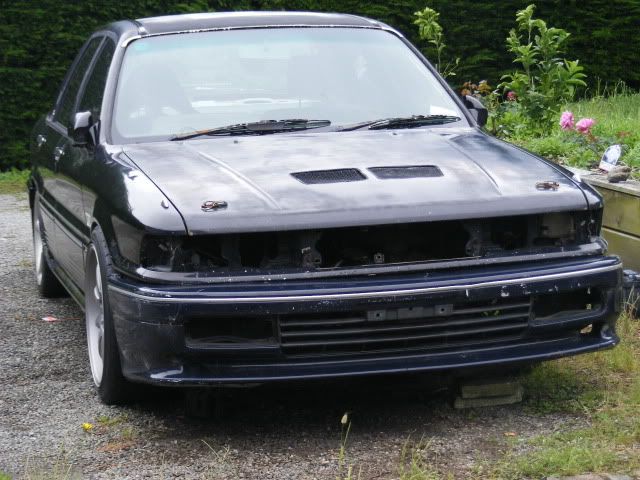

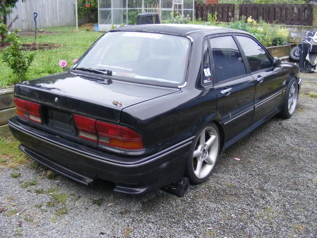

only one corner thus far due to rain, anyhoo, that's an 18"x9" +30 with a 235/40 - note: brake disc is not fitted pending some holes being drilled, so wheels will sit further out by thickness of the disc hat - guards will need to be pulled slightly, at present however it clears when the suspension compresses thanks to the camber gain.
Edit: last pic is cropped from a shot of the whole car, which is why it looks like it's got positive camber - it's actually quite neg (2/3rds on cusco camber tops)

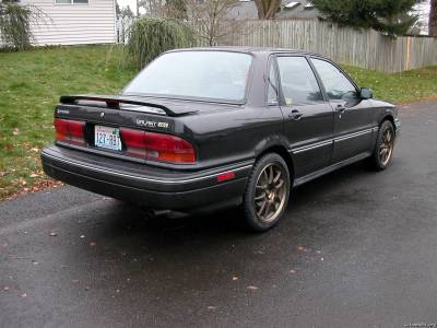

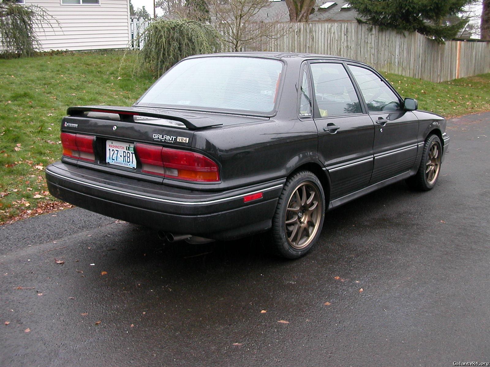

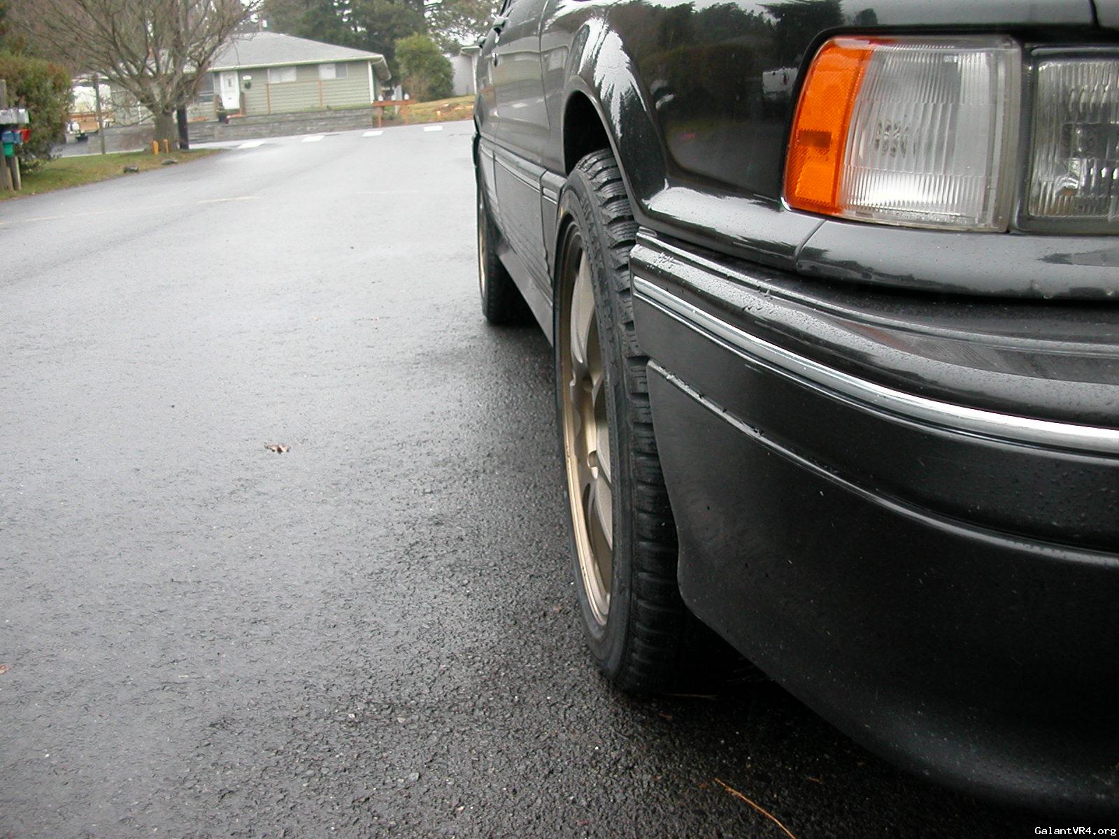

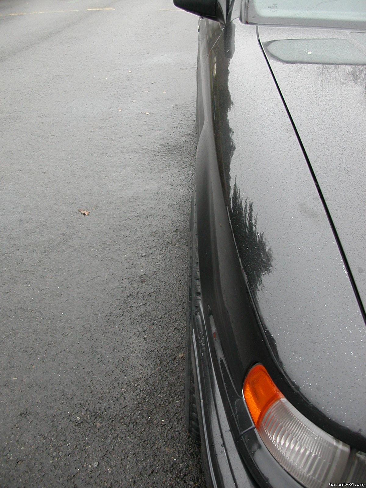

Rota Torque 17x8 45mm offset 245/45R17 bridgestone blizzaks. The rear rubber barely rubbed on the trailing arm, so I just ground down the seam a bit and now there's no problems. I have stock suspension, so I dont really have to worry about getting the tires to tuck, but with some camber, they probably would (turbowop's 1051 has 35 offset 17x8's that do). If I had purchased spacers for the rear to get them out to where the fronts sit, grinding the trailing arms wouldn't have been necessary.
