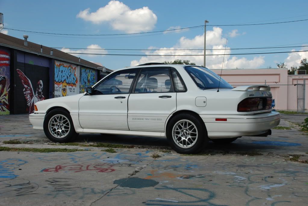

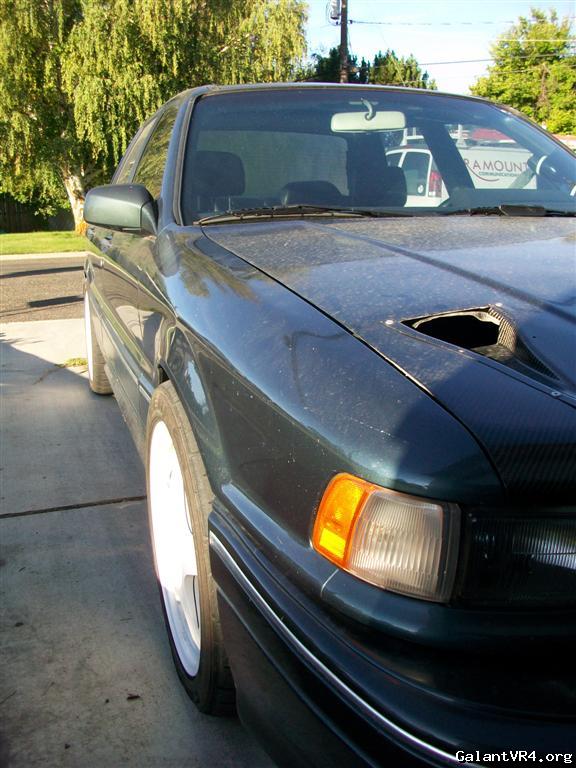

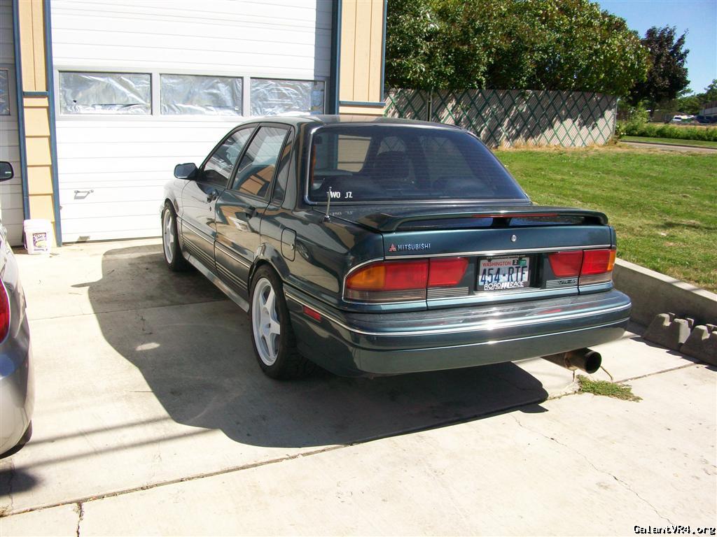

I'd like to take this opportunity to show some pics I took of Karter's car.
17" x 8.5". I dunno the offset. 255/40r17 Falken Azenis.

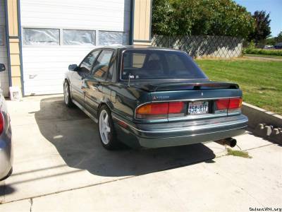

i dk about crazy... but just thought i would through it out there, i'm running 225/40/R18's. i know alot of ppl have 17's i dk how many ppl have 18's. probly alot :p all i know is i don't have alot of room in the wheel well.

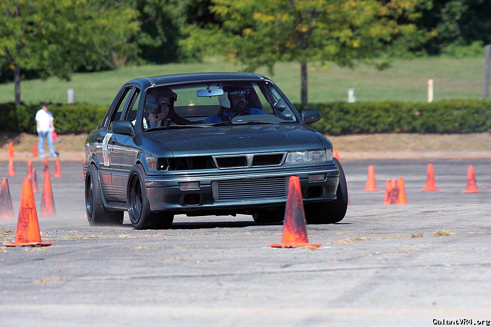

Yes, it is sticky, I think I've finally got enough tire. Offset is +48, but I'm running a 5mm spacer in the rear.

I assume coilovers are a must? That's like stock sized offset in the front, but 2.5 extra inches.

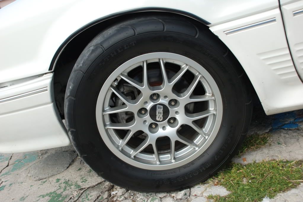

P255/50/R16 Mickey Thompson ET Street Radials /ubbthreads/images/graemlins/crazy.gif
BBS 16"x8"
H05TYL
Jun 9, 2007
752
Wgtn, NZ
full specs would make this thread more helpful.
diameter / width / offset + tire width / profile
please /ubbthreads/images/graemlins/smile.gif
MMCVR4
Feb 16, 2005
740
Quoting ZeroCharisma:
BBS 16"x8"
Looks nice! Like the meaty & bossy look.

Quoting turbowop:
Yes, coilovers are a must, and in Karter's case, some other custom work as well.
Other custom work as in how? Rolled fenders? Some frame modifications. I'm always down/interested in fitting more rubber underneath my wheel wells.
11,983
To clear the tires he had to raise the perches on the coilovers to sit above them. Normally that would make the car sit rather high, but he moved the camber plate to above the strut tower in order for the car to sit lower. I'm still not convinced that's a great idea, but if it works out, I'd be tempted to do it as well to gain some travel on the front of my car.
In the rear, he had to grind down and weld the trailing arms to clear the tires. Having a large enough offset to tuck the tires also means pushing them into the trailing arms.

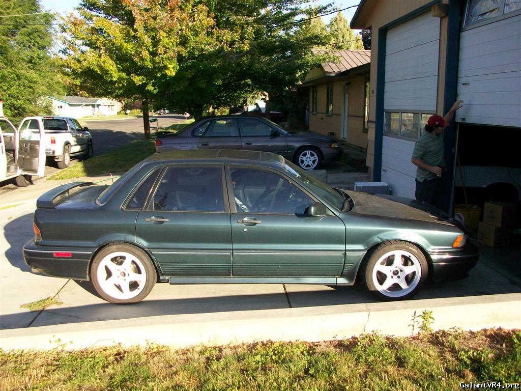

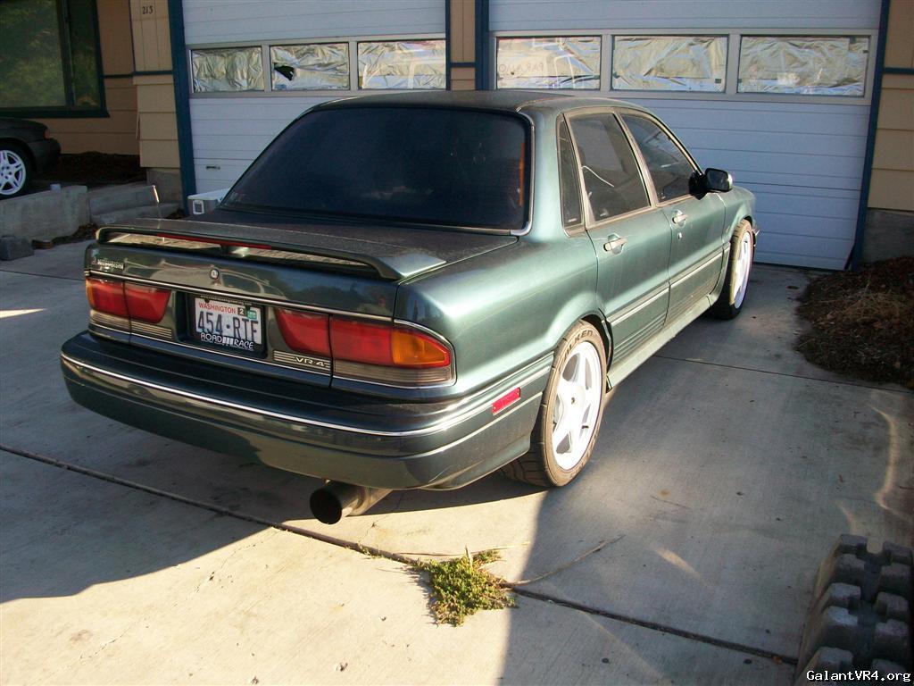

mark are you referring to vr4play's car or kartar's vr4?
i would like more info on vr4play/mjrosenfelds wheels. i have a place in milwaukee that makes wheels that i am debating on them make a custom offset wheel for me.

vr4play's car with mj rosenfelds wheels
