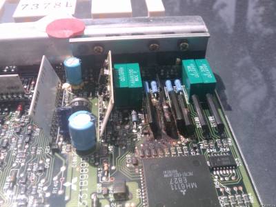

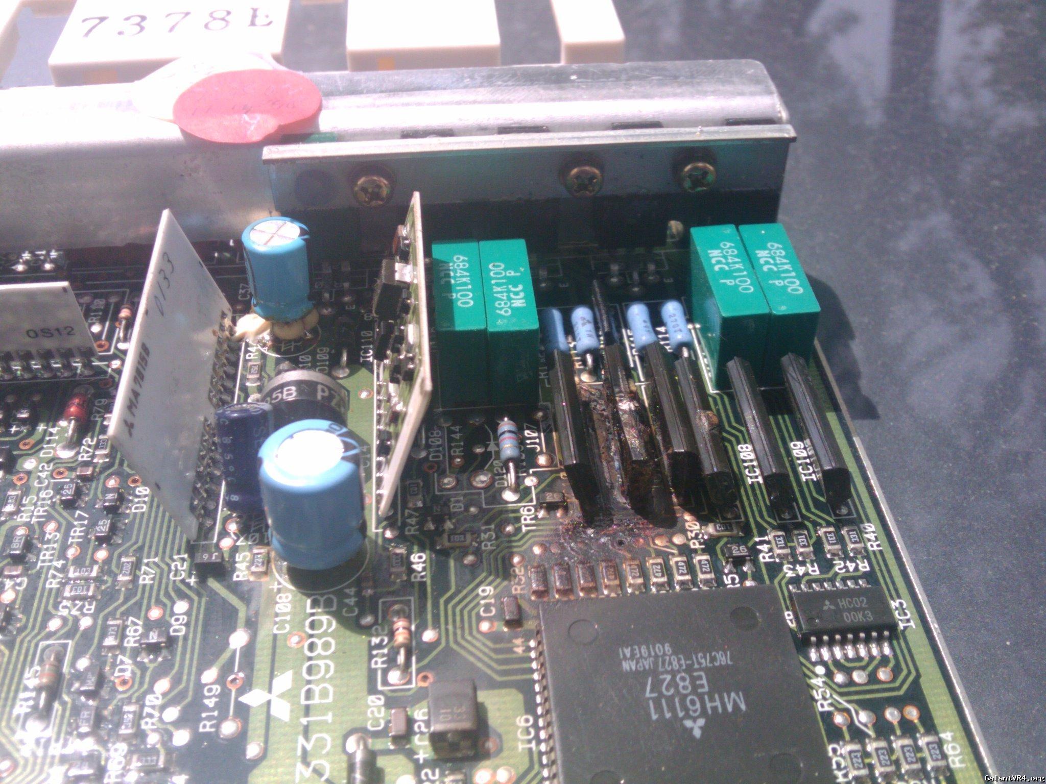

Someone will likely correct me but I believe those are the ISC drivers. A faulty ISC will fry them and it'll do it again to the next one. Replace the ISC motor (or block it off) before you replace the ECU.

Yes, ISC shorted out causing a blown driver.
Yes, 1G ECUs are the same but have a different eprom chip, but it will run as long as it is for a 5speed. Auto ECUs are programmed for smaller injectors.

What would cause it to short out? I bought the isc a few months ago from autozone with warranty(maybe not the best idea?)

The chip might have already been cooked by your old ISC. The new ISC is probably fine. I replaced mine and then found the smoked driver later when I was checking the caps for leaks. There's a simple procedure to check it ISC CHECK

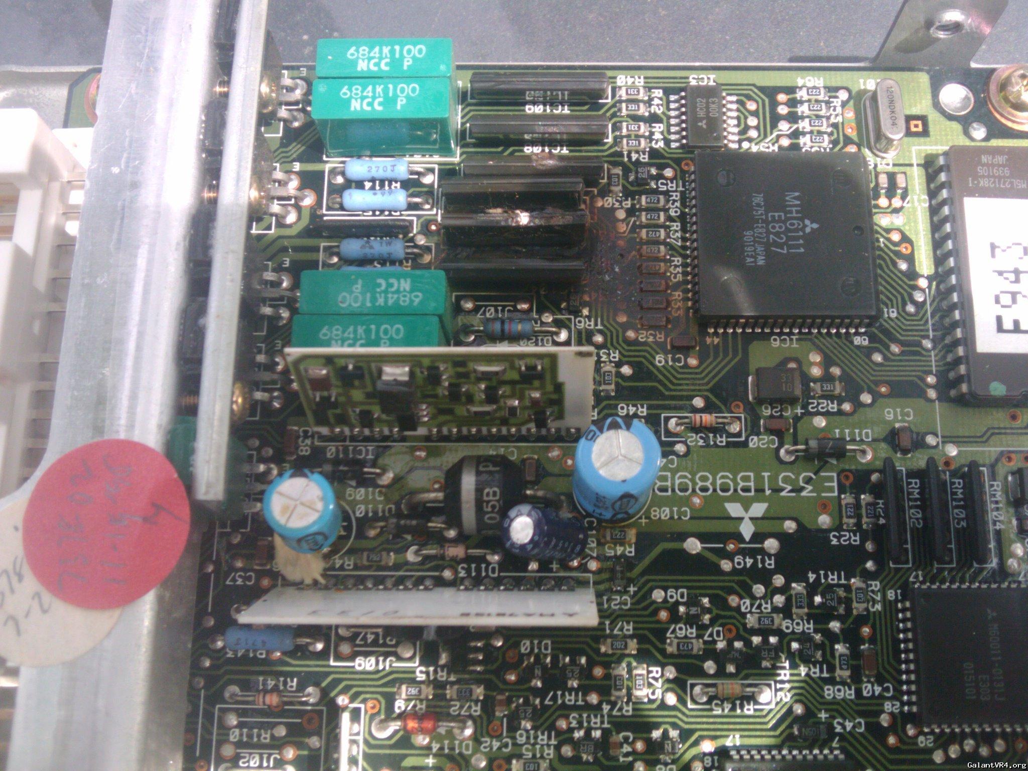

There is no difference on a 90 ECU that would cause issue with activating the fuel pump. It's likely the other ECU is also damaged.
I just noticed that both ISC drivers are blown on the original. IC105 went big time but IC107 is also blown.
