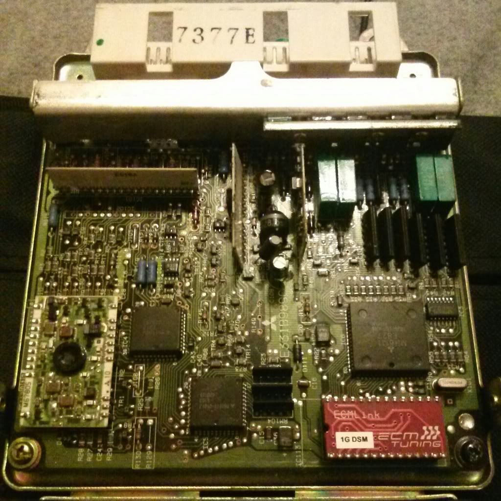

Pictures would be really helpful. If the ECU from the other car has a purple chip in it, that is ECMLink V3, and you can pull the similar looking chip from your original ECU and replace it. Should all be fine. If you had some other kind of aftermarket EEPROM/EPROM chip then yours should already be set up to receive the Link chip. Please post pictures before doing this though. I would not want to find out you ripped out the wrong chip and ruined one or both of your ECUs.

ecu should look like so
