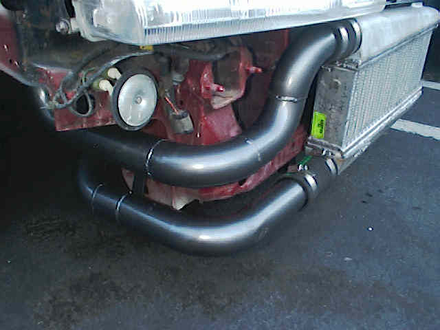

Evo 8 Intercooler painted Black..... sleeper baby /ubbthreads/images/graemlins/jawdrop.gif
