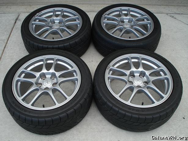

thinkin about picking up this rims but first i want to know if they will fit in the vr4 brake kit.... i know that garfield say that the evo 8 ones fit but how about this one?
^ What he said. Those are Evo 9 wheels, yes they will clear the 3kgt vr4 brake kit.

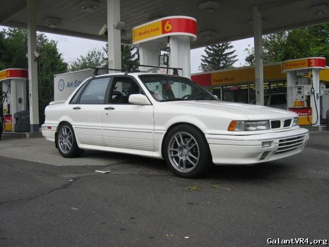

Hard to see but has 3kgt calipers with GW's brackets.....
one more question in here you know how in this car you can see that the front wheel stick out a lil more than the back??? well i just recently picked up a whole 4 bolt subframe for my vr4 and 2 wheel studs are busted and was planning on replacing the rear with extended ones and put spacers in the rears so that the rear wheels stick out evenly with the front.... my question is you guys know where i could find a good wheel studs? how long do i need them to be and how tick of a spacers to use?? hope someone can answer this /ubbthreads/images/graemlins/smile.gif
ARP sells extended wheel studs. The size spacer you'll need is ~1/4". I don't have spacers on my rears but I'm sure someone who does will chime in.
