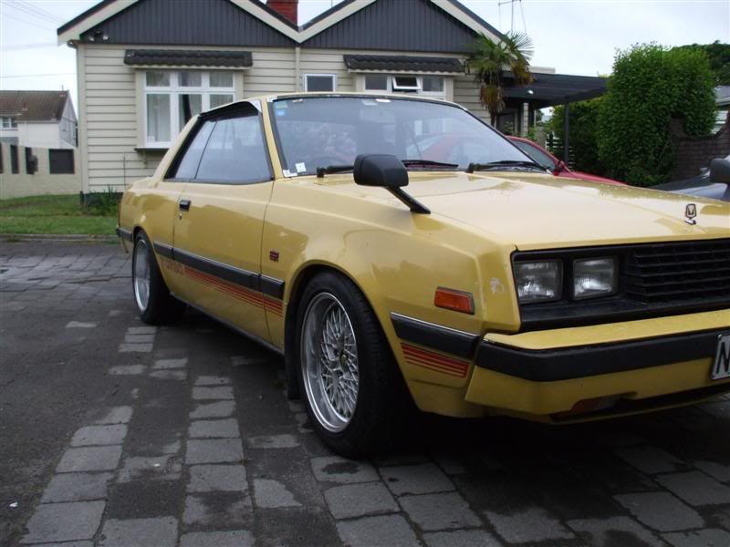

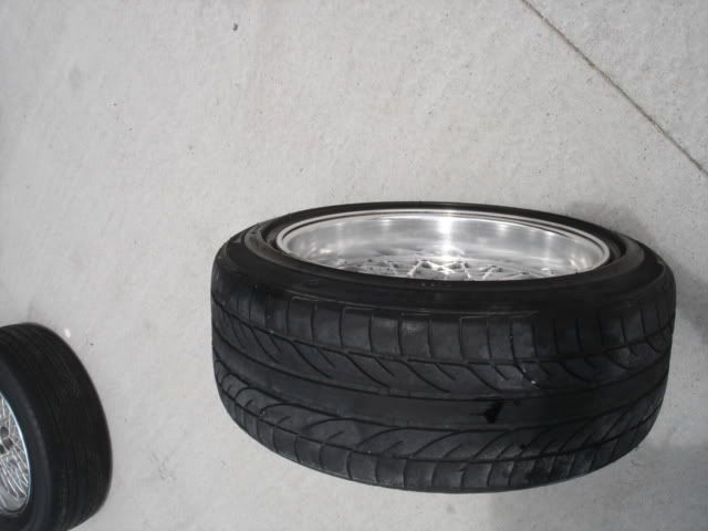

Here's 205/50 on some 16x7.5 +20 and 16x8 0 offset rims on my Eterna:
And here are some 215/40 tyres on my 16x9 Starquest SHP rims - barely stretched at all:

OK thanks for those pictures.
Looks like I'll run 205 either way.
