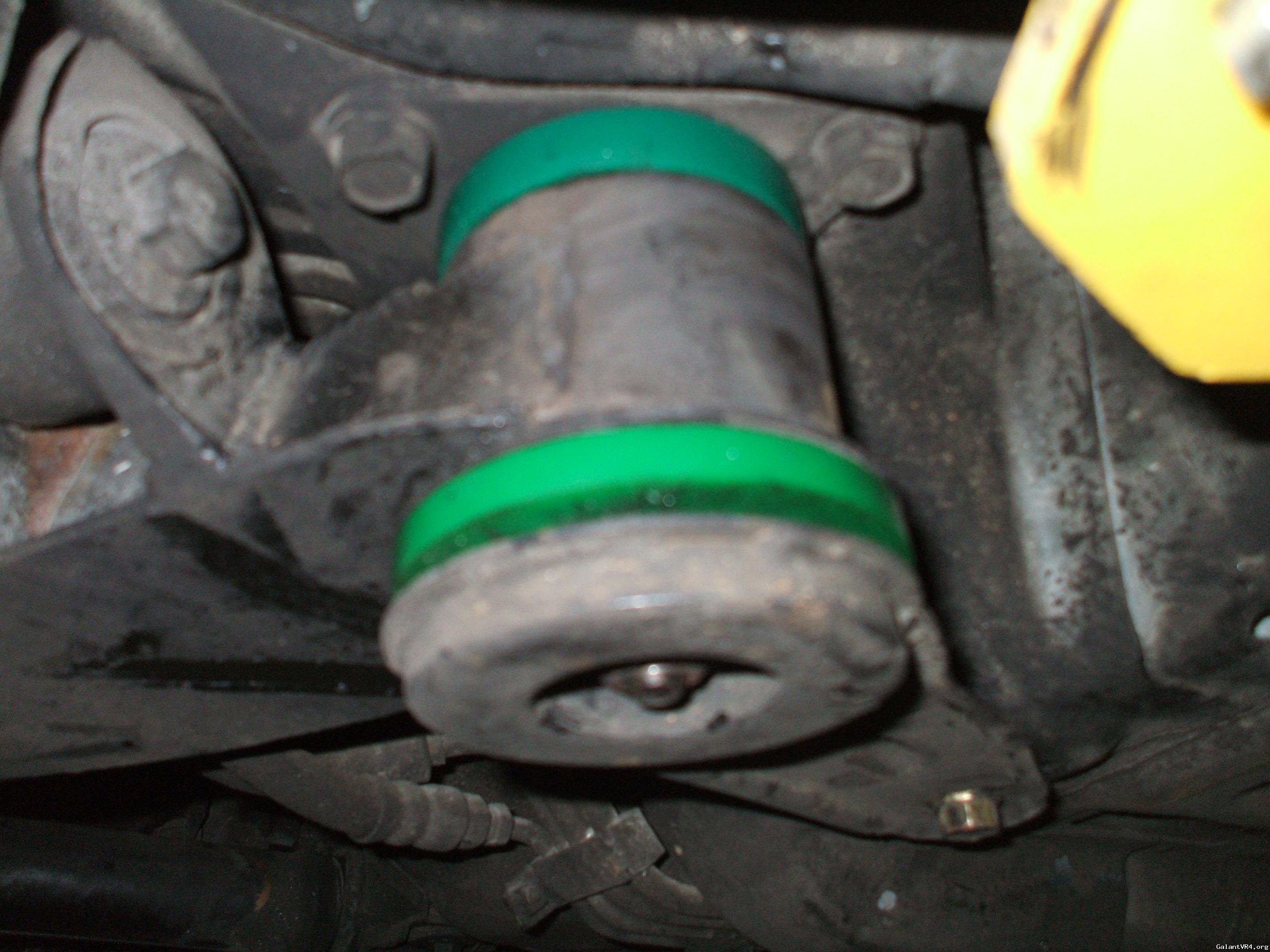

Vman911 finally installed his rear bushings and LSD 4 bolt. Came up from ATL and staying with mutual friend. He's been sitting on the stuff for almost a year....Can't say anything I'm getting close to the 2.5 year mark with mine.
I took a quick ride in it and you could definitely tell a difference from the first time he pulled out he called later to say DAMNNNNN.

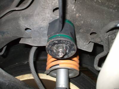

thanks for the help curtis....
Yes those rear bushings helped out alot...My rear doesn't twist any more when I turn hard. Body stays stright. Rolls real nice.

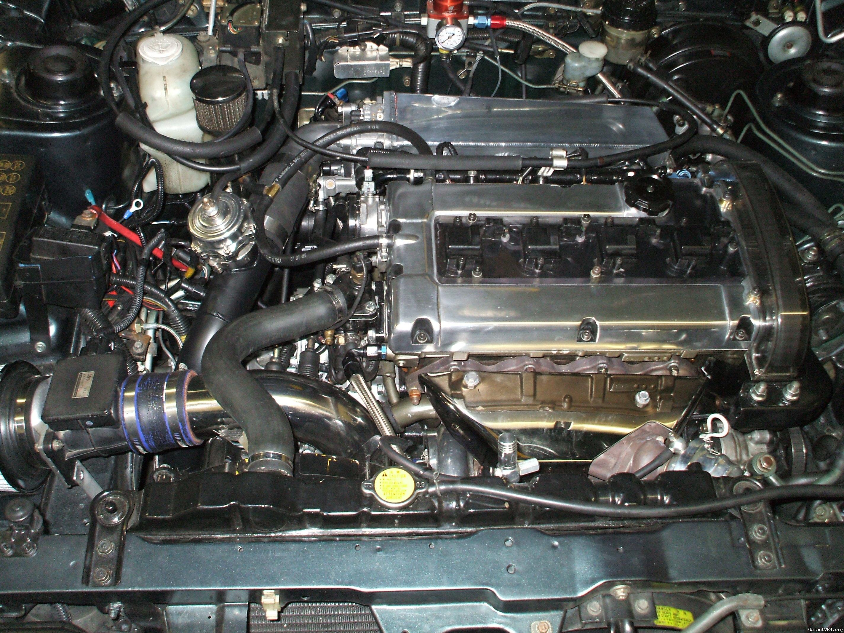

Its actually 1/2 clear lexan. I made it myself. Only 2 ever made by me so far. Mike @ 4Gperformance has the other one. Expensive plastic but looks good.

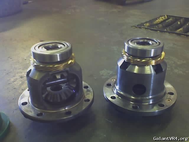

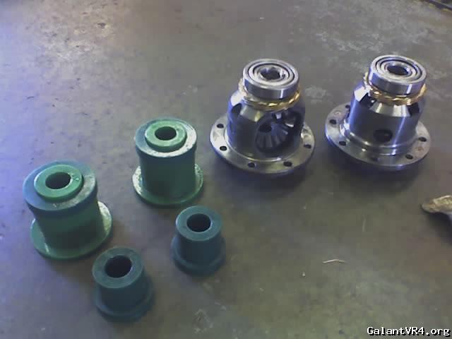

Pre install pics. I didn't want to press off the brass gear on my old 3 bolt. I got a new drive gear and bearing.
part #'s for the brass Gear (drives rear pump), Lock pin and side bearing
MF472536 Lock pin $.83
MB69835 Gear $49.78
MB393957 Bearing $27.39
