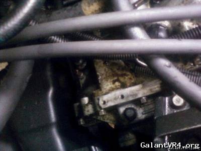

I have noticed most leaks on the 4g63/t come from the valve cover, oil pan gasket and the oil return lines.
Valve cover = super easy, use new gaskets and rtv - I believe rock auto has the valve cover gasket set on sale right now ~17$ (shipped) if I remember correctly).
The oil pan isnt to bad but make sure not to squeeze the gasket out when tightening it down. The t-case and some cross members will need to be dropped to fully access the oil pan. again use RTV, some board members just use straight rtv. If the oil pan is tweaked or thought not to be true, get a new one or expect to do the job all over again.
Turbo oil return lines, get these from mitsu and buy a few to keep in stock if you somehow get some type of contamination and it doesnt seal, i use rtv on these also...
If it was my ride, replace all of the above. The oil pan and the turbo return gaskets, I do these together regardless. Always use a torque wrench please.
Please get some more information and some pictures up if you're in doubt. Lay under the car for awhile with a flash light and try to trace the oil if it is possible. If the leak location cannot be pin pointed, look into some UV dyes and follow the bottle directions to a T.
