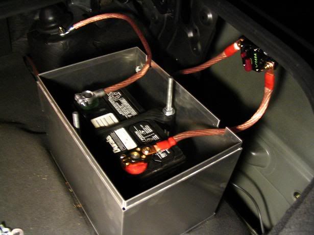

I just thought Id update with a VERY important note and a pic.
In this pic, note that I SHOULD have a rubber grommet around the (+) battery-to-breaker cable where it passes over the aluminum box. The cut-out for the wire has a sharp edge and could eventually slice through the sheathing causing SERIOUS ELECTRICAL FIRE. This is the purpose of the breaker so that if connection is broken between the fuse under the hood and the breaker in the trunk, an increase in amperage (> 140amp) will trip the breaker and cut power (so as to avoid fire). It is IMPERATIVE that the breaker be as close to the + battery terminal as possible with as little chance for unwanted contact as possible.

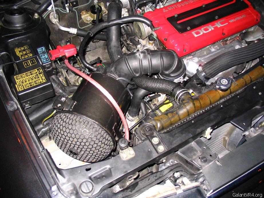

and a pic of my HKS airbox suckin air like it should have from the factory /ubbthreads/images/graemlins/smile.gif
