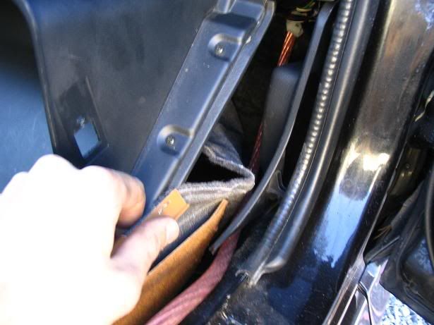

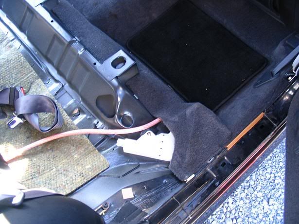

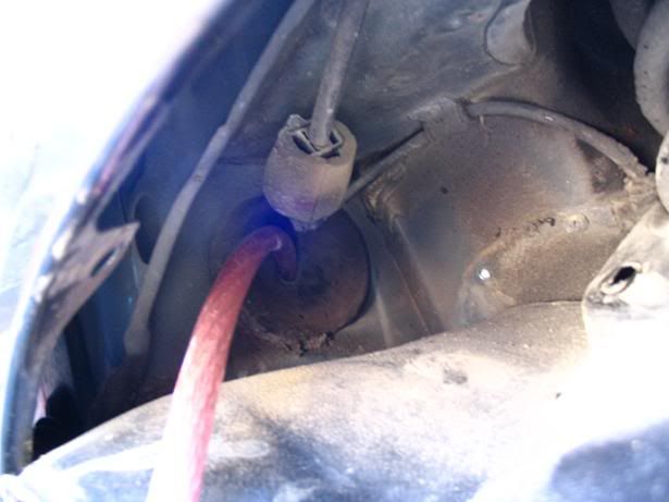

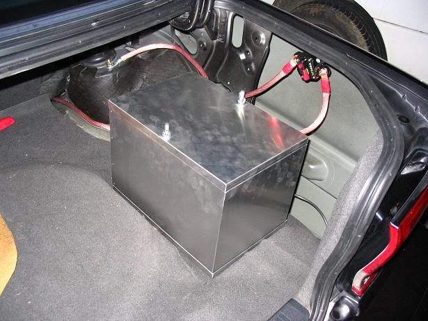

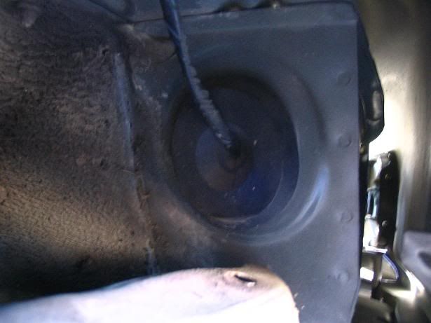

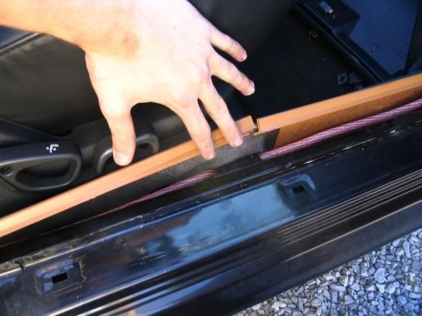

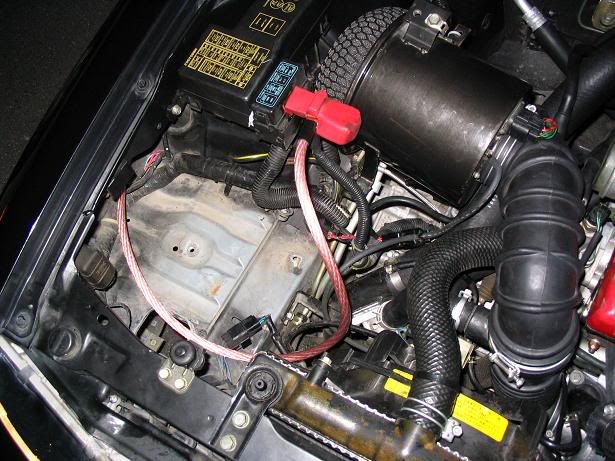

I will be running 4awg wire from under the hood to the trunk with a 140amp breaker mounted in the trunk (as close to the battery as possible).
I think it has been determined that the best place to run it is through a boot in the front right wheel well that comes through behind the glove box. Then it just runs along the side of the car under the carpet, beneath the rear seats, into the trunk.
I have been gathering parts to do this for the past two weeks and its all going down at 2'oclock on saturday, so Ill post up lots of pics. However, I wont be doing a kill switch as I gathered it's not a safety issue; more a NHRA track legality.

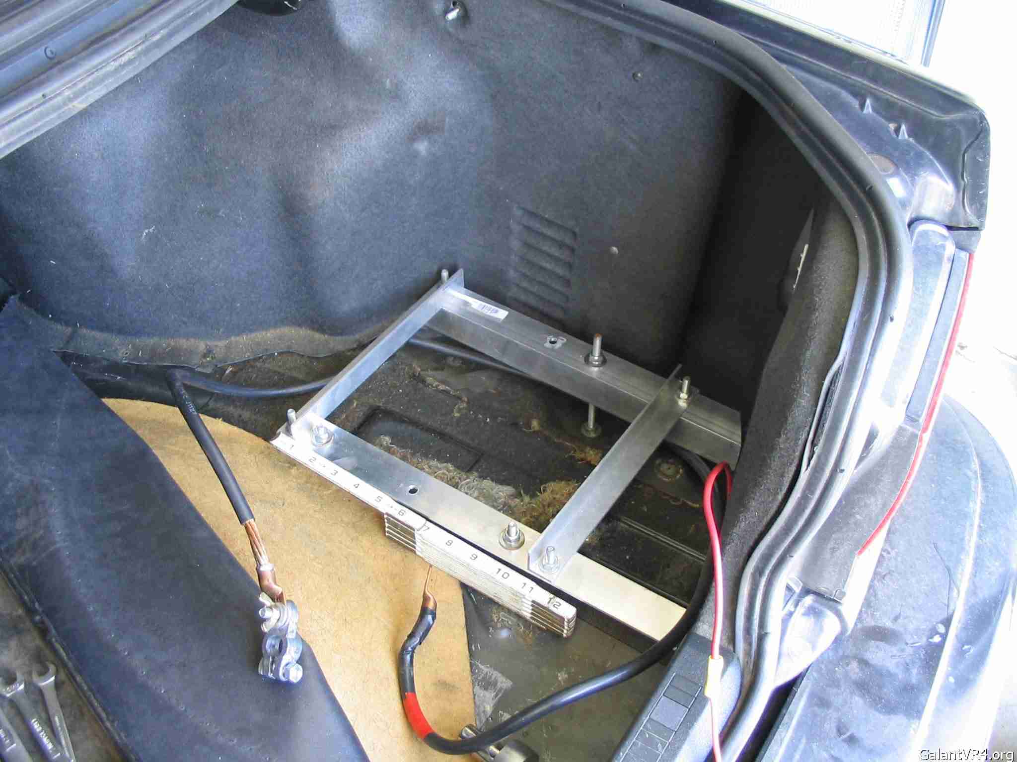

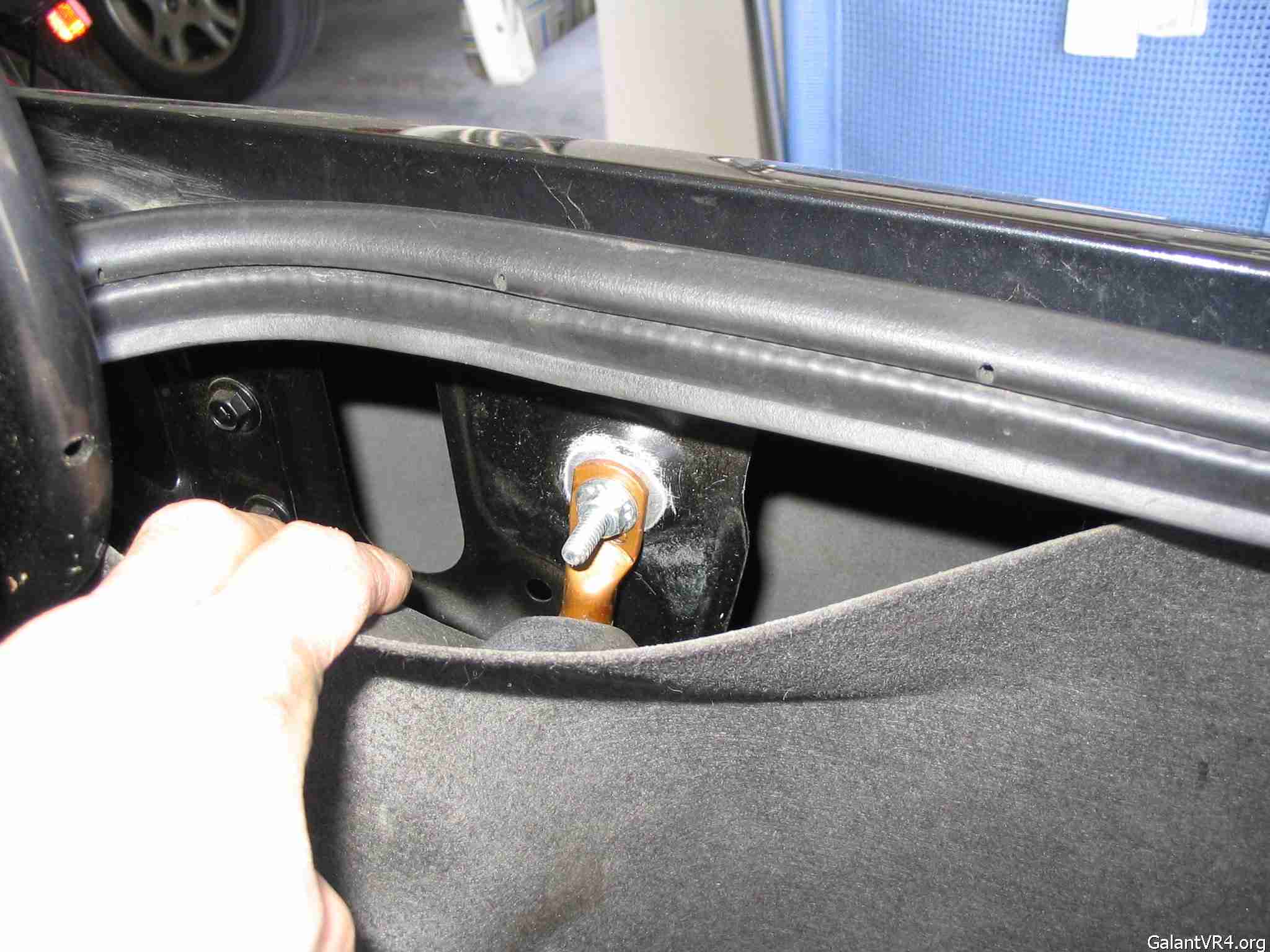

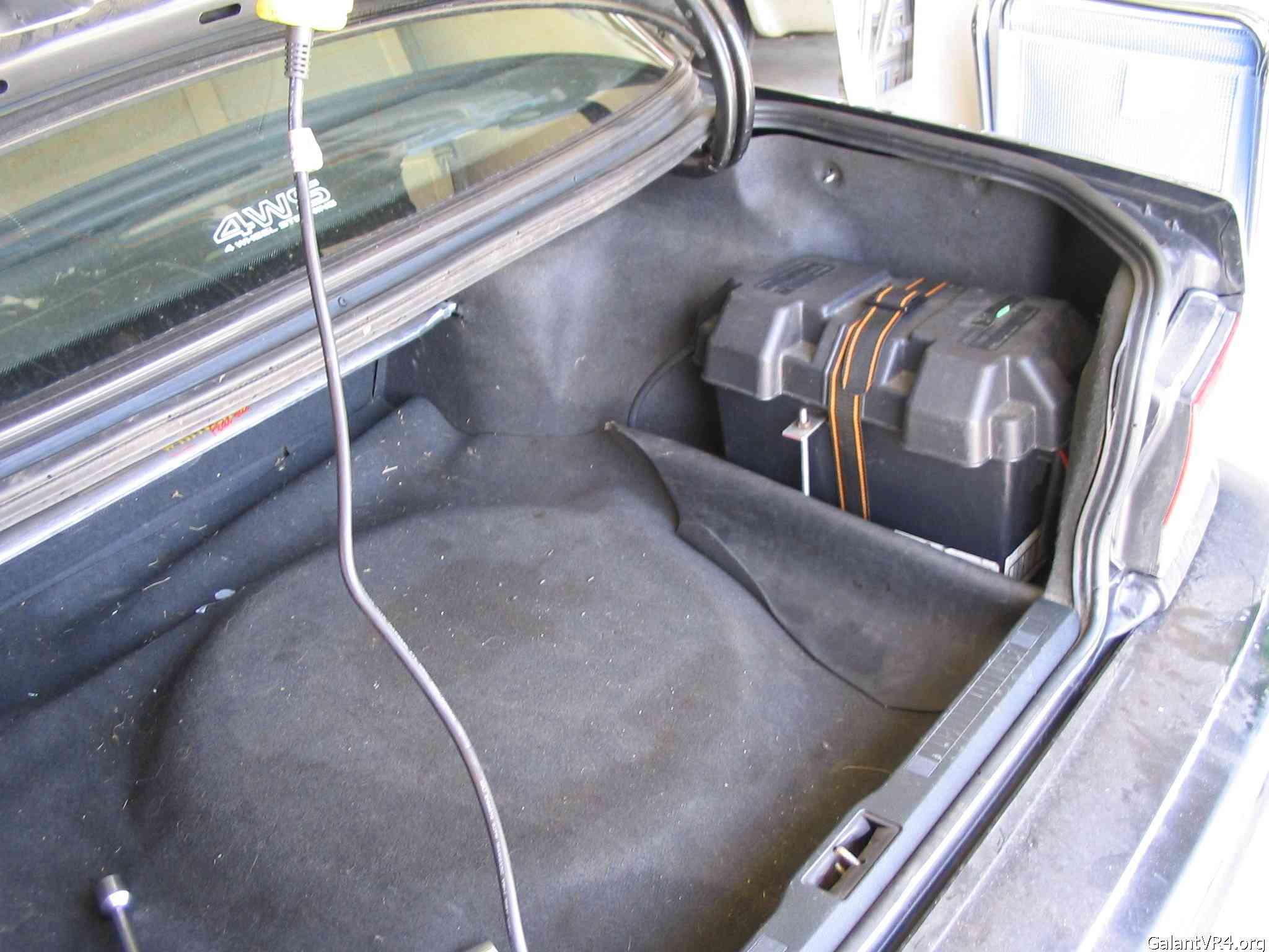

My back hurts, and Im too tired to write, so all you get are pics for now...

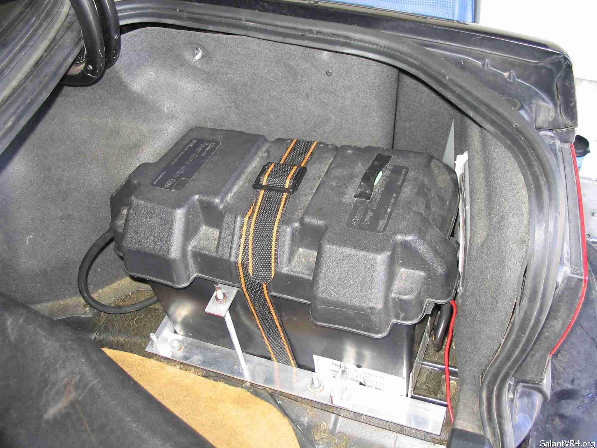

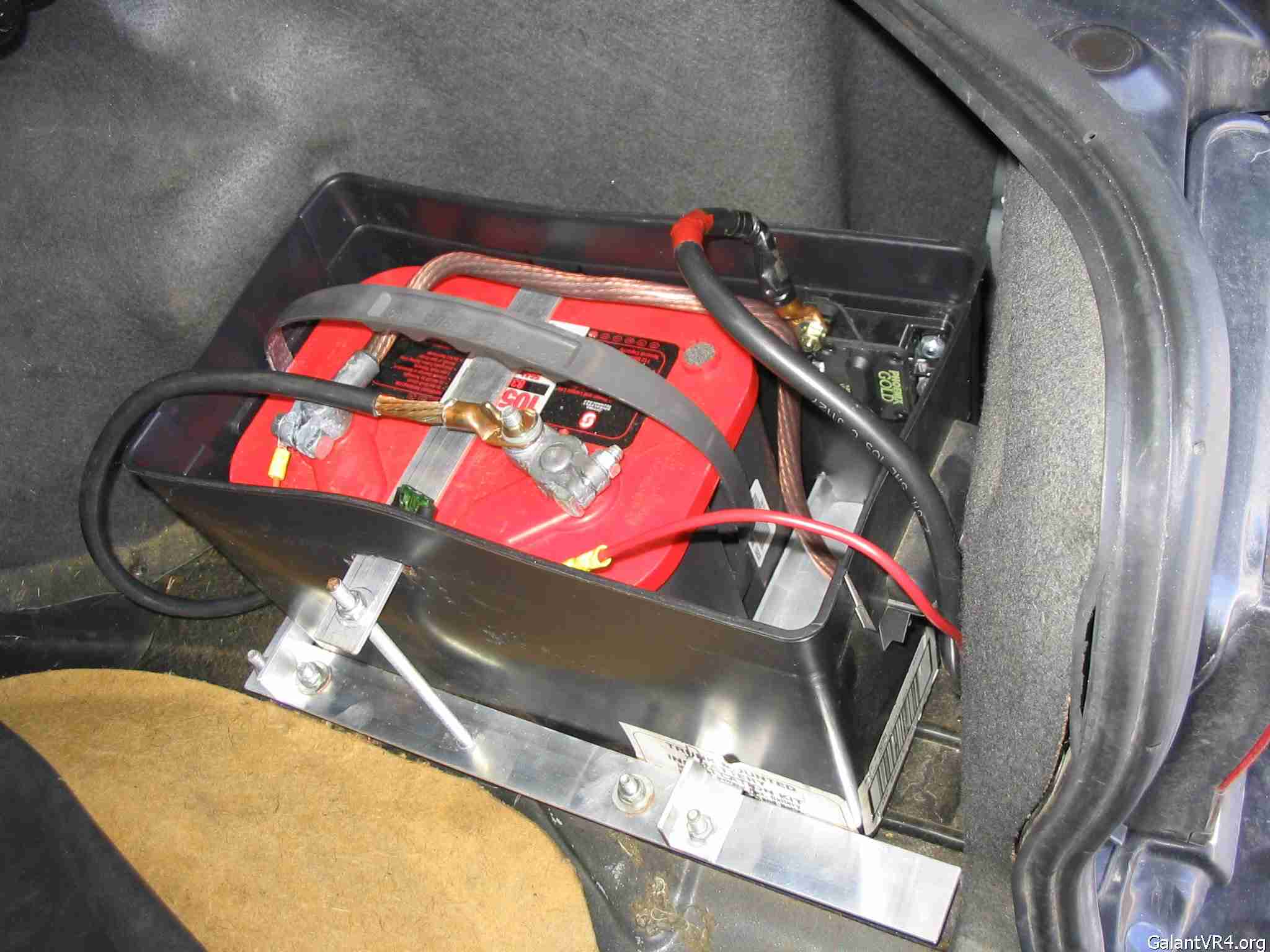

I have another question. My aluminum box is sealed, but it has a breather line that vents out of the side. Does that have to go out through a hole in the bottom of the trunk, or can it vent into the trunk itself?
11,982
For NHRA legality, it needs to vent to the outside of the car. The techs at my track have never looked for it, so I haven't installed the vent yet.
