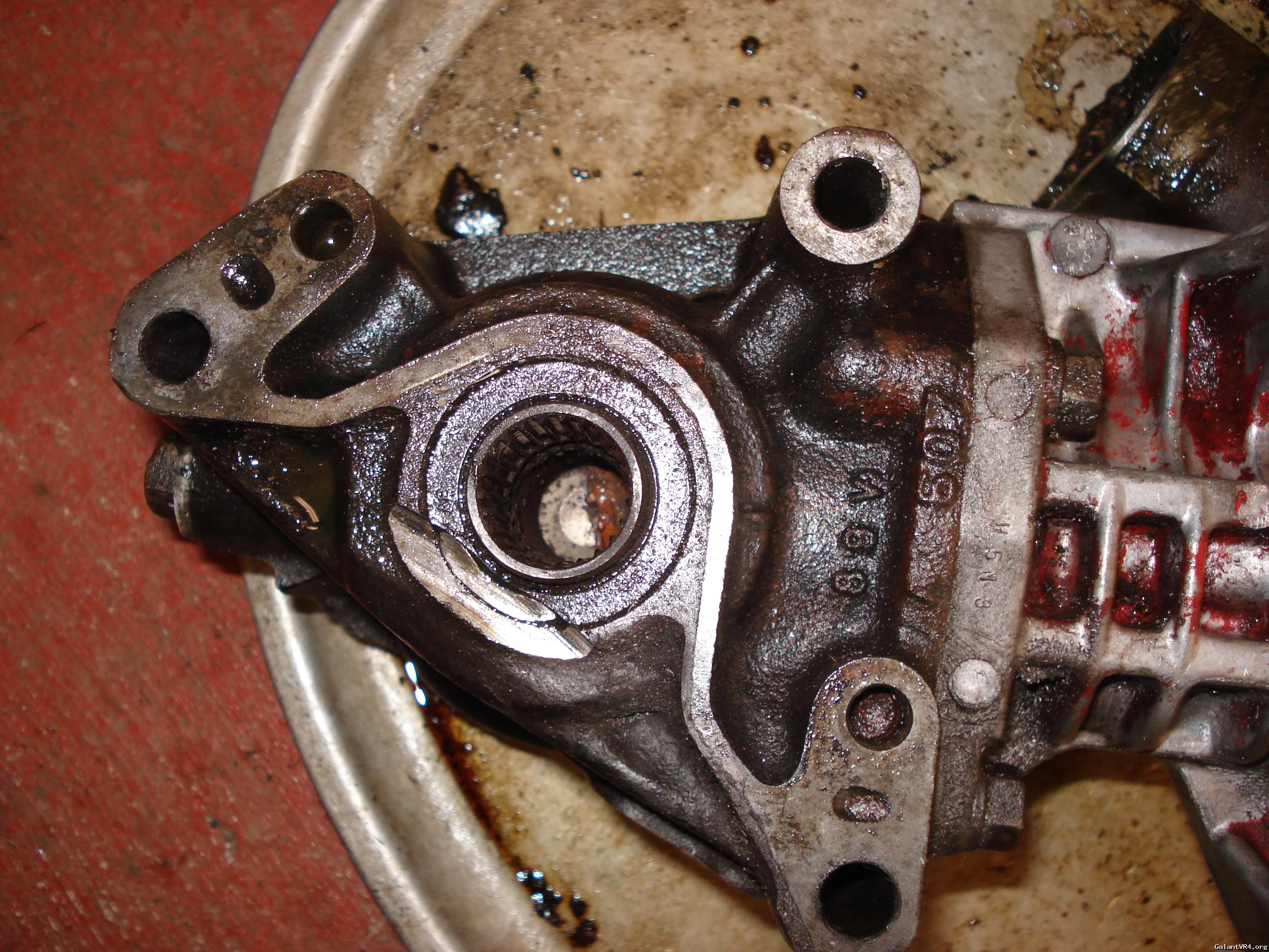

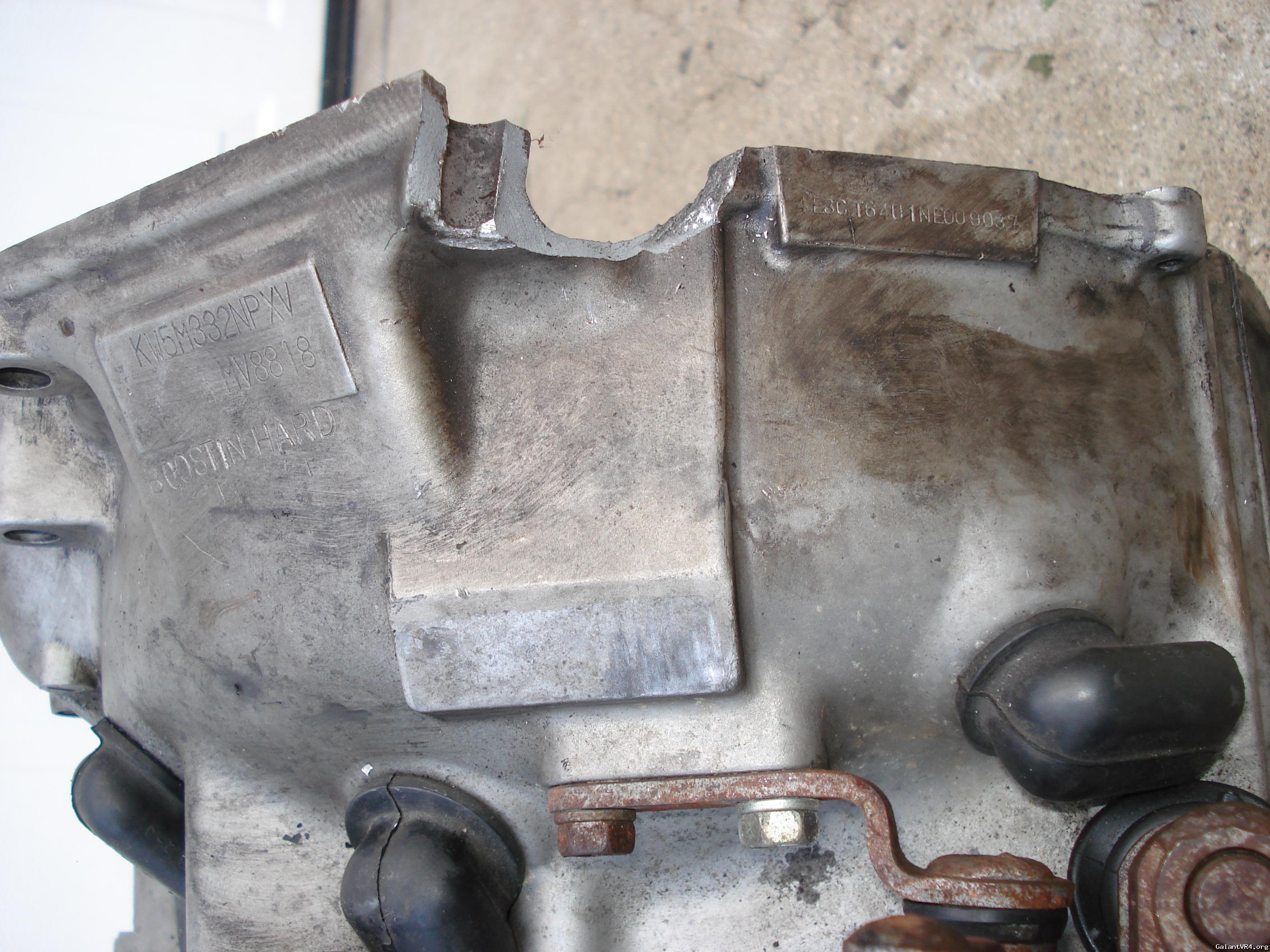

so i snapped my bellhouseing on my tranny and i was wondering if i can switch out my bellhousing one that fits a 2.4 7 bolt crank, i have the trans that was on a2.0 4g63 but now i have a 4g64 block, and i was wondering where should i go from here. here are some pics of what happened t my trans.
if anyone could plz let me no if i can change to a bellhousing that will fit a 7 blt 2.4 4g64.

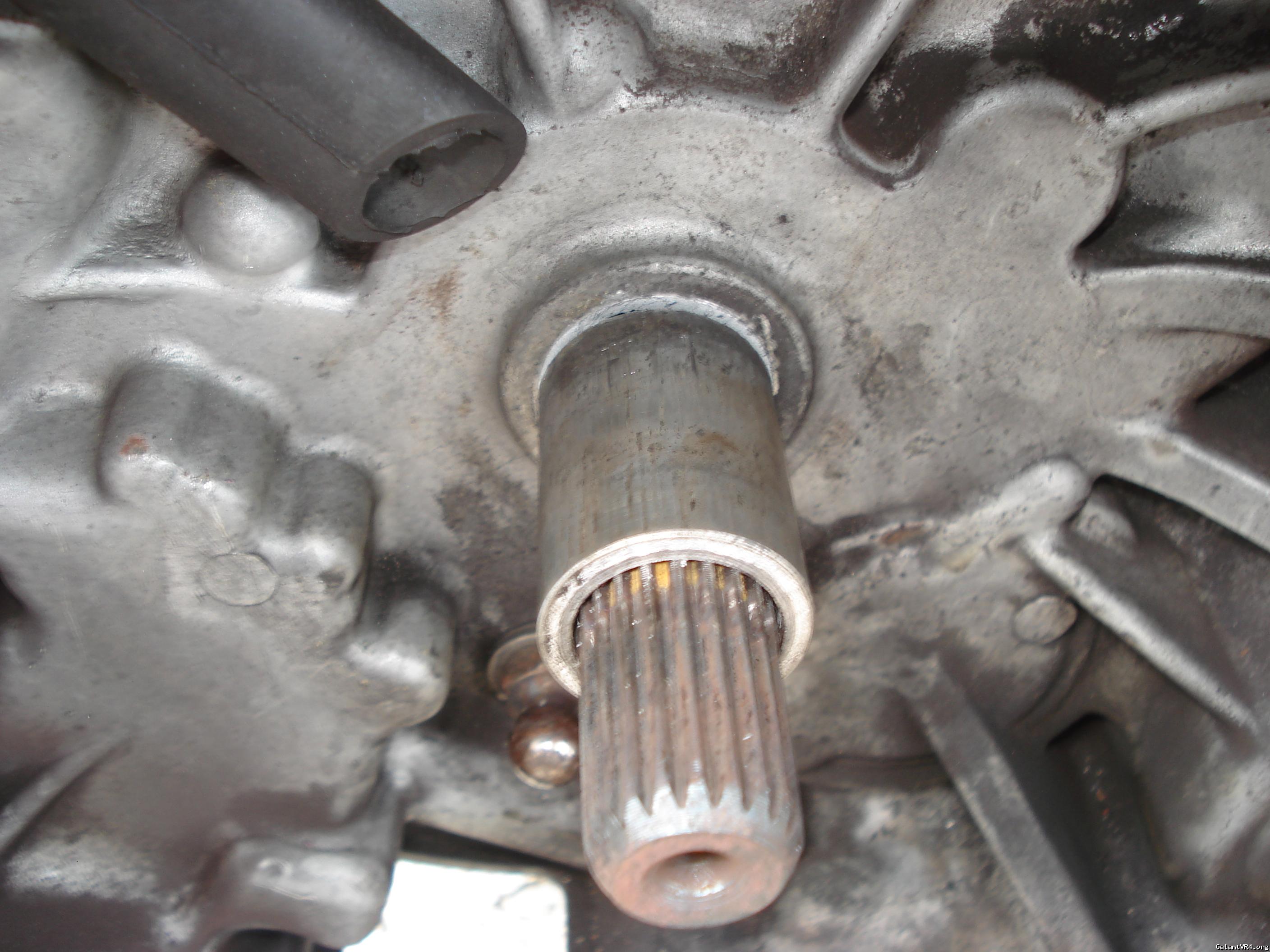

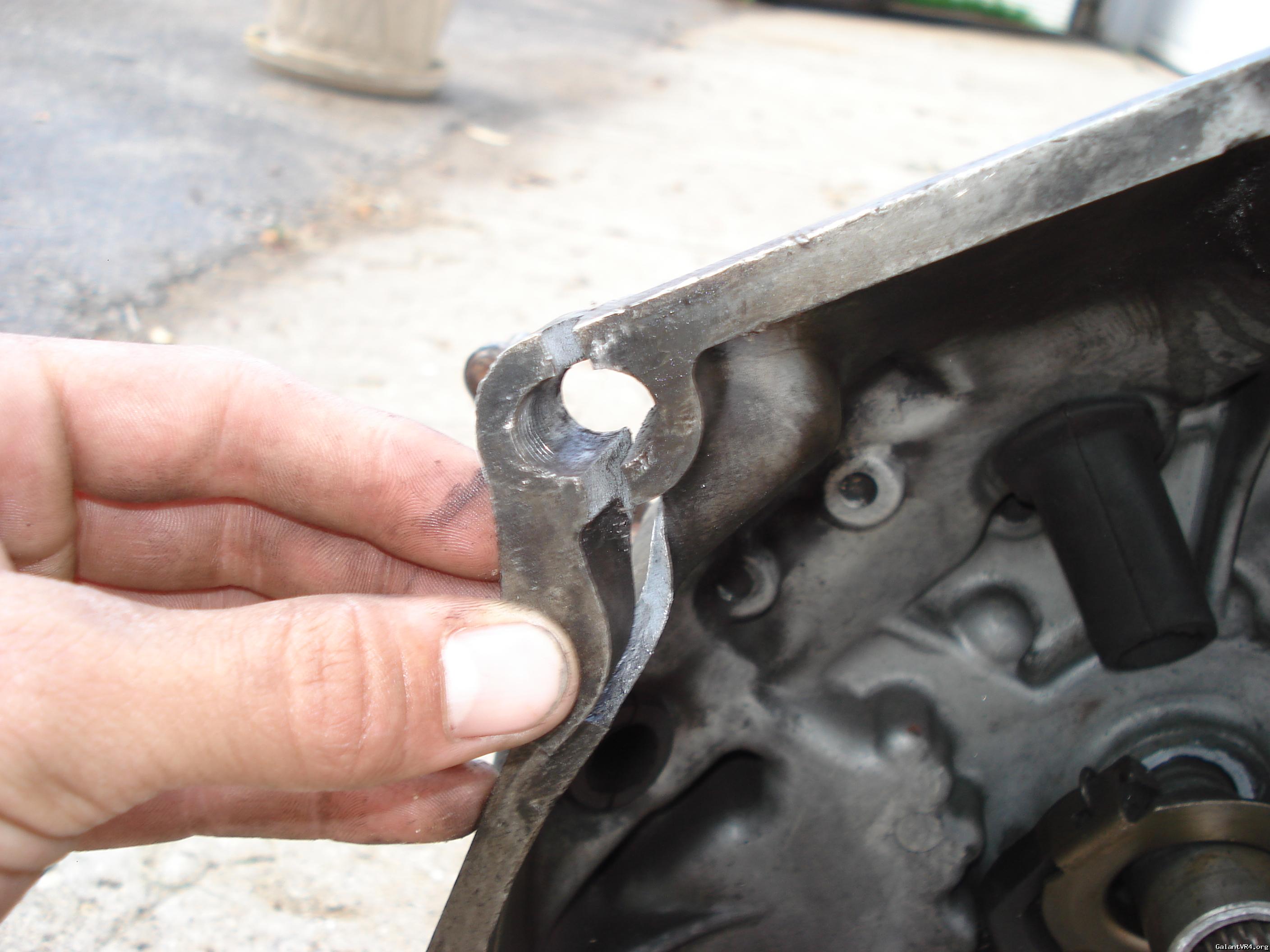

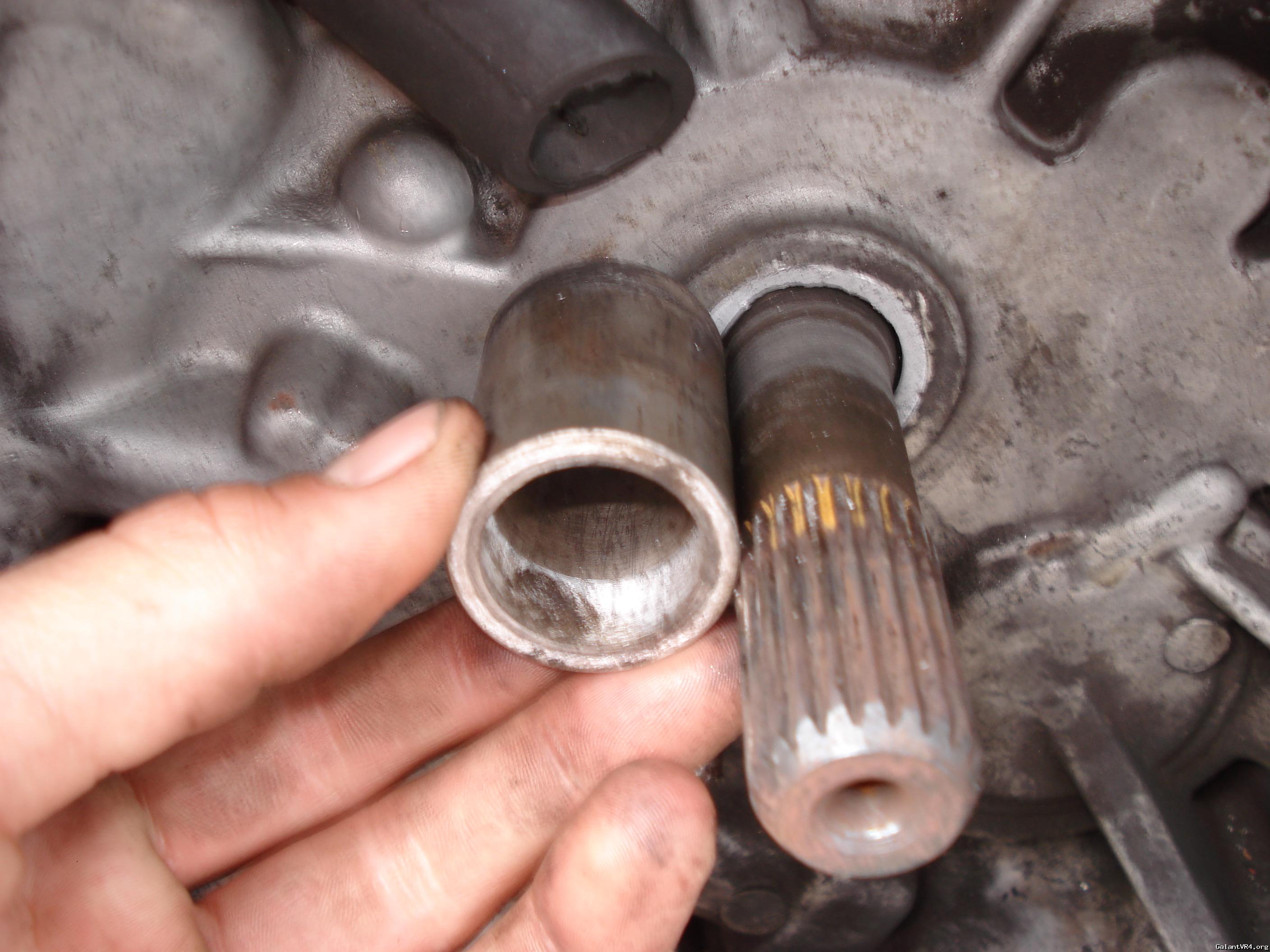

Have you considered talking to a welder about repairing this? The bolt hole tab looks fixable. Not real sure about the input shaft sleeve.
i have a guy who can wed this for me he said< i just hae t tear it apart bc there is a bearing behind this seeve< am i correct? and today i just fabed up a front engine mount so this kind of stuff wont happen again. and when this happened i only had 2 side poly mounts and the rear poly mount there was no front mount.

Yes, there is a bearing, but more importantly there is a seal that is only serviceable from the inside. So, I guess he's right.
yea i just bought a new bellhousing for my trans and im gunna have my friend tear it apart and put the new one on.
