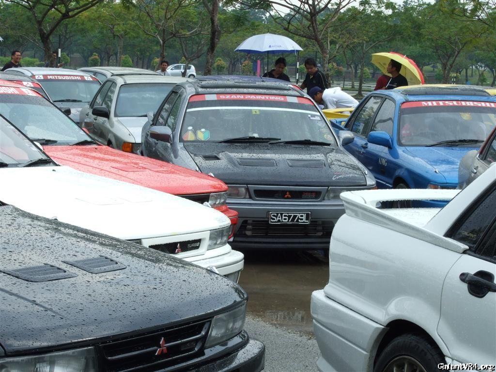

Somewhere there's a few pictures of those guys and about 40 friends over there. Pretty sure it's Malaysia. Most of the cars were usual colors (save green), but there were maybe 3 red and one orange. I used some of them in a post on my website a few months back. Wish I remember where I found them. (Probably here, naturally.)

Thanks for the link! Lots of sweet looking cars in there. One in particular struck my fancy. The one second in line as a evo 3-esque hood. I'm sure its a custom jobby, but it confirms that the Galant can pull it off.
EDIT: I also like the 'eyelids' on the white car.

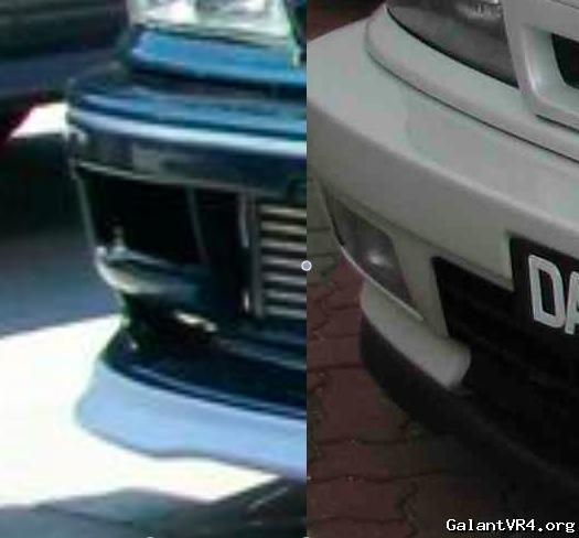

EDIT #2: And where did they get those sweet lips? Not that the Boostx lip aint bad, but those are nice and subtle. Daddy wants!

Isn't that just the AMG bumper? ie: no lips added?

For the lip, I've been trying to figure out how to make it. Fiberglass is the easier solution, but I'd really like to make it out of urethane for durability's sake. The majority of urethane auto body parts are injection molded, but some are thermoformed. Both of which require quite a lot of tooling to accomplish.

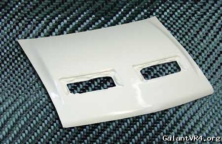

Racepro does a fiberglass Evo 1-3 bonnet center but they charge a ridiculous amount for it!

Whoodoo. I think RedTwo was just talking about the center section and not the whole hood.
It looks like you would have to fuse the fiberglass center section and hood together, either with a fiberglass or CF hood.
Quoting RedTwo:
Racepro does a fiberglass Evo 1-3 bonnet center but they charge a ridiculous amount for it!...
RacePro's website

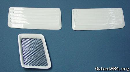

NZ to USD conversion = $427 usd for the center section and $161 usd for the vents. Together about $590 w/o shipping...plus a donor hood and body shop fees /ubbthreads/images/graemlins/uhh.gif
Talk about a pricey/baller hood. The end result looks undeniably good though.

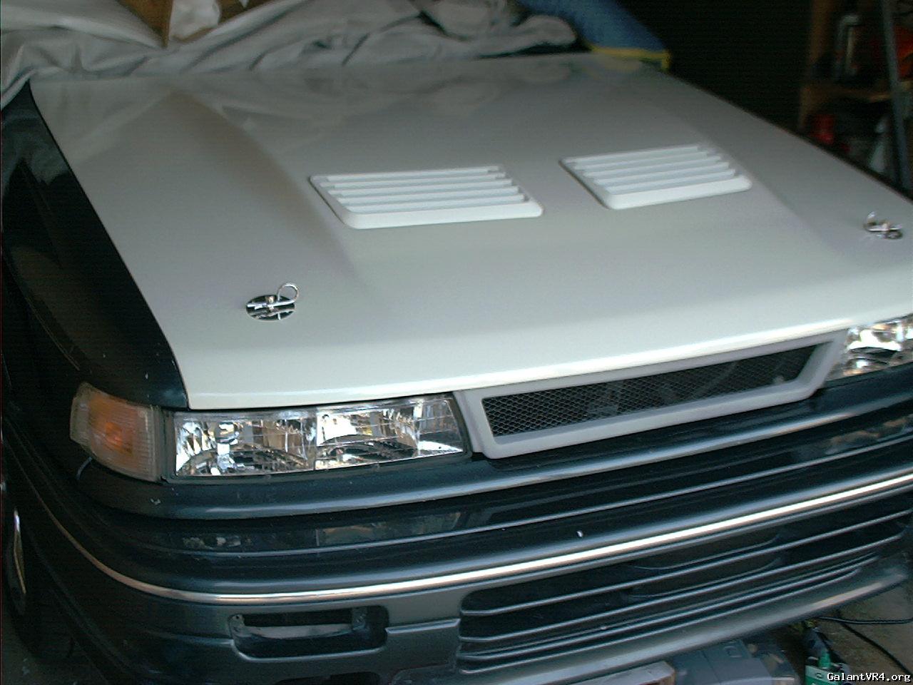

I asked about that hood some time ago and the pictures I was sent showed that it was made from a cut EVO III hood grafted onto a Galant one. If I ever did this, that is the way I would go. Years ago I had a similar hood made for my old 8G Galant VR4 using a fiberglass centre section on an OEM steel hood. I am not sure if the rate of expansion of the different materials, vibration from the chassis or a poor choice of primer/filler/bonding agent was to blame but the paint cracked along the edges of the graft. I had it redone several times but after getting the same result, I eventually gave up. I ended up having my hood prepped and used as a mold and then had the whole thing redone in carbon fibre.

I Actually own one of these hoods. It does fit, but you have to drill out the stock hood latch a little bit. I installed hood pins to hold it down, due to it moved around alot while driving on the street. The hood has EVOIII hood vents which are larger than the stock ones from JDM vr-4s.
It's still sittng in may garage boxed up.
