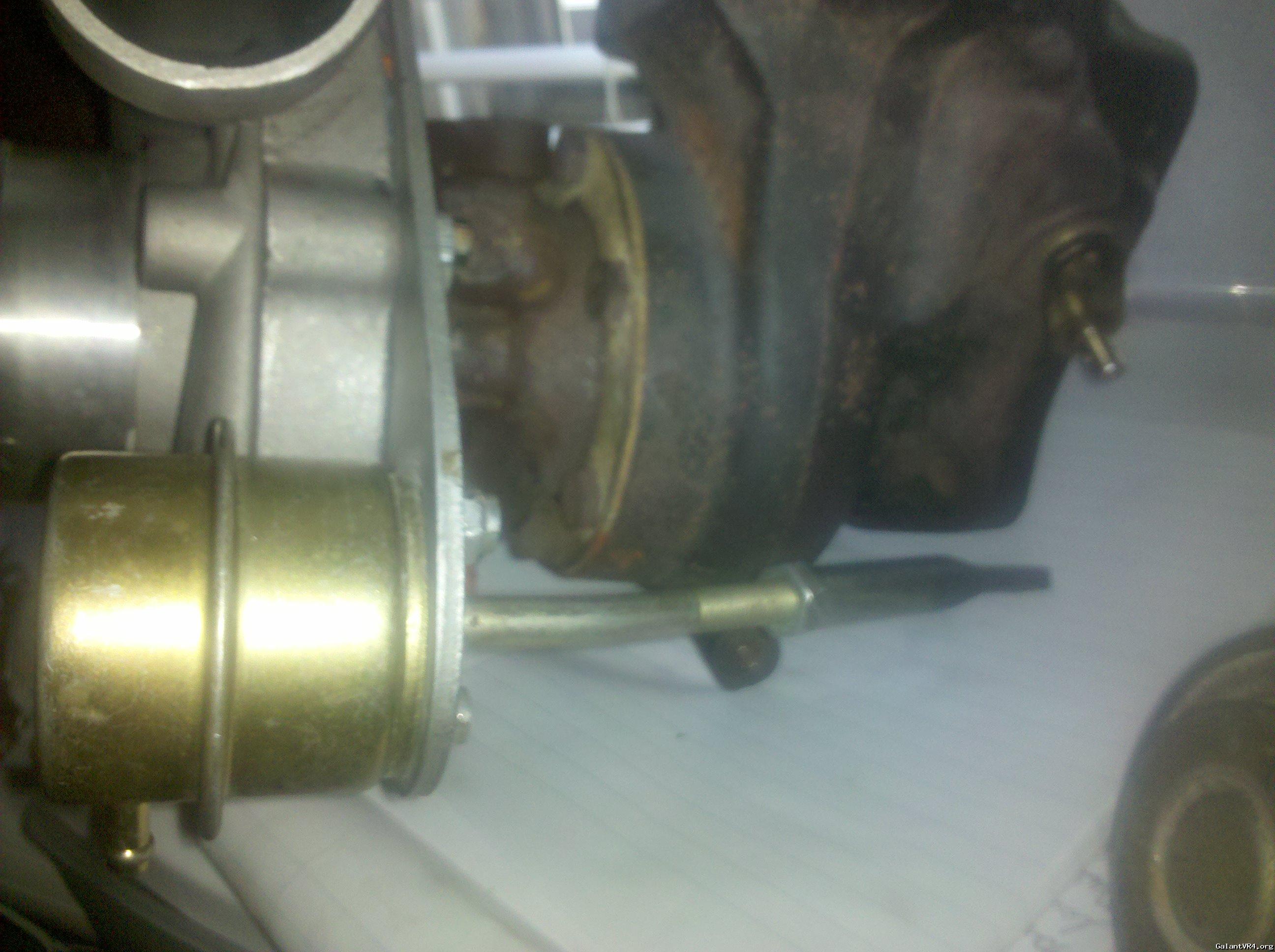

ok well i have it clocked now i have this mess... /ubbthreads/images/graemlins/dunno.gif
its not the right length. quick solution?
any help? /ubbthreads/images/graemlins/uhh.gif

Internal wastegate actuators makes clocking compressor housings rather difficult. Any turbo I've ever clocked has used an external wastegate, which allows the compressor to be clocked regardless of the wastegate actuator. You may need to fab up a new bracket.

Yeah, you're gonna need a 'Z' type of arm...it pushes/pulls on that 'flapper arm' (on the exhaust housing)...Just be sure to keep it rigid, or it's not gonna push & pull right [

See if you can unbolt the actuator from the housing. Then see if there is another possible orientation at which it can be bolted up again. You might have to adjust your clocking a little but if the actuator bolts up in a couple of different places around the housing then you could choose the one that gets you closest to the desired clock position.
