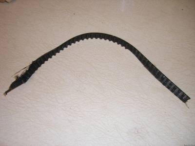

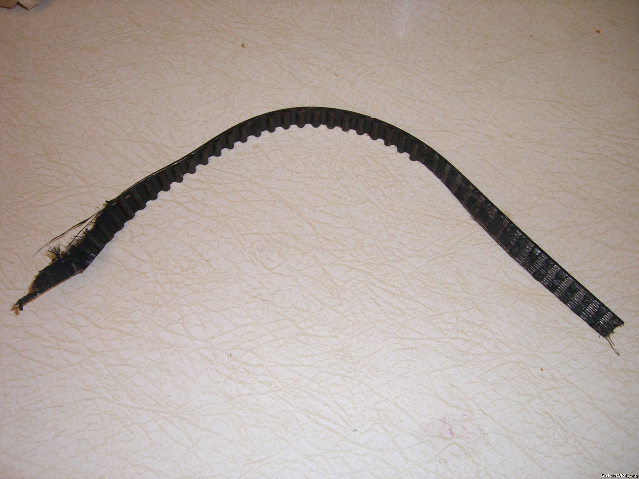

I always use OEM timing and balance belt no matter what. Although that didn't keep me from having to do this job over again today. My OEM balance shaft belt shredded and almost took out the timing belt with it. I spent the day cleaning rubber bits from my timing cover and replacing belts. Only had 12K on it when it went. At least it didn't take out the timing belt. /ubbthreads/images//graemlins/applause.gif

If you looked at the construction of the belts, the s-glass and Kevlar reinforcement is in the back (non-cog) side of the belt. Not the cogs. So, your only advantage to running these is for the balance shaft belt which has a tendancy to totally rip through the belt (which I contend is the result of tightening the belt too tight, and not to spec.) In the 50+ belts I've chanaged, I've only seen one main timing belt break all the way through. It was a case, where some bolt in the timing cover came out or was left inside the cover and it worked itself loose and rubbed against the belt until it literaly wore through one complete side of the belt. At that point the tension was too great and finished it off. All the other belts have always failed on the cogs, by ripping several cogs off.
Bottom line, save your money on the Kevlar timing belt, buy the OEM one and install a Kevlar balance shaft belt.
