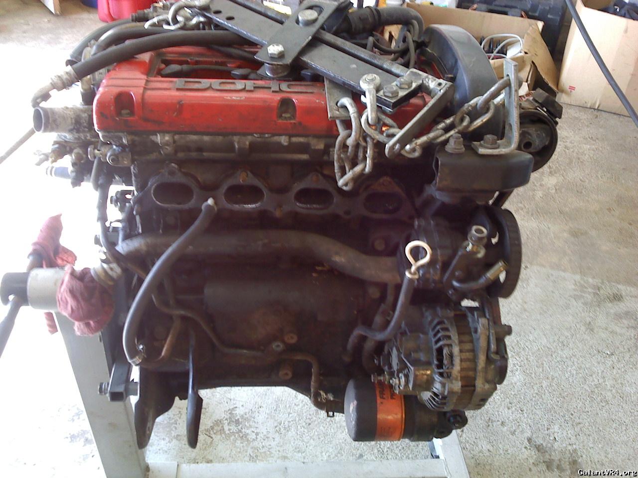

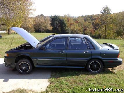

I bought/saved this car last year, it had sat for 5+ years. When I bought the car it wasn't running. I put an ecu in it and started right up. I installed an ets fmic, 3" exhaust, and an act 2600. While doing the clutch I found crank walk /ubbthreads/images/graemlins/banghead.gif. So the car sat till I could work on it. It sat for a while and when I went to start it the fuel pump wouldn't come on till I was done cranking the motor (I think that ecu fried too). Well I started on it thursday by pulling the motor out. I took a spare block to the machine shop to be cleaned, also took a set of 1g rods and evo 9 pistons. The plan with this build is to use parts I have from left over builds. I just took the
HX-35 to the max on my 2g (11.4 at 125 on 93), so that more then likely will make the galant it's new home but I'm not positive yet since I don't have the injectors to support it. I have an afc 2 but I'm torn to step up to dsmlink. Anyway here is the progress and pix to show you all what I'm working with.

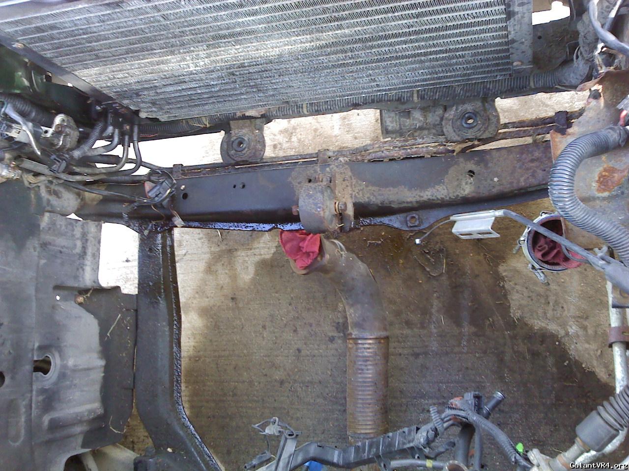

Little bit of rust on the rear power stearing lines

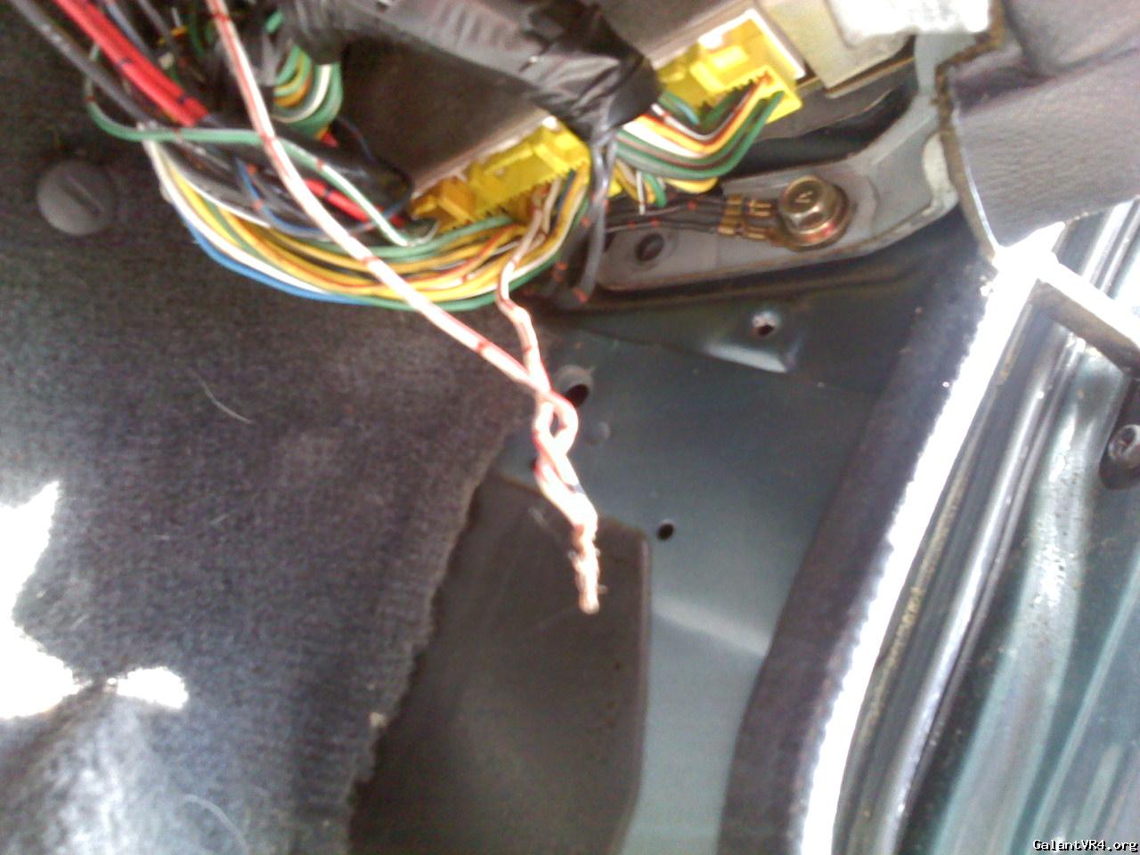

I don't know why this wire was cut?
Old motor out

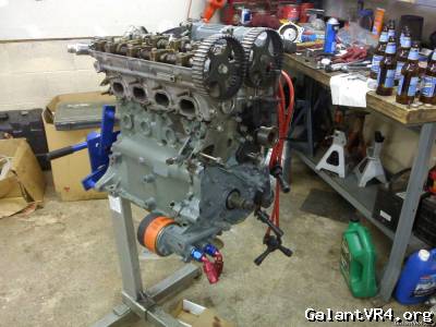

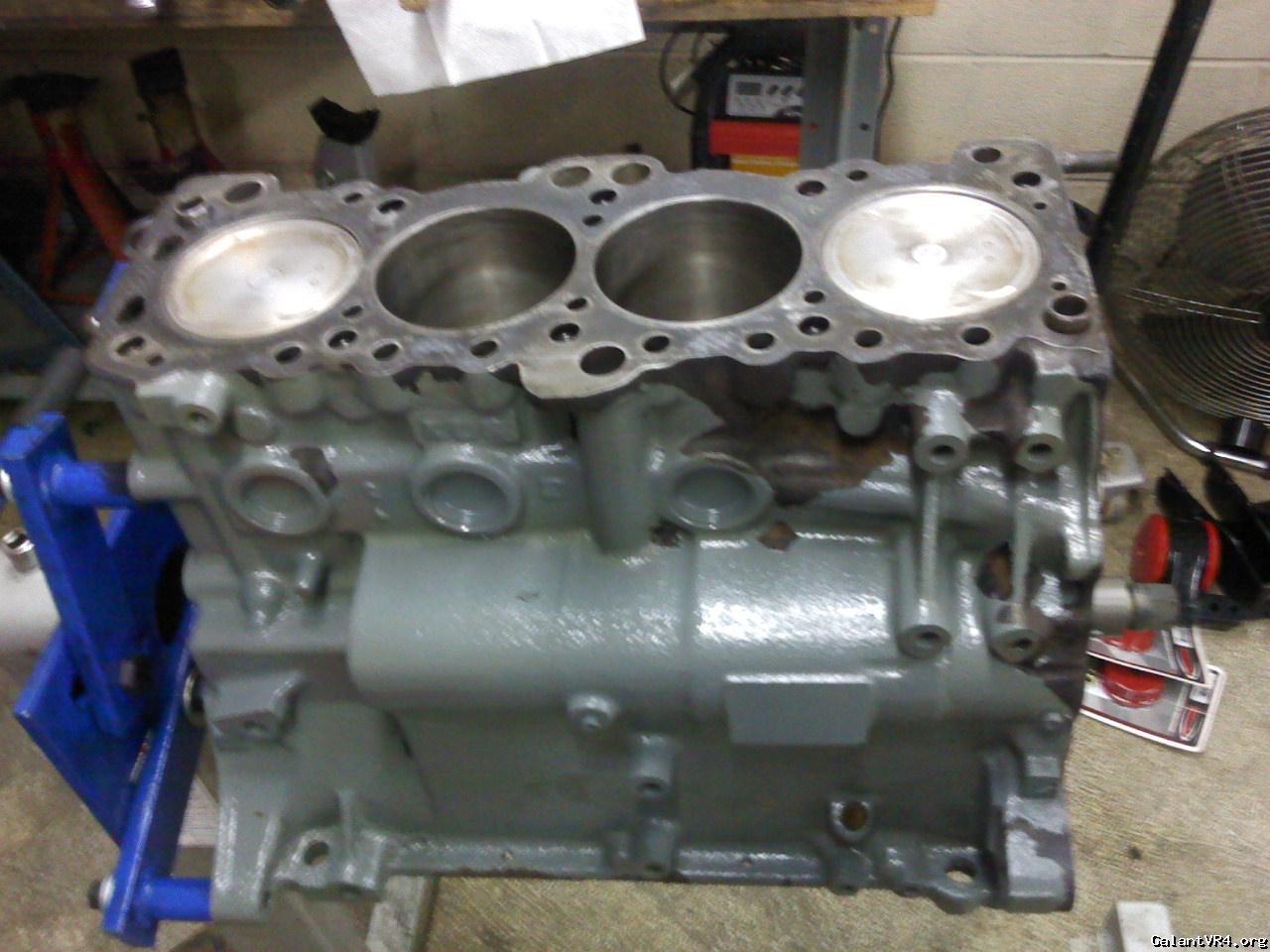

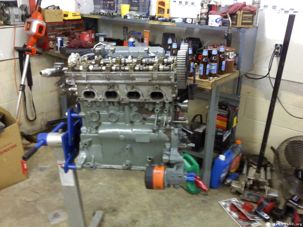

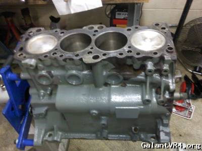

Started putting the new motor together. I put in the crank with ARP mains and pistons with ARP rod bolts in. Installed the arp head studs and set the head on top. Couldn't torque it down because my friend for got his bigger wrench.

Did some work tonight, oil pump, head, intake manifold, and fuel rail installed today.
I need to paint the block again

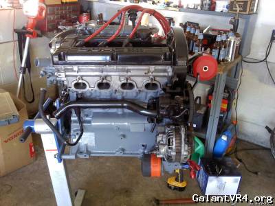

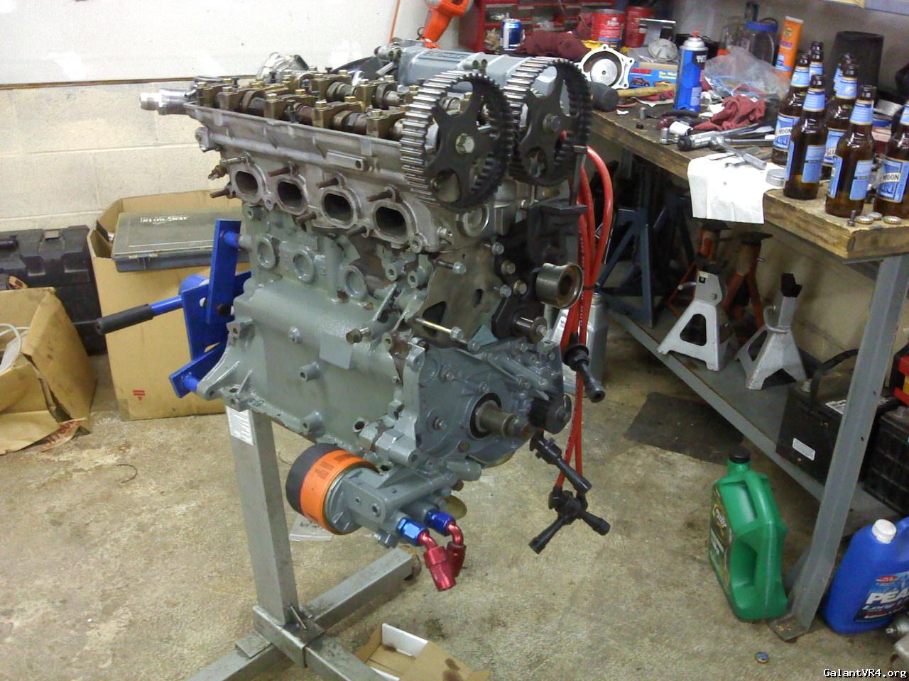

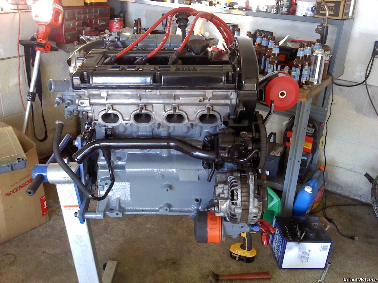

Ok so the motor is 90% done. I need to bolt on the top timing cover, valve cover, oil sump needs to be fixed, oil pan, and the A/C. Here is a pic of where I'm at so far. Do you guys like the black cover or should I stick with the red?

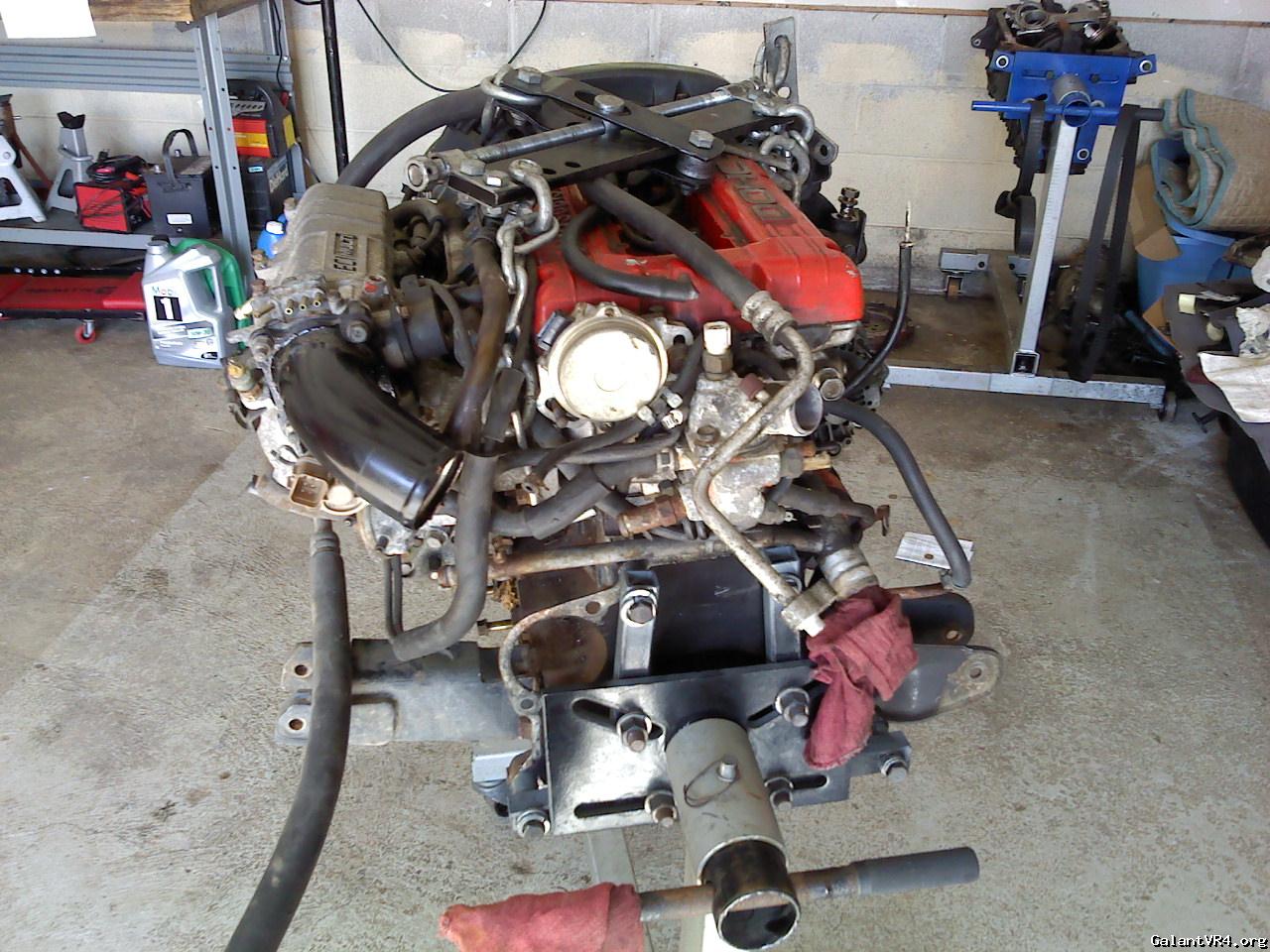

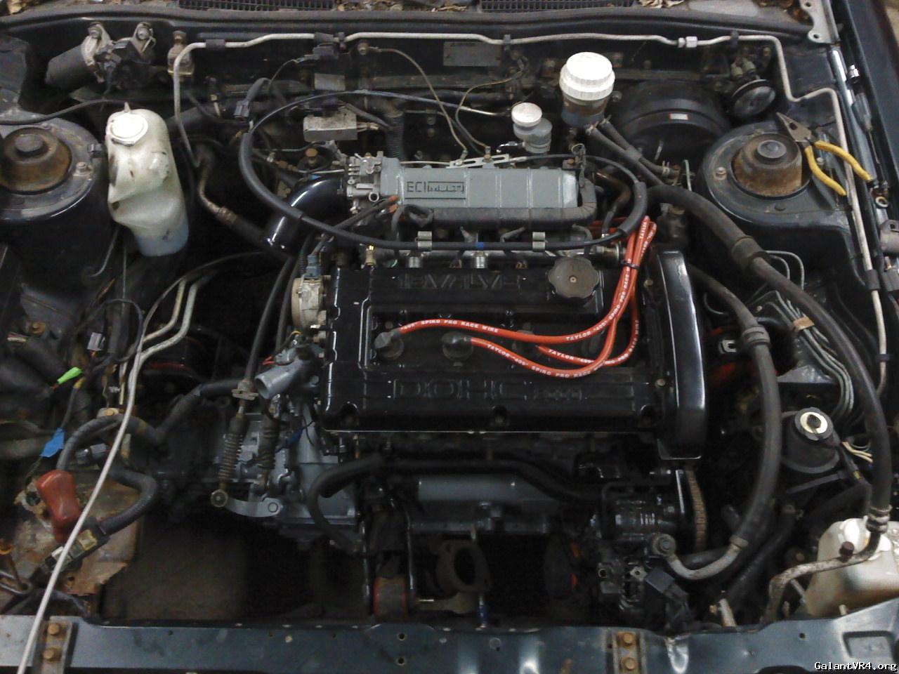

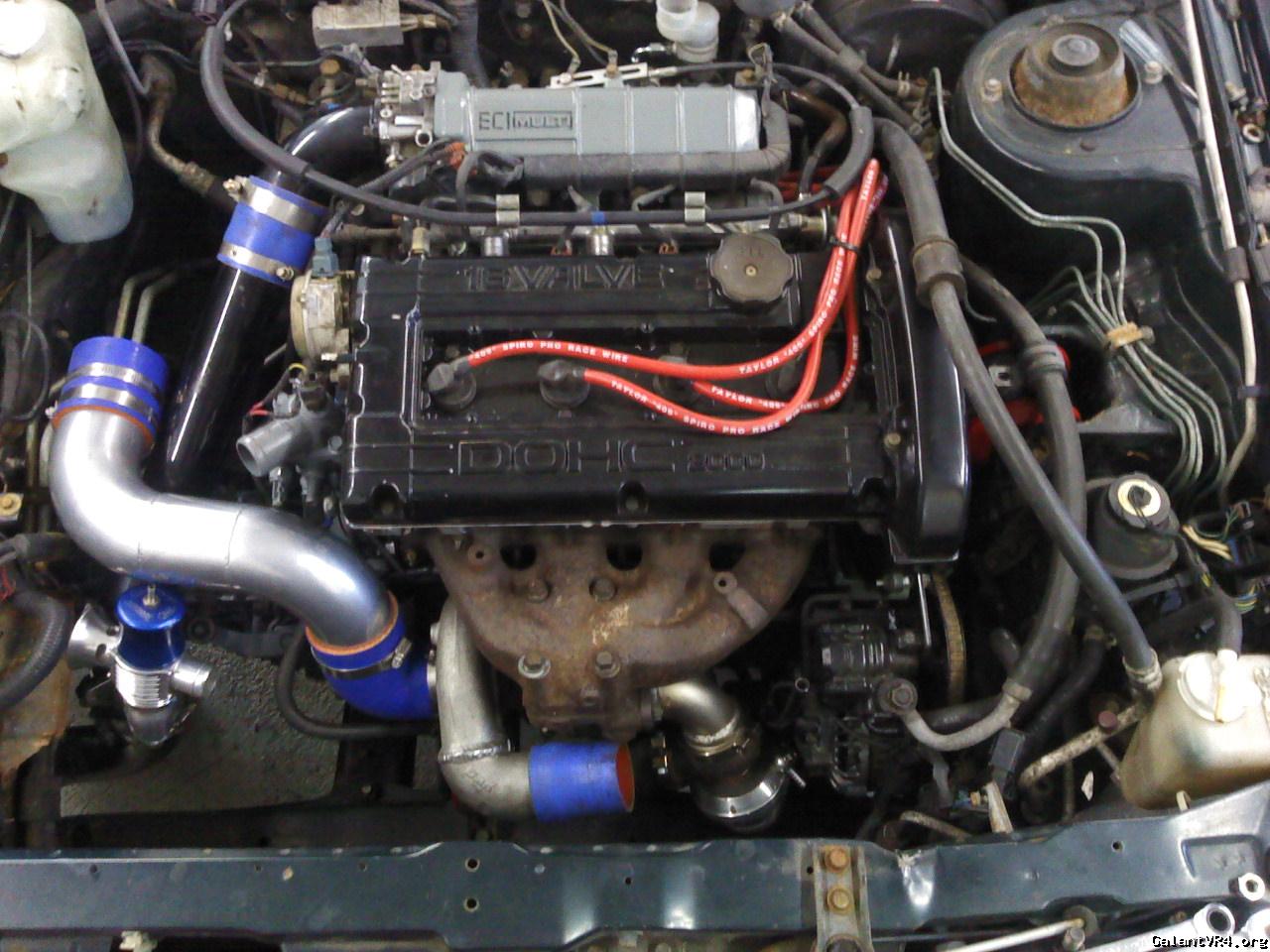

Been a long time but I got the motor in.
I have the suspension put together. Only thing left is to put the IC pipes in, slave cylider, dsmlink/ecu, and drop a battery in to get it started. I had to cut and turn the wastegate setup to fit. I'll take a pic when it's back in the car.

Little more head way. The BOV nipple will need to be moved in the future (It's a beast of a bov). The waste gate setup turned out well but I may need to re-route the dump since it may block the oil filter from being changed.
I need to figure out the placement of the 90 oil cooler and plumb it. Anyone have suggestions as to where?

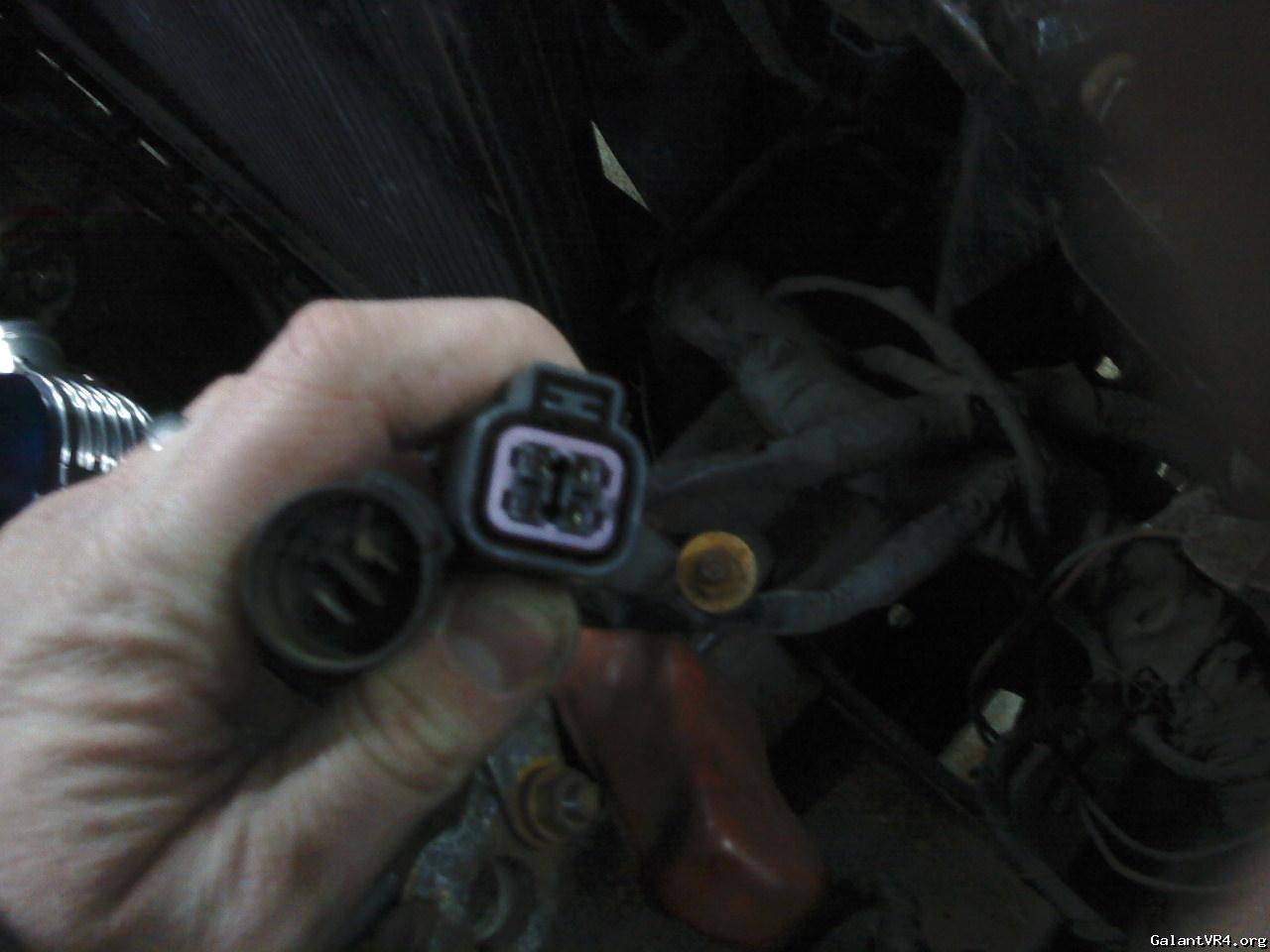

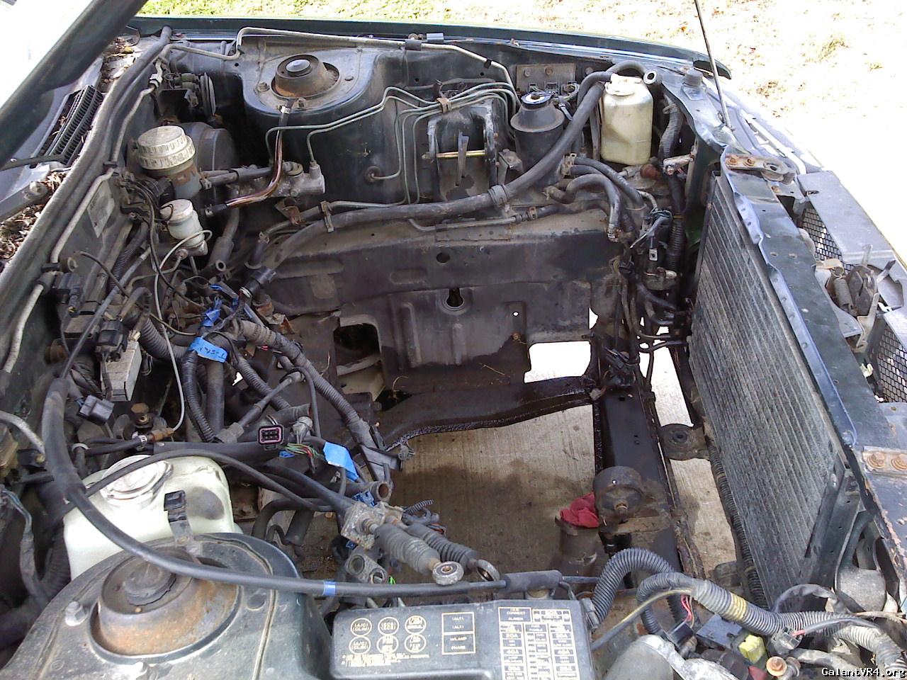

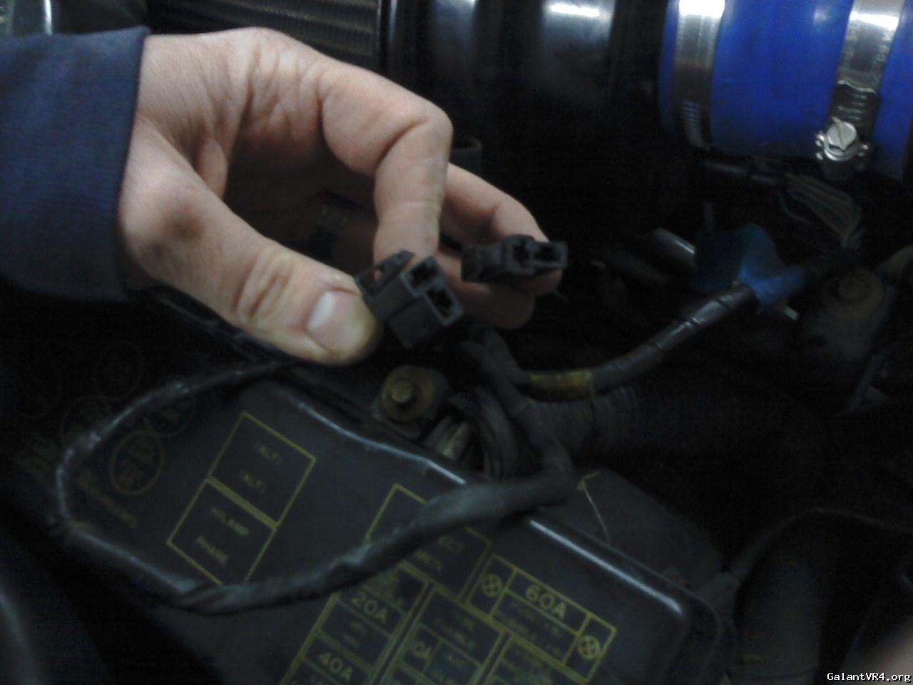

Well I have a few connectors that I don't know where they go too. 2 small connectors from the main harness and 2 from the harness at the front (behind the head light).
Also where does the wire come from for the sensor at the bottom of the radiator?

In the top picture that looks like your speedo connector to the tranny on the left. Not sure about the other. The bottom looks to be for your emissions solenoids if you still have them. I believe the coolant temp sensor on the bottom of the radiators connector is in the same loom as the fan's wiring.
Where did you put your oil cooler?
Edit: maybe that's not for the speedo looking at it closer. Do you have your o2 sensor hooked up?

I do not have the o2 installed yet but that connector is under the T-stat isn't it? I haven't mounted it yet and still trying to figure that out while I button things up.
